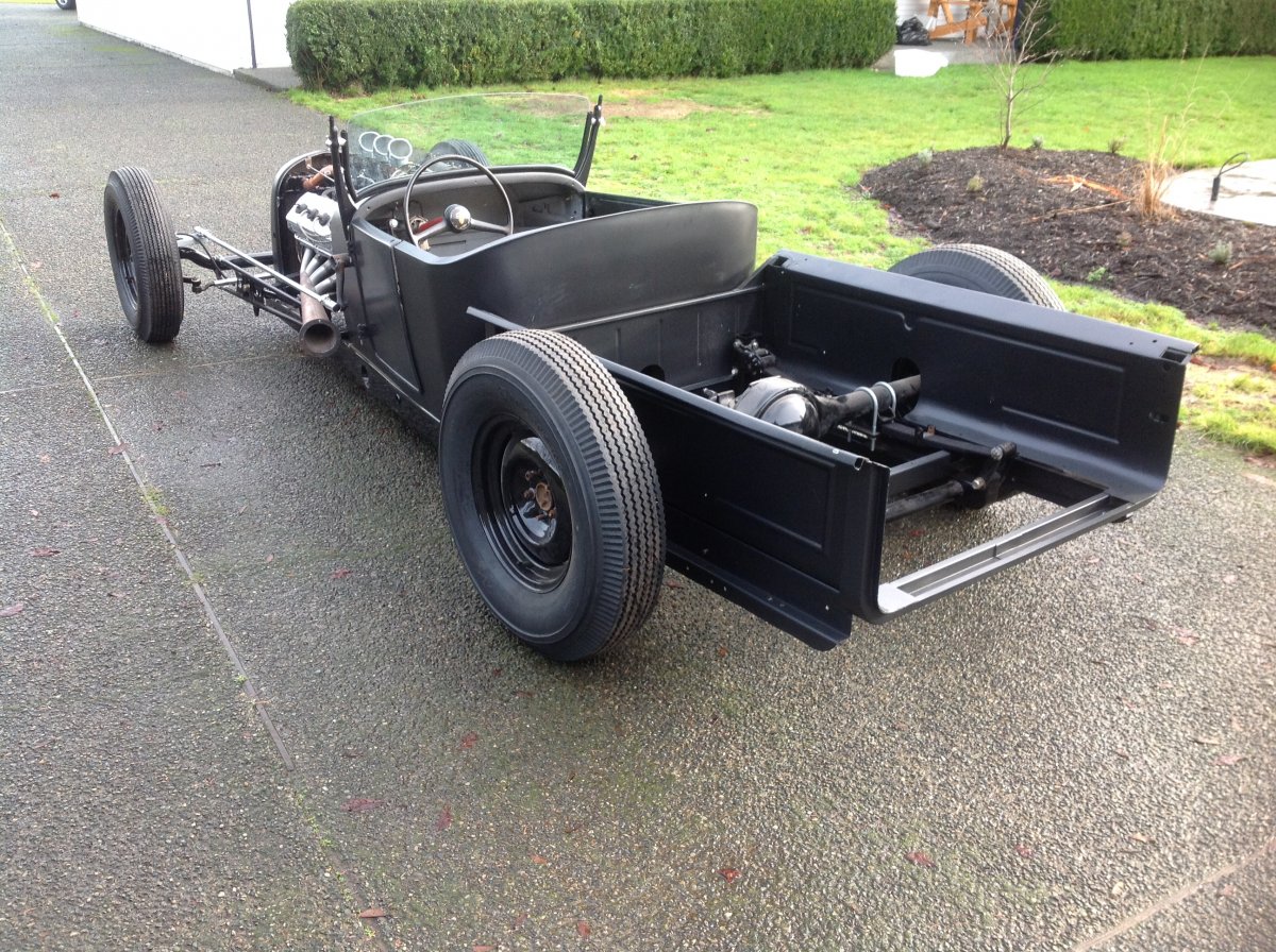

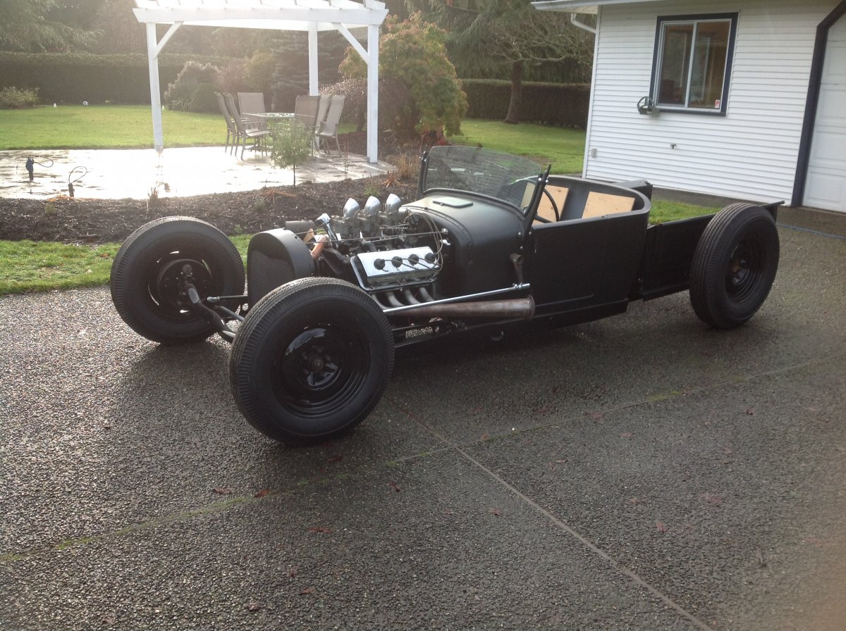

    It finally stopped raining for a couple minutes so I rolled it out again for some update pics.
    There's been a few changes. The frame horns are gone and you'll notice the rolling stock has been swapped out for 7.50 and 6.00 Firestones on International wheels. The primer is temporary. It will eventually be gloss black.

    I love the wavy tube axle and the super low stance

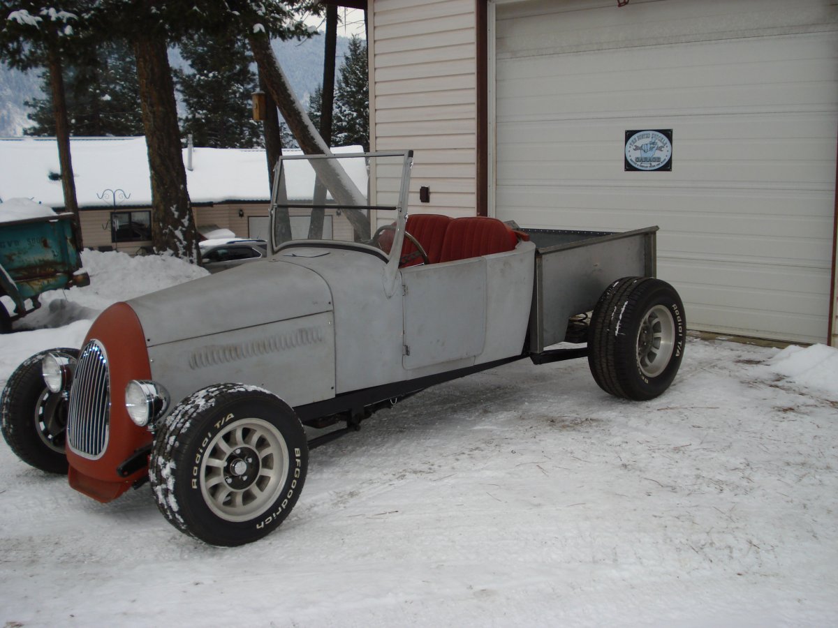

    You only need three forms filled out, I'll post them later today, gotta dig them out, a weigh scale slip, and a mechanical. As you may know, the open wheel law is coming, it'll be here sometime this summer. DSC05869.JPG
