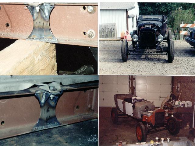

  9. dondanno
    Joined: Mar 20, 2003
    Posts: 679
    dondanno
    Heres the T touring I had in the past on A frame. I was able to use the stock rear mount on both piece then made these for the center and front mounts. No narrowing of the frame...Danny
