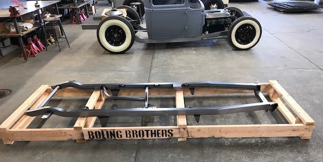

    I looked at at least half dozen ch***is/ suspension fabricators and Boling Brothers was the only shop that has the jig / plans / measurements for a stock orientation full fendered model T coupe. (others could but for premium additional cost)
    These guys are first cl*** fabricators and can build as much or as little as you want, I had them build the basic ch***is and supply (Multiple Sourced) front end components they have confidence in, and all the tabs gussets and link bars for a triangulated 4 bar set up on the rear.
    I will be installing my own trans and motor mounts, front shock mount (the model T does not use front shocks) steering, brakes and rear end.
    shipped to my door and just an awesome value. the pics are when it shipped and how it arrived. [​IMG]
