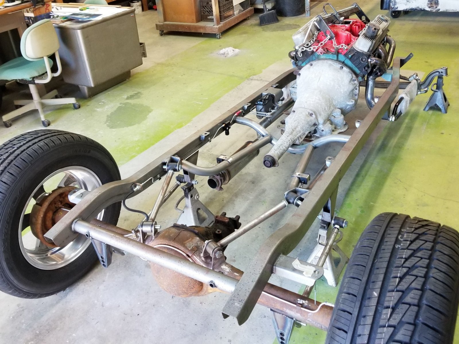

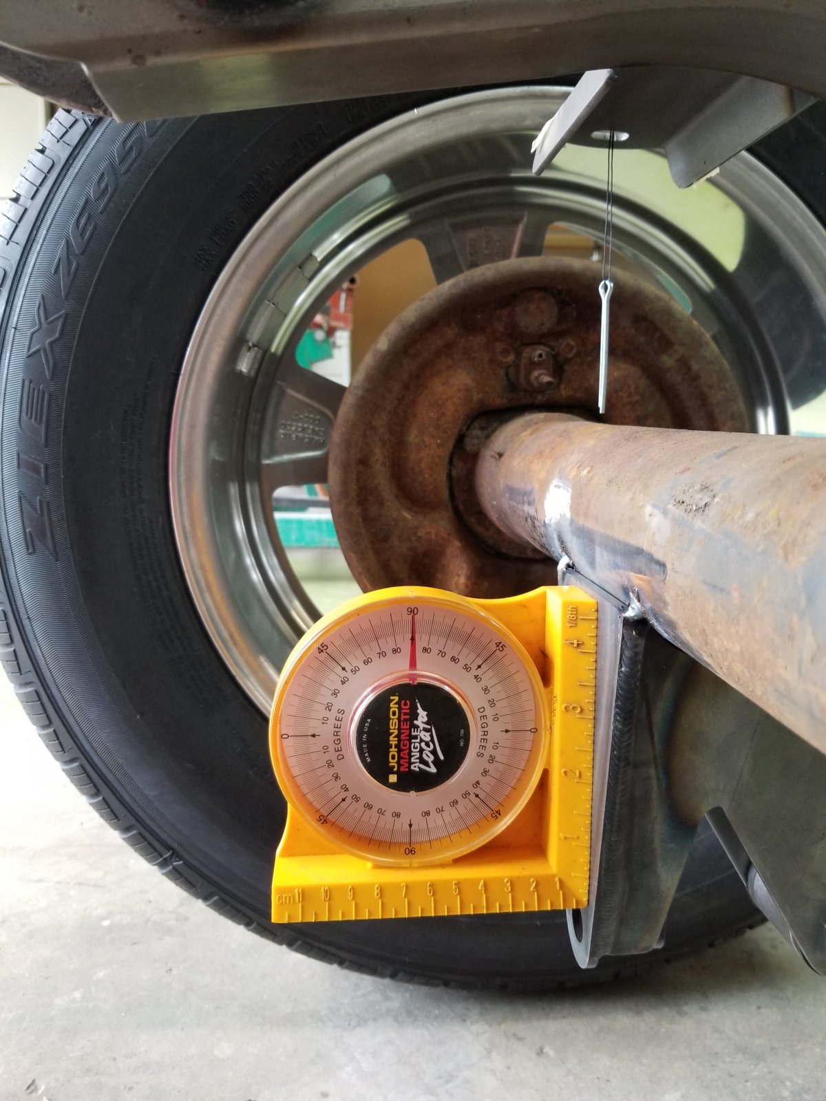

    After engine and transmission placement established, I set out to install the rear axle. using the output shaft angle I matched pinion angle, once all the weight is in the car there is plenty of adjustment in the bars to achieve proper pinion angle.
    I will need to take 4" out of the axle width (2"per side) but being that it is centered I can get all the mounting brackets fit and installed. The lower mount angle using the supplied lower bars, I will take some length out of them to get 90* 11-5fp.jpg 11-5fq.jpg 11-5o (2).jpg

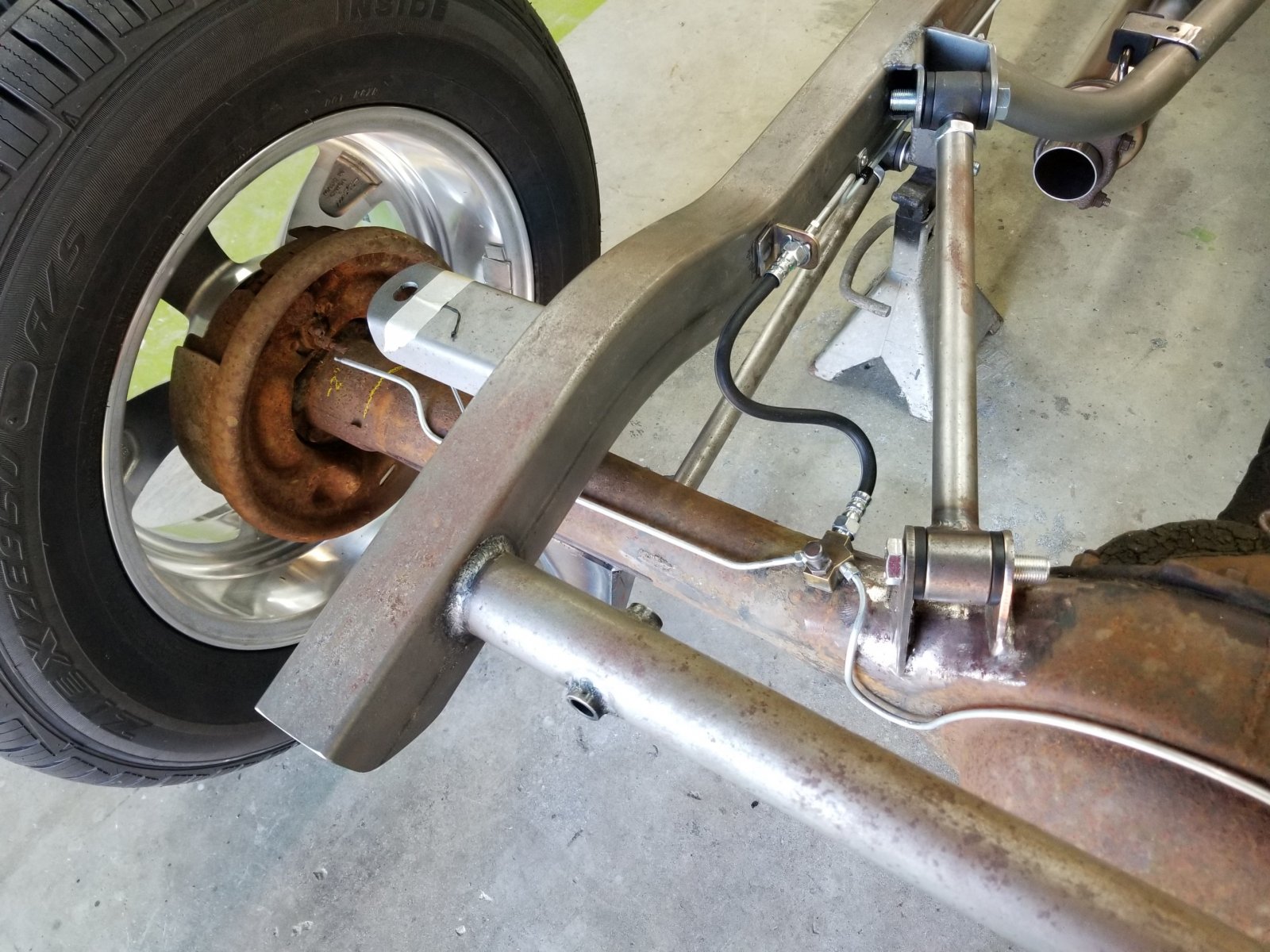

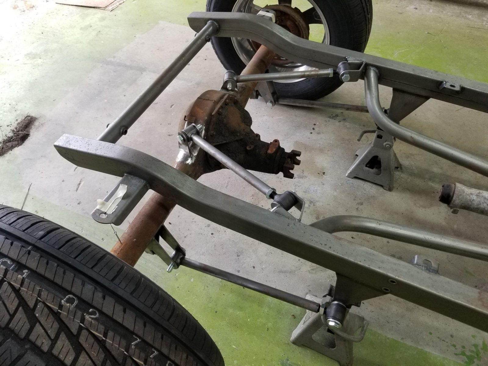

    Shortened the lower bars and set the lower mounts, fabbed the uppers and welded them in.
    Here are some shots of setting all the angles

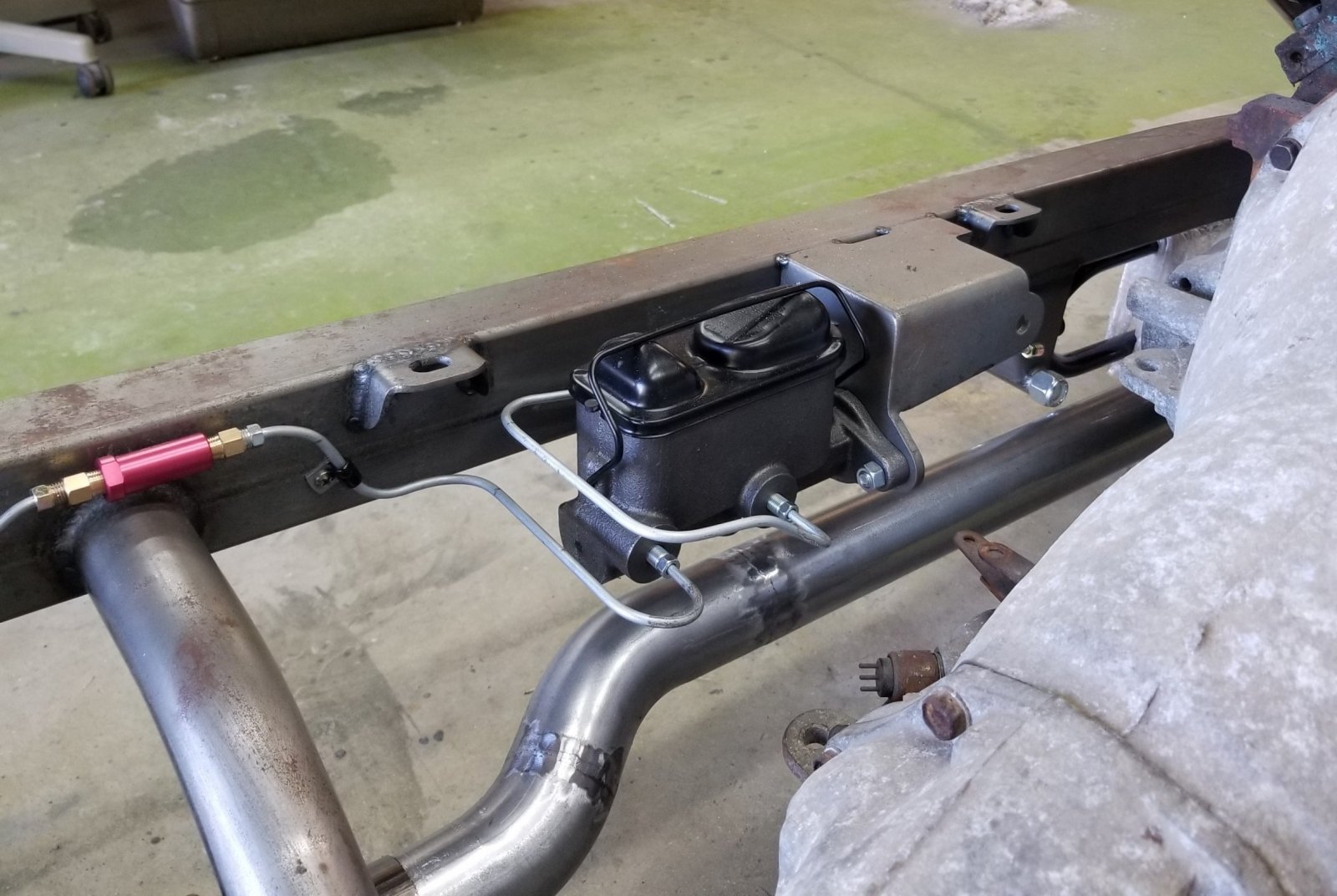

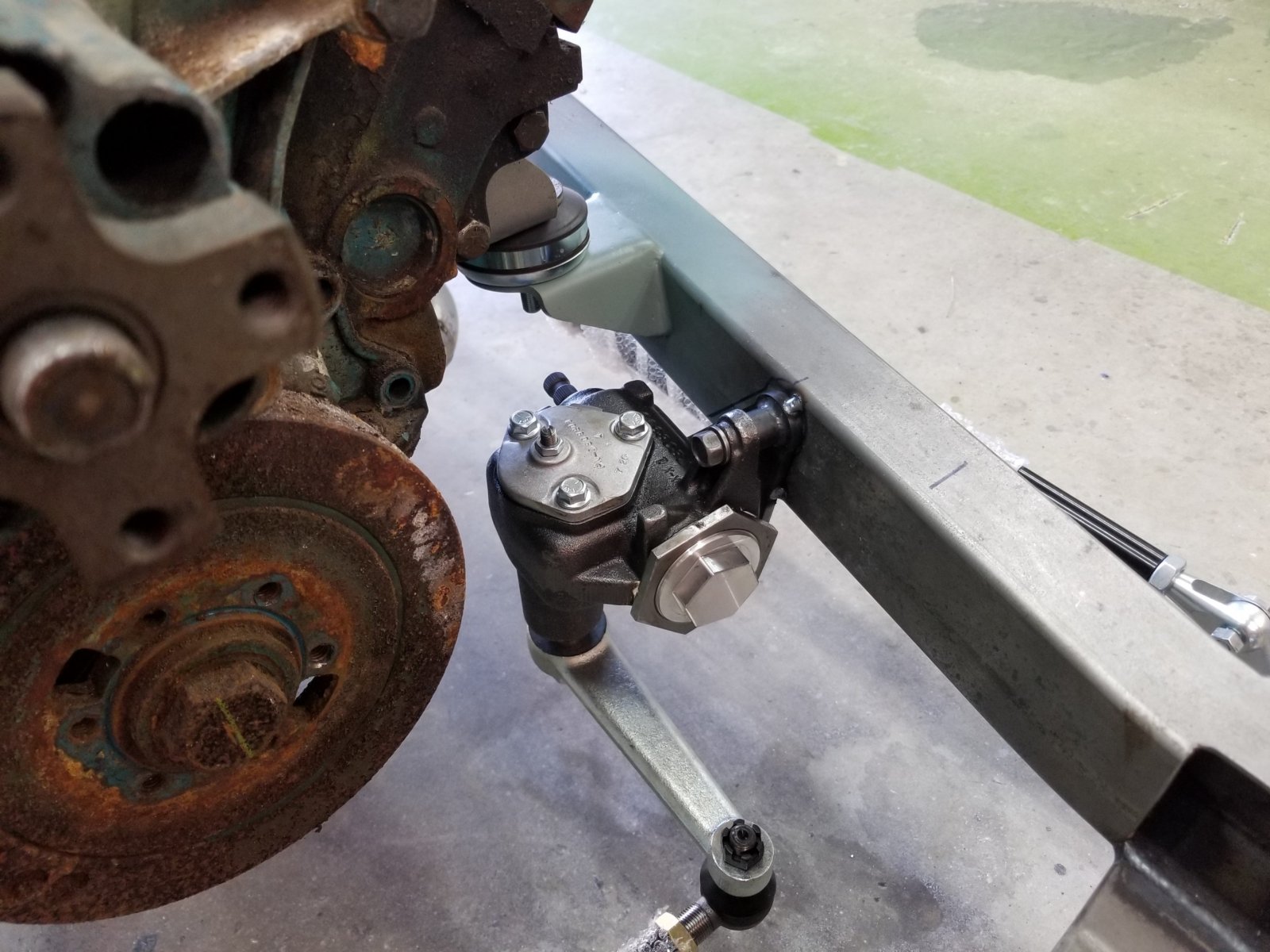

    Mocked up front suspension to begin the brake plumbing, steering box, exhaust routing, nothing complete but mostly planned out to consider fuel routing. Next is modify the body for steel floors and firewall.

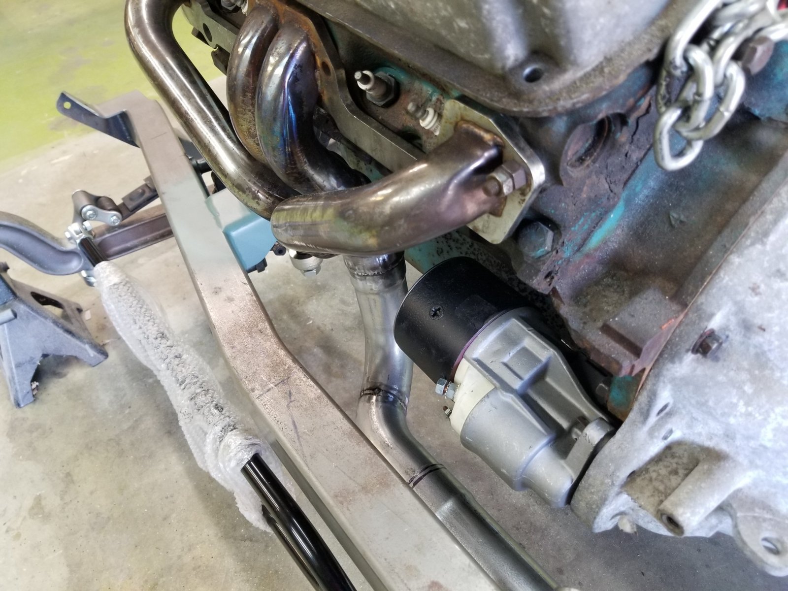

    While I think Boling Brothers do a spectacular job with their builds and fab, i sent them a little adjustment to their ch***is design that i think should be incorporated.
    It is the space allotted for mufflers, I have a full fender ch***is so ground clearance isnt an issue but these bars really cause space issues if you were to use chambered mufflers and the car was low to the ground.
    all I suggest is to add a small bend downward near the trans crossmember, it would allow the tube to be rotated upward adding clearance. chassismod2.JPG chassismod1.JPG

    WOW 3 weeks without a post and the thread drops to page 6. Anyway rolling ch***is is mostly established except for steering column, time to move to firewall tunnel, body mounts, floor structure.

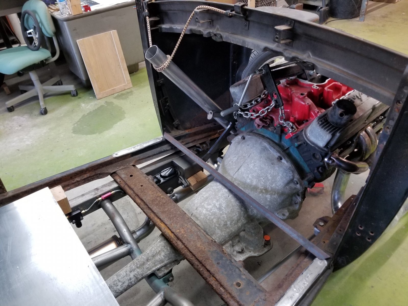

    Body setting in its location to rough in the seating position, steering column and ***essing what i will do for mounts and floor structure. had my Dad (83) sit cause we are about the same size.
    Made seat tabs and risers, seats are the narrowest I could find out of a KIA Rio, removed the arm rests, lumbar handles and the base tilt option, modified the tracks for mounting.

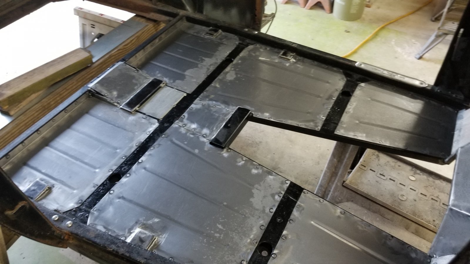

    Removed body off ch***is to start body floor structure, did plenty of planning for mounts and to maintain as much original steel in the car. I used 1x3 rectangular tube for cross bracing that doubles as body mounts and nests into the modified original steel. 1" square tube and 1/2" square tube make the trans tunnel and firewall support. I had considered using only sheetmetal for the floor structure but for ease of fabrication I chose this route

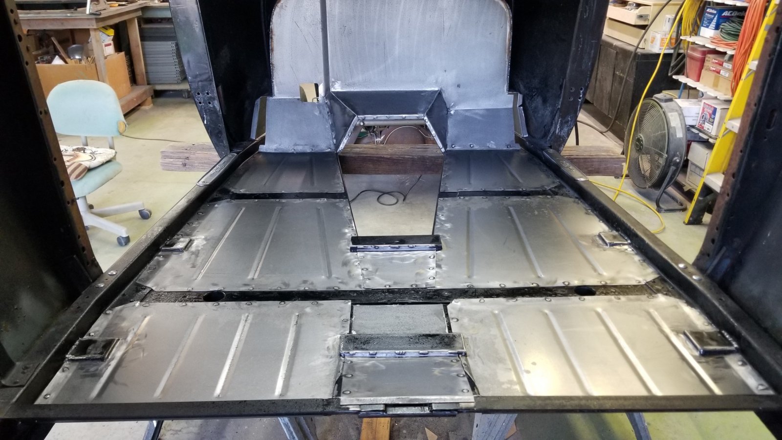

    This is the layout for flooring, you can clearly see the seat tabs and original body mount holes. I will address the trans tunnel when I get the shifter and I mount the body back onto the ch***is.

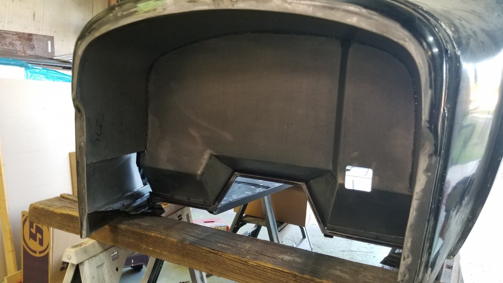

    I did some outer body sheet metal repair before finalizing the lower sections of the engine tunnel. The body on this car is really solid, only had to patch about 2 inches along the cowl bottoms and I filled in the Fresh Air/ Gas fill hatch.

    I sandblasted the under body structure then treated with OSPHO, primed with metal etch and then welded in my patches, proceeded to lower inner engine tunnel area. 1-22p.jpg

    Henry27T
    Got the floor panels bead rolled and installed all tied into the firewall. ****oned up many small bits and things to ready for the next step. It needs to go back onto the ch***is for steering column, shifter placement, trans tunnel, master cylinder hatch ect. ect. ect. 1-22k.jpg 1-22e.jpg 1-22d.jpg 1-22c.jpg
