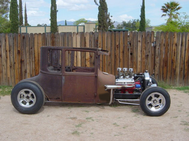

    A little inspiration for you...
    This thing really does it for me.

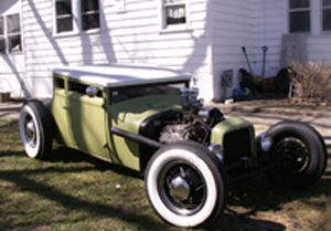

    ***us' T could be as cool or cooler with its old green paint...

    Don't chop it, the wacky tall look is unique. Chopping a tall T removes the character. Its like cutting the fins off a 59 Caddy, taking the horse collar off an Edsel or eliminating the Studebaker bullit nose. I thought the idea was to be unique. Why get lost in a sea of cookie cutter chops. Wish mine was stock height. But unfortunately it was chopped in the early 60s for a racecar project that was never finished.

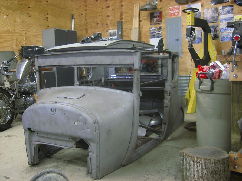

    Here is a shot of Bob Bleed's T-rantula in progress. Not the best pic but you can see where it was cut at. I talked to Bob about it and he said it was harder than you would think to chop because of the taper built into the door posts and the side windows.

  21. The tapers are exactly the opposite of what you would expect. The top actually gets wider as it goes up. And the window gl*** tracks are on a still different outward angle. Nothing easy about it. And a good argument for leaving it tall.

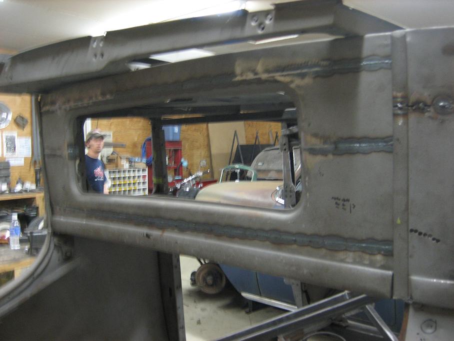

    I think one of the most difficult deals with choppin my T, was the window panes (look in the picture above) you have to cut them completely out cut a strip out thats about 1/2 inch then weld them back together to get the tracks to line up it wasn't really difficult just very time consuming.

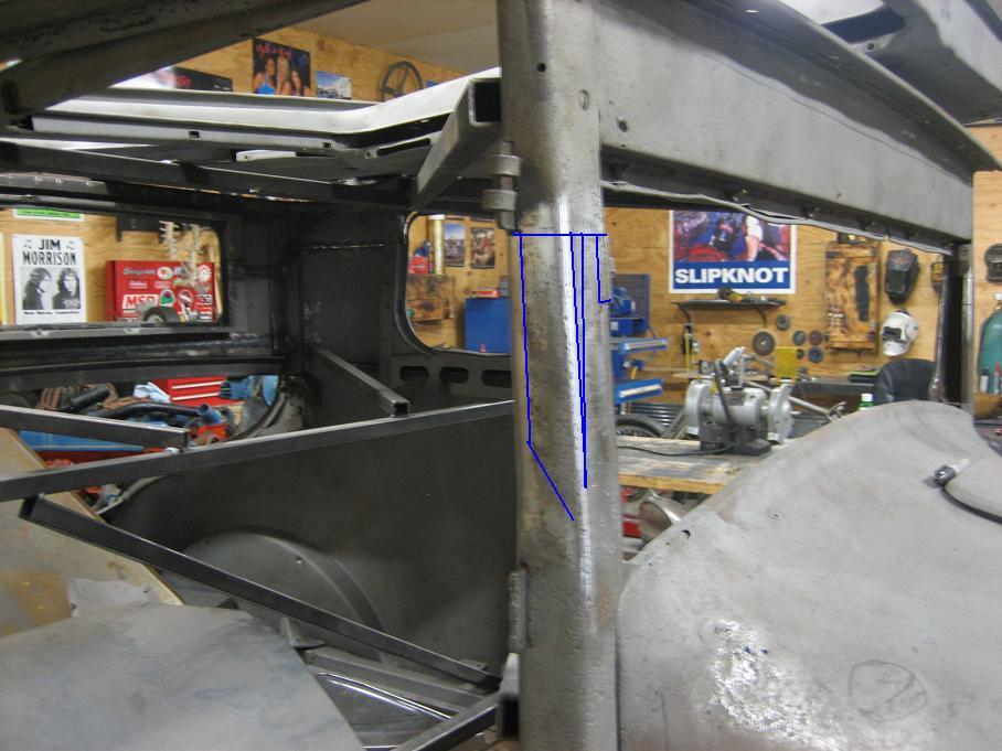

    Here's the few pics I have taken of mine so far. It is an easy chop.... sorry it is. Planning cuts in the posts is the most difficult part. It takes several cuts to make the posts line up like they should and not LOOK like they've been chopped. Patience is a virtue on finishing. I can get better pics sometime but these give you some idea. I marked out most of the cuts on the front posts since after finishing the welds you can't see them. There are like 2 more but you can't see those in the pic.
    You want to make the bottom of the post match the top, don't try and make the top of the post match the bottom, it won't look correct. That's on the A-Pillars
    The B-pillars are all together different. I'll get some pics of those if someone wants to see what I did there.

    I say leave it tall. My .02 though-reconsider the wheel/tire combo if you leave it tall. For tall T's, I think the wheel/tire combo needs to be tall and skinny like the body. For a shorter and wider wheel/tire combo, a little chop would look better.
