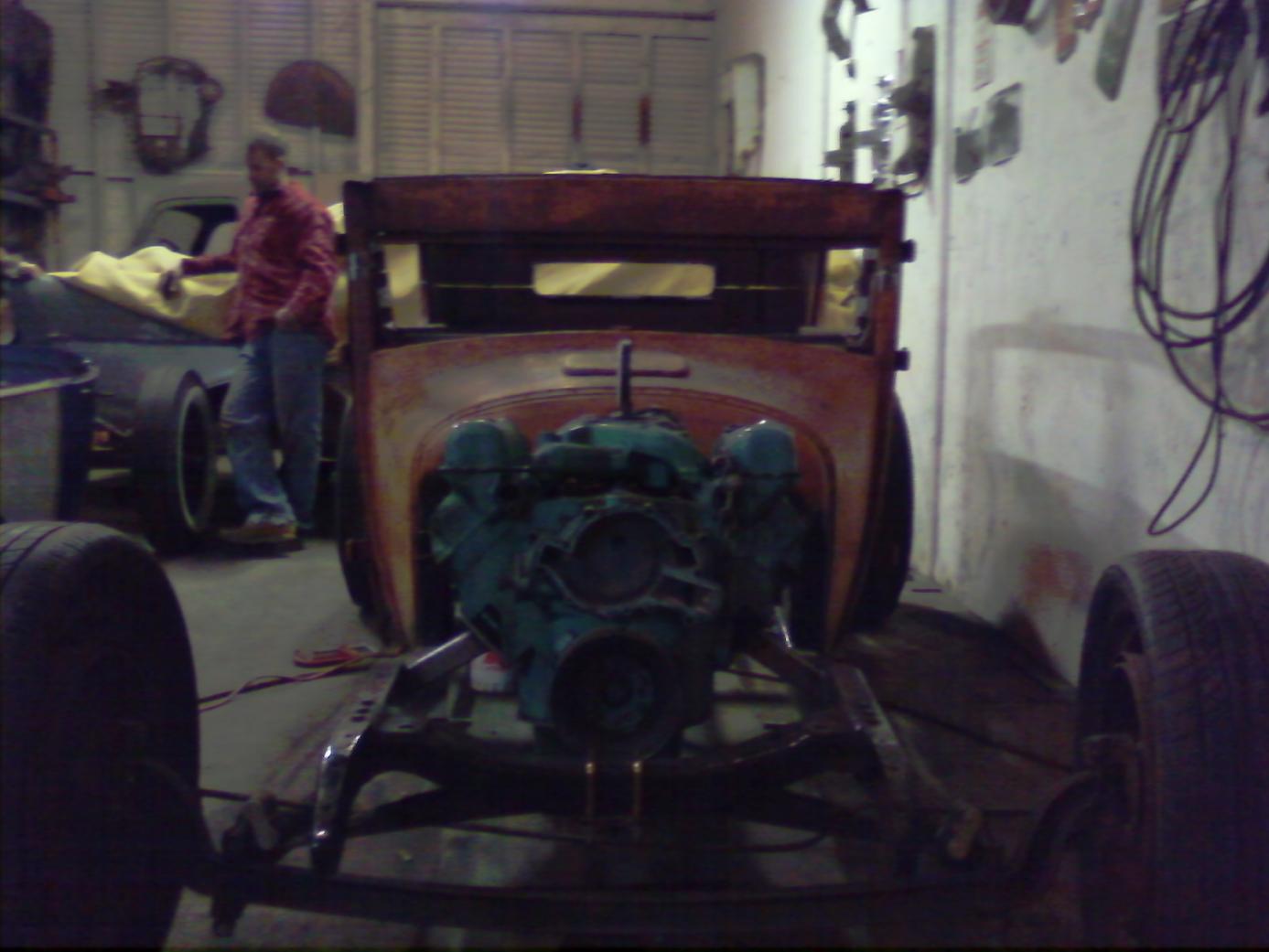

  1. I don't have a whole lot of progress pictures.. but here it is.
    A frame Z'd 12 inches in the back, swooped 6 in the front and boxed.
    4 in drop axle up front and a '48 ford rear end. '64 401 nailhead. It's channeled just to the bottom of the frame, but i'm thinking about going another 2 inches. Just chopped it the other night. Still have a lot of work...

    I think it looks dead on as is.Did you box the whole frame?I saw the first pic of the frame,and it wasn't boxed in the rear,which I would for shure do.Your hot rod looks killer though.Keep up the good work,and keep us posted:D

    It would have been awesome to leave it as it was in that third photo.

    Looks good to me but I would box the frame and I to like the 3rd pic :cool:

    Looking good, chopped AND unchopped. Keep us posted!
  7. yes, it's boxed all the way around. that picture was taken right after we z'd it. thanks, i will keep the progress pictures coming.

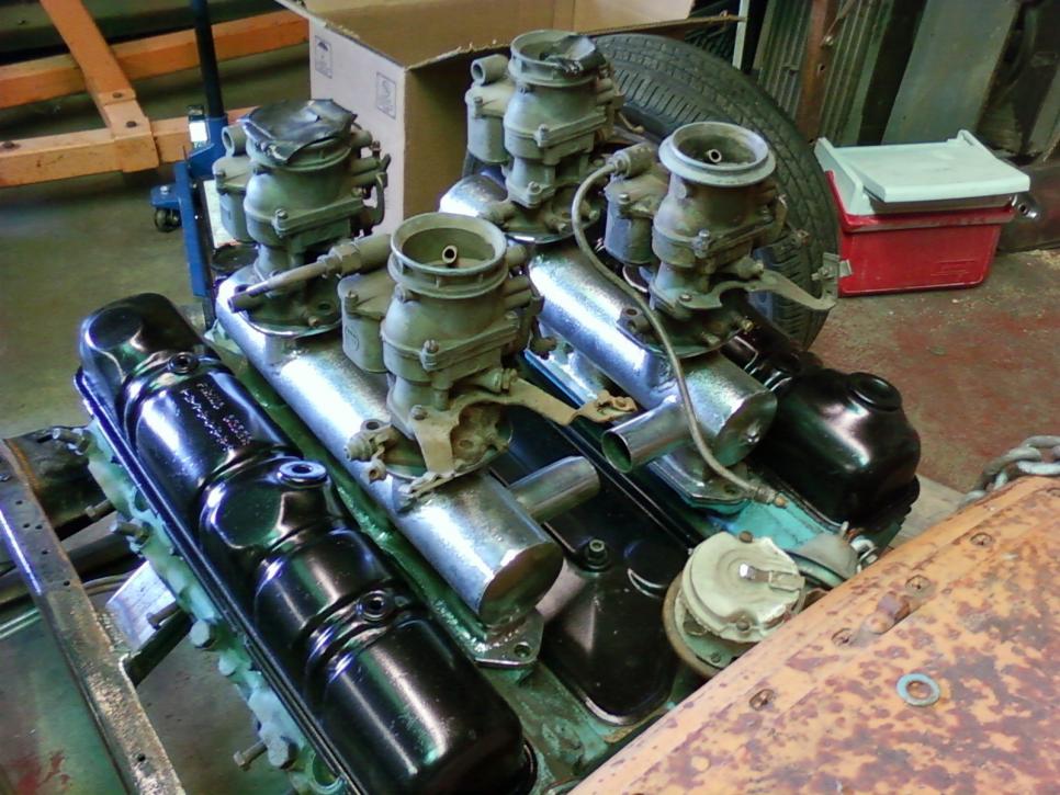

  9. new intake.
    4x2 log manifold.. looks to be homemade from back in the day, still has the original chrome.
