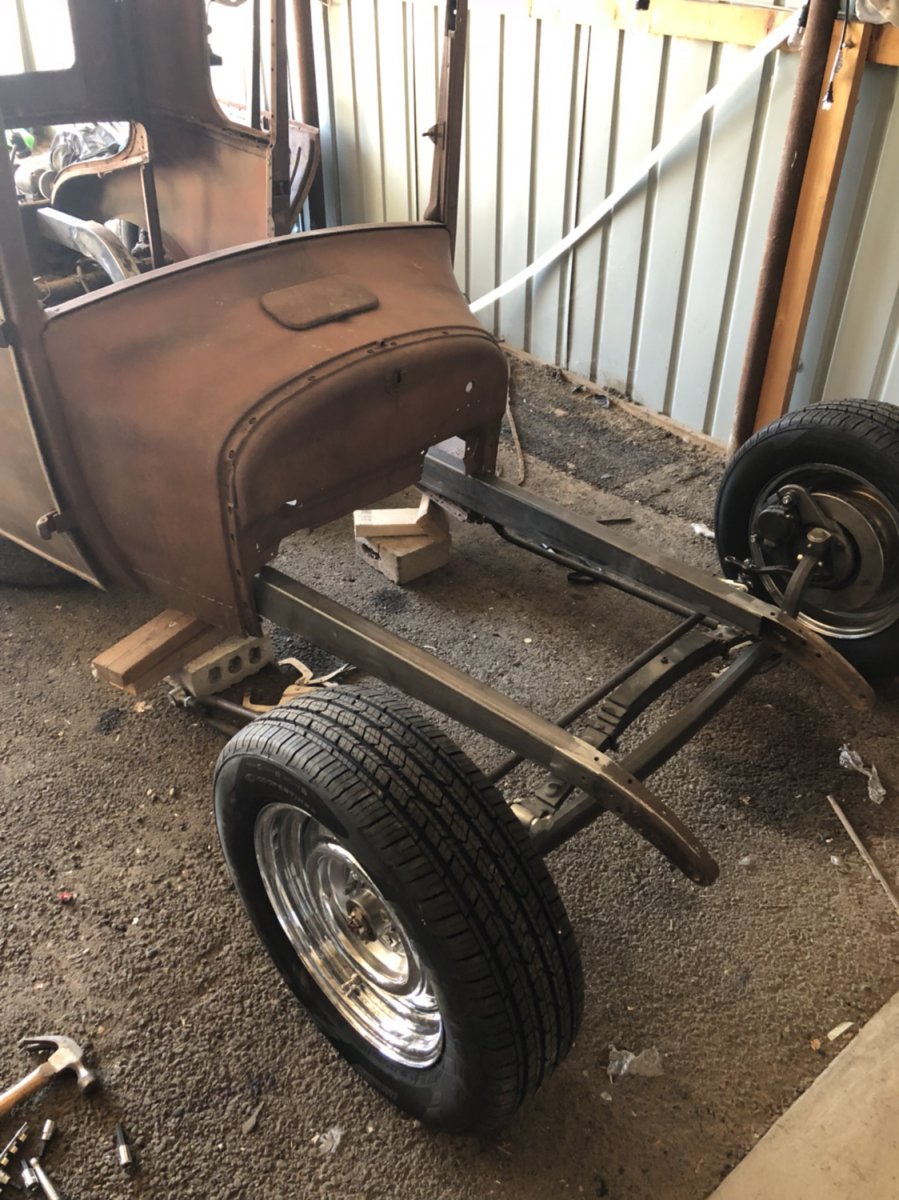

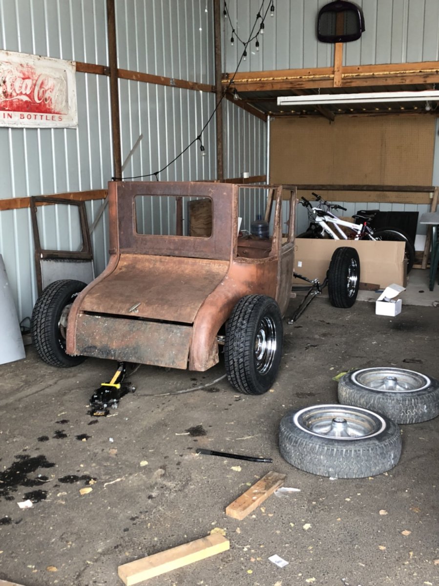

    My grandpa and I are building a tall 1927 T coupe we done everything ourselves including frame just on here looking for parts and good conversation

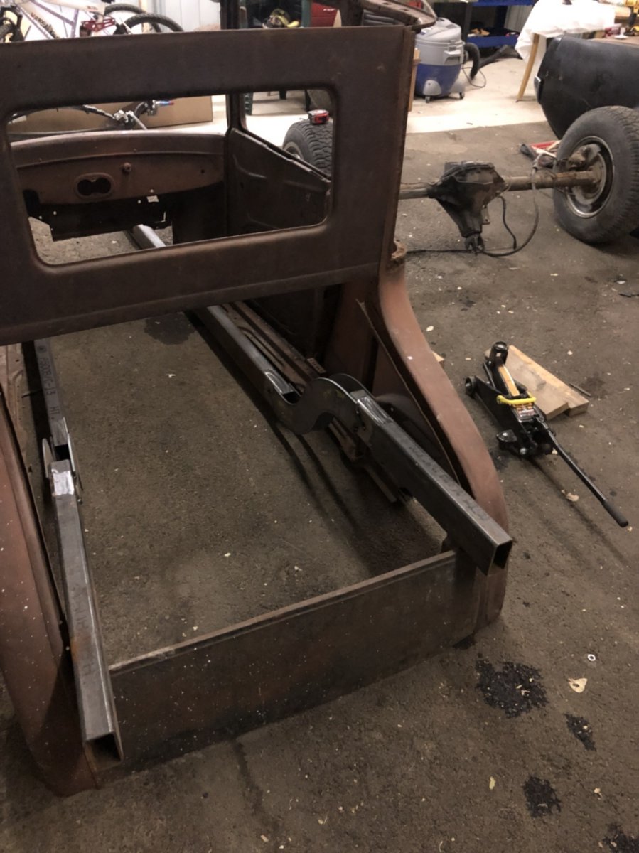

    Can you please show us what you have done inside the body for channelling over the frame?
  9. Nightheat Fab
    Joined: Jun 14, 2018
    Posts: 38
    Nightheat Fab
    Sure I have some pics not the best but I custom built the frame to fit inside the cab it’s much narrower the a model A frame. But I notched the corners of firewall so it slides over as well as as took out floor braces and seat pan it sits 3 inches over the frame. Will try to get some more pics this week IMG_1172.JPG IMG_1095.JPG IMG_1269.JPG
