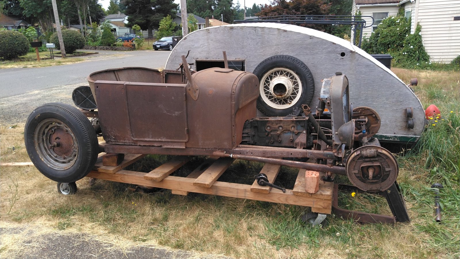

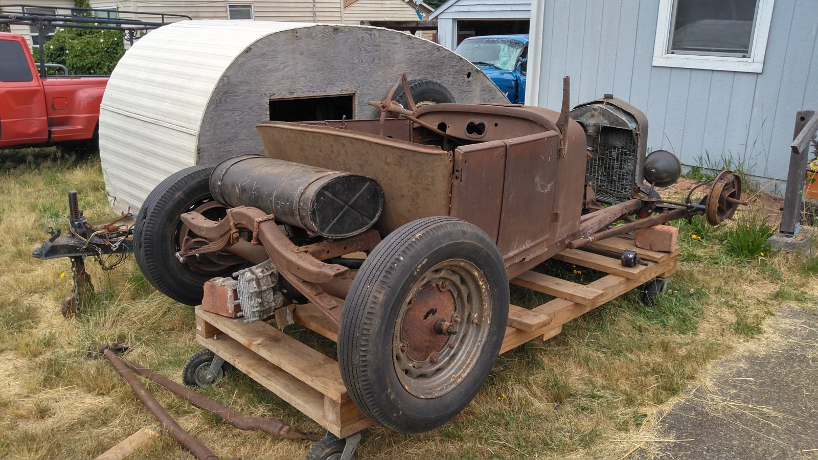

    I traded fastrnu for his modified project that has been sitting for the last few years. I will be finishing the build and posting the progress here. 16262924098668882594797411401699.jpg 16262924465349156662232664441461.jpg

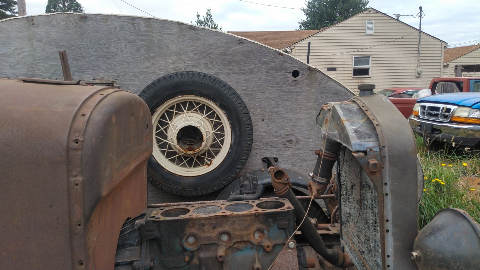

    I am leaning towards using a stock 27 T grill shell. I think that if I use the earlier radiator (low height) and modify the mounts I can clear the spring. I can use the 27 grill shell (tall height) grill shell to get the right height of the shell to make the hood fit right.
    An other option is to use the 27 radiator and shorten the bottom to clear my spring. There is also the fact that the lower water neck is on the wrong side.
    I looked at using a 28-29 grill shell but I would have to narrow it and I don't think it looks as good narrowed. If I use it full width the angle of the outer frame rail will not be right when the hood side. 16263789143771441512518681421748.jpg 16263789853413688523406122366233.jpg 16263790428887263111110436189757.jpg 16263790961607821597220490417400.jpg 16263792935503895947984563007082.jpg

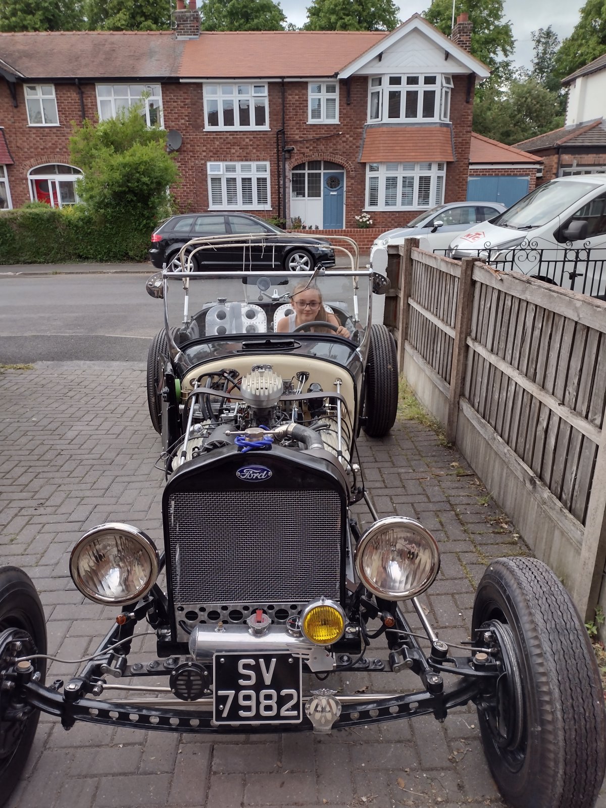

  21. Using stock rad shell, headlights and stands on my 27 Modified IMG_20210611_165606956_HDR.jpg

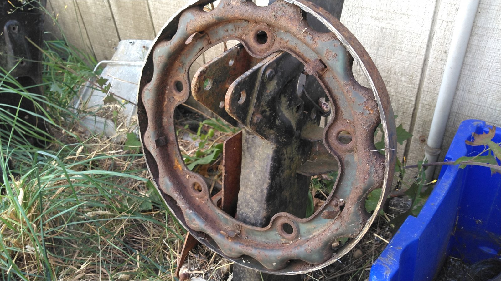

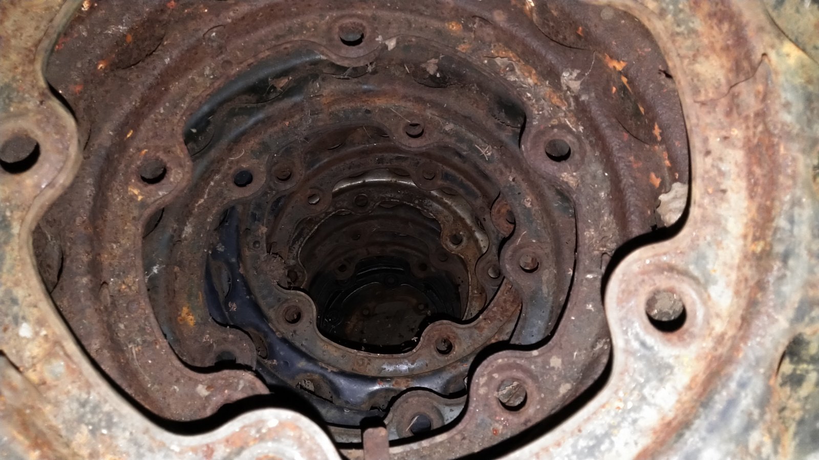

    I looked through my wide five wheels and found a couple cancer candidates for surgery. The centers are decent but the rims are totally gone. On closer inspection the new rims are about 14-5/16" while the wide five rims are 14-3/16. In the light of that I am going to leave the center band of the wide five rims for now until I see that I don't need it. 16276008199197839864081316738143.jpg 16276008586901953859419521730529.jpg
    oliver westlund and brEad like this.
