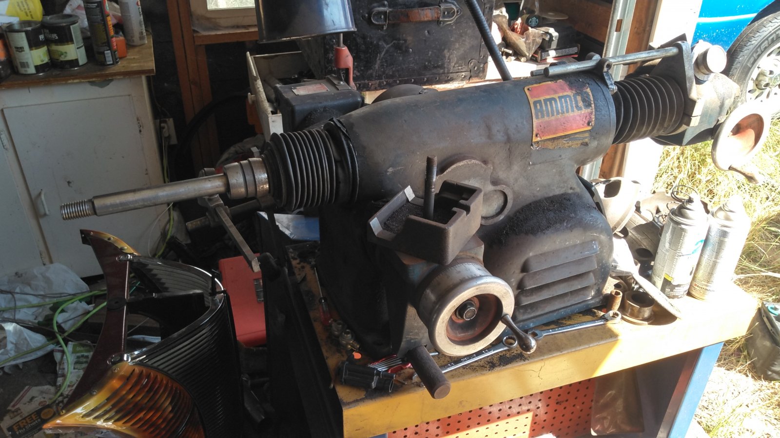

    Got mine at the local tire shop. He had two, one set up for disc and the other for drum. Bought both with all the adapters for $150. They just started taking their stuff across the street to the auto parts store because it was cheaper and easier than doing it themselves.

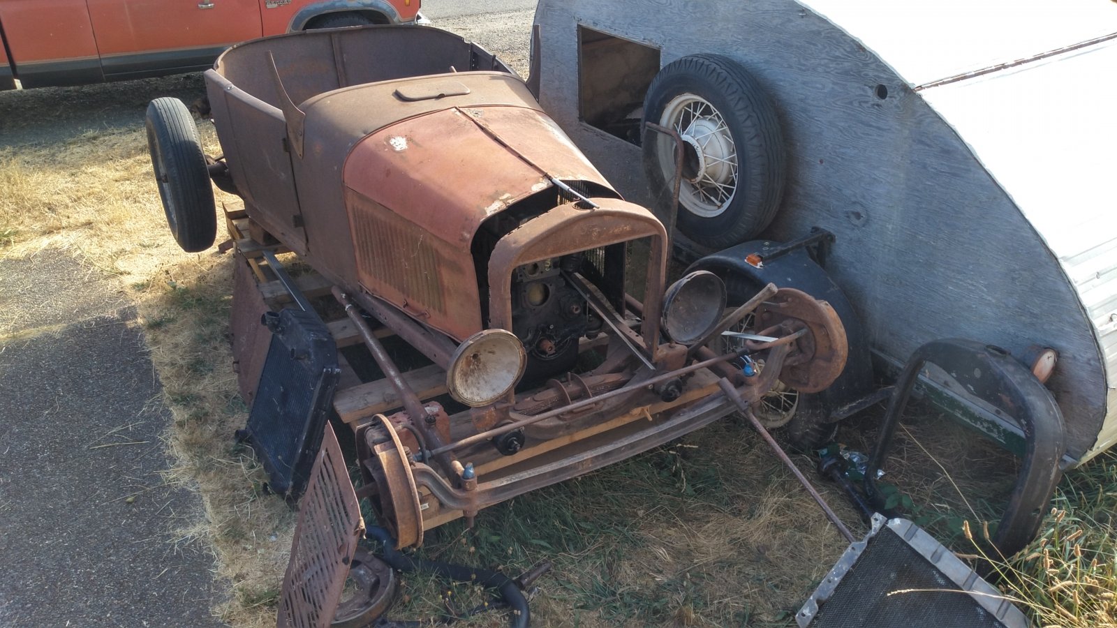

    Cut a junk brake rotor off and bolted the first wheel to it. Almost got it cut apart when something happened to the wiring or the motor on my brake lathe. I will look into it later and figure it out but for now this is what I have. 16287831469832421784944202795306.jpg 16287836355252324472979608679250.jpg 16287836578866347776086583427378.jpg 16287838051172559180244858580672.jpg

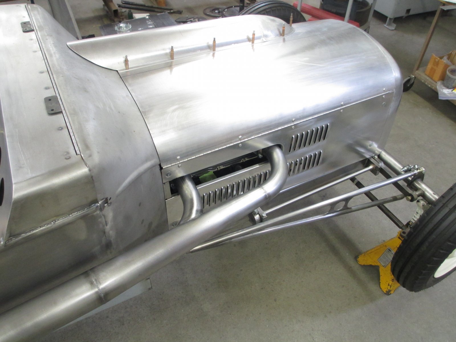

    I am looking at hood options. I have a stock 27 T hood for measurements. The hood needs to be lengthen 5-1/4" and I want it to come down to the top of the frame rail. I have been looking at using a model A hood but even the 30-31 is about an inch too short. Thinking about just forming a hood from aluminum sheet. Not sure on weather to make a 3 or 4 piece hood. I was thinking about using woven wire mesh in the sides rather than louvers. The other area to look at is how to latch the hood. Looking for ideas and options. 16293307720104424592268932214267.jpg 162933081130879148381095390475.jpg

    In my opinion for what it's worth, I like it and can imagine the hood that much longer. 3 pieces and how about leather straps and buckles

    I think that I have decided to make the hood out of aluminum. I am pretty sure I will use stainless woven wire mesh in the sides instead of louvers. Contemplating running the exhaust out through the side panel and splitting the side panel above and below similar to a Duesenberg SJ supercharged car has.
    I am going to run naturally aspirated for now but have a turbocharged manifold and a pair of 97 carbs to go on it. This would require a hood top change because they will stick out the top. The turbocharged manifold also dumps out on the driver's side instead of the p***enger side so pretty much would have to remake all of the hood and sides at that point.
    I am thinking that a 3 piece hood would be better if the carbs come through so I might as well start with that design. I was thinking about placing a square tube bar down each side to attach the tops of the side panels to and use 28-29 hood latches bolted to the frame at the bottom.
    I could use a Dan Fink hood latch kit for the top although that wouldn't be as traditional as I would like. I was also thinking a spring loaded rod with a knob out through the top of the side panel might work as well. The hood top could pivot open either way or be lifted straight off. The side panels can be removed separately. I am also thinking about using 26-27 T hood latches at the bottom.
    Any thoughts on these ideas are welcome.

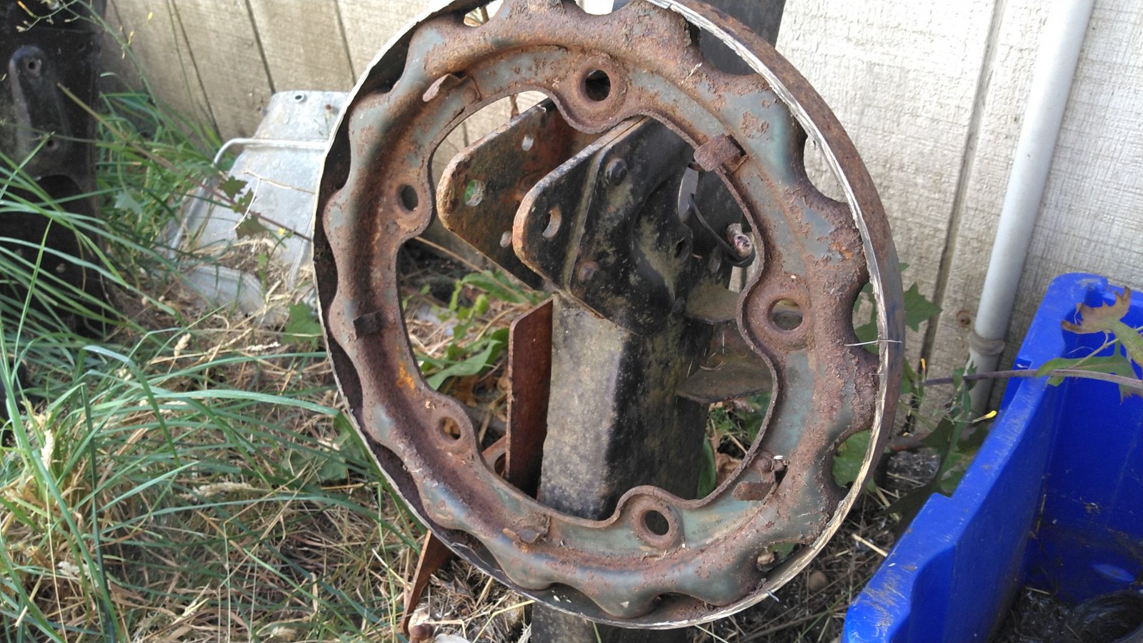

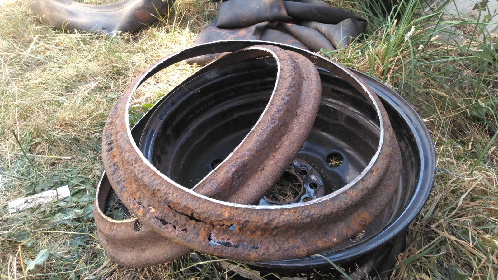

    Got one wheel cut apart and second one cut but not separated. After cutting the welds in the brake lathe I had to heat the rim with a torch to expand it and beat the center out with a big hammer. Looks like I will have to remove the band off the center. 16294278126716961023496362117597.jpg 16294278744324418573881226027894.jpg

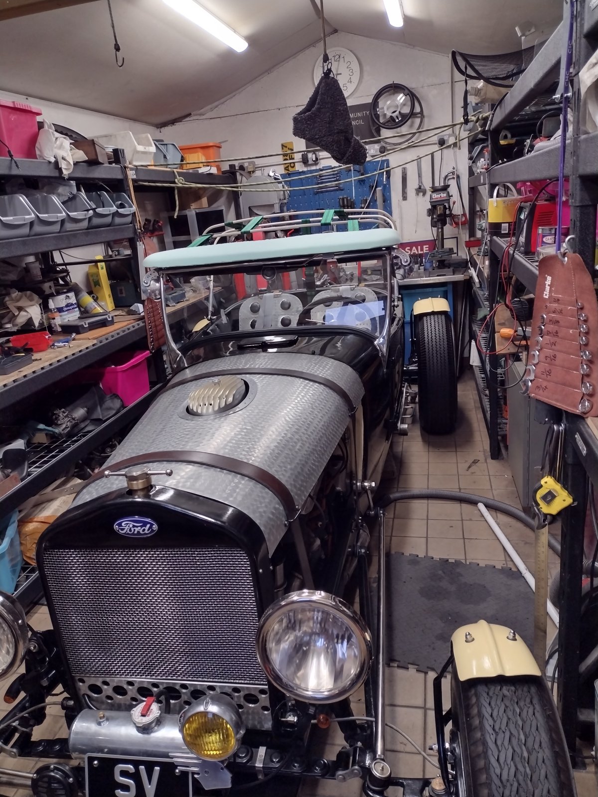

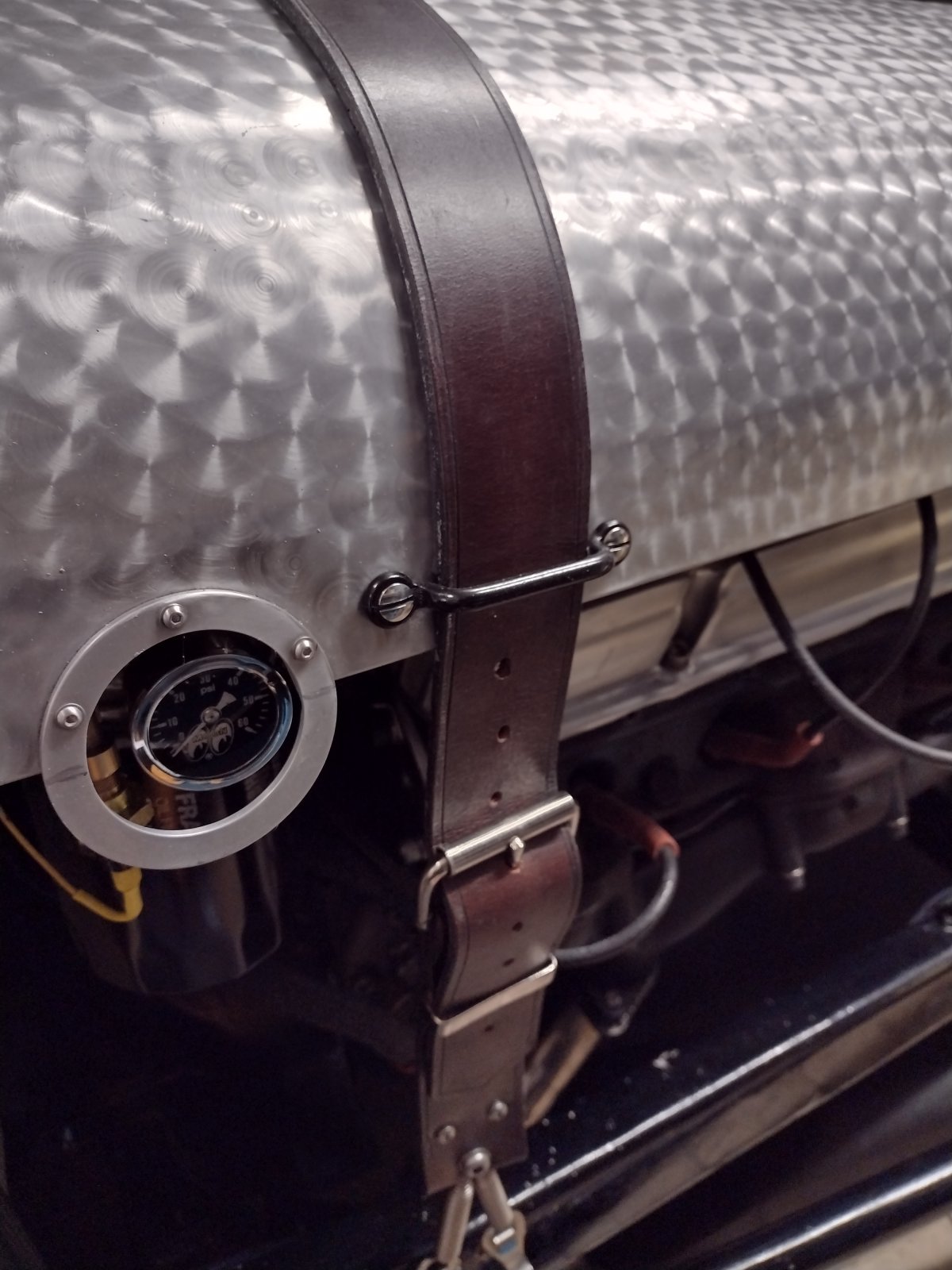

  15. The aluminium hood is 15" over stock length and is fastened by leather straps on spring hooks
    Yes... I did build it in there

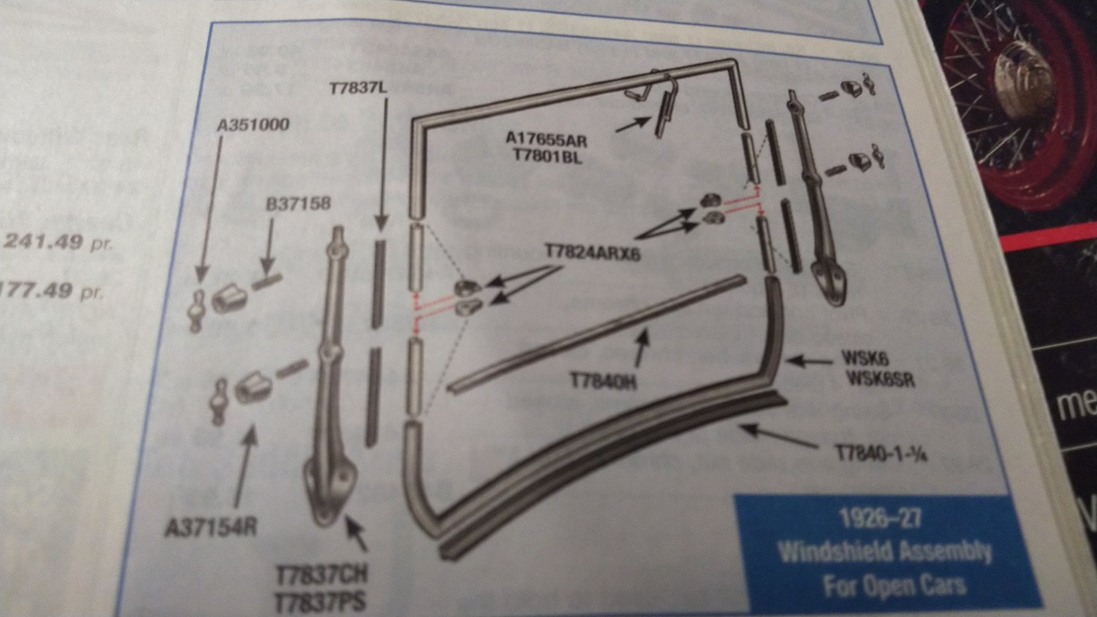

    Does anyone have the dimensions of a 32 Ford roadster windshield? I'm pretty set on a fold down windshield. I think that I could use 2" chop 32 posts and mounts with a lower 27 T windshield frame. Not sure if the 32 lower stanchions will fit the 27 T cowl. The other option is to modify the 27 T posts to accept the 32 foldable posts and use the 27 T windshield. 16294462198953506635307481916755.jpg 16294463204227491534357990015026.jpg

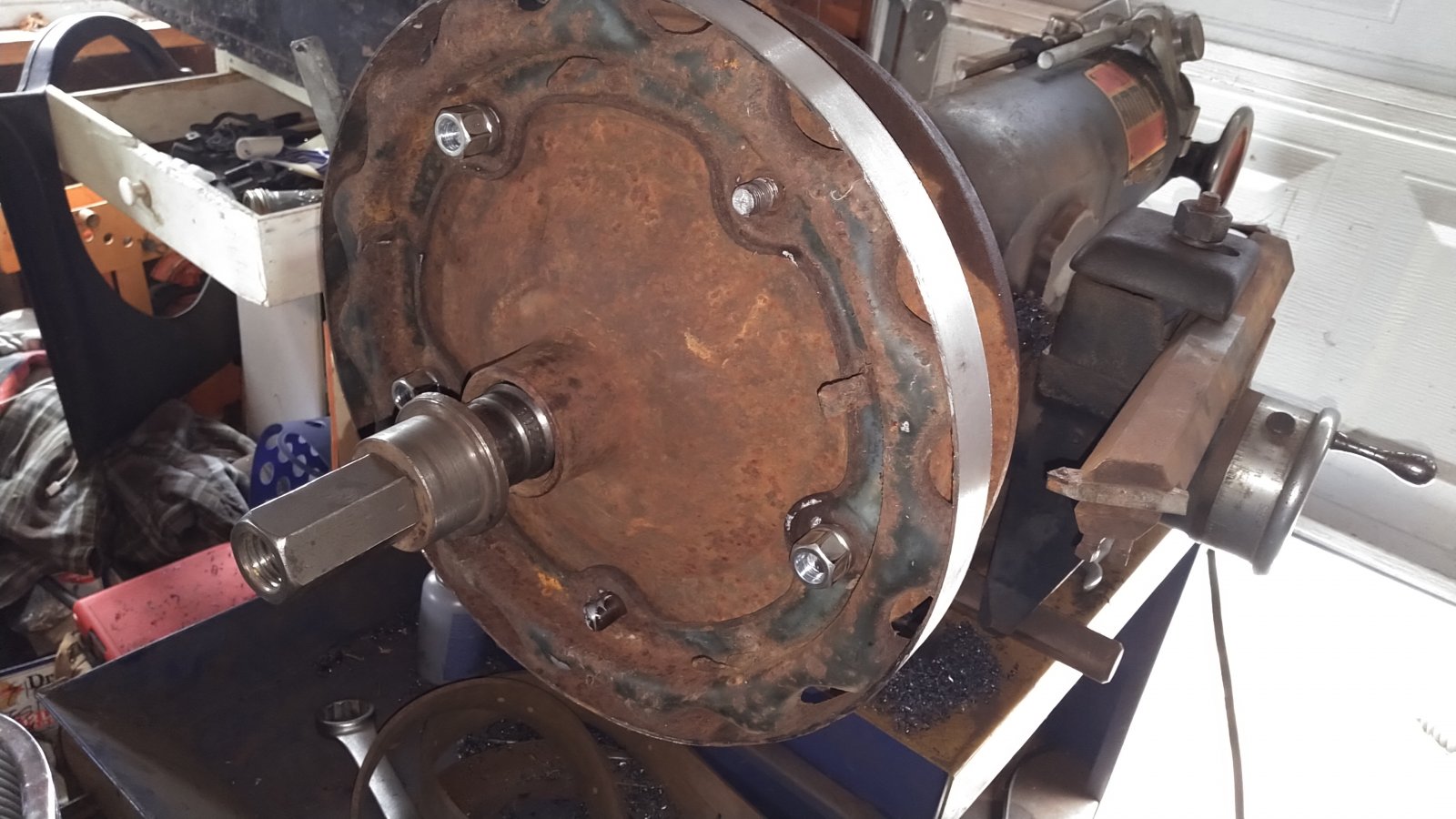

    16295683131468791999985314536526.jpg 16295685084477366555057152153107.jpg Chucked up the wide five hub in the brake lathe and turned down the center. I cut the back side even with the edge of the center so when I weld it it will not rely on the rivets.

    Flipped it around in the brake lathe and cut the front side. Had to use a brake drum damper on it to keep down the chatter. It ended up being about 7/8" wide and I will be able to weld the front side of the spokes to the rim. The rivets are still in place holding the center on. 16295706970693664202845218902953.jpg 16295707214288291998063869515285.jpg

    16295734773715932496632834909706.jpg 16295735328155293476460277689711.jpg 16295736757856579414732624674585.jpg Used my rubber headed mallet to tap the rim on the center. Hand turned the rim and adjusted it until the cutter was hitting in multiple places. If anyone has had experience with rims they are close but not perfect from the factory.

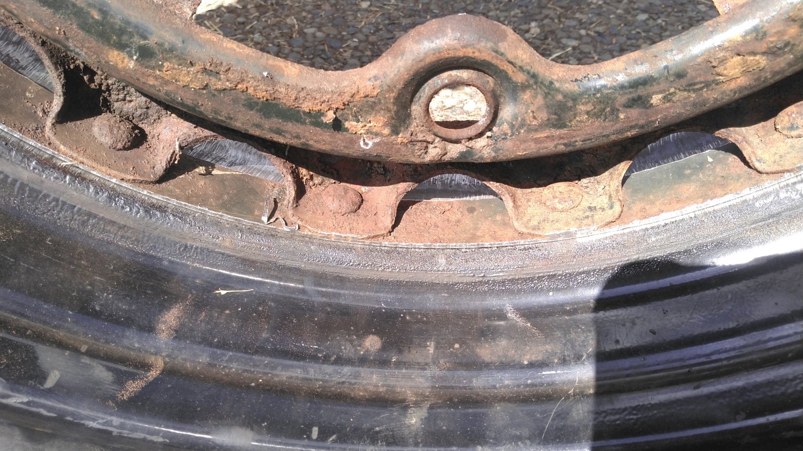

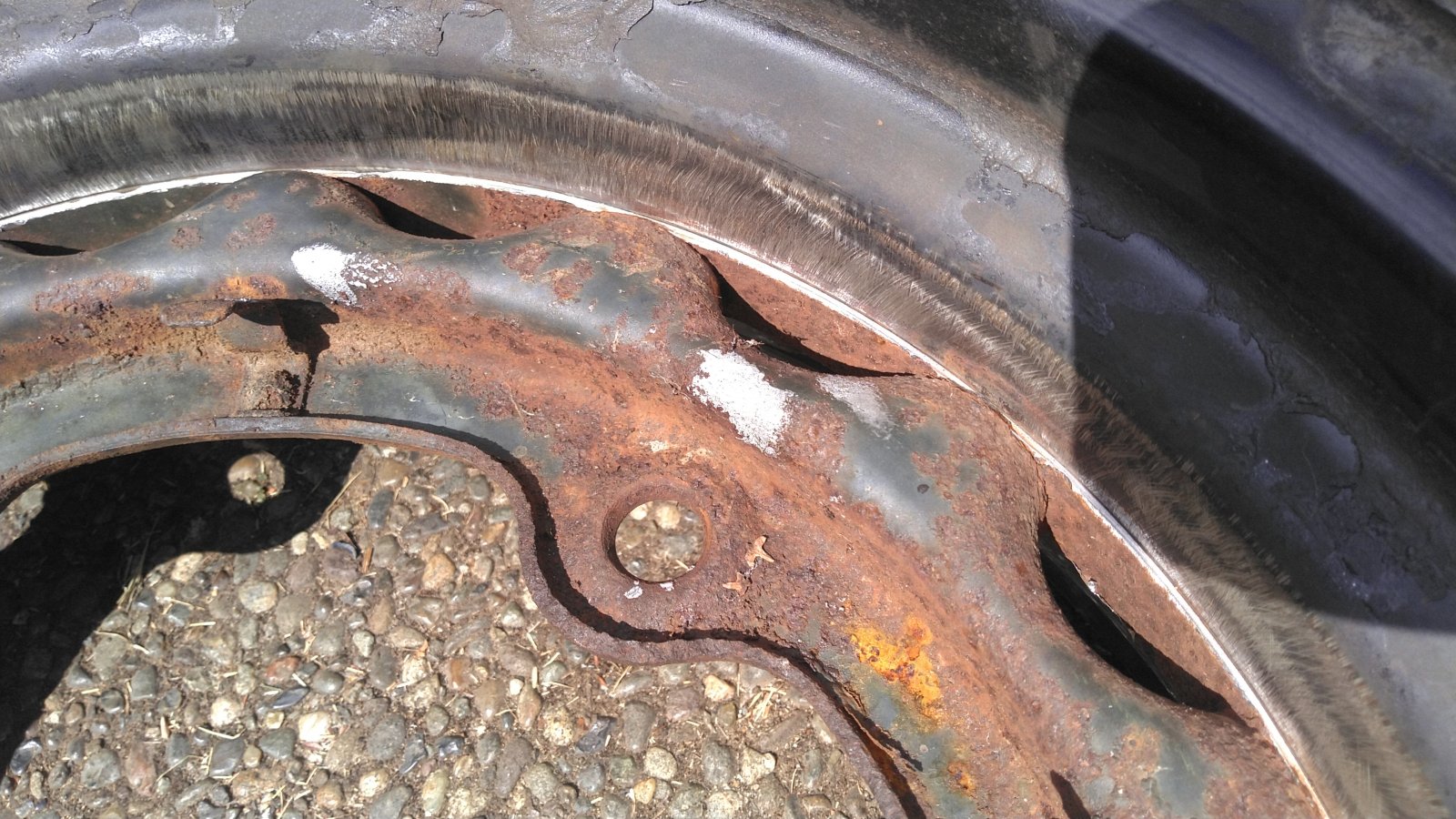

    The edge that I am not liking. Thinking about cutting it out between the spokes and tig welding it front and rear at the spoke. Any thoughts on that? 16297504896723709106300783655638.jpg 16297505280314465480325951966224.jpg

    Imho it looks like you could weld all the way around the band and grind it smooth on the outside so that it looks like it is actually part of the wheel hoop. Sort of trick the eye into seeing it as smooth. Then a second bead at each spoketo further trick the eye and effect a strong connection between the center and the hoop.

    ratfink56
    Hit it with some rattle can black and see how it looks?

    I am with Dave on this one, what he suggests the wheels would be strong and look good.
