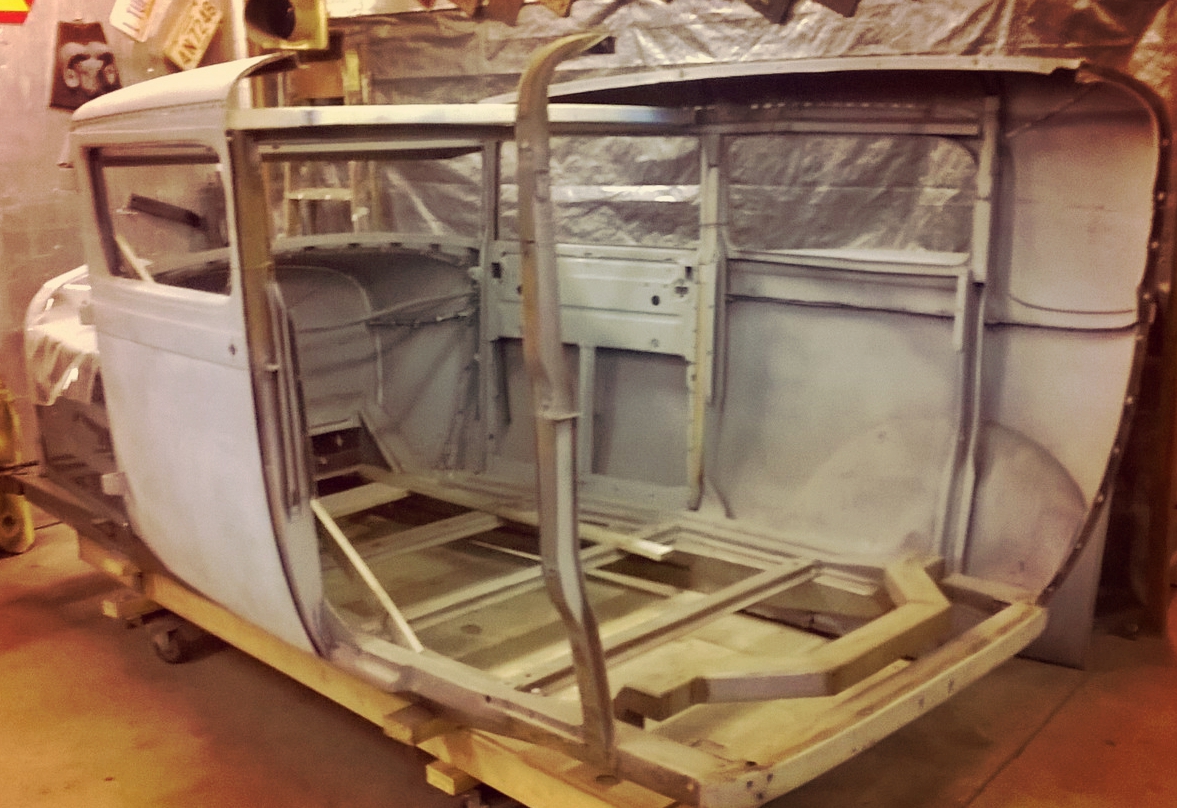

    WP_20160303_004.jpg So, I need a bit of help. After doing a bit of comparison, my dad has decided to "un-sedan" this Model A. Could anyone with a '28/29 coupe help with a paper tracing of the rear quarter window opening? He's looking to determine how to get the existing shapes to look correct. He is aware the beltline trim is drastically different and has studied several photos...but... a paper tracing would answer a lot of questions. PM me if you could help out and we can iron out the details. Thanks!

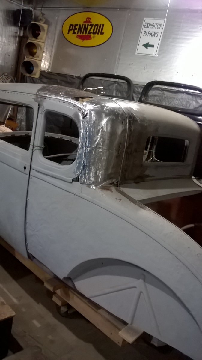

    WP_20160303_003.jpg Another pic... messing around with a hand drawn "guess" of how the window should look.

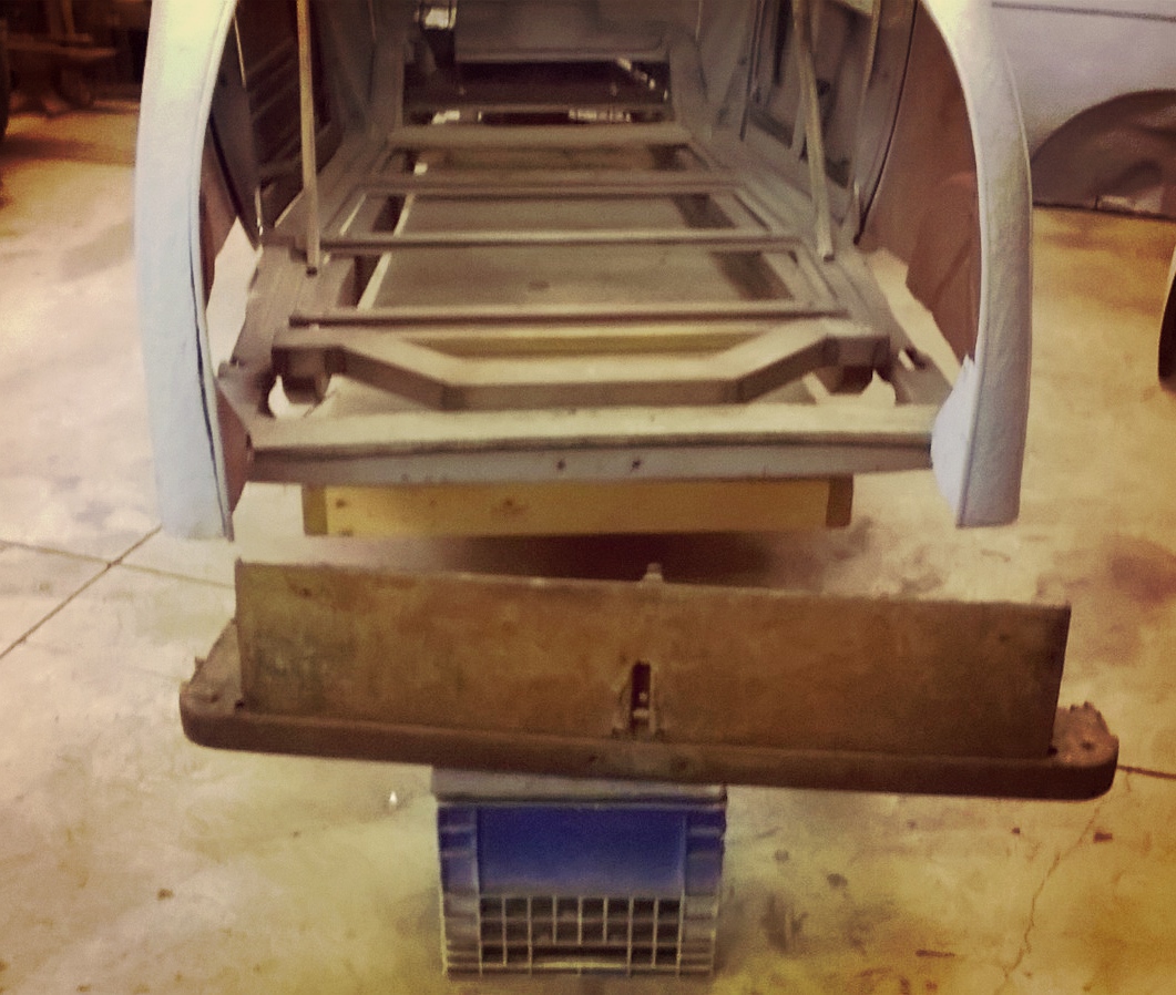

    back.jpg And so it begins... The sedan has been around the shop since 1993 when I bought it for dad for father's day... so, selling it isn't an option. He's just making "improvements"!!! LOL.
    So... anyone care to help with a pattern? Thanks

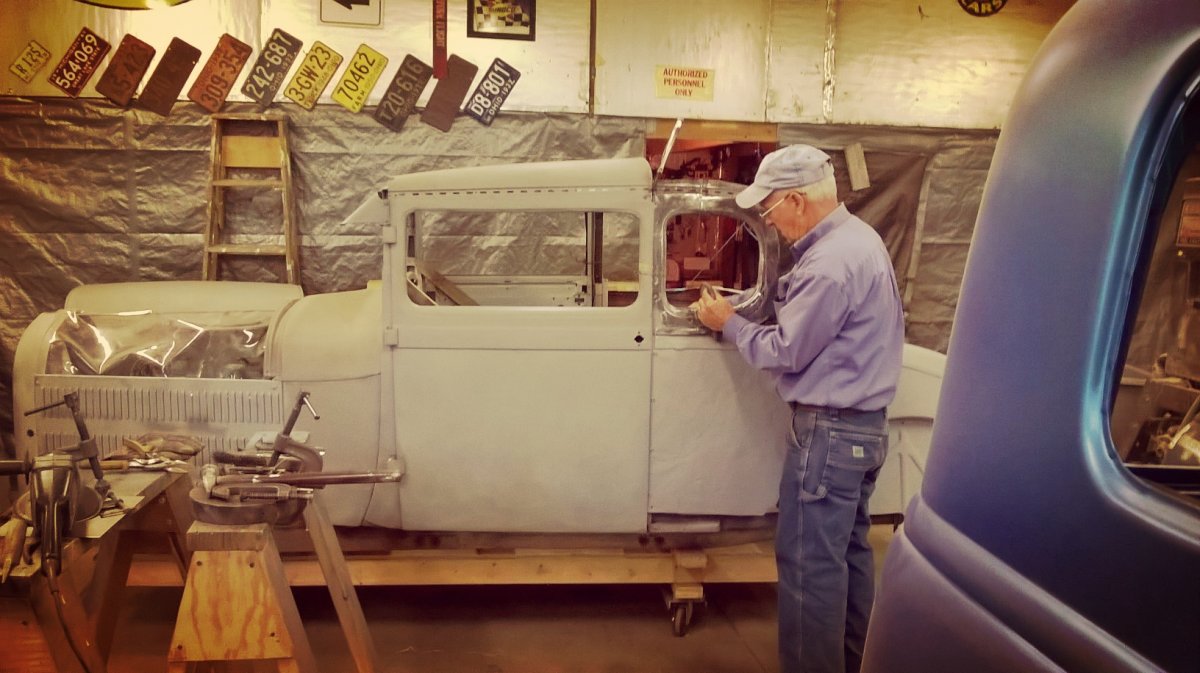

    Progress... Rear quarters that were rough wall hangers for years and a tulip panel from Ebay...

    rough.jpg A picture of the "good" quarter before a day of preliminary hammer and dolly work... Pretty sure they propped up a bulldozer at some point in life!

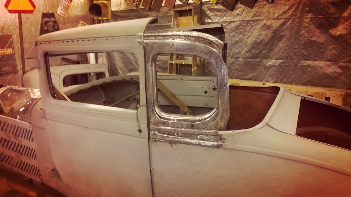

    side.jpg Progress...

    side2.jpg Thank you Ron Funkhouser for a perfect set of patterns!!!! The p***enger side is next... then onto the rear window

    Looks great! I filled in the missing roof sections of a sport coupe using sectioned down Tudor pieces, worked out well, I used a garnish molding for the dimensions and was going to suggest the same to you but looks like you guys got your pattern and are well on your way, good work.

    I ***ume you/dad, made a quarter window "perimeter" from sedan pieces? I've always thought that a chopped A coupe quarter opening looks upside down to me.... meaning the upper rear inside curve and lower rear inside curves look like they should be reversed and used on the opposite side of car.
    If you can't understand how I wrote it, look at a real coupe with a chop, and study the rear upper and lower inside radii.
    Yours looks better to me

    Is the bead below the 1/4 window from the sedan or fabricated?

    It's actually a bit of both!

    Agree with F&J on the quarter window, what you did looks better than stock. Another option would be to stretch the doors and make a phantom three-window, best of luck with your project.

    Dad gets a bit sidetracked camping in the summer... finally was snowed in last week and he had to work on something! :) A little nip & tuck and the old gender confused sedan is starting to look just right!
