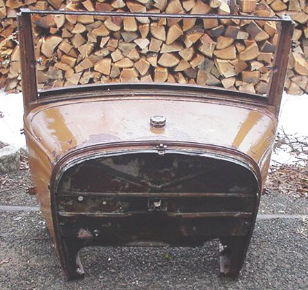

    Here are two different 28-29 4-door cowls. One with the factory cowl vent. They both came with 28-29 Ford Roadster-Coupe-2-Door tanks underneath them. That's why my brother, a Model A restorer, would pick them up 'way under cost. Sedan Cowl copy.jpg

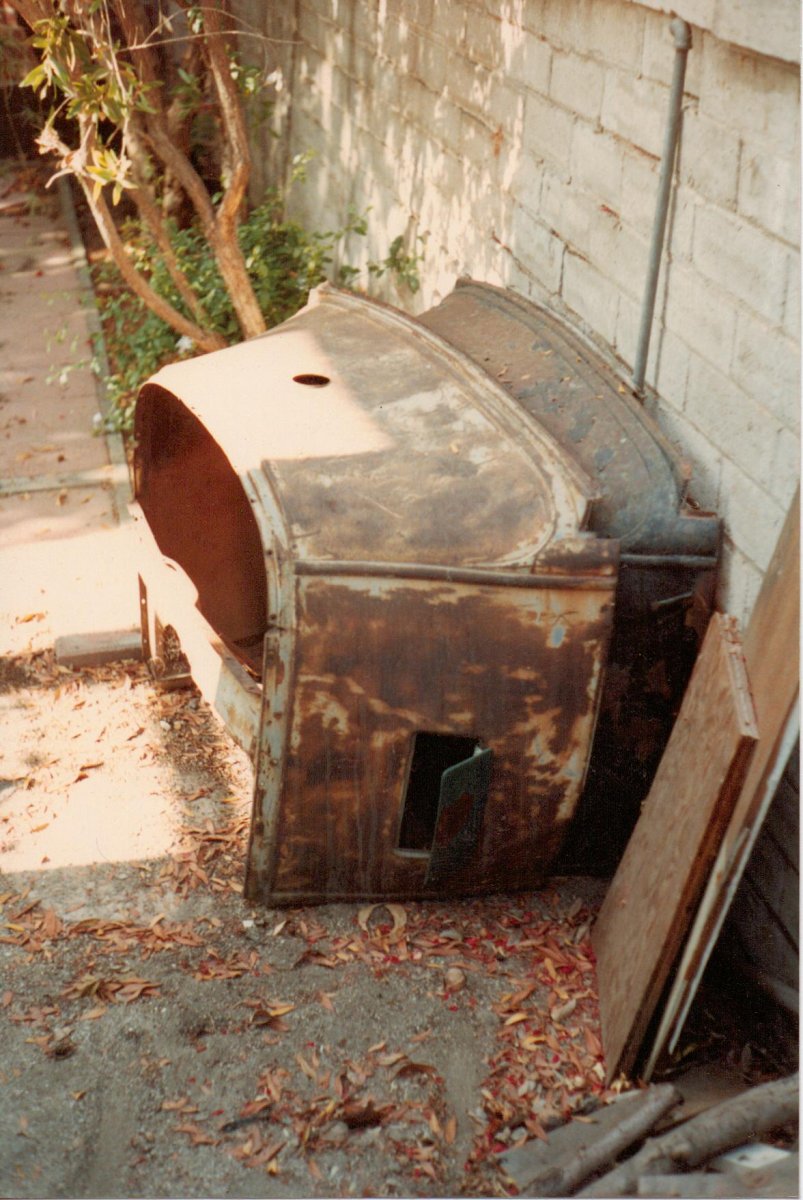

    That's the one I used 25 years ago to build my '28 Mercury Torpedo Salon. You shove the stock tank up and under the cowl and use it for a gas tank. And the hood will use a stock 28-29 radiator and Fordor hood (in this case a Mercury). But the body lines line up with a 30-31 Tudor (in this case the '28 Mercury Torpedo Salon body which is 5 inches less tall). See avatar.
