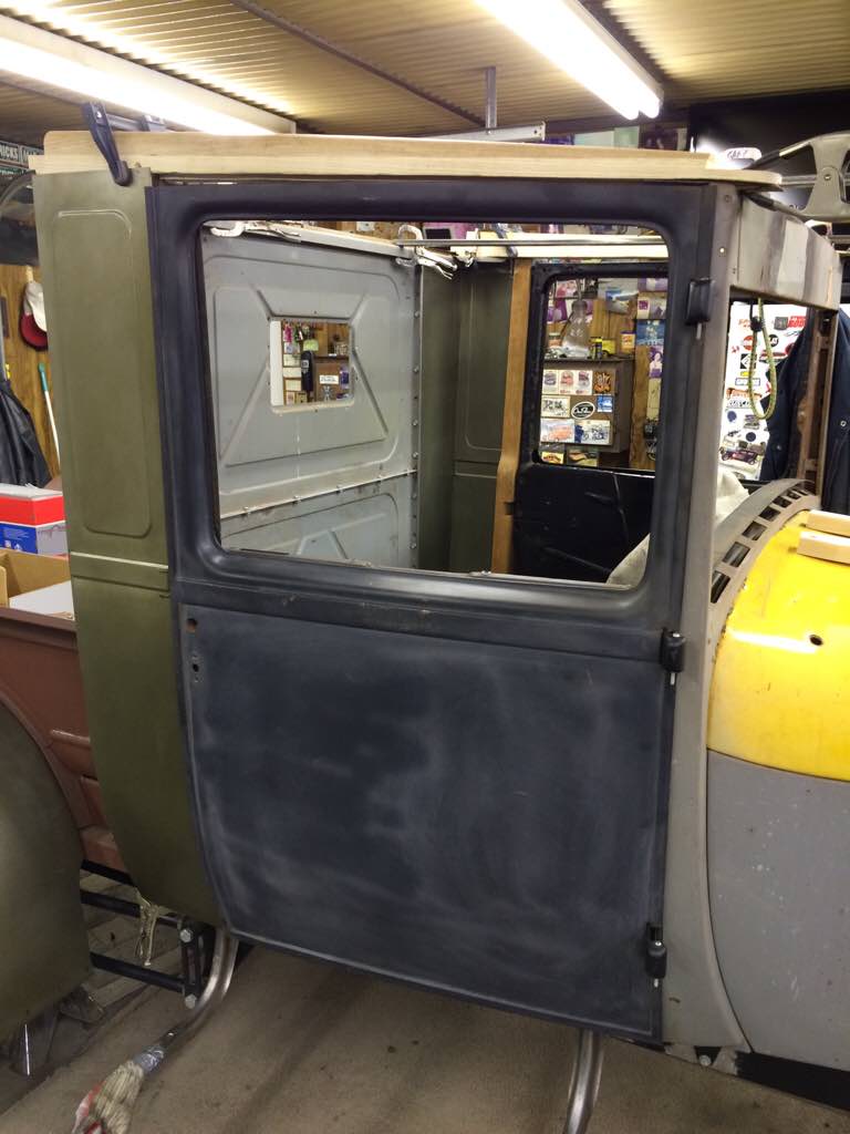

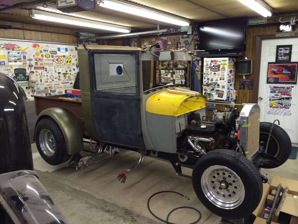

    Trying to square up the cab, doors, roof, etc on my truck project. I have nothing to reference,the cab was all apart when I got it. I bought a roof wood kit. Pics would be great if anyone has some!!?
    - how does the top of the door line up with the roof wood line? Are they perfectly parallel? How large is the gap?
    - what does the drip rail look like? Does everyone typically use it or remove it? Do you use a hidum around it instead? I want to use hartz cloth type material on it.
    Never done a truck this year, so it's tough trying to figure out what you need or how it goes, especially when I got it in pieces and didn't take any of it apart!
    Thanks for any help or advice you can offer!
    -Gary

    I made my own wood but I think its normal to have a 1/4" to 3/8" gap at the door tops. Just get your belt line even and doors closing easy and it should be good. I used the aluminum drip rail but I have seen the hidem strip used all the way around and looked ok.

    those wood kits suck,, use your own efforts, just cut grind, make it look good to the eye,, you gotta great looking truck. BTW, there are several really informative Model A restoration books available..

    I can line it all up what ever works best, but the door gap at the top, front to back has an angle, I think it should be parallel? So right now I either have to raise the cowl up or lower the roof wood down.
