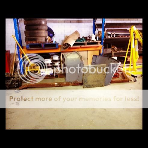

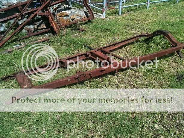

    Ok I think I have enough parts to start a build thread
    Last month or 2 I've been collecting parts to build my first rod. The aim is to make it as simple/quick/painless (unlikely) as possible.
    I've spent a bit of time researching what I want to build.
    The basic summary is:
    A ch***is, '40 ford front axle and split bones, BW rear on 4 bar and trans leaf, front half of a tourer body, possibly y-block and 4 speed.
    I have the 4 bar/front spring/various brackets etc. on their way from speedway motors.
    I'm running deitz headlights and 32-36 tails. Bomber seats with padded bases, ammo case glove box and probably a luggage chest on the back to hold a fuel tank, battery, tool kit.
    Here is my some what collection of parts so far:

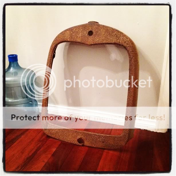

    Grill shell:
    Somewhat cleaned shell, few cracks to weld, not much:
    early days mock up

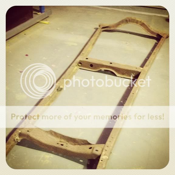

    Gutted the ch***is last night and scored some hoops for cheap, just need to find some cheap rims to fit them in.
    Installed the racing seat:
    Hopfefully the body/axle/rear end parts arrive soon and the ball can roll faster
    -Owen-

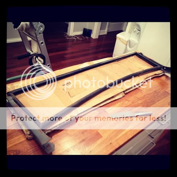

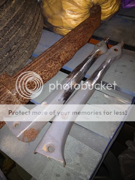

    I scored a 2" chopped shield frame and posts from the very helpful Striper (pete) which I gave a quick flap wheel to tidy them up for now.

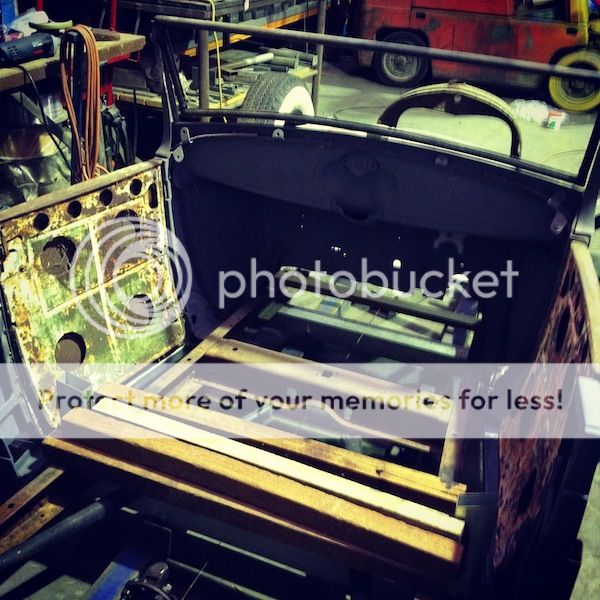

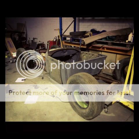

    channeled what was left of the cowl over the ch***is and did another mock up.
    fairly well pleased with how it all looks so far (albeit only the beginning)
    I'm going to half the length of the horns to get the axle fairly close to the cross member because I don't want the car looking too long, I will probably cut about 6" out of the length at the back too because I want to run the diff behind the cross member.
    I've knocked up a rough sketch of kind of where I'm headed ch***is-wise (depending on the tac response)
    i've drawn it up with a 10" kick up at the rear and 2" sweep up front, at the moment ride height is set to 5" however i'm not sure what others are running, I might lift it up a bit.
    pretty fond of this car aesthetically so might copy the paint finish somewhat (minus the red wheels)
    -Owen-

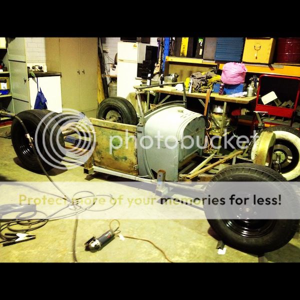

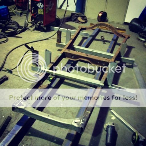

    bit of movement at the station, got the front kick up done and tacked together, 4" in the end.
    I pushed/man handled the diff into place, the frame is going to need a 13" kick up at the back to give me 4" of travel.
    The nail motor mounts will be where the frame levels off again forward of the kick up.
    I currently have 670's on the front but I'm going to order some 640 firestones.
    With the new tyres and a modified front spring everything should sit at the right height.
    the rears will be 820's, I have 9.15 on at the moment which are pretty close to the same OD.
    whacked the body parts on just to see how everything goes, I'm going to have to move the cowl back about 6" from stock to clear the nail - I might just push it into the firewall though to keep things looking very short...
    put some timber down to sort out the seating position, wheel base and track turned out pretty well.
    hopefully the ladder bars don't hit me in the **** while I'm driving.
    I threw on my spare half grill surround to see what it will look like, going to need a pretty short radiator..

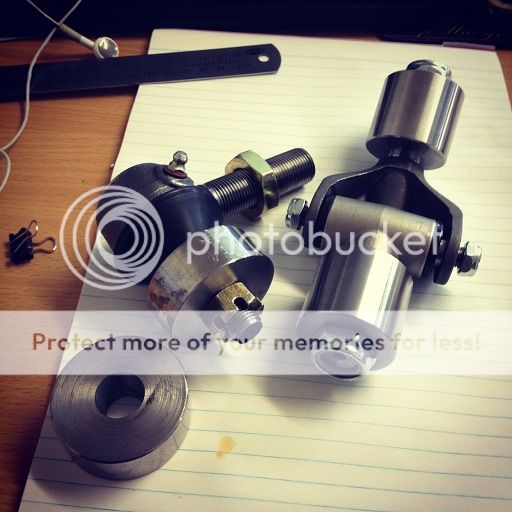

    one of the machinists at work was kind enough to machine up some weld in's for me as well as machining down my steering arms to clear the axle.
    the swivel perch heads (one dead one live) will have their bungs welded into the split bones and the socal tie rod bungs will be welded into the ch***is.
    -Owen-

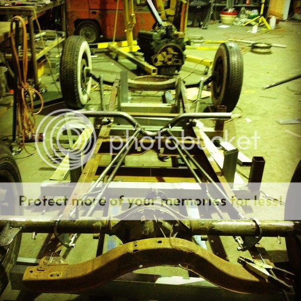

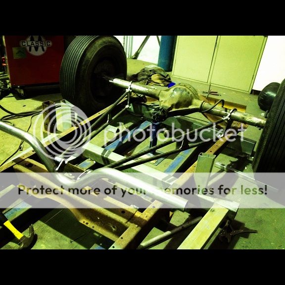

    Ended up crumbling for some ladder bars, managed to get them on the diff last night, will finish up on saturday and hopefully build a k frame around them. They are the long socal ones, the tube cross member lines up where the original cross member is (now was after the photo).
    I had to re-adjust my spring brackets as the perch ctrs weren't wide enough (must have rushed the first time), had to run the gussets on the inside to avoid the hand brake lever.
    Have been working on some mini horns for the front to sit above the axle, should have them all done tomorrow too.
