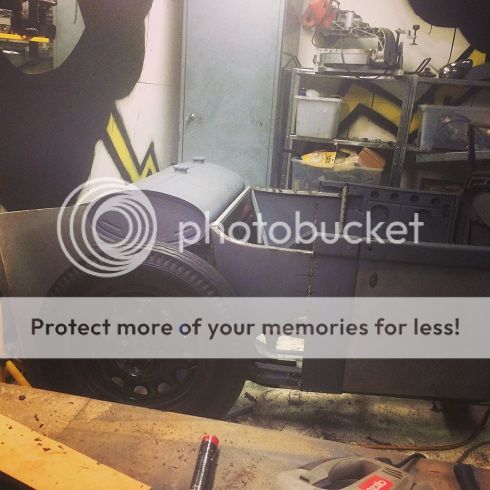

    Been a while since I checked in Owen. Looking good. I was a little concerned by this pic. Looks like you have very little clearance between your frame horns and axle. Might be OK if it really does sit there when everything settles but I know mine sunk a good inch or more than I had planned.
    By the way you have that tank mounted the wrong way. The "auxilliary" tank goes on the left ;)
    Pete
  3. Lamb
    Joined: Jan 20, 2010
    Posts: 87
    Lamb
    Hey Pete, there is 4" or more between the horn cut out and the axle, I'm thinking I'll have to sort out a spring for the front so ride height is as per the mock up.
    Thanks for the info on the tank, it's just sitting on some patio tube currently to see how it fits in.
