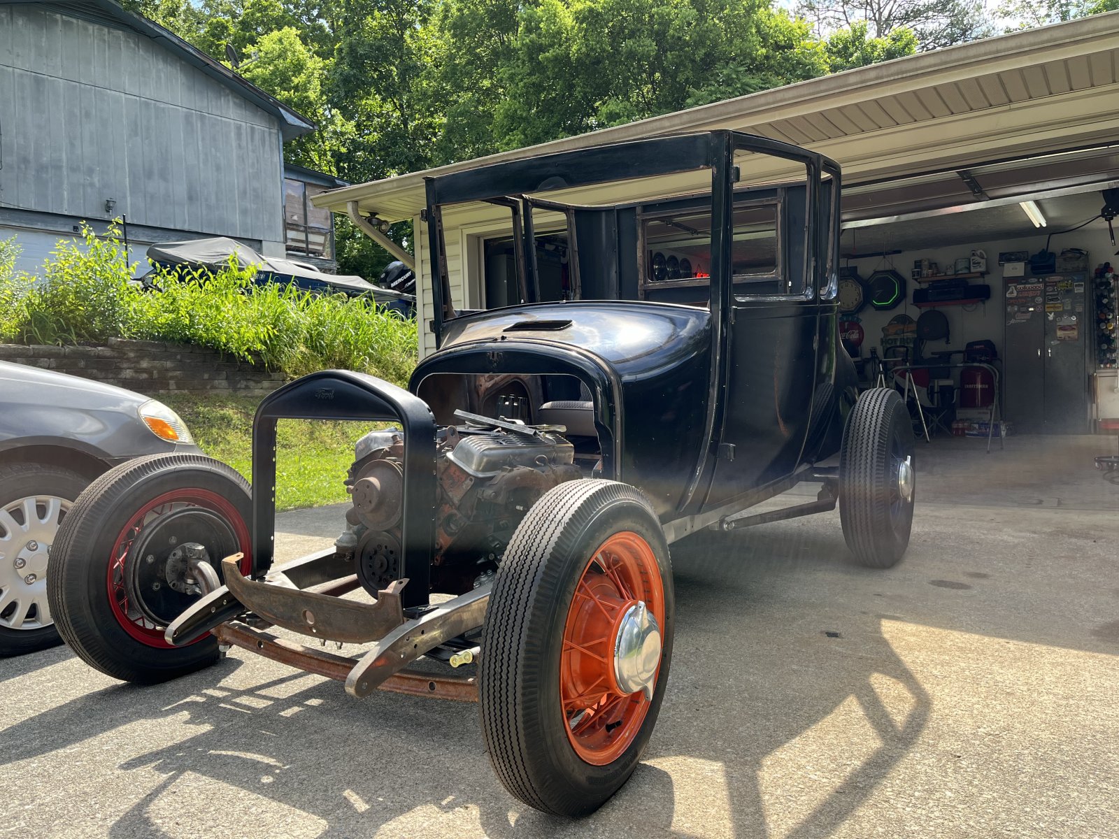

    Below are some cars I feel got the height "right" in my mind. Their rads/engines are different of course. Maybe up close they aren't perfect but from what I see they appear lower than stock.

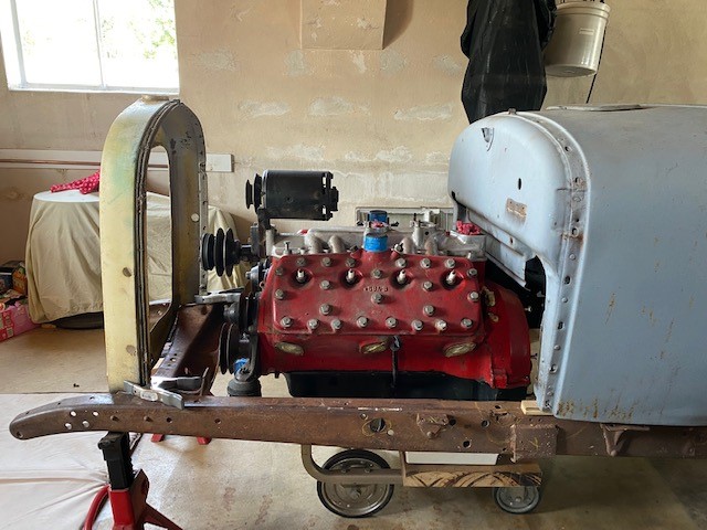

    Below are two pics of the mock up right now with the rad shell just sitting on the frame. Stock height I think is up 1/4"-1/2" from there. 2nd picture you can see how the shell is higher than the body. Body is shimmed 3/4".

    I would set the body on the frame (no blocks), trim the sides of the radiator shell to get the height you want then have the radiator made to fit.

    Thanks! Good advice, then tweak things with body blocks afterwards? My only concern is if I reduce the height of rad and drop the shell only, I will create a visible gap between the bottom of the rad and the shell. Rad is smaller and the shell is same size but lower.

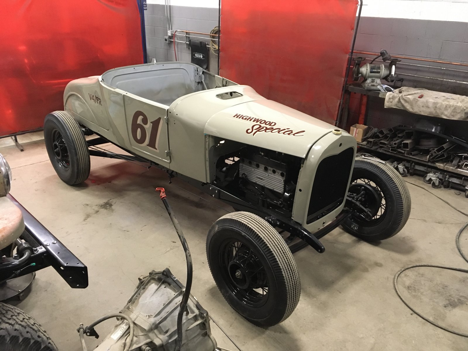

  17. Spocker
    Joined: Oct 21, 2016
    Posts: 5
    Spocker
    The T in your first picture (61 car) has a custom rad and I chopped a little off the bottom of the shell. It runs a hood too , and it lines up properly
    Tman and Fisher400 like this.

  19. Fisher400
    Joined: Jan 27, 2020
    Posts: 181
    Fisher400
    Thank you for sharing what you did to the car. Hope you don’t mind me referencing your car. It’s one I keep for reference/inspiration ;)
