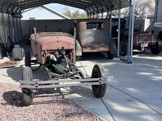

    Figured I'd do a build thread on my second build while I travel for work and guys saying theres not enough build threads. First build was a model a phaeton and now I'm building a little 28 pickup. IMG_8552.jpg
    Picked up the pickup with my pickup at the Long Beach Model T swap. Glad it fit lol
    I then put it on the side of my house for about two years so I didnt get sidetracked with my phaeton build. Anyone know of a Max's harness shop? Its got a faint patina lettering, wondering if anyone knows what it was or familiar with it?

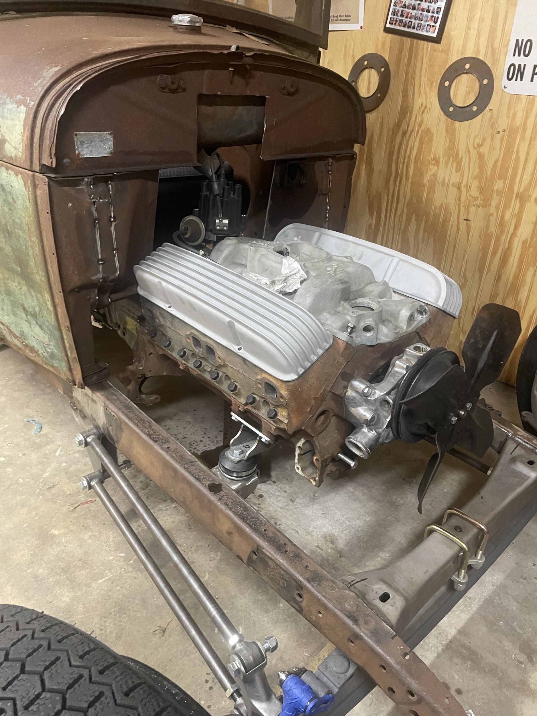

    Got the frame back to my garage and started setting up the motor into position. IMG_8514.jpg
    Went with a champion 3 row radiator and a ford falcon fan.
    Then setup the rest of the suspension. Went with the Cl***ic Street rod MFG four bar setup with aldan coil overs in the rear so itll drive nice.
    Also got the trans mount all setup in there. Its a speedway bolt on deal that I just welded to some 2x4 steel tubing and clearanced the tubing for my tailshaft and driveshaft.

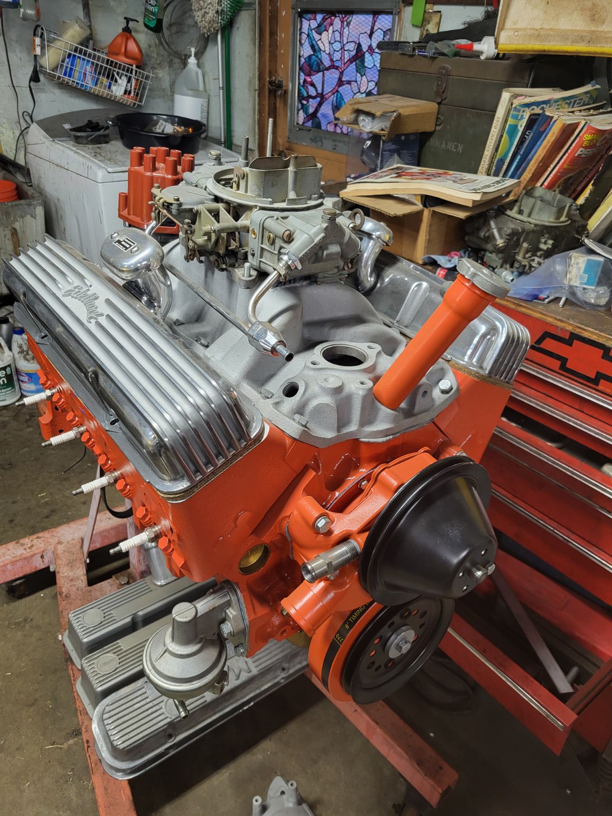

    IMG_20250312_194025.jpg The start of the frame build:cool:
