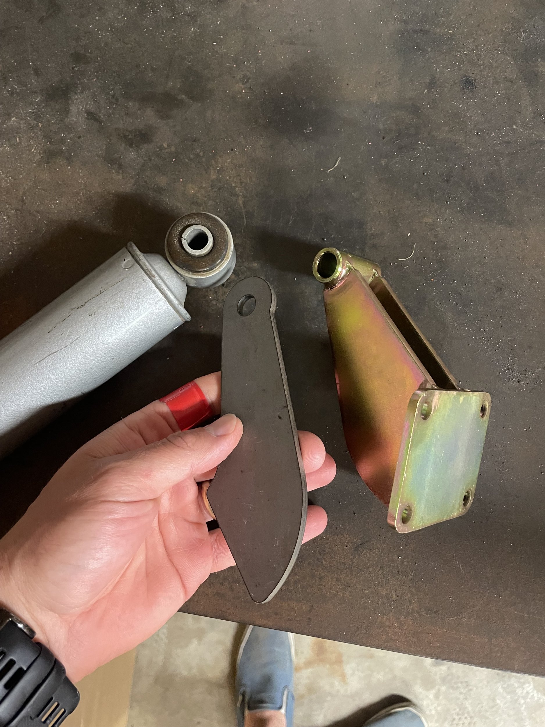

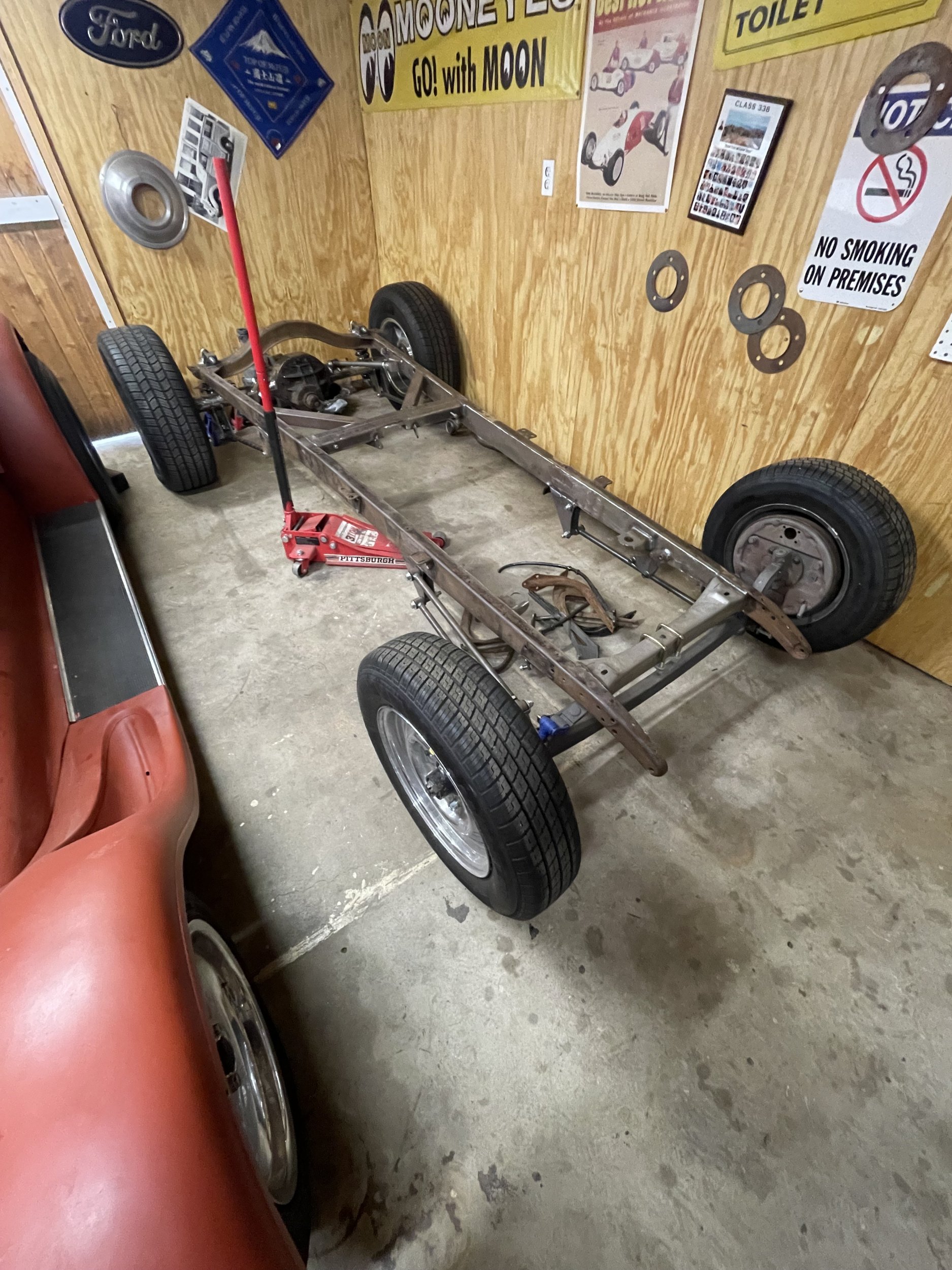

    IMG_0145.jpeg IMG_0147.jpeg IMG_0146.jpeg Not much to report. Finish welded the ch***is minus the front shock mounts. Gonna use the roadster supply ones and weld a bung between them and then run them like the speedway zinc ones. Returning the speedway zinc ones cause theyre a 1/2" dia and I need a 7/16".
    Not pictured, finish welded the exhaust pipes.

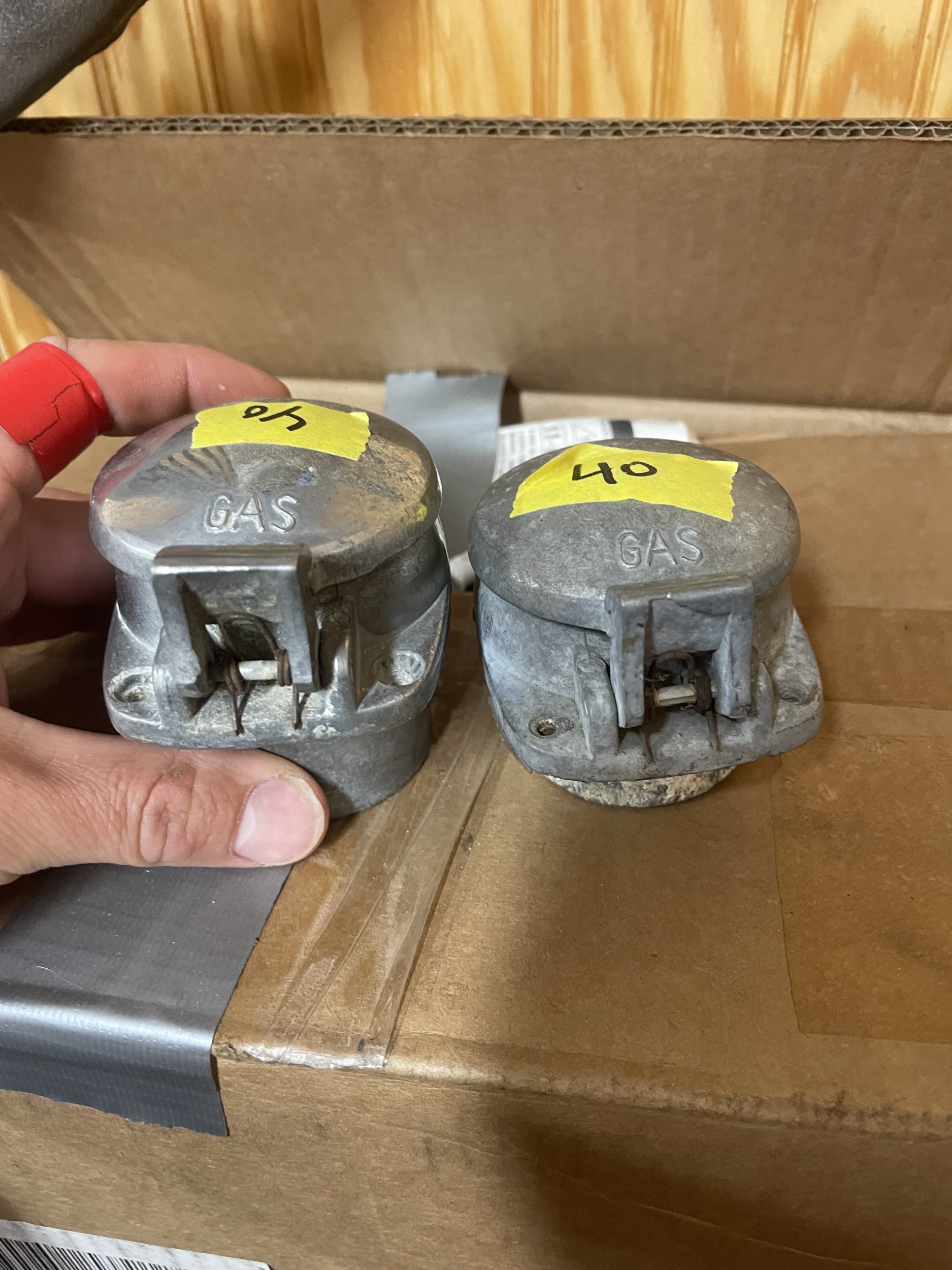

    Next im gonna play with fitting the fenders and getting the tanks put on. I got these cool gas caps from my friend George at a local swap. I'm gonna try to fit them up into the aprons. Once I figure out the fenders and tanks, next step is ch***is paint.

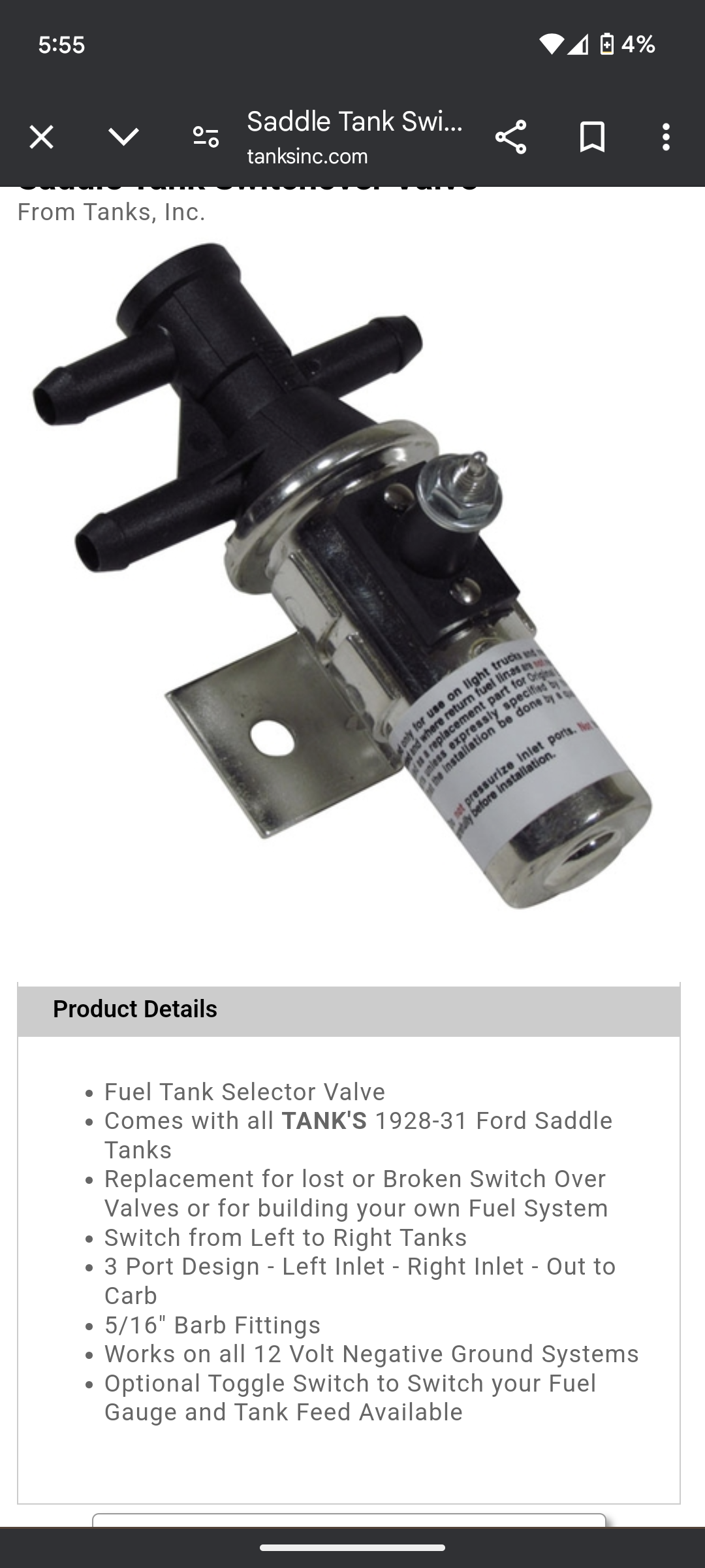

    Anyone familiar with how the tankz saddle tanks work? They seem to have an extra hole on them, which I'm ***uming is to run a pipe between the two? The directions I received are pretty terrible lol

    You should have this and a toggle switch to operate it. https://www.tanksinc.com/index.cfm/...duct_id=93/category_id=-1/mode=prod/prd93.htm
    A guy I used to travel with long-distance to shows had them on his A Tudor he built into a tub. He hated them. All the rest of us would pull up to a pump, fill, and be done. He would need to fill on both sides and it was slow. He said he'd never use them again on another A. Just food for thought. They're a good idea in terms of space saving, but if you ever need to service them you need to pull the splash pans, meaning raise the body. Big job.

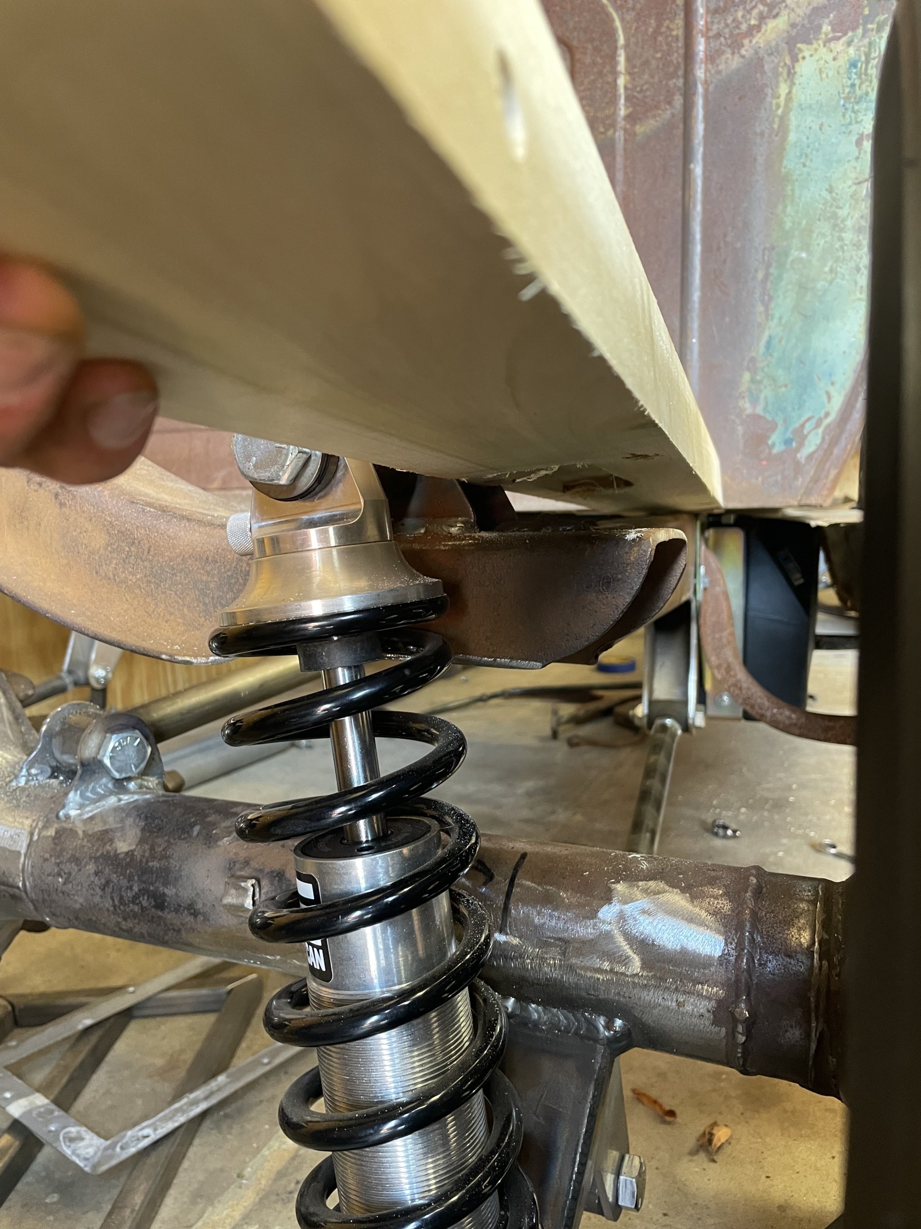

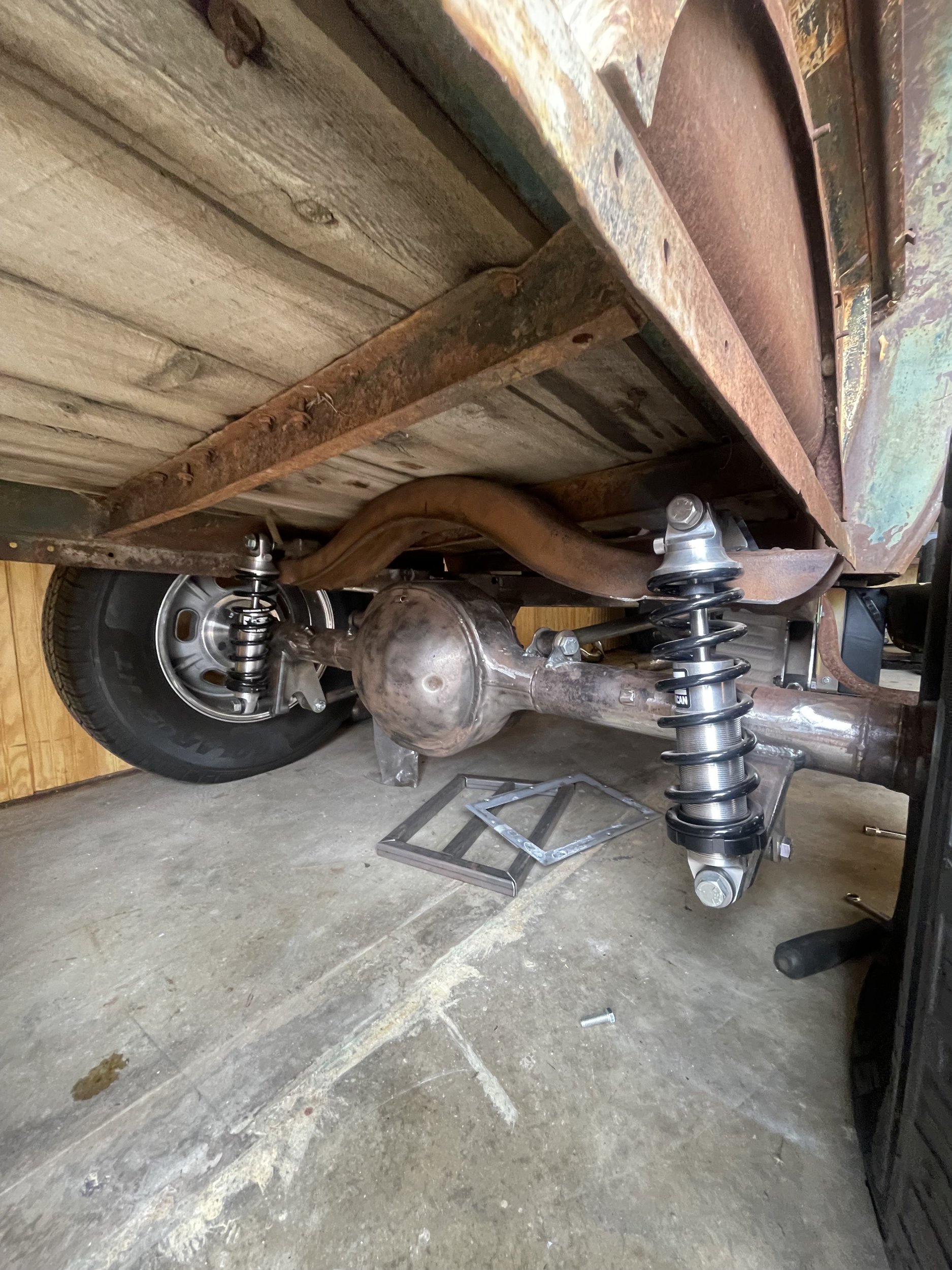

    Playing with body blocks and the bed. Think I either need to modify the blocks or modify the coil over mounts. Thinking I'll just mod the blocks though as that seems to be the easiest solution.

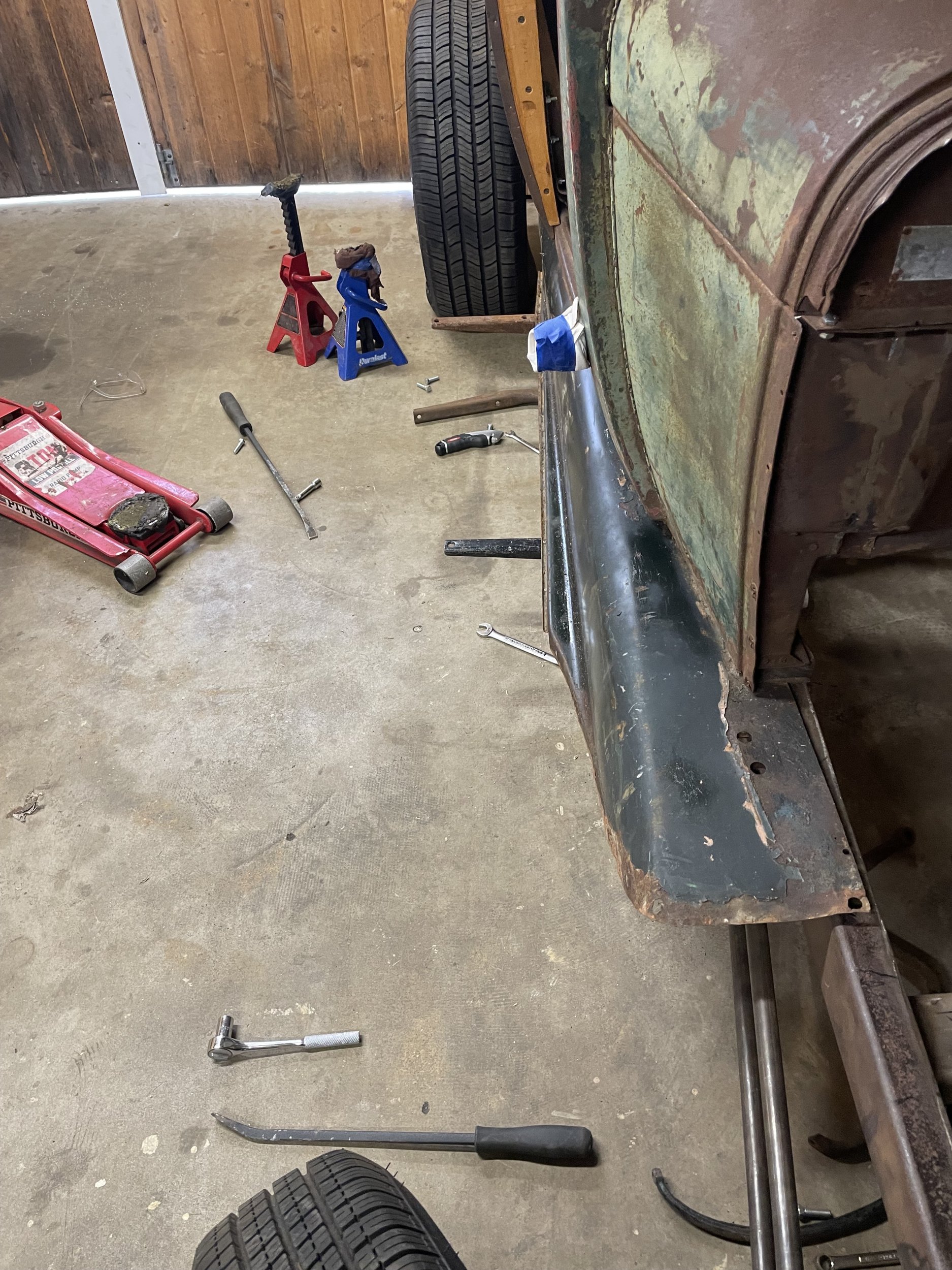

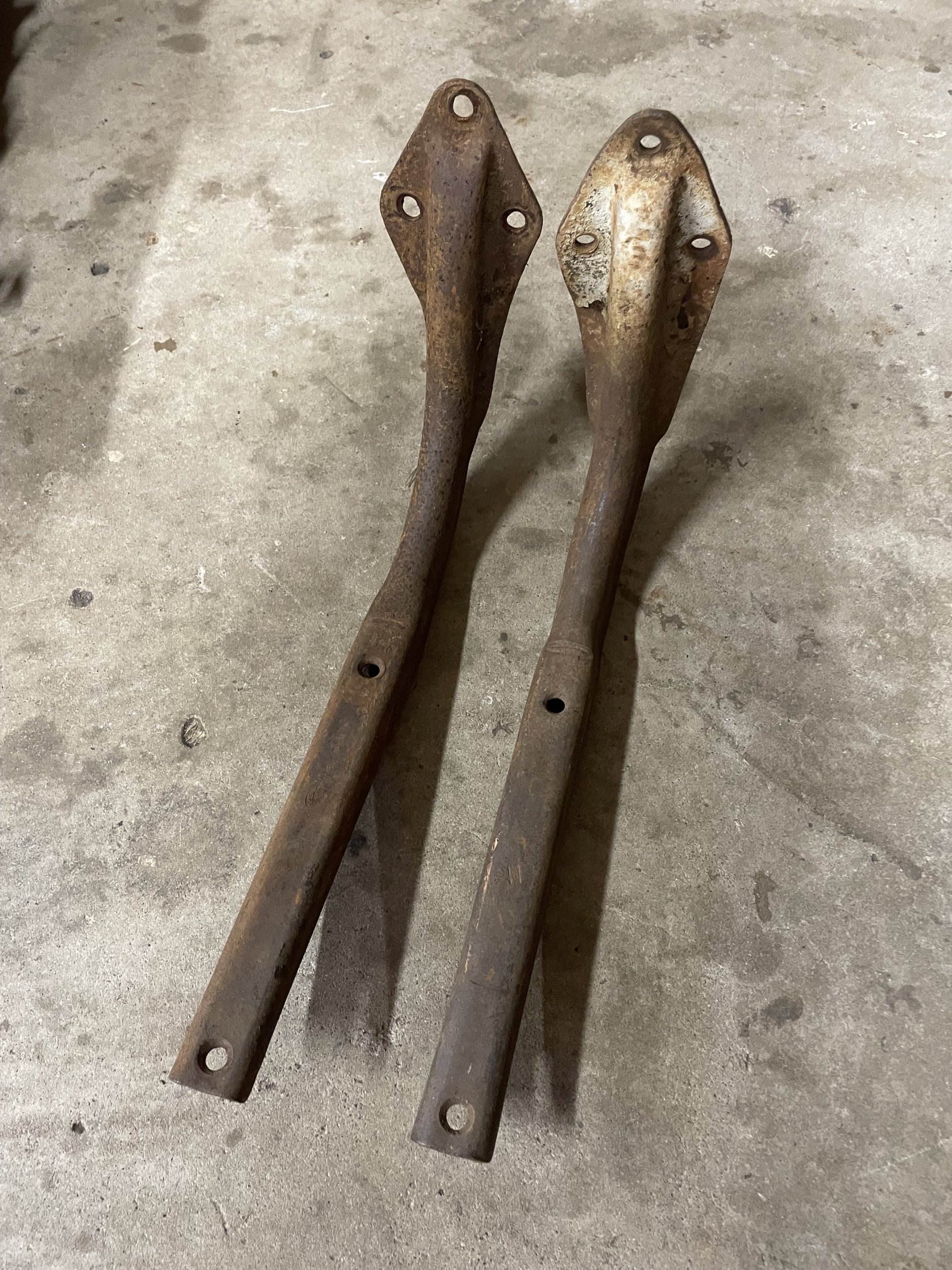

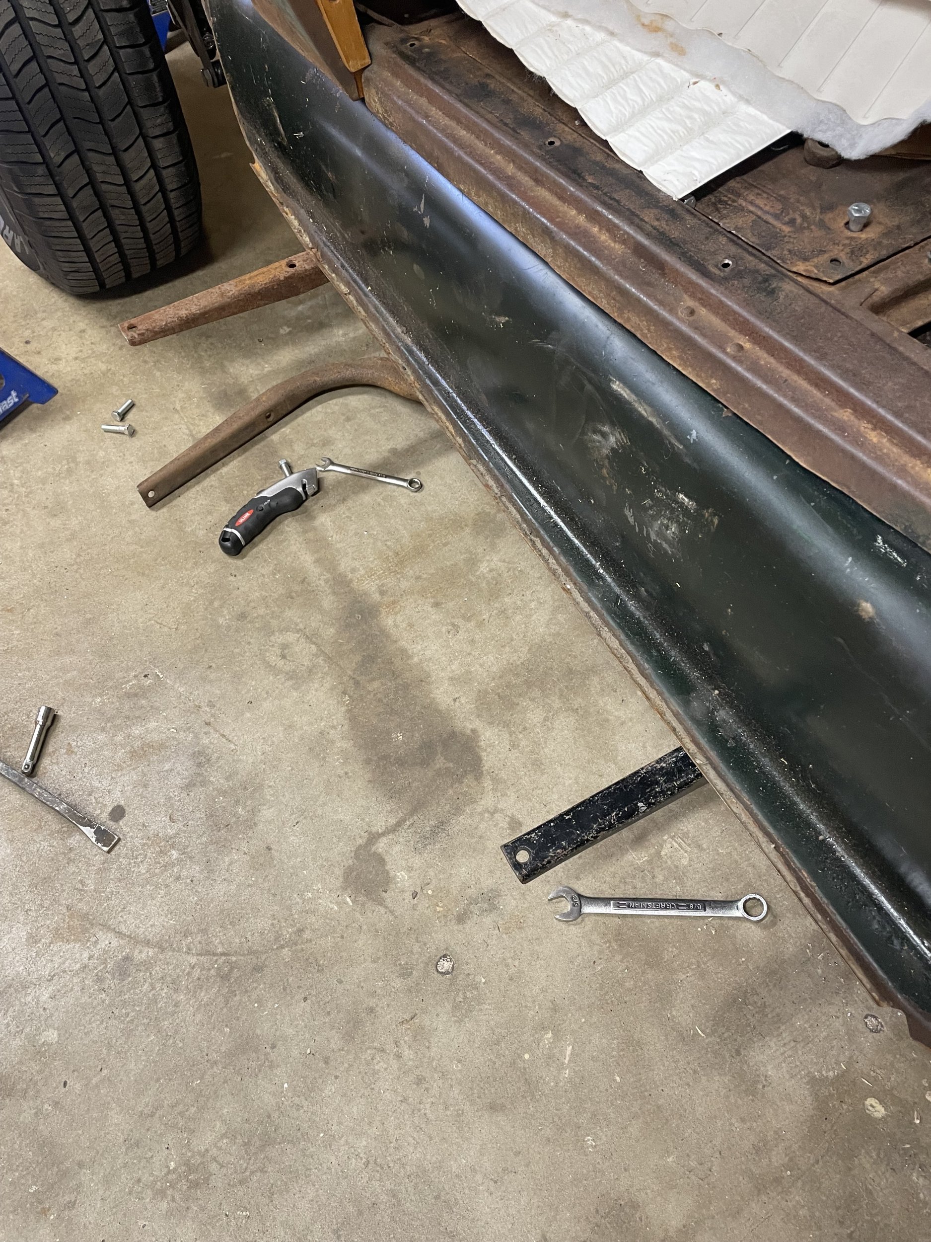

    Also it appears my running board brackets are all the same? Is that how they were or are they different from right to left and front to back? The back p*** side looks right, but the front p*** side looks very off.
  18. Weedburner 40
    Joined: Jan 26, 2006
    Posts: 1,225
    Weedburner 40
    The two front running board brackets are longer, otherwise they are the same side to side if I remember correctly.
