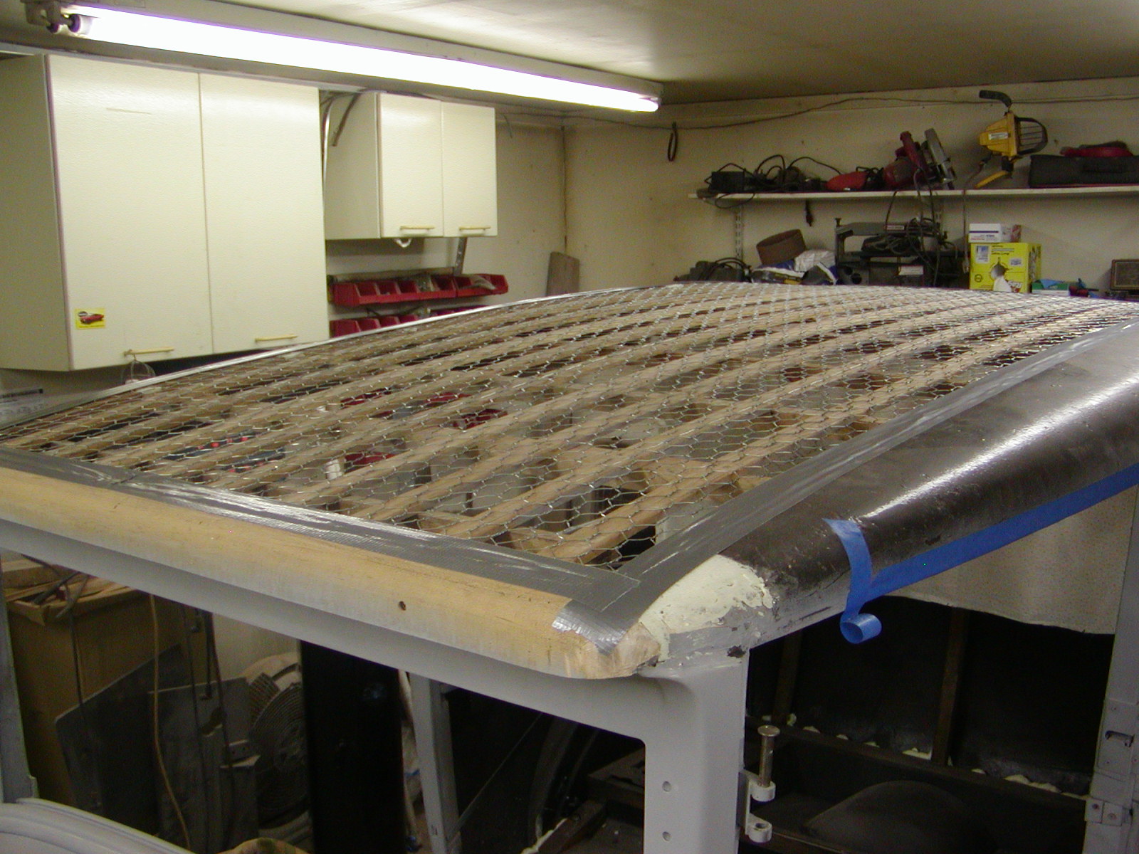

    Getting ready to do my top for the 28 and have some uneven places that will be under the padding and material. Basically a couple places where the wood doesn't quite match. I would like to fill them with something to make a smoother surface but what?
    I don't think putty is a good idea. How about spray foam insulation. Could shape it when done.
    Any other products out there you can think of?
    Thanks!
    Jim

    Spray foam is a good choice. I used it on a 29 Plymouth and then had box liner sprayed over it in place of the fabric. Not quite the same texture, but looks good. If you use foam be sure to use 2lb foam. Definitely not 1/2 lb, it's way too soft.

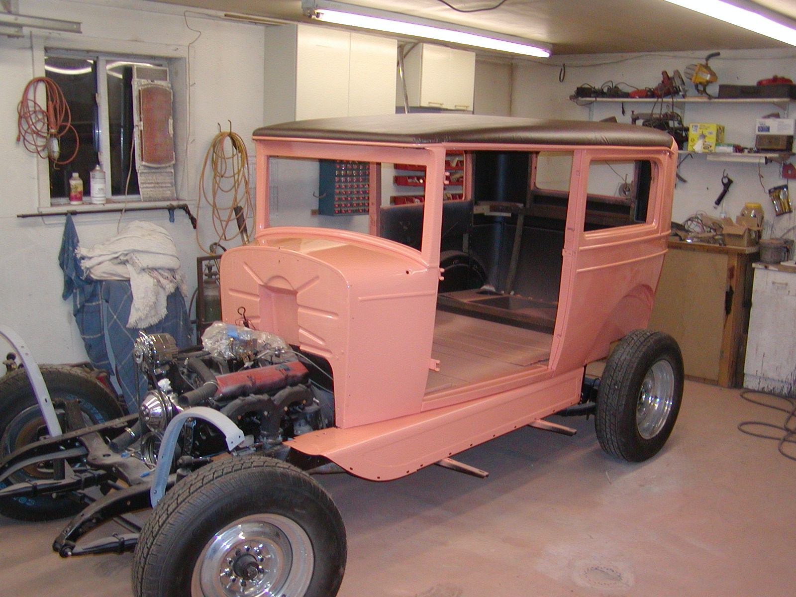

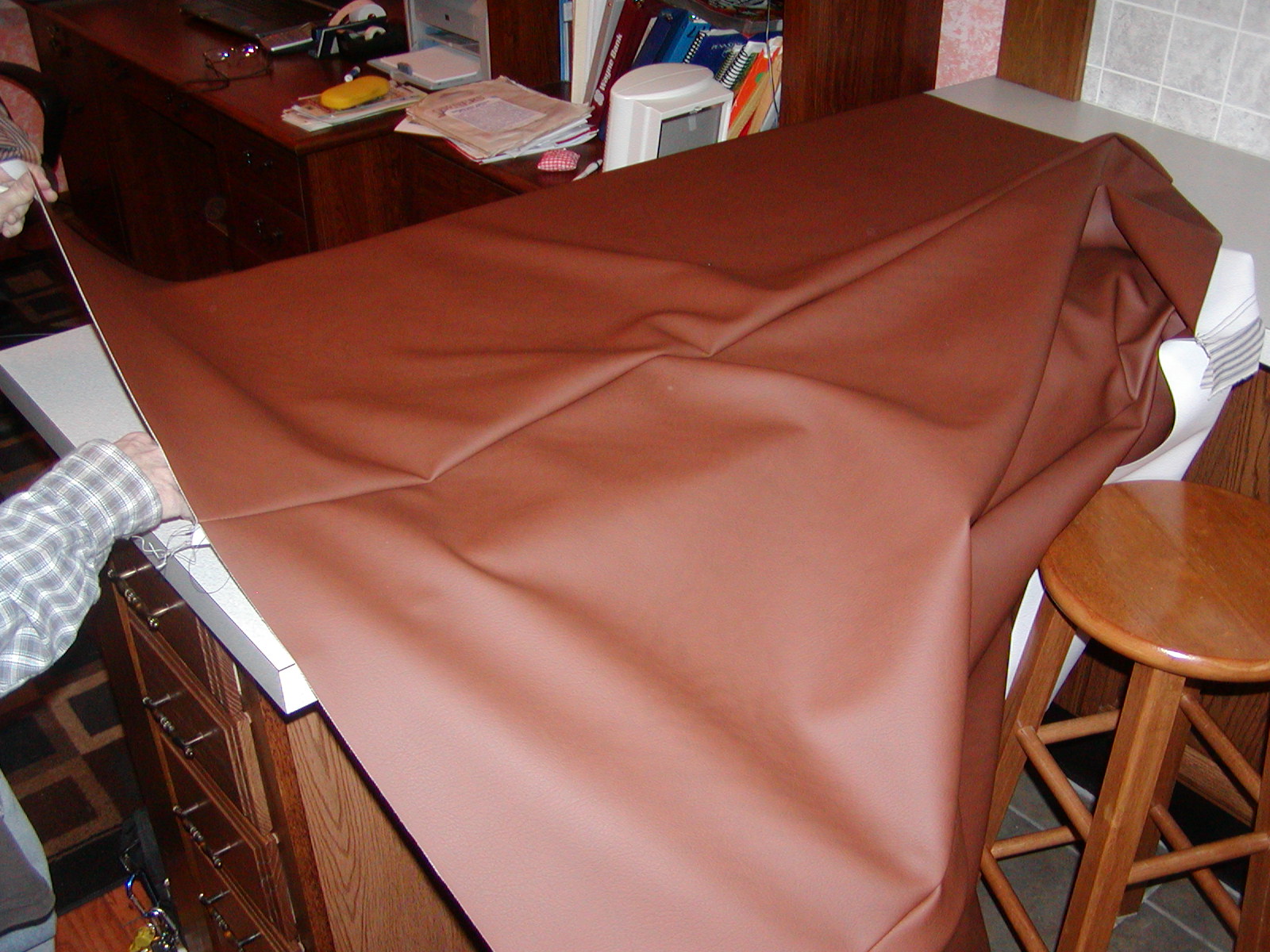

    Here are a couple of picts. Going pretty good. just a couple of wrinkles I can live with. Gonna try to finish up with trim and such tomorrow.
    Jim

    I can't tell from the pictures but did you use any padding?
  9. 28 chevy
    Joined: Mar 5, 2006
    Posts: 512
    28 chevy
    from NE Pa
    Just the chicken wire and the foam
  10. JeffreyPhipps
    Joined: Jul 25, 2005
    Posts: 33
    JeffreyPhipps
    Ha, I see now. You can use a hair drier to soften the vinyl a little before you tack it down. Just be careful not to burn it.

    Those wrinkles are workable.

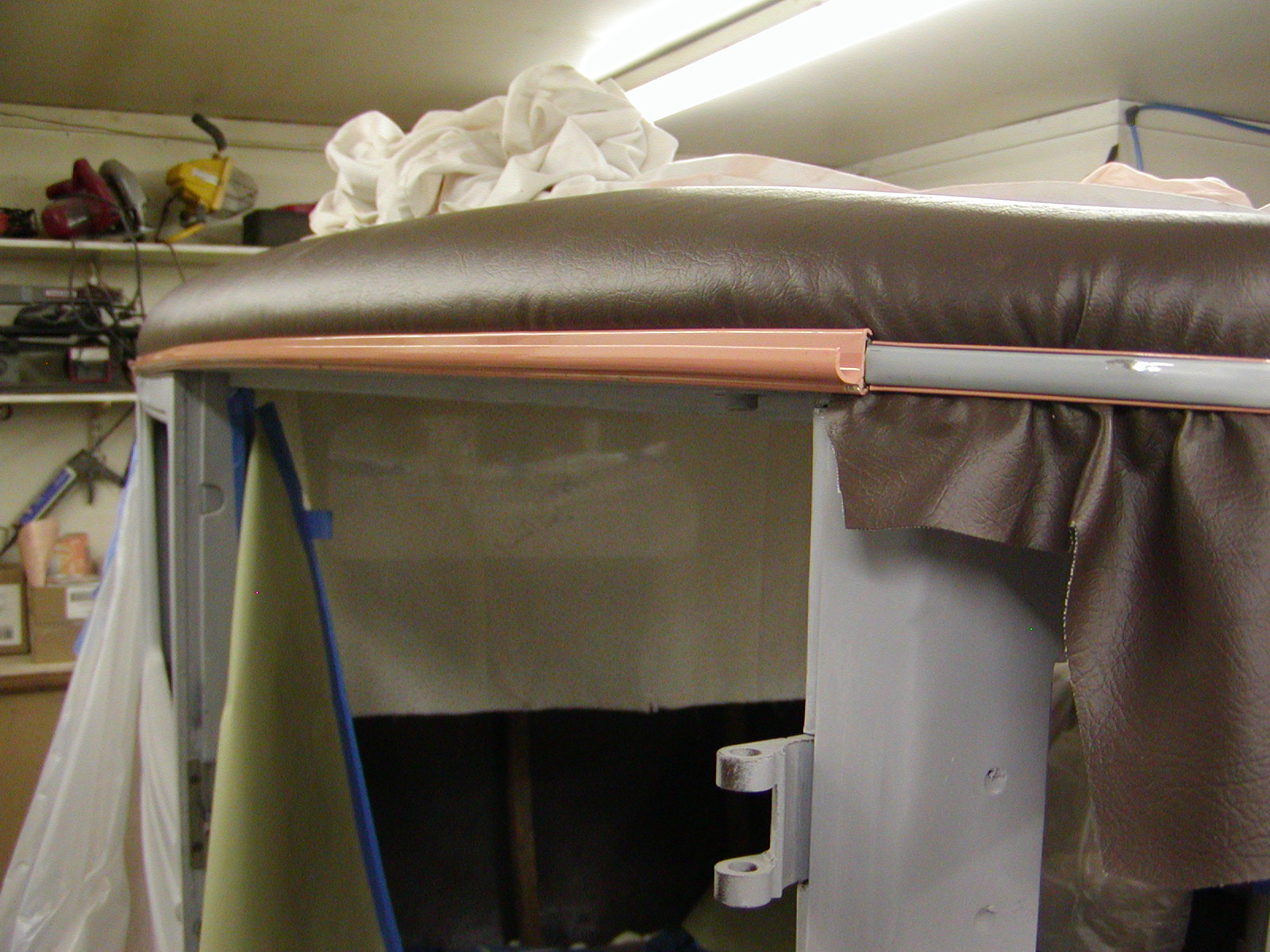

    One more thing. You may be getting wrinkles because the padding is thick on the sides. If you sand it down the wrinkles might smooth out.
  14. 28 chevy
    Joined: Mar 5, 2006
    Posts: 512
    28 chevy
    from NE Pa
    I thought probably. We've been working them but no luck. They are worse in the corners. I guess that's the only place we tried the hair drier. Will try to finish tomorrow.
    j
  15. JeffreyPhipps
    Posts: 33
    JeffreyPhipps
    And one more thing. Did you put anything between the chicken wire and the foam? If not, the chicken wire could begin to cut into the foam and really start to look bad.
  16. JeffreyPhipps
    Posts: 33
    JeffreyPhipps
    The tonneau material really doesn't stretch. It's not supposed to. I looked at the pictures again and I think the thickness of the foam is your trouble. It looks like the material is going out then back in to the moulding.
  17. 28 chevy
    Joined: Mar 5, 2006
    Posts: 512
    28 chevy
    from NE Pa
    The foam is 1/4 inch (described that way but really is a little thicker). Are you talking too much foam from the top down to the trim or just in the corners.
    Thought about the wire-foam situation too late. All is glued down now so will prob take my chances.
    Really not trying to stretch it, just trying to make tight.
    j
  18. JeffreyPhipps
    Posts: 33
    JeffreyPhipps
    When the vinyl lays over the sides, it looks like you have to push it in towards the car to put on the trim. When the moulding is off, the vinyl should be laying real close to the body on the sides at the moulding.
  19. 28 chevy
    Joined: Mar 5, 2006
    Posts: 512
    28 chevy
    from NE Pa
    OK I get what you mean. Will survey the situation tomorrow. May change it if we can.
    Thanks for spending time helping me out!

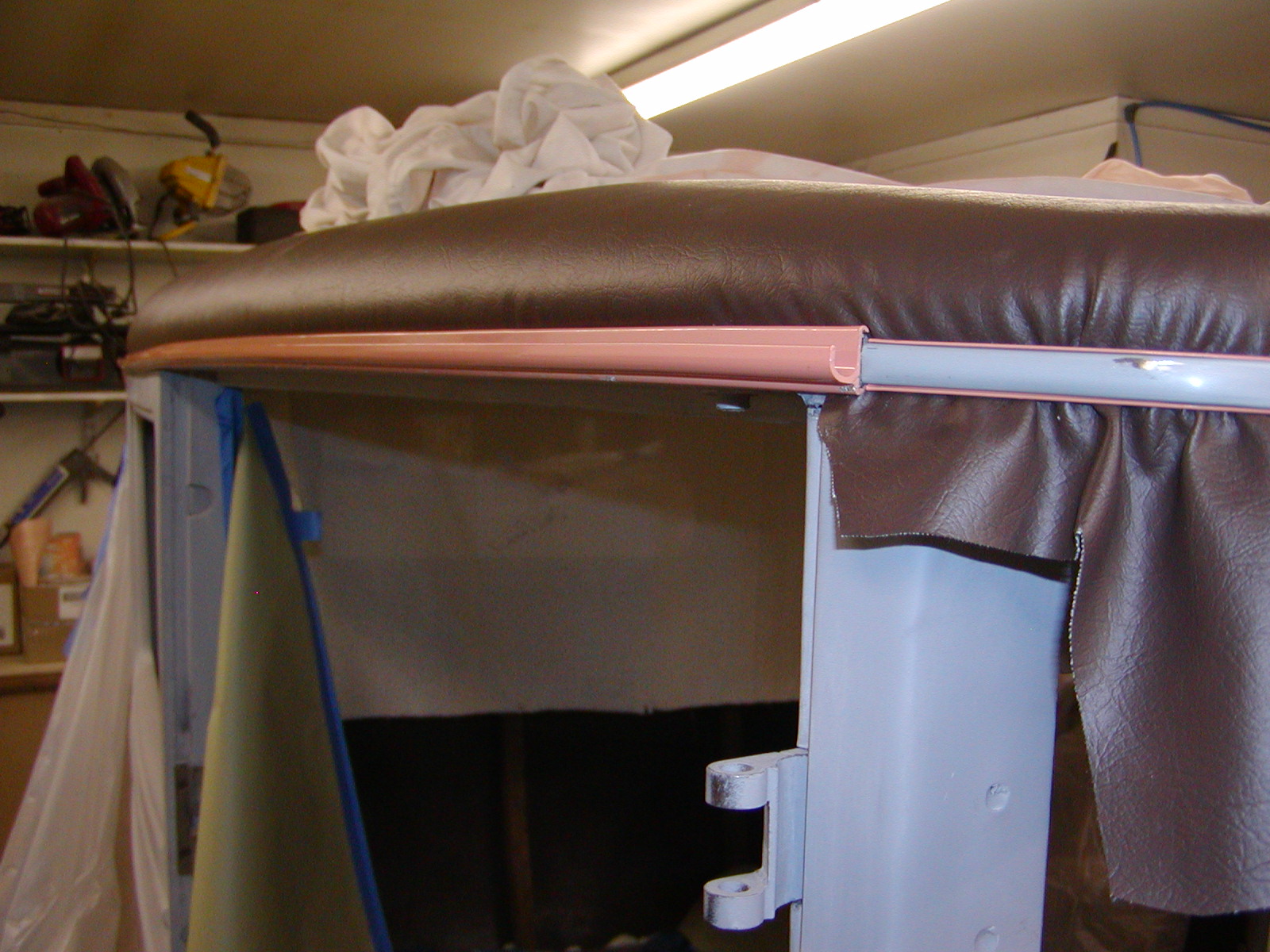

    Did the trim and the visor today.

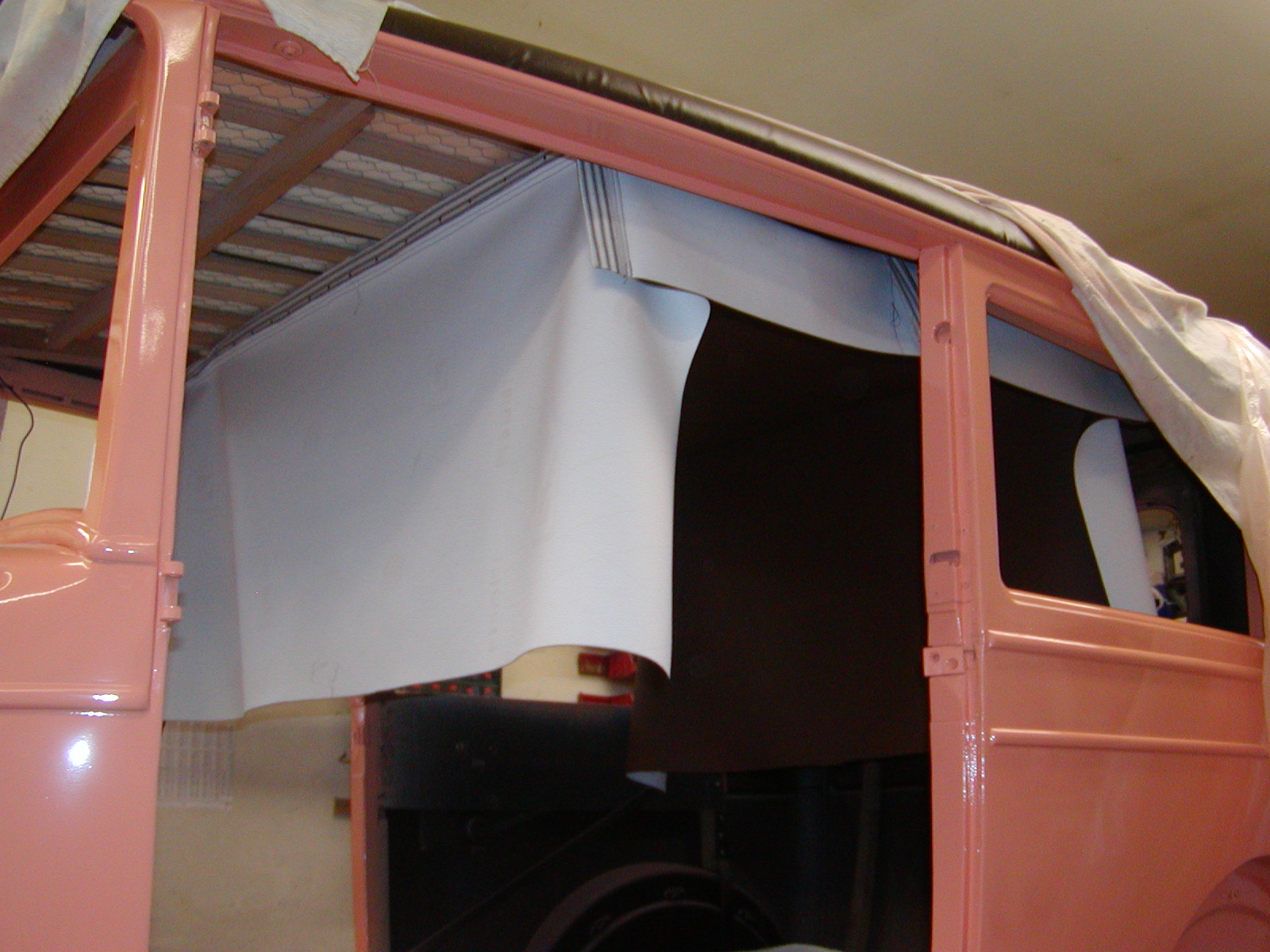

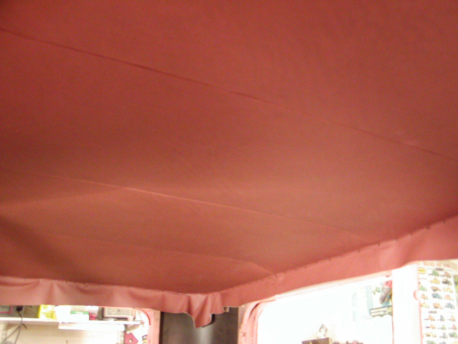

    So my wife got the headliner sewn and we put it in the other day. It is one thing on this car that actually worked the way it was supposed to.

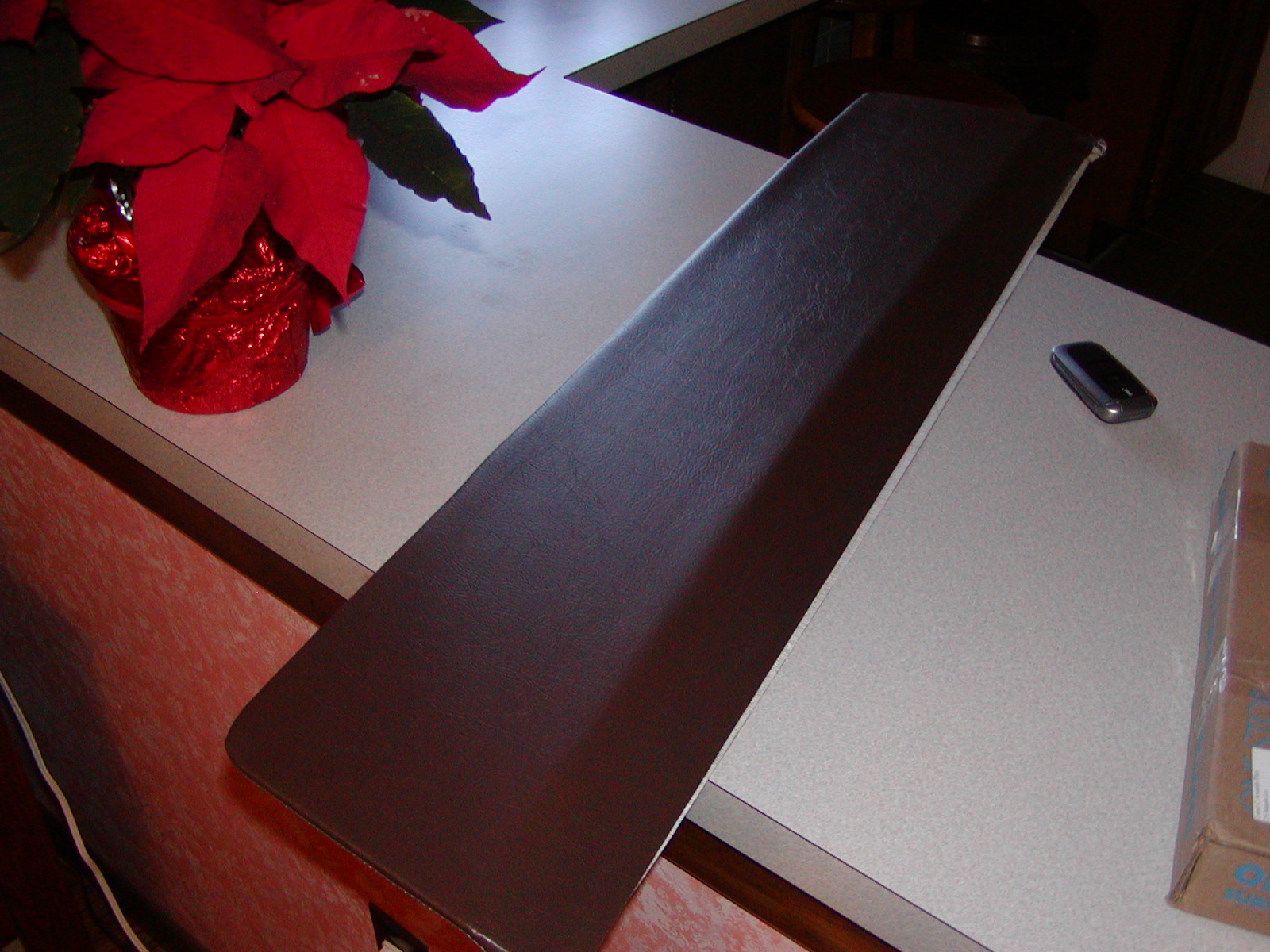

    Just looked at the pict of the finished headliner. It looks like it is uneven but that is a shadow.
