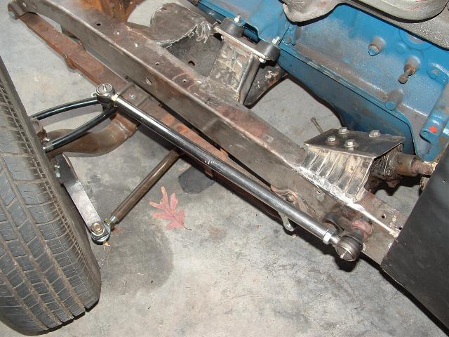

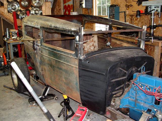

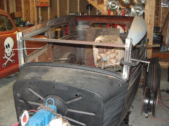

    After a couple of weekends we got the steering all together so we can make turns now, got the doors mocked in place so we know where the bodys final resting place is, and made the windshield posts.
    Enjoy,
    Rick

    Parallel leaves!!! Thank you for keeping your Chevy a Chevy and not a Model A wannabe.
    Where's the upper steering arm from? I assume that's an MAS drop axle w/ 49-54 pass car spindles & brakes?
    Ed
  7. KingpinOlds
    Joined: Sep 16, 2004
    Posts: 103
    KingpinOlds
    He got the steering arm from a buddy, but we think it is just like the one speedway has. He got the axle and spindles from speedway, the lower arms we made a pattern for and had another buddy make for it.
    There will be no ford parts, the only part we have used from another vehicle is the steering box from a '49 studebaker truck. Keeping it all chevy only made sense, i'm sure people will still call it a model A though, oh well....

    We are replacing all the wood with 1x1 tubing, there wasn't much of it left anyways. Plus we're suiciding the doors and need the extra strength throughout the body, it's really not that bad of a project to replace the wood with steel.
    Rick

  10. When I did my Pontiac it was kind of ugly getting door openings that ended up being the right dimensions and curvature as the actual doors. Biggest piece of wood I had left when I started was about 8" long.

    Good move! When I started with my '31, most of the wood was in good shape... really just the two pieces that run between the sills and frame rails were rotted.
    Replacing those two pieces led to replacing everything.
    With the wooden structure, you could push the turret and watch the door frame flex on the opposite side. It's a whole different car after replacing the wood. It's solid as a rock.. no flex.. probably overbuilt..
