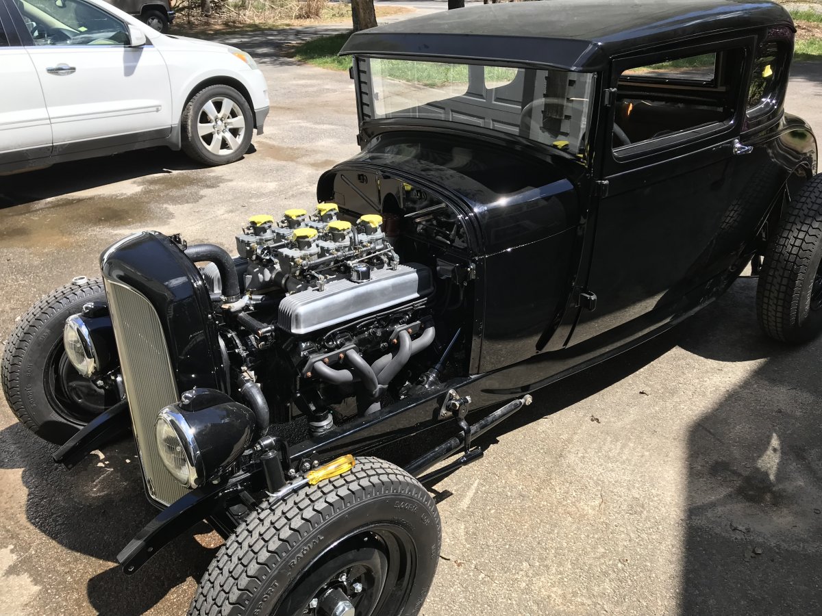

    Had picked up this GM tach drive generator early on in the project as a way to have a Tach because the magneto I found didn’t have a drive on it. The problem was, in the corvette it sat up top on the drivers side and I needed it flipped to run on the Nailhead bracket.
    Finally got over the hump of not wanting to modify it and just took it apart to make the changes. It work out well and fits the setup pretty good in the end. A19C4A81-2616-480D-8602-27ECE371347F.jpeg

    Uncle Max at 97-express refurbished the bases for this setup and man what a great job he does, fast turn around and very fair price. 0B170CAB-3B04-4F14-AB74-880ED6BD55BE.jpeg
