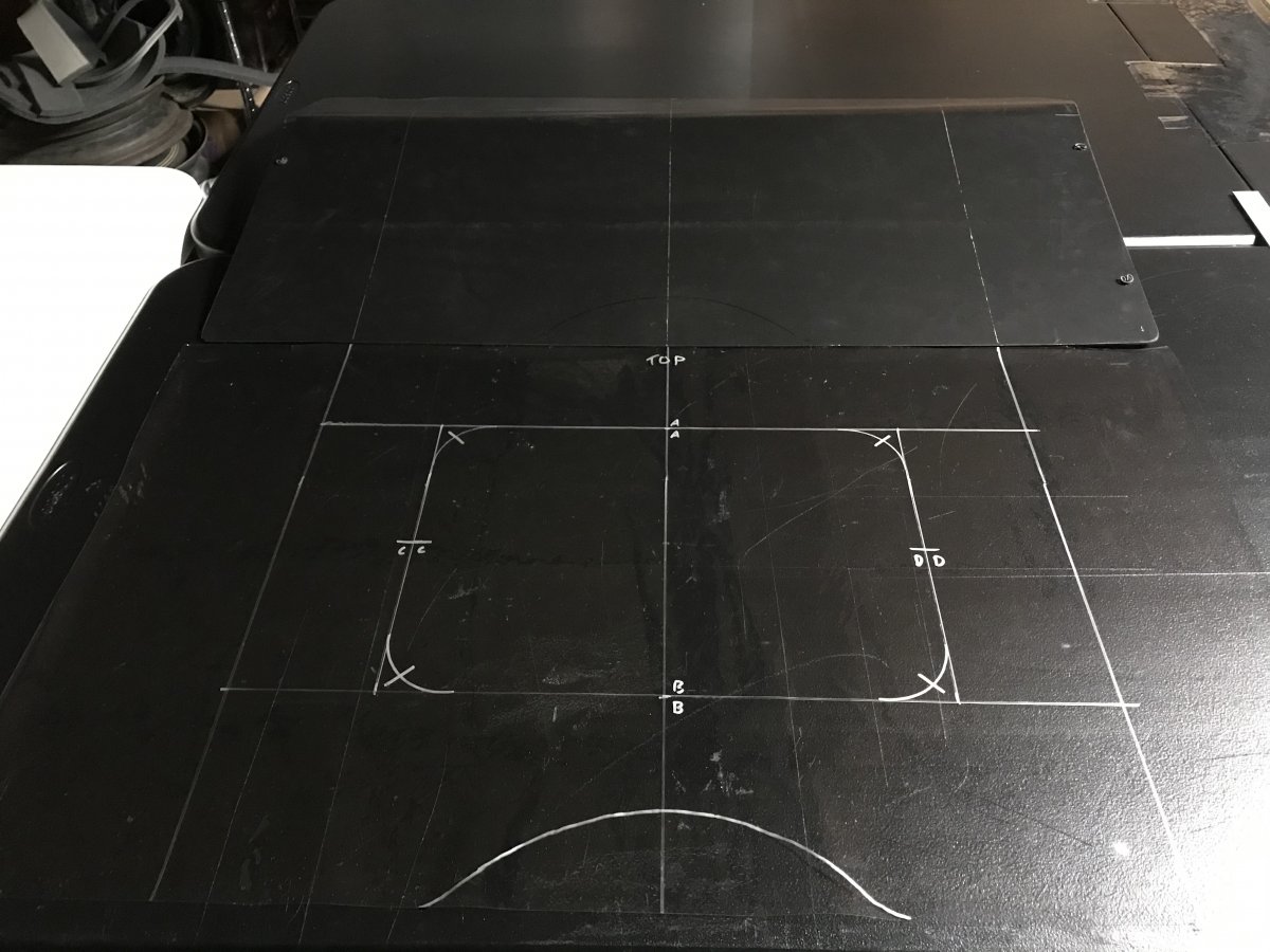

    In keeping with the theme of “I’m pretty sure I can do that myself”, picked up a Sailrite Fabricator sewing machine when they had a great sale going. Watched a bunch of YouTube videos and ordered some supplies to get my feet wet. After some practice pieces I got started, this was the winters project for the coupe. C3558AF4-4EF9-4983-B5A1-71425167613F.jpeg 4F7D872F-3E39-4CC0-B5A3-D60D999636AC.jpeg 3F613280-B5F3-4026-97C3-92035A6F7E59.jpeg 7A8D873E-9A37-44F1-8AEB-A0352163428C.jpeg 2AFD5F0F-C500-43CC-9269-D6E0981D1C7C.jpeg 0679C085-0554-485D-B06B-134042DF50CA.jpeg 200768EE-3974-4962-8DF4-2F273A1F20A7.jpeg D605A5DF-BAF7-4A7F-897C-BB8083AA80F1.jpeg B13ADAF6-C3AC-419B-8E44-51FF4DEC2697.jpeg C4A77DE1-09CE-49C4-8775-A3EFD01354E5.jpeg 981ADE95-E391-4DB7-A1D1-DFDE66053267.jpeg E03B07C8-69E1-4C55-96CF-CA43C58BA8FB.jpeg 6AECFFD4-1AD7-42CA-ACE6-02F261129CE6.jpeg BEFFF23E-4E45-4979-8143-3301675F3548.jpeg 9C1D40E2-87E2-4E68-9485-21006A619E4F.png A08E3F53-2A2C-453C-BA2C-42940CCDC9B3.jpeg 338F78E5-E5DD-476F-900D-0FD4DCF0328E.jpeg 39A593A0-1553-46AD-8748-81503E8446A0.jpeg 0C7CAD5E-CA9A-4206-89D6-E73716CB2268.jpeg E964BAEF-F53E-4F7D-94B2-2BB553F796BB.jpeg

    Thanks guys I had a lot of fun upholstering it and learned a tremendous amount with this car. My next project is a roadster and I will do the interior and a chopped top for it when I get to that point.
    I measured in between each bow, and subtracted 1/2” from each panel so I could pull it tight. Left the front, rear and sides long because you pull them tight , staple and then cut the excess off. It’s far from perfect but it looks ok for an amateur attempt.
