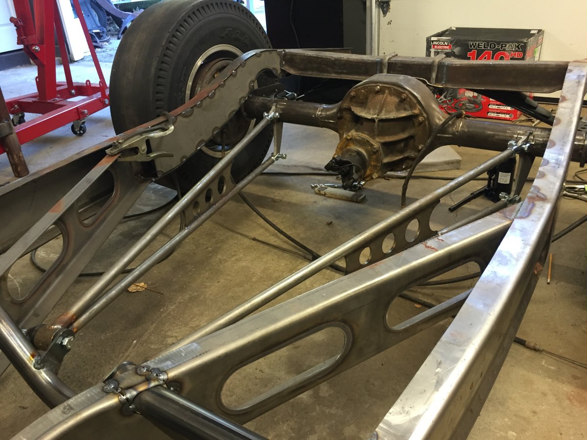

    We got the X member made up and 40 pedals mounted. Needs a notch under the clutch pedal but other then that it should work ok. image.jpeg
    oliver westlund and AHotRod like this.
  30. 51box
    Joined: Aug 31, 2005
    Posts: 1,116
    51box
    from MA
    Getting the mounts in image.jpeg image.jpeg Reused old trans cross member but had to modify from the old frame. image.jpeg Motor mounts were made from a 40 front crossmember.
