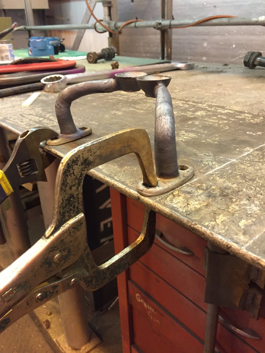

    Well after getting the radiator in that I'll actually be using I had a lot more fan clearance then I thought. So I cut the second grove off the lower pully, put the fan as close to the water pump as I could. Cut engine/Trans free and slid it all forward. Much less firewall recess needed now. This is what I had before image.jpeg and now with the lower pulley cut back and fan tucked in tighter image.jpeg firewall clearance image.jpeg

    So here's what I'm thinking for the toe board and firewall. I basically just drilled the rivets out of the toe board channel at the top & pie cut the lower to bend it back. image.jpeg So now I can run a flat wood toe board with out having a big Trans tunnel cause foot space was going to be tight . image.jpeg So I'm thinking of just building a new lower firewall one piece with the steps at the bottom for the toe board channel.

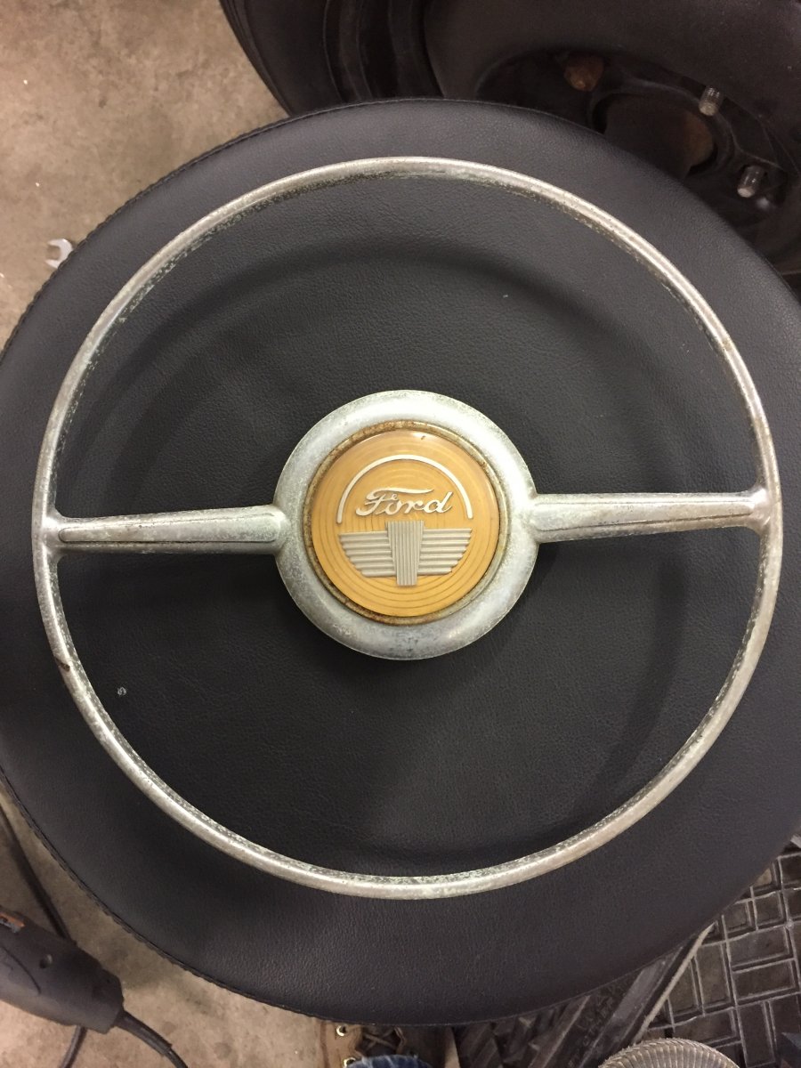

    Scored a nice take of parts last night, I went for the steering wheel but he was turning that 47 into a street rod so I grabbed what he had left for original parts. image.jpeg The wheel is nice only a couple hair lines on it, im thinking Wimbledon white image.jpeg

    from MA
    I know, who cares about the horn.... but I'm amazed at how well it came back! image.jpeg image.jpeg

    That horn ring & ****on looks great!
  29. Oh, WOW! What an amazing transformation.
