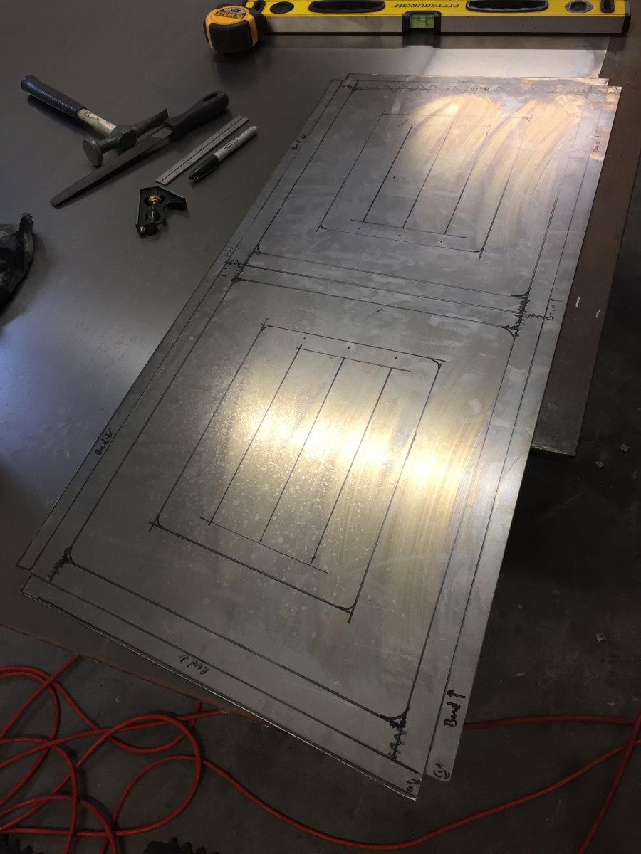

    IMG_0085.PNG Thanks for the good words on the build.
    Jared I'm more like an entry level butcher when it comes to sheet metal hah.
    Final stance is not set yet, but it will be more level then nose down when finished. I have a full 32 truck spring in the front with regular eyes still, so plenty of room for dialing it in.

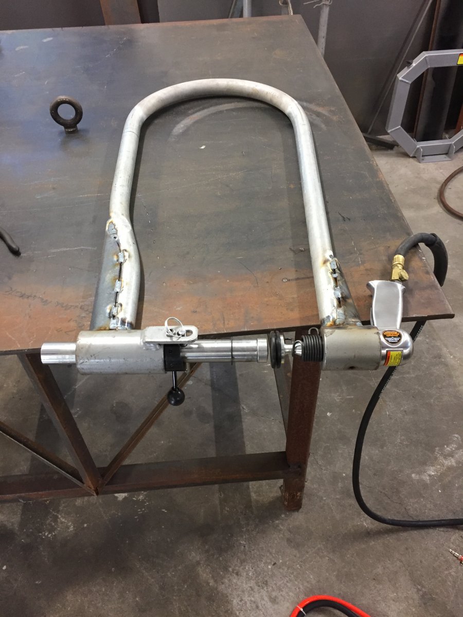

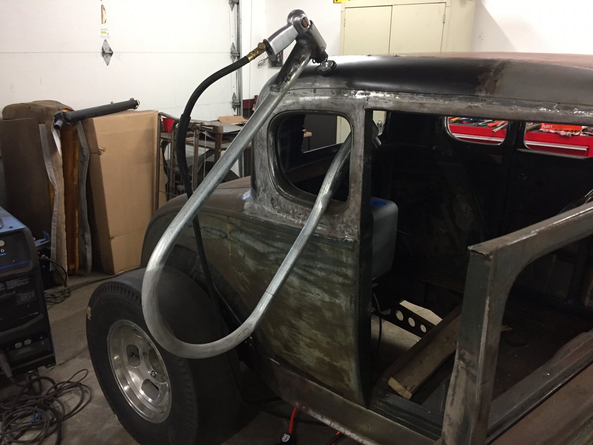

    Good progress. You might post your planishing hammer on the homemade tools thread. That is pretty slick!
  9. 51box
    Joined: Aug 31, 2005
    Posts: 1,107
    51box
    from MA
    Thanks guys, I really want to drive it in 17 just need to keep plugging away.
    This is the hammer setup, picked up a cheap table top one and cut it up. Used a piece of 1 1/2" conduit long enough so it would reach the center of the roof no problem. IMG_0132.JPG

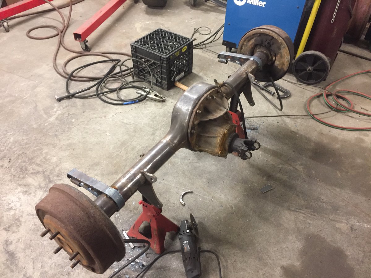

    I'm working on the trunk floor now. Some poor planning early on is rearing its head now. Basically I unhooked the shackles to bottom the axle out on the frame in order to do a hump over the center section. But my spring hanger's hit the frame with about and inch to go. Walked away for the night and need to think about how to gain the clearance. IMG_0265.JPG

    Thanks for the hammer pics! I know I'll be needing one eventually.

    And to remedy the spring hanger gusset clearance problem, I cut the gusset off and then bent some 3/16"
    1 1/4" flat bar the the torch around the whole axle. IMG_0290.JPG
    It seems rugged, think it will be ok.

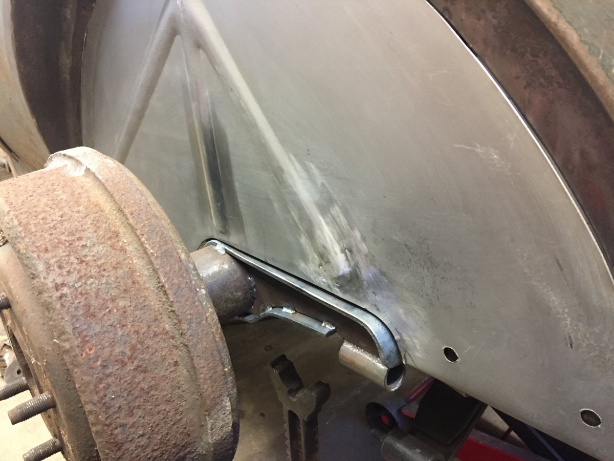

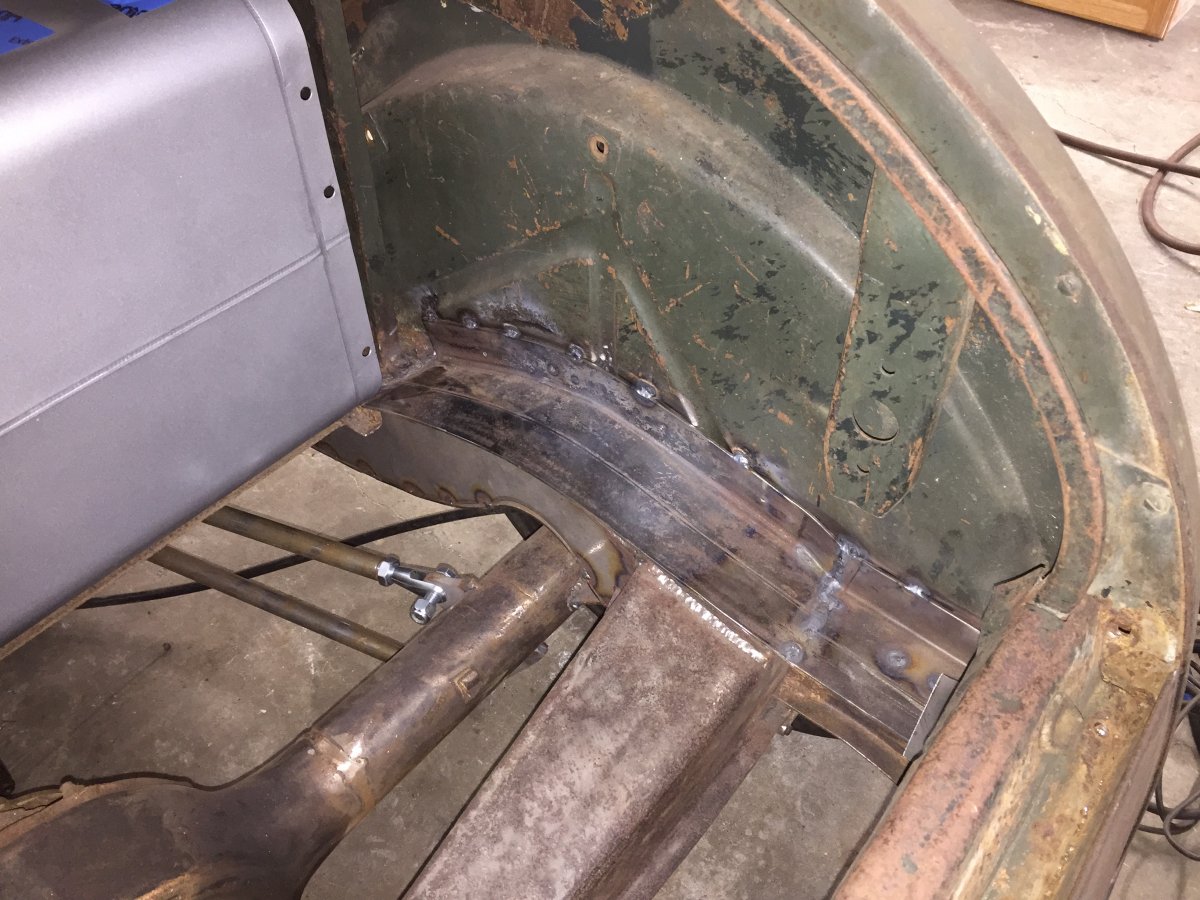

    Alright after doing those I beam spring hangers some wheel well clearance was needed. Had to move the middle and rear bead up for starters. IMG_0312.JPG IMG_0342.JPG

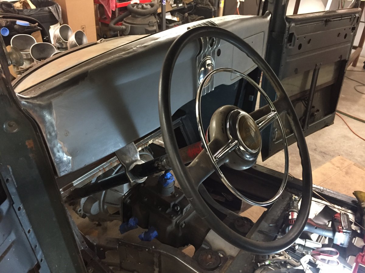

    Then onto the column drop. I just welded a sleeve inside the stock model A clamp to fit the F100 tube. Then 3/8" flat bar glued on and ground to shape. IMG_0537.JPG IMG_0541.JPG IMG_0539.JPG Front floor board/tunnel is next on the list.

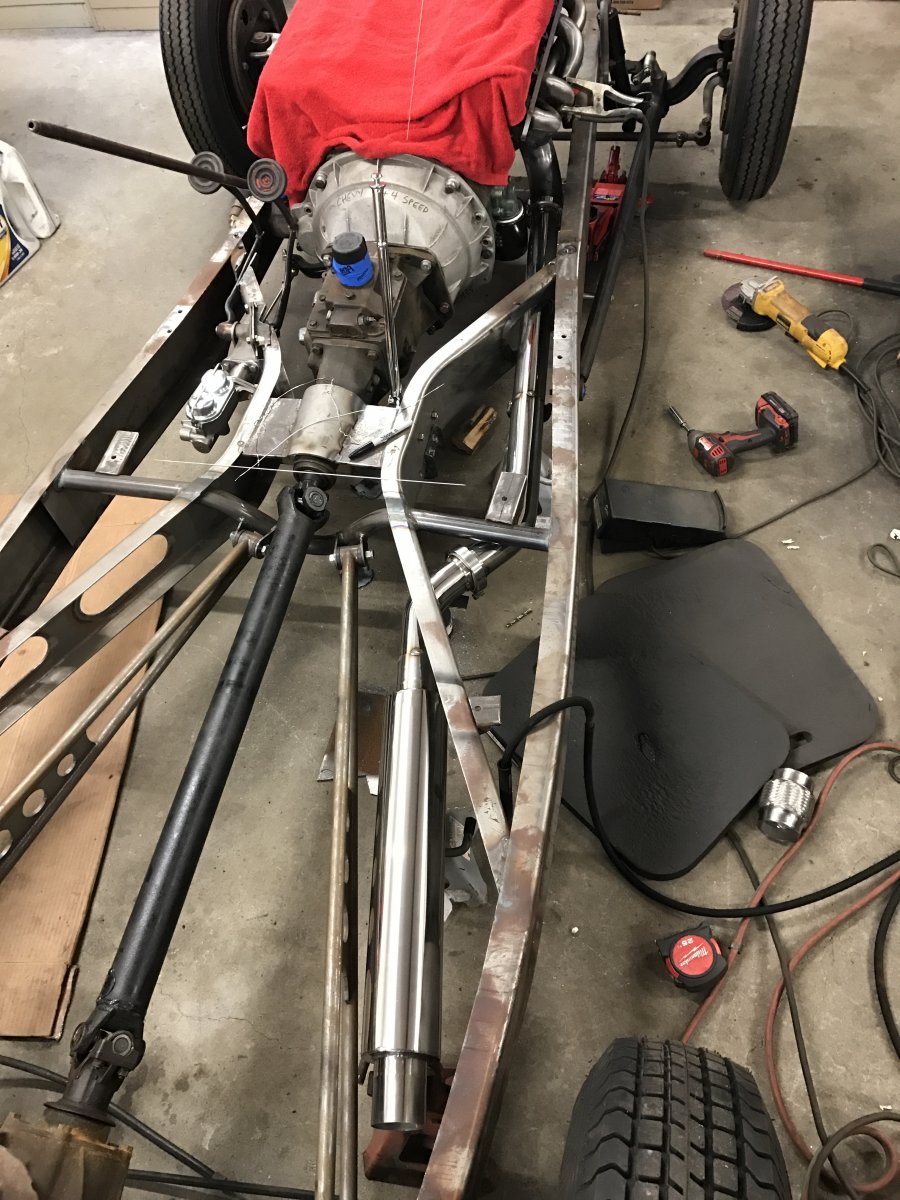

    Started making up some 3/4" box structure to build the floor on. IMG_0579.JPG
    Little tunnel action, this was the third attempt after trying to make the first two out of one piece.
    Started off by shaping some 3/4"X 1/8" flat with the gas axe. IMG_0599.JPG IMG_0608.JPG IMG_0609.JPG
    Anyone know what ratio to make the clutch pedal using direct linkage? I know these pedals stock had a bell crank also so it's different. IMG_0596.JPG

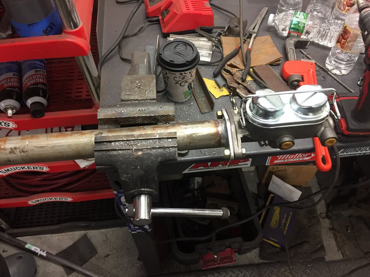

    Made up this adapter to go to the amc master in using. IMG_0646.JPG IMG_0647.JPG IMG_0648.JPG IMG_0651.JPG

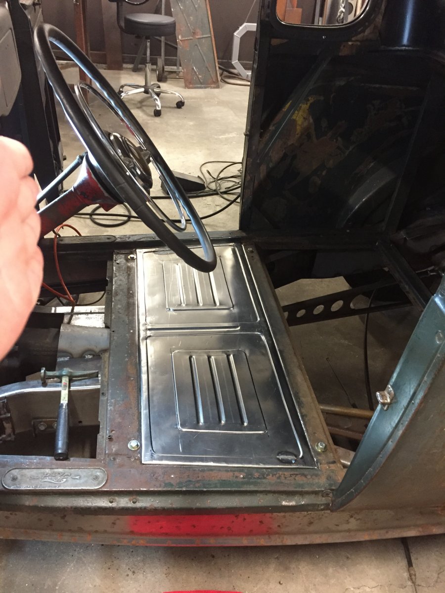

    And finally made up the front floor out of some 16 gauge, just need to pop some holes in it for pedals etc. IMG_0678.JPG
    It's split up the middle so it all comes out for access under.

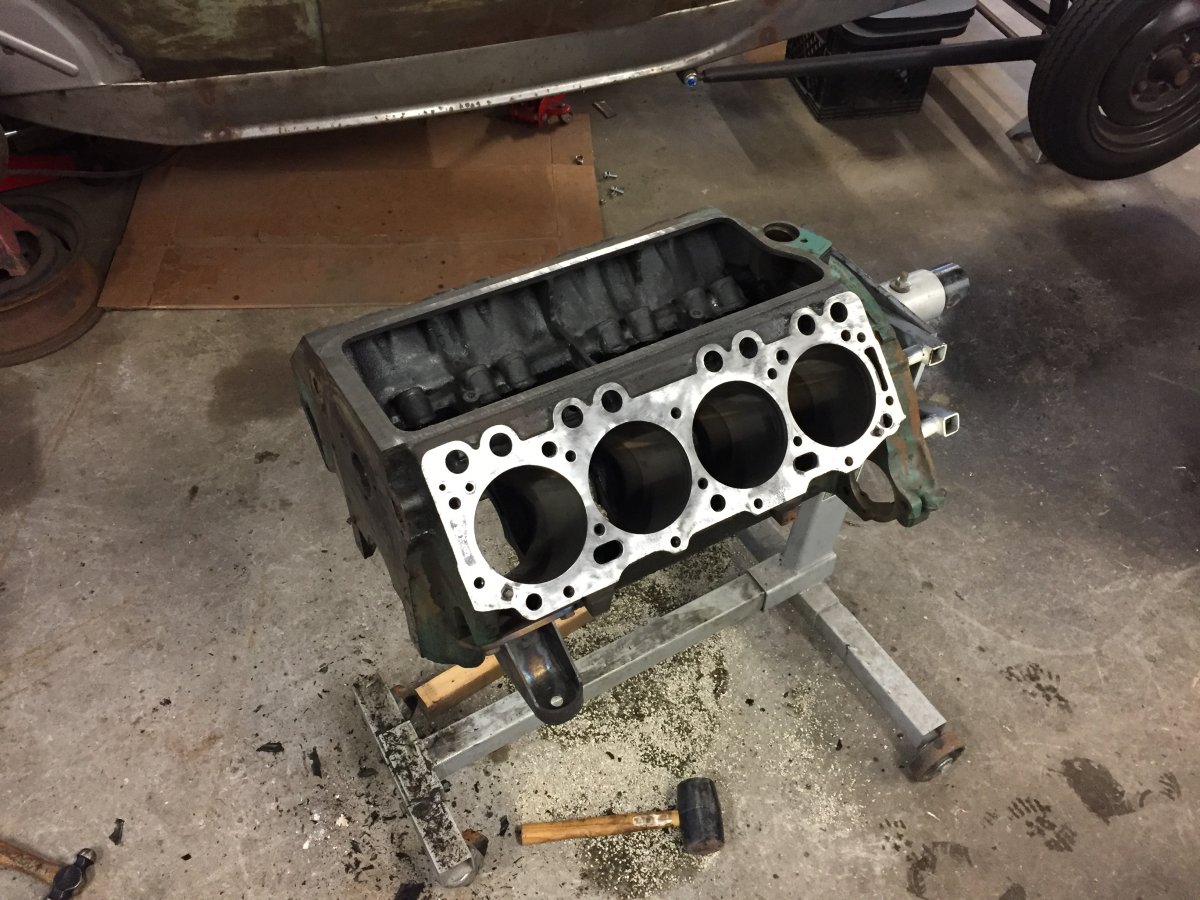

    Thanks to my buddy Jared for helping out on the take down / inspection of the 425. She'll be off to the machine shop soon for a little work. IMG_0530.JPG IMG_0531.JPG

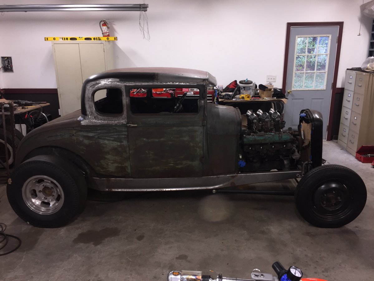

    IMG_0684.JPG Rolled her out for some fresh air after the long winter we had in New England. Lows 60's today felt great. IMG_0685.JPG IMG_0668.JPG Very happy with the proportions etc, but I think the front needs to come down an inch. I might try to reverse my original 32 main leaf.

    Lowered the front about an inch by removing a couple leafs and slight de-arch on the main and second leaf. IMG_0695.JPG I think it's good, just a little rake.

    I'm just seeing this, and I really like it. I would love to hear that nailhead fired up. I have a buddy with a 53 Buick with the original engine, and they sound great. And this later one has a lot more cubes! Is this a full rebuild of the engine, or just a refresh? What all are you replacing and machining?
    Very cool build. I miss the pinstriped grill shell though, haha!
    kidcampbell71 likes this.
  27. 51box
    Posts: 1,107
    51box
    from MA
    Thank man, unfortunately the engine needs a bit of work. Definitely an overbore due to pitting in cyl 1. Deck the block and heads. Some custom JE forged pistons, Schneider cam, adj pushrods etc all new bearing stainless valves etc. I was going to have the heads ported but I really don't think it's worth the investment.

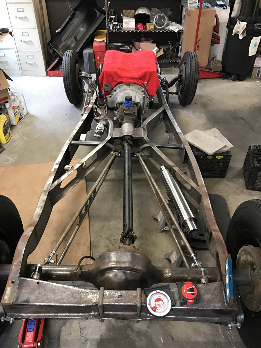

    Exhaust all tacked up, will do the tail pipes after the body is back on. IMG_0851.JPG
    Started off with finding a decent spot for the muffler to live. 26" long steel pack mufflers. IMG_0853.JPG Connecting the dots now IMG_0885.JPG 2.5" from collector back. IMG_0884.JPG
    Drivers side was more tricky because of the side steer and drivers side starter. Had to go under and come back up. IMG_0952.JPG IMG_0963.JPG IMG_0973.JPG
