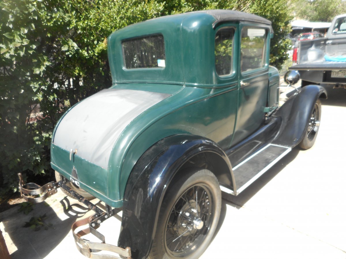

    Enjoying this build! I have been trying to decide what to do with my 29 coupe; you have a lot of great ideas I hope to use on mine. Looking forward to more updates.
      178.9 KB
      522
    kidcampbell71 likes this.
