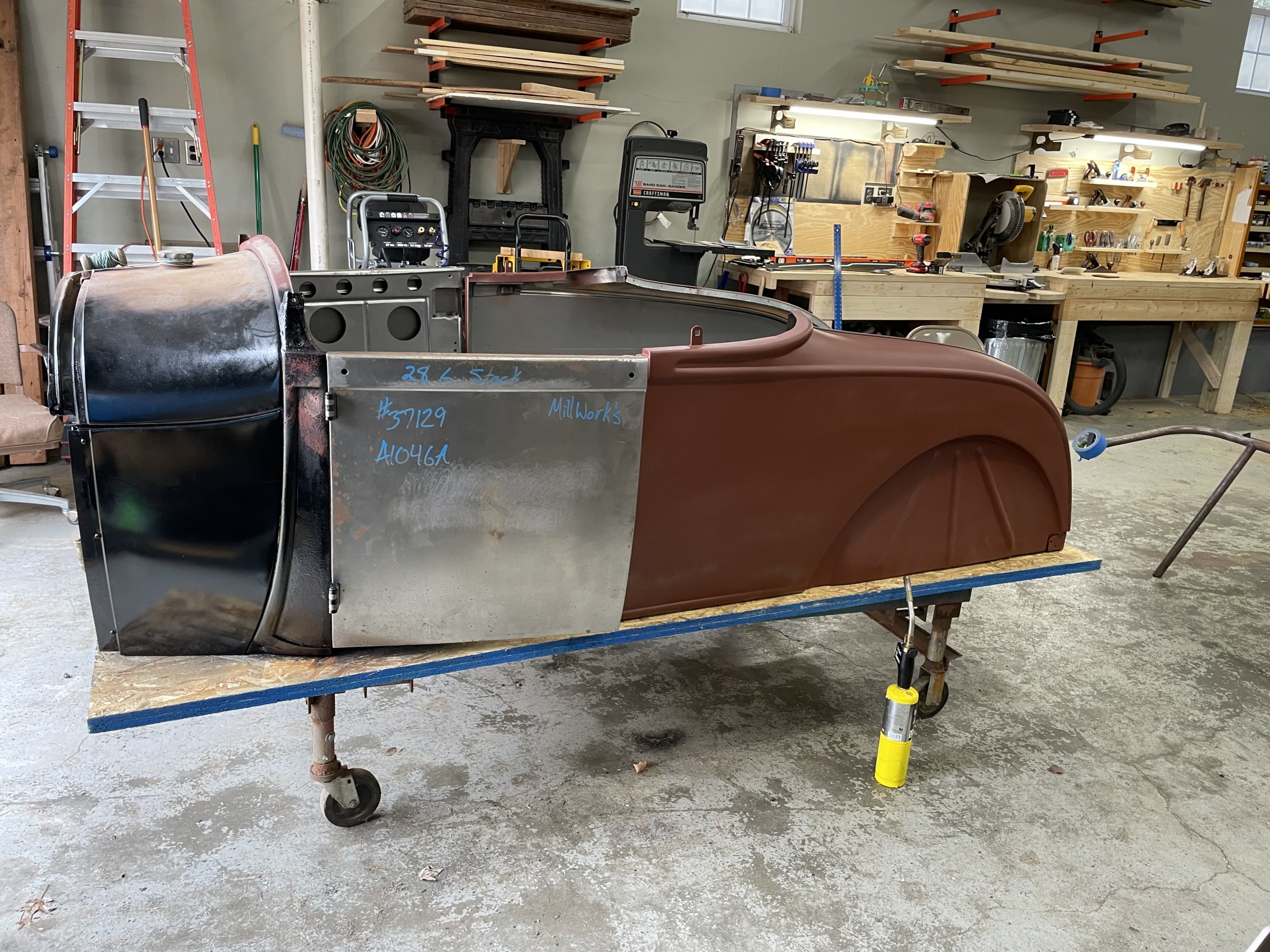

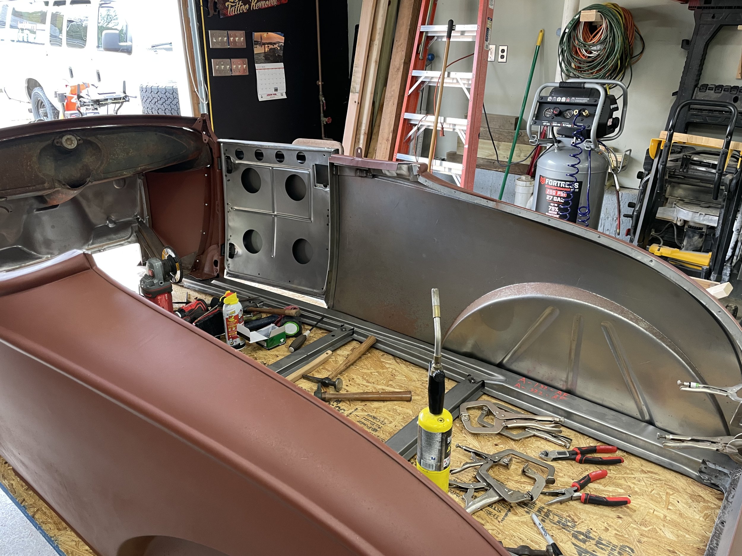

    Back on this one again, after a long break. C’est la vie. I bought some new Brookville doors and a set of subrails from Millworks Hot Rods and that simplified the ***embly process from what I originally planned to do. I built a platform for the top of the body dolly that is flat and level and laid everything out. picking away slowly over the last few days as I am on spring break for a couple weeks. But, I am also getting prepped for an exhibition of new paintings coming up at the beginning of April. So I am a bit divided in my attention, as always.
    Since I worked on this last, I have also totally revamped the workshop and gotten myself out of the little garage. Believe it or not, we actually park daily drivers in there now. I know, crazy talk. But it's a really lovely little upgrade. A clean workshop is a nice upgrade too.
    Anyway, today I drilled out the old hinge hardware on the A pillars, and got the new doors and hinges mocked up on it. Pretty good progress for a morning's work.

    Today’s progress included getting the old hinges removed from the A pillars, the doors mounted to the cowl with new hinges, the tulip panel and panel below deck lid bolted in, and the deck lid freed of its old crusty hinges and new ones installed. Decent progress for a day.
