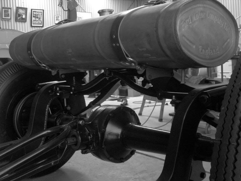

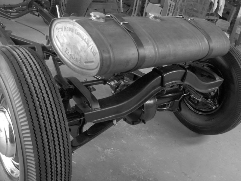

    Been slowly working away. Having some real issues sorting out my clutch. I have a plan though and if it comes off I should have it sorted out this week. That's been holding up everything else because I can't install the motor and gearbox without the clutch and I can't drop the body on without the motor and box in and can't wire it and can't plumb the fuel lines. It has been a chance to catch up on a lot of little things that I've put to one side. That's good because as it turns out there's quite a few of them.
    One important one was reconditioning my old Fordson fuel tank. I bought a cleaning and sealing kit. It was fairly labour intensive and time consuming but I think it has ended up pretty good. It was a 3 stage system. Once complete I mounted the tank on my ch***is just for a look
    The middle stage of the system is a rust remover, etch chemical that leaves a powdery grey finish that looks like an old water tank and can be left unpainted for about a month without flash rusting. I did the outside as well as the inside.
    The brackets are now welded to the tank (thanks Binga) so the straps are really just for looks...although they do provide an additional bit of security too.

    The ch***is looks Great, gonna be one NICE modified!
    I love the end-caps on the fueltank.
    Nick.

    Thanks Swifty but I've got the pics :)
    I'm not going for the super slick look. I have quite a few mis matched bolts etc that I hope to replace after I'm on the road. Trying not to be too fussy at this stage. It is black though so it will be reminiscent of yours. I've gl*** bead blasted all the polished aluminium for a more business like look.
    Pete

    Looking good, I've got a similar tank as yours. Glad you found good use for it, mine is just waiting...
    --mika
  21. Glad I could help out.
    Looks good sitting on there.
