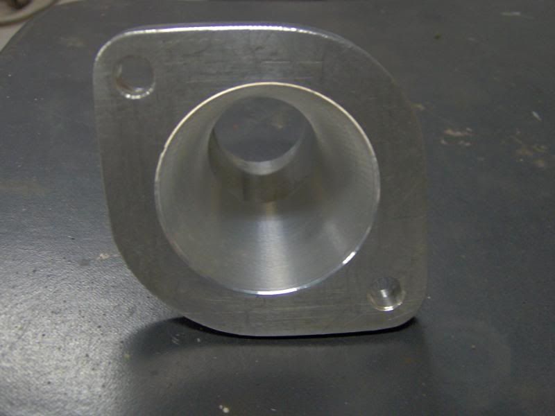

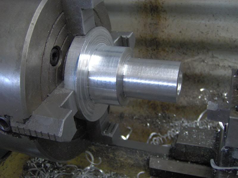

    I asked once about water necks / thermostat housings for nailheads on here. I got some advice that SBC ones fit. I bought one ...they don't. Then I think Zman gave me a link to an aftermarket one...$65US. Ouch, that's $100AU + shipping.
    I just finished this up tonight:
    Chunk of aluminium 4" dia x 4" for $34. (Australian)
    Came out OK. Lucky I'm not on hourly rate but no use having the big expensive machine if you don't get to play with it.
    BTW, is aluminium swarf sharper than steel?...I'm sure it is
    Pete

  28. You clever bastard! Your RPU is really looking good!

    Do I need some sort of exemption for my new water neck? Where do I apply?...Ryan?
  30. thunderbirdesq
    Joined: Feb 15, 2006
    Posts: 7,091
    thunderbirdesq
    You made it yourself, I think tht gets you off the hook!;) Nice work.
