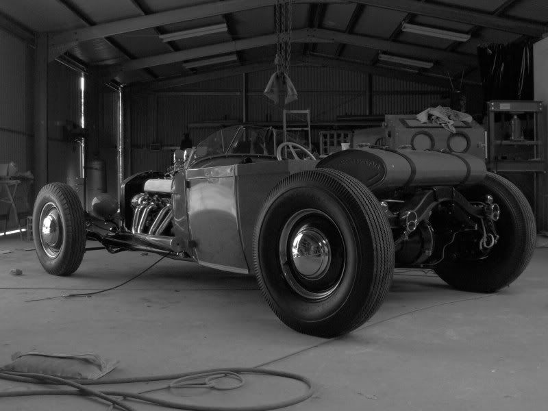

    Well, it finally looks like a car!
    We are in the middle of wiring and a few more little things and I might actually get to go for a drive soon.
    One problem that I mentioned above. I never mocked the car up with 7.00s on the rear. They are a bit tight !!
    I just dropped the wheels off to have the tyres demounted. Hopefully this arvo I'll adjust the offset of the wheels. I can only go about 15mm (5/8") on the rims so I hope it's enough. I like things to fit nice and snug, but I don't need rubbing.

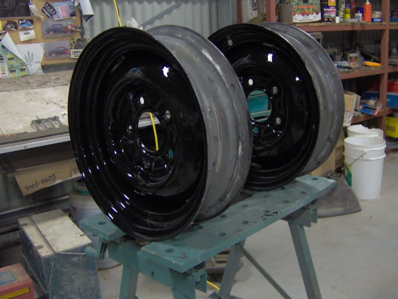

    A number of things pushed me toward the alteration of the offset of the wheels over spacers.
    The first one is: It's the right way to do it
    The other thing is I could do it straight away without relying on anyone else. If I went with spacers I'd have to source and buy the material, then I'd have to machine it, Then I'd have to get longer studs, Probably from the US because you can't buy anything out of the ordinary here, then I'd have to machine the studs to suit my brake drums (as I did for the ones on it now) Then I'd have to pull the hubs that I just torqued up, Then I'd have to press out the studs and press in the new ones and re***emble.
    All this to have spacers I don't want.
    Instead I did this today and it's done and done right:
    Drill out the rivets
    Knock out the centres
    Clean up the surface rust off the mating surfaces
    Refit the centres in the rims (reversed) and plug weld the rivet holes from both sides
    Weld along the edge where the rim and centre meet
    And paint
    All done this afternoon and tonight, ready for tyres to be refitted.
    I gained about 17mm or so in the end so it should be good. I reversed the centres only to save on filling and finishing the rivet holes. This way they are actually used as part of the attachment. Just had to fill and redrill the valve stem holes.

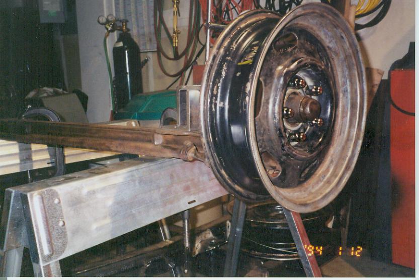

  18. Did you set the centers up on a spindle and bearing and rotate the "outers" while checking with a dial indicator to guarantee that everything is truly lined up with no run-out, or did you just "eyeball" it? I used to know a fellow back in the sixties who reversed wheels as a business sideline, and he used the method I just outlined to ensure that the wheels wouldn't wobble as they rotated.

    I ran them on one of my front hubs. A dial indicator is probably a little too sensitive for these 60+ year old wheels. But I did spin them and checked with a more appropriate guide (a hammer handle secured to a milk crate) that they ran true. Only a little tapping was required to get them to probably 1 1/2mm accuracy. I think that's about the best you'll get out of them given their age and the fact they were probably never 100%.
    Just for others doing this. It is worth mentioning that I checked for run out against the inside "channel" of the rim, not the outside of the rim. The outside is usually so out of round from years of abuse you could never hope to get an accurate reading.
