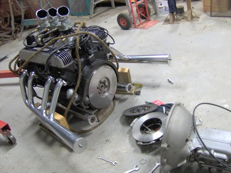

    Time for a mini update:
    After a few days of pissed offness I bit the bullet and set about cutting all my wires so I could pull the body off again. It wasn't a mindless hack but precision surgery. It should all go back together nicely. So off came the body again
    Then the motor and gearbox came out

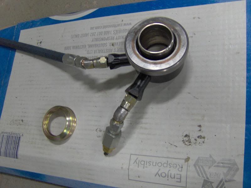

    And I split them. The knocking I had heard when I pushed the clutch on "fire up day" was as I suspected: The hydraulic fittings on my hyraulic throw out bearing hitting the back of the pressure plate ***embly. they shouldn't have but they did. When I pushed the clutch the whole T/O ***embly moved. It was just enough to cause the clash. I think part of the reason it moves is the shims between it and the front of the gearbox.
    There are 7 of them in my application and they aren't a snug fit on the snout of the gearbox by any stretch. They can move around on each othe so the T/O bearing doesn't really have a very stable platform to push from. That's my theory anyway. So I'm going to machine a more accurate solid spacer. I have also ground off the offending parts of the hydraulic fittings so hopefully take 2 will go a bit smoother.
    While I had it all out of the car I thought it would be smart to make sure nothing else was fouling e.g. clutch plate and flywheel bolts
    It was all good so I am now sure where my problem is / was. I think Martin is coming to give me a hand on Thursday so I'm trying to get to a point where if we go hard at it, it'll be back together and ready for a second try this week.

    Not much happening. My playdate with Martin fell through, but I made a little progress. I made up the spacer that is going to replace the shims behind the throw out bearing.
    Motor and gearbox are back together. I just need a solid day or so to clip up all the wiring and fix a couple of other small things before I put them back in the ch***is and drop the body back on.

  14. That spacer sure looks cleaner than that "pile of bent washers"! Good luck

    Interesting thing with the spacers. The McLeod I used is adjusted with different depth pistons. Naturally the one it came with wasn't right. After taking all the measurements ordered the right one and it works perfectly. Catch 22 is you need to have the whole thing set up to do the measuring.
  18. striper
    Joined: Mar 22, 2005
    Posts: 4,498
    striper
    That sounds like a pain in the *** to set up but in the end a better deal. The trouble with the Howe is when you put the shims (or spacer) in, the whole ***embly moves forward. This is where I ran into trouble. When it all goes forward the hydraulic lines go too. That's how mine crashed into the pressure plate. If it doesn't work this time I'll need to explore the McLeod and Ram options.

    Striper, when I said you have to have the whole thing set up it's not that big a deal. You can do it with the engine sitting on something and bolt the throwout to the box and measure piston movement at 1" m/c travel. If that's ok bolt the lot up to the engine and check any other clearances. I suppose the pain is you can't add shims there and then, you have to order the new piston. The wrinkle I had was possibly the use of a Lakewood ****tershield, maybe a stock bellhousing may have been ok with the standard piston.
