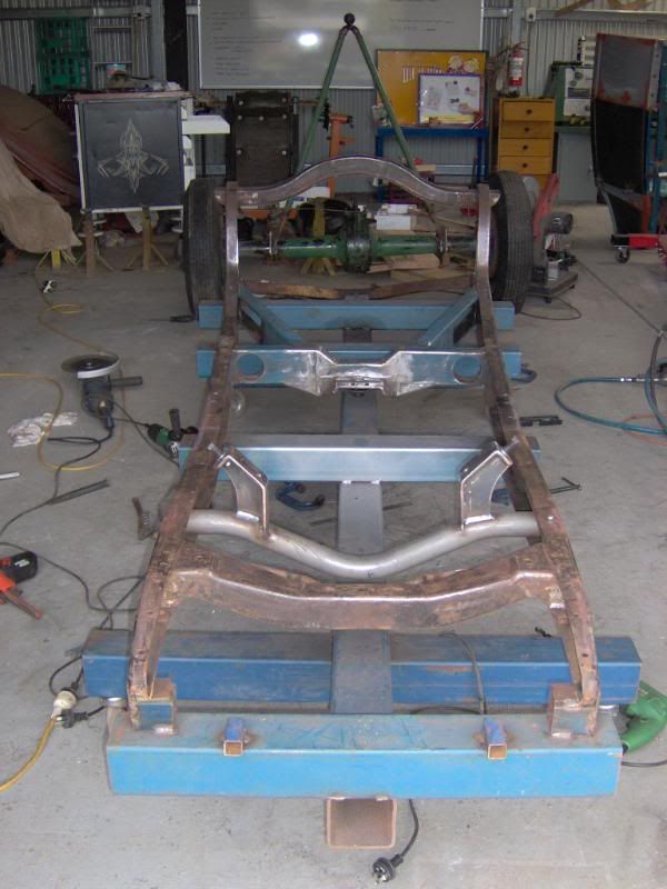

    So now that I have the front and rear crossmembers where I want them I can hang some axles under there, drop in a motor and work out the rest of the chassis.
    Starting with the rear, I made some hangers to mount the '48 rear radius rods to. I had to move them inboard because the Z meant they would clash with the frame.
    I also turned the rear radius rods into a wishbone using the ball from the front wishbone taht I was splitting. Once I had the rear wishbone in place I could position the centre crossmember.
    Then I constructed the crossmember incorporating the ball socket out of the '48 frame I bought. I since got a '48 Merc wishbone with the extension bracket that would have been perfect and I wouldn't have had to butcher the Ford chassis. Too bad.
    Then I added the trans mount on the crossmember, cut some hole for the exhaust to go through and made some K member legs

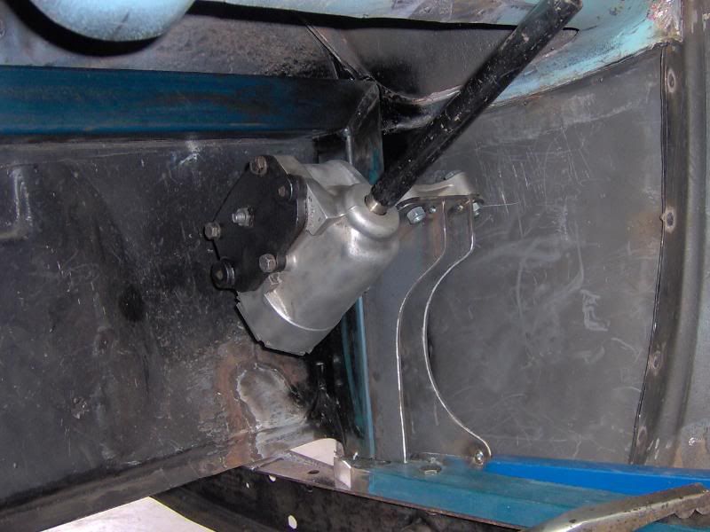

    I'll post some pics up of how I mounted that steering box.
    First of all I looked at the profile of the car and decided that the draglink should be parallel to the radius rod. I know it's not ideal steering geometry but because it's a very long drag link the variation in arcs between the radius rod and drag link will be minimal, therefore bump steer shouldn't be an issue.
    then I cut a hole
    Once I knew the position I made a mounting plate to fit the box. It was a bit of a bastard because one of the 4 holes is at a different angle to the others and doesn't sit in the same plane.
    So I had the position worked out and a mount plate. Just needed to mock up the box in position and make some steel supports. I had a little jack handle that worked weel to simulate the steering shaft so I could guesstimate the angle and postion of the wheel. This is how the whole mounting bracket looked prior to installation
    Here it is tacked in with jack handle in place
    and here it is welded in
    Oh yeah, I just remembered when I saw the pics again. I thought ahead and drilled the bracket to hang my accelerator pedal from. I knew it would be really hard to get to if I wanted to drill it later.
