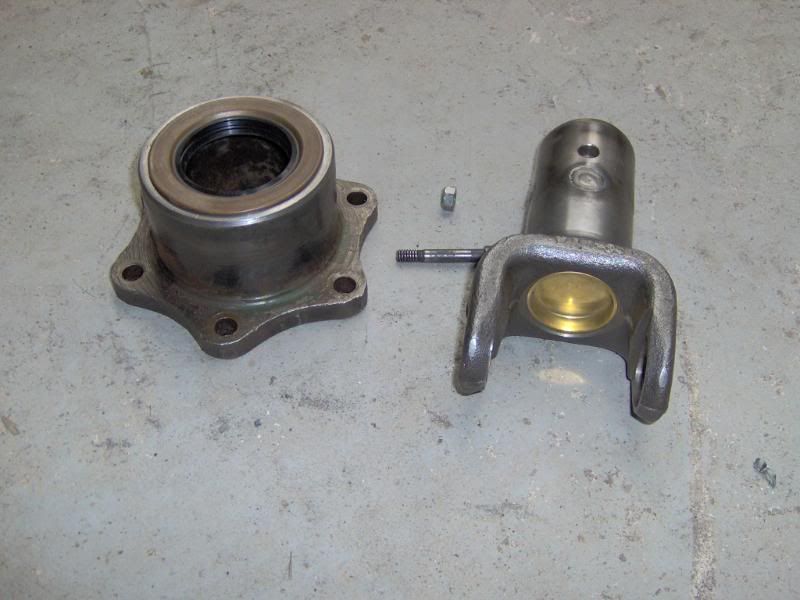

    Back to the running gear. I want to keep the '48 banjo out back because it's highly visible from the rear. I know it doesn't make a lot of sense...401, Muncie, banjo...but I'l try to look after it. It needed an open drive so I made this one
    It uses a TH 400 slip yoke with the middle bored ot to fit the banjo coupler inside. It's a press fit and is then welded in
    Chooped the end of the torque tube off, capped the end, machined a hole and pressed in a seal
    Like most things I do for the first time, I see a lot of things I would do different. I could certainly improve on this set up but I'm not so **** retentive to go and do it again. I have no intention building this whole car twice.

    Main things I would change with the open drive are 1. I would shorten the slip yoke a bit more (already shortened it quite a bit) 2. I would leave maybe 1/2" to 1" more on the end of the torque tube when I cut it. It just looks like the uni joint is fuether forward than it should be. If it was a bit shorter I could have a longer drive shaft which would be good (slightly improve its angle).
