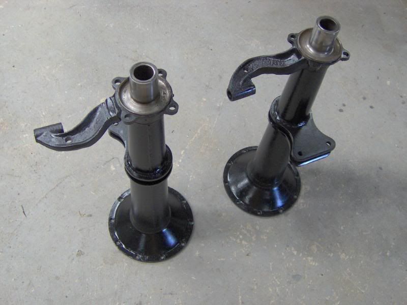

    Time for a build update. Too much talk here...not enough pictures.
    I spent some time today putting my rear axle housing back together. When I bought it, as you would expect, "It had just been rebuilt". So I took it apart for a look. Glad I did. Three stripped ot threads in the diff housing and way too few gaskets, therefore too much preload on the carrier bearings.
    So as you can see I helicoiled the stripped threads.
    The whole thing got blasted and painted while it was apart too
    Then I set about setting the preload and backlash correctly. I have to give a lot of credit to "the-rodster" for producing one of the best tech threads I've read. I printed it out when I first saw it a couple of years ago and today it paid dividends. It is such a practical and well written tech that even though it is a fiddly job and takes time, it's not that hard.
    A link to the thread is here. Unfortunately I just checked it and the pics are gone. I reckon it would still be a fairly good guide though even without photos.
    http://www.jalopyjournal.com/forum/showthread.php?t=61502&highlight=banjo+***embly
    This shot is one of the many times this axle housing was together today
    I was lucky, I had to ***emble and dis-***emble the thing about 4 -5 times to get the carrier bearing preload right, but on my first check the pinion backlash was smack in the middle of the acceptable range.
    I have been asking questions via another thread about ratios. I was dumb enough not to check mine until I was ready to put it together. I ***umed that being a car diff it would be maybe 3.54. Don't know why I ***umed but it's 4.11. A bit low for my liking but I'll live with it for now in the interest of keeping the project moving. I can feel a Cyclone quickchange in my future.
    Pete
