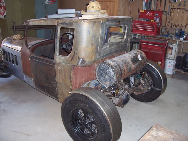

    Drewfus and Dyce. Both of your solutions look more planned out than mine. I just made it up as I went along.
    Ryan. You have done well to be ready for October. You put me to shame.
    I have an update. I have seats. No cushions, just seats. I found some old plywood. I was going to buy a new sheet but this is better. One piece used to be a work bench and each time I cut or drilled it, it gave off that old oily work shop smell. I think it'll be great on a hot day. When it gets hot it will probably give off that old smell...kind of like patina for the nose :)
    The seat bases just sit in place, located by anothe piece of ply screwed to the underside. I'll have just a little bit of storage under there. Maybe just enough for a tool roll or a street directory.
    I welded in two more pieces of 1" RHS to support the seat back and screwed a corresponding piece to each side of the back. These have little pins that hook behind the seat frame to positively locate it.
    You can also see the latch I installed to hold the seat back. I have a pice of string attached to operate it at the moment but I'll use a piece of leather or whetever my upholstery material ends up being (grey velour???)
    I picked up 3 of these latches for $10 a couple of years ago at a swap meet. Came in handy. You can also see in an earlier pic, the bolt that the latch closes on.
    There's a little bit of storage behind the seat too. Every little bit counts on a car like this. The seats are really firm when installed and the back works really well. When you pull the string it just pops forward about 6". Then it just lifts out if you need to take it out.
    Upholstery will come but is very low on the list of "to - dos" at the moment. I can live without it.

    An Update.
    My rear end set up had me stumped for a long time. I am using a '48 Banjo that I converted to open drive. That necessitated a 3rd link or torque arm or something to handle the torque at the rear end. The trouble was that the 10" Z, 4" channel and the fact that I moved the body back as far as I could, left no room for any of that. The solution is the "Torque Fork" TM. This solution didn't come easily, even though to look at it now, it is very simple. The whole rear end and wish bone ***embly is rigid and pivots in the ball housing within the centre crossmember. It works the same as an original Ford front end.
    The fork straddles the drive shaft
    The rear of the fork is held in double shear between ears welded to my open drive conversion (end of the original torque tube)
    The front bolts to ears welded to the front of the wishbone near the pivot
    None of it is super beefy. However there will be very little stress on the wishbone or "Torque Fork" TM. There is no suspension bind due to the single pivot point. There will be a small amount of spring bind as it travels through an arc, but no more than on a standard Ford. Hope it works!
    Pete

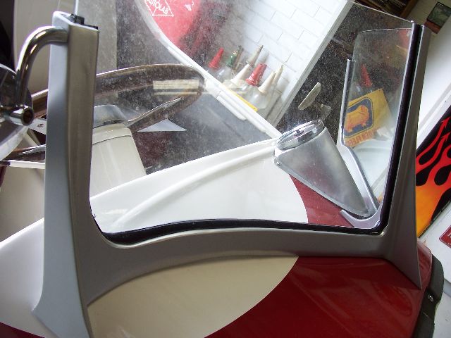

    i built a similar style windscreen a couple of years ago on one of my cars in a very similar fashion to how you describe
    heres the only in the build pic i could lay my hands on, i painted it in a silver metalic for a brushed aluminium look
