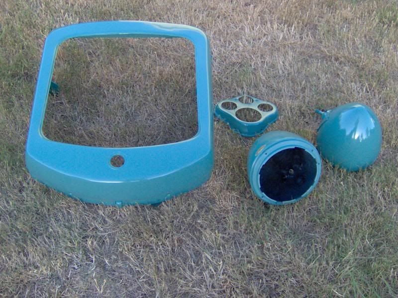

    My thoughts exactly. I'll have some pics tomorrow. Today and yesterday I painted my grill shell, headlights and misc stuff. Tomorrow it's the body and doors.
    The ch***is is a roller, brakes plumbed, new Firestones on the back.
    Funny thing with the paint. I got a batch of lacquer mixed for the backyard paint job. I always intended a low sheen paint job. Not really sure why. Probably because I never intended spending much time on body work on this car. I like a straight body and I can do it, I just thought the time to get it schmick wasn't justified. It's not that kind of car.
    Anyway, I mixed some flattener in and shot the grill shell. Colour needed some tweeking and more flattener. Shot it again and really liked it. It's glossy but not mirror shine. Like it's a few years old. I think I'm going to go with it.
    Only thing I'm nervous about is changing my plan this late in the build.
    Ah well, gloss is the new matte anyway.
