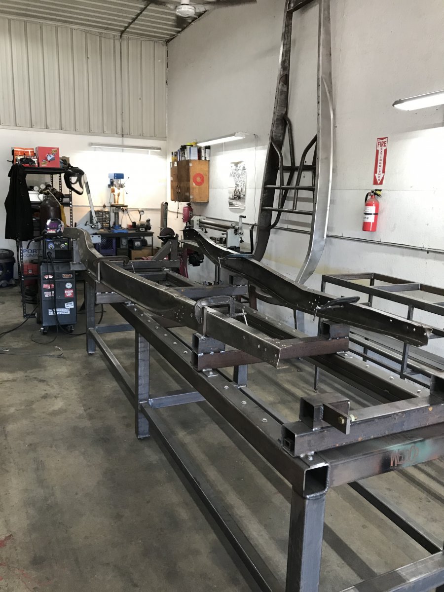

    Rails in the table! Pretty easy to see how twisted they are now.

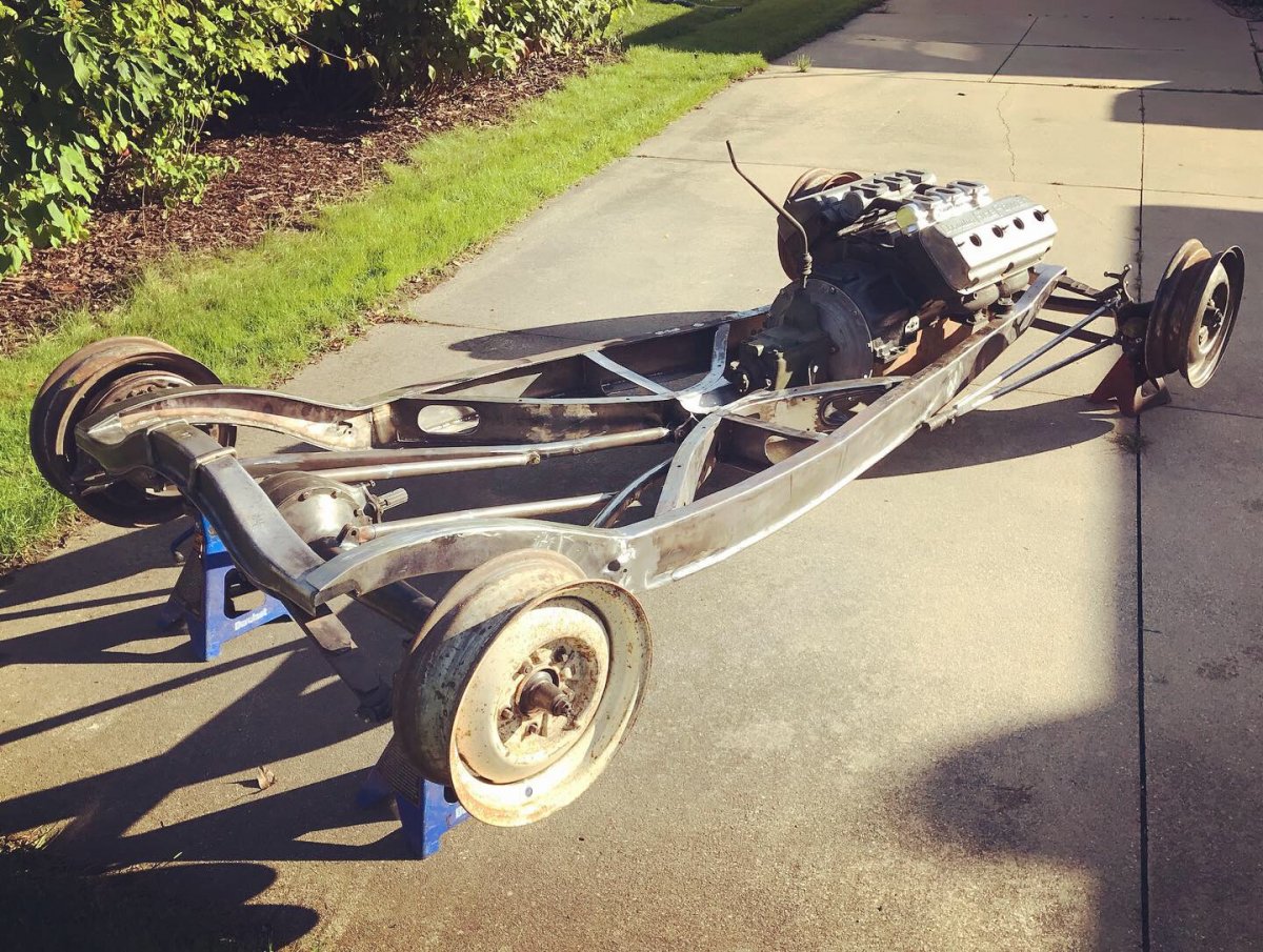

    Back home for some glamour shots. Got my Body placed on the frame and now it’s ready for many hours of body work. I will try to update as I move forward. Again, Could not have done this without Johnny’s help and experience, really happy with how it turned out so far.
    Chassis 43.JPG Chassis 44.jpg Chassis 45.jpg Chassis 46.jpg Chassis 47.JPG Chassis 48.JPG
