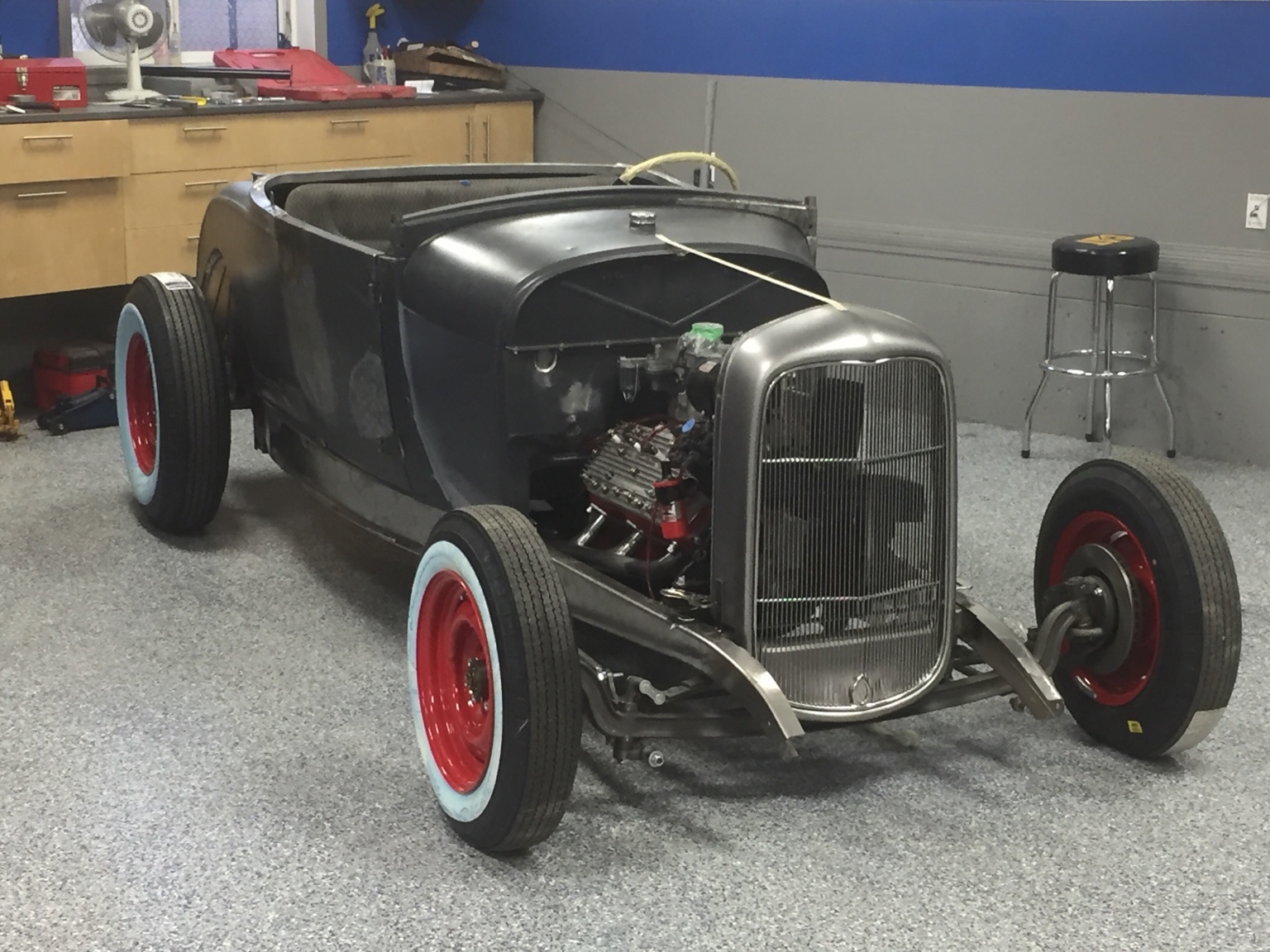

    I had a local shop build me a 2.5" chopped 3 row core 32 radiator. When I went to install it I found my fan was just contacting the bottom of the rad as it is a lot thicker than the stock rad I used to mock every thing up. I moved the rad forward 1/4" and then modified the fan hud to slide the fan back 1/4" giving me about 3/8-1/2" fan clearance.
    Next up was mounting the windshield.
    [​IMG]o
    I found the stock hight just didn't look correct. So a 2" chop took care of the Fugly

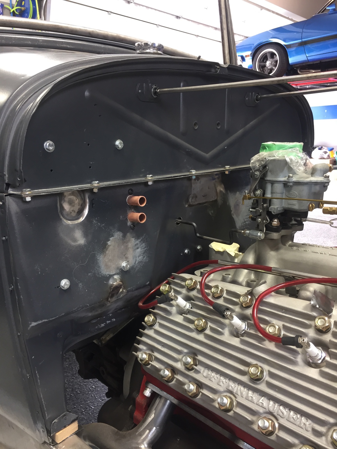

    I have also spent way too much time building a heater for the car. I picked up a old Heatmaster heater at a swap meet. I blasted it down repainted it and cleaned up the chrome the best I could. The original core must have frozen as the bottom tank was split open. I dis***embled the core and attempted to patch it back together every time I fixed one leak another pin hole would open up. In the end I used a 65 mustang heater core and adapted it to fit with a small transmission cooler fan providing the air flow. I practiced my plumbing skills and made up a copper adapter to mount up to the fire wall to be my bulk head fittings for my heater lines

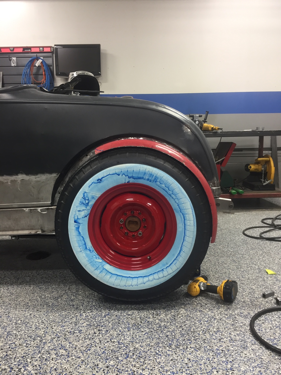

    Well who knew building a hot rod would be so much work, spent the last 2 weeks of my spare time trying to get one cycle fender made and mounted. I'm finally happy with the fit to the tire has about 5/8" clearance from the tire to any part of the fender. Now I just need to figure out a system to bolt the fender to the bracket
