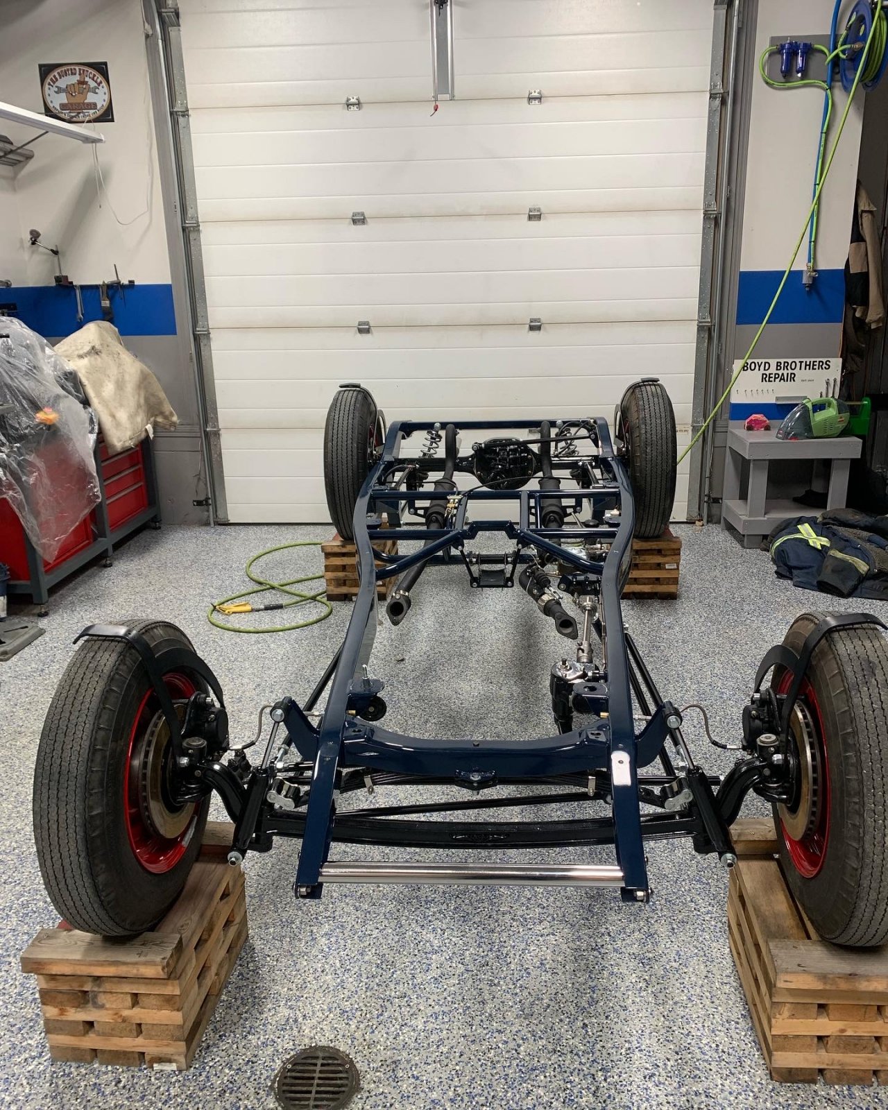

    from Calgary AB
    Well I have putting the ch***is back together so I can roll it around. Picked up a set of wheel skates and they sure make icing the thing easy now can’t believe I used a floor jack to drag this thing around for the last 5 years

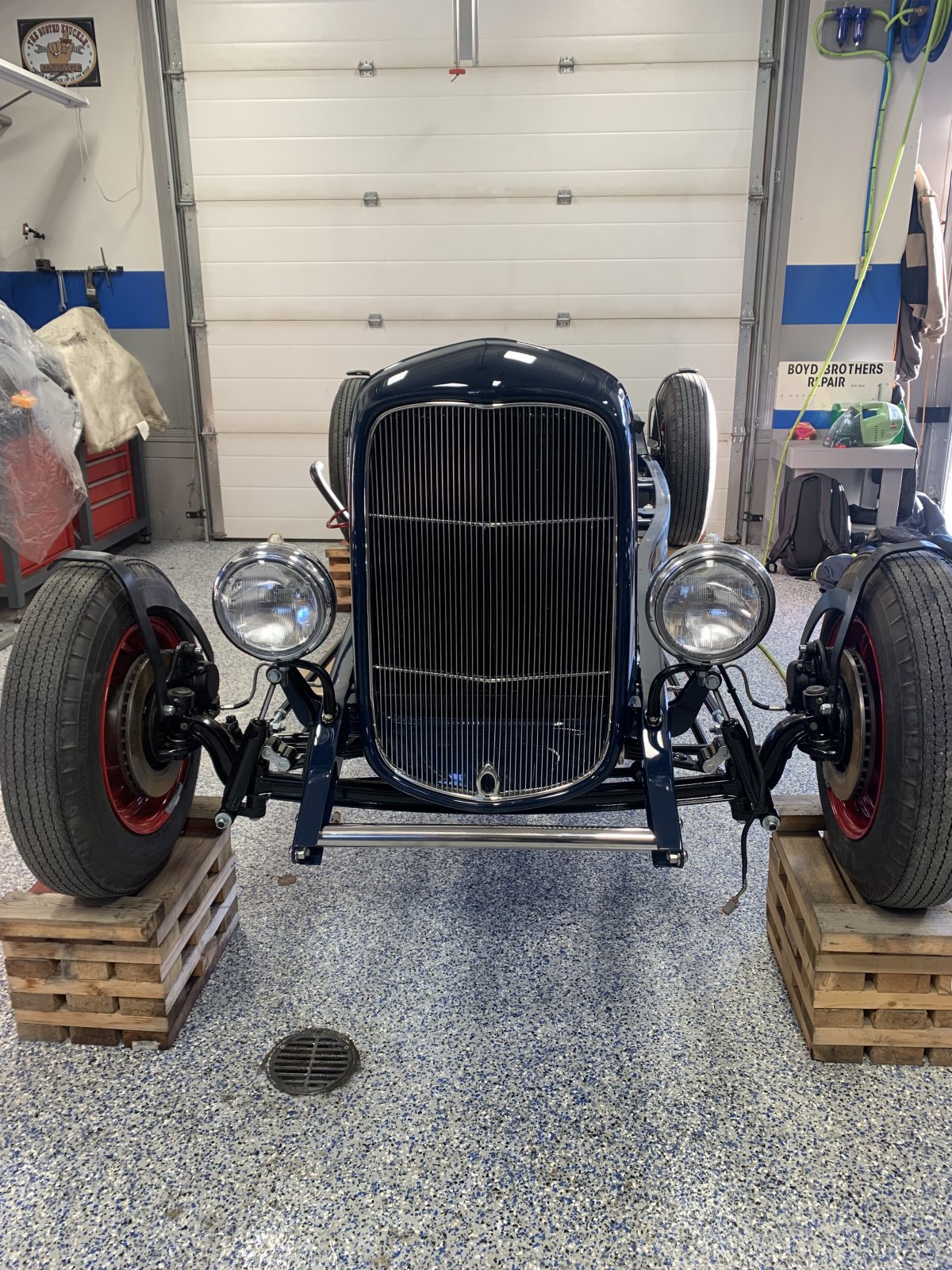

    I have working away on the ch***is the last few weeks installing the brake and clutch system. I made up a clutch safety switch as I’m sure it will be required for licensing inspection. I also tested out my brake system. I’m sure glad a went with DOT5 as I had major leaks and could not get my original residual pressure valves to seal up due to miss machines seats that would not seal. Had to replace both of them and then it was all good.
    Next up was the fender brackets I installed the front brace and powder coated everything.
    Next up us put the body back on get the doors and trunk working and latching correctly then it should be time to start it up!

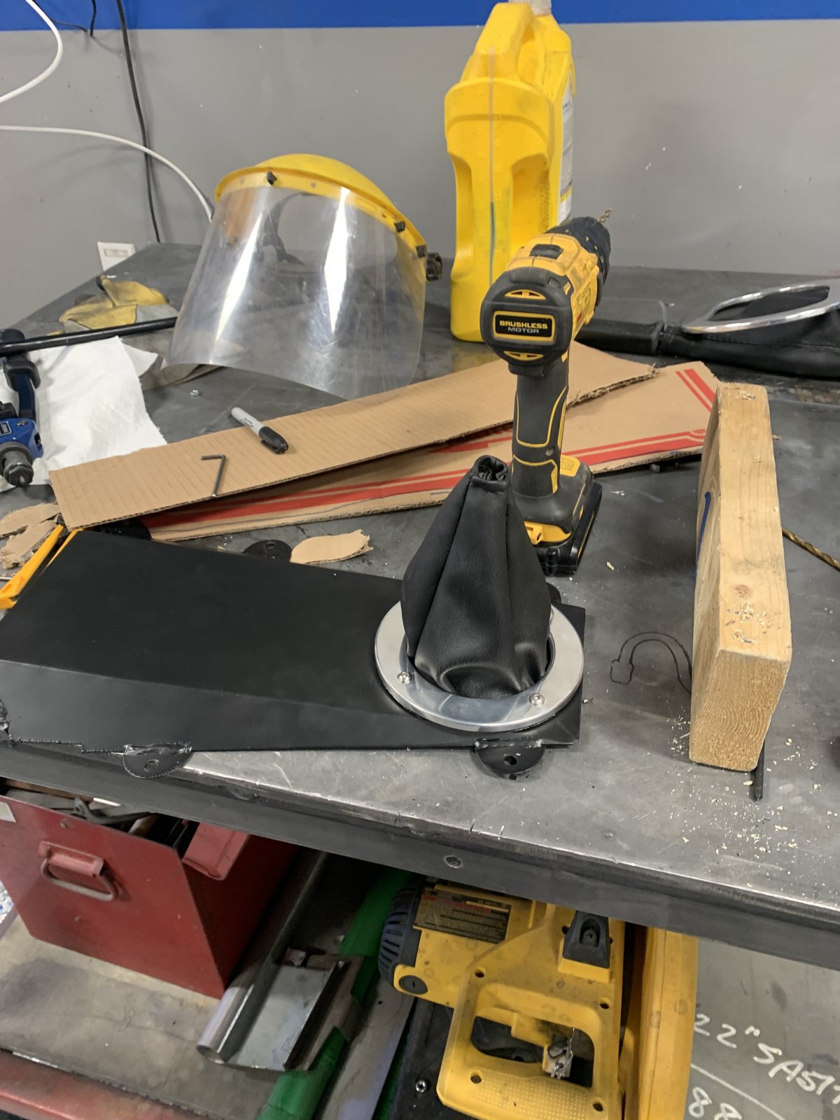

    Next up was making some door handles and a shift knob. Used some acrylic pen blanks and turned them out on my lathe followed with wet sanding and a polish
    The metal ring on the shifter is a silver napkin ring with my initials engraved on it. The Napkin ring came from my grandparents when they would set the dinner table everyone place was marked by these rings and after they p***ed we all got them. It has been sitting in the garage for the last few years figured this was a good home probably the first time it was polished in 20 years [​IMG]

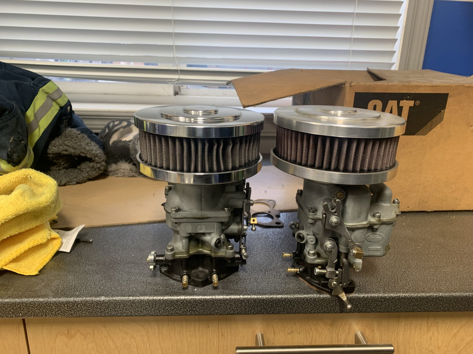

    Transmission back in and I made the first under power trip in the car. The carbs need a lot of work they are leaking and stumbling but you got to star som where I guess

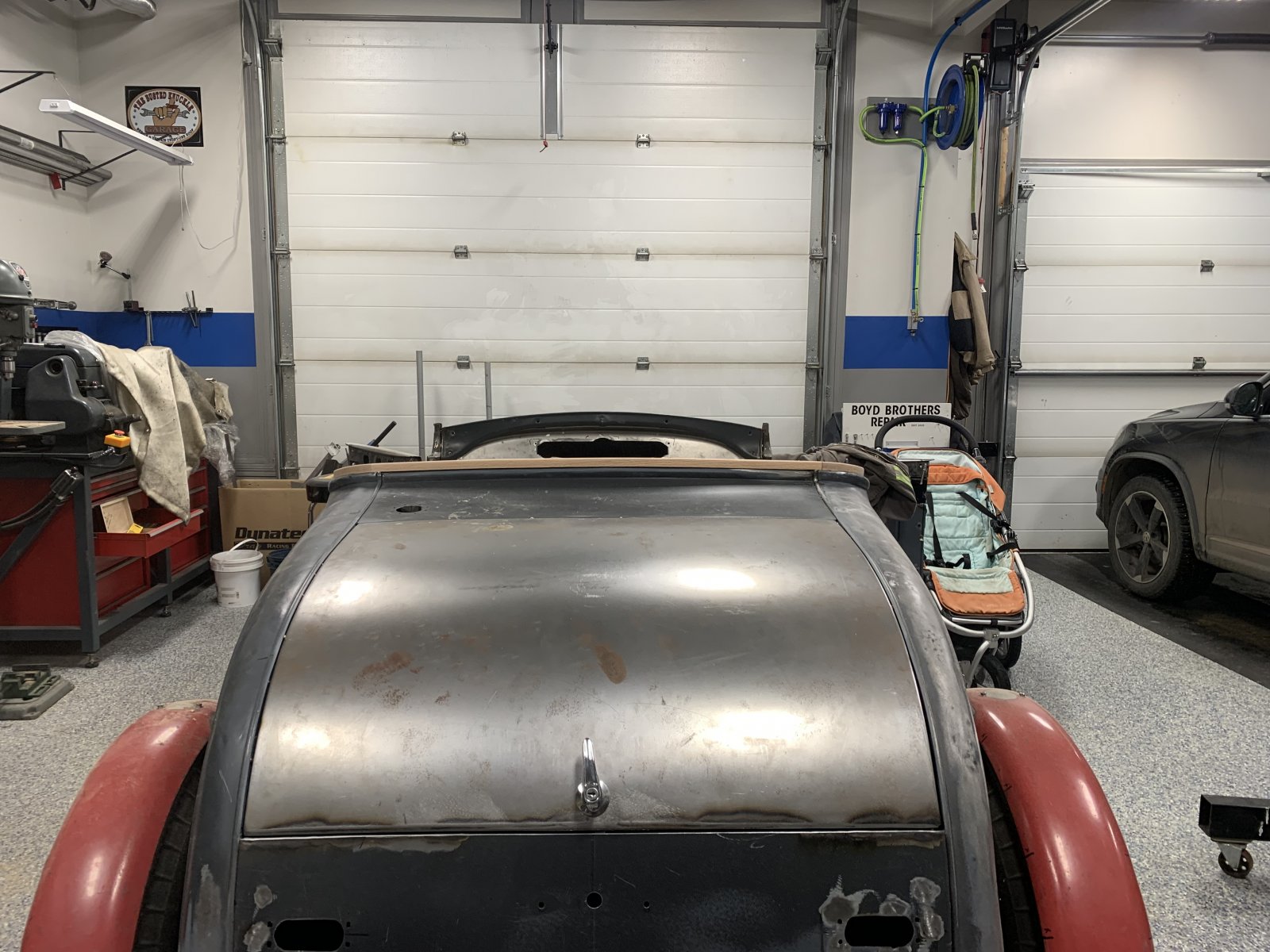

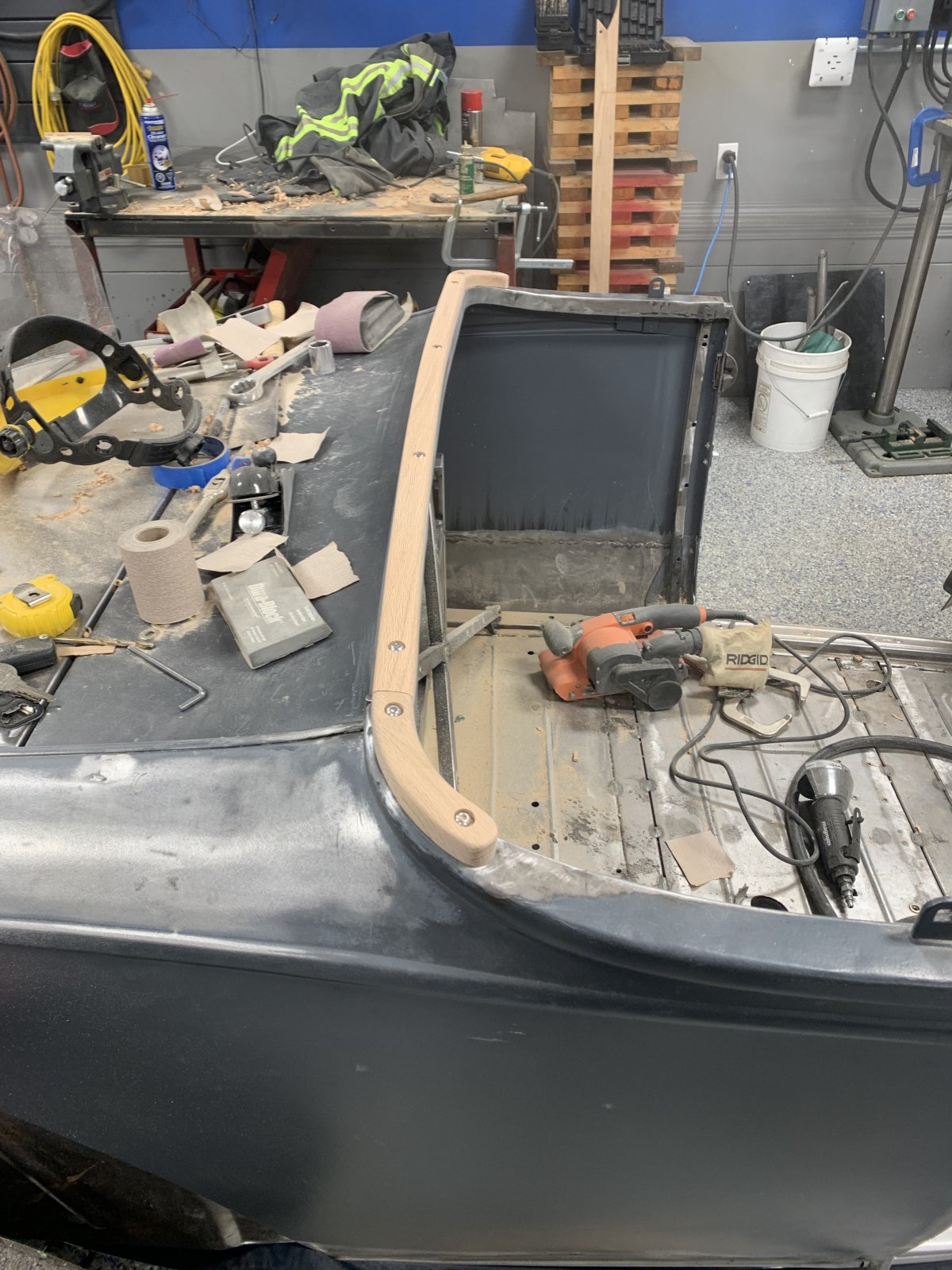

    For the last couple of months I have been pulling the car back apart getting ready to send it in for paint. I had it all ready to take it in on Monday but I decided I couldn’t live with my 3rd brake light set up
    So today I was busy building a oak trim pice to wrap the rear of the ****pit. I will stain it dark and I’m thinking of a way to insert a thin brake light into the wood.

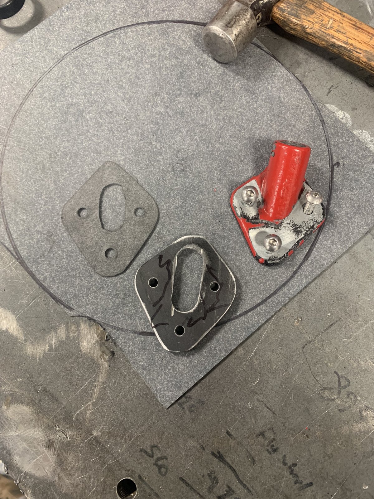

    One other little side project with the engine out I wanted to take the leaking dip stick in the side of the pan. After 70 years the gasket was leaking on the riveted in adapter plate. So I was able to remove the sump of the oil pan and drill out the rivets and build a new plate to go behind it and tapped it for 10/32 screws. This way I was able to then make a new gasket and bolt the dip stick adapter to the oil pan

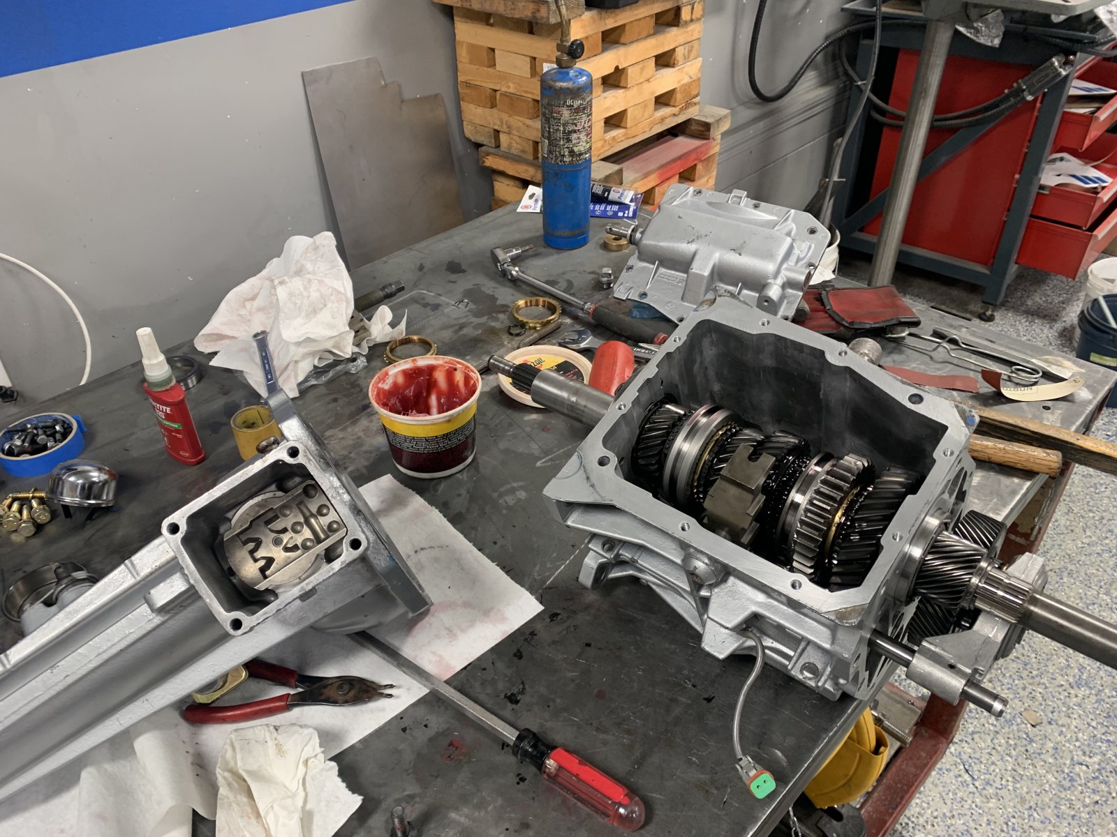

    Still making forward momentum on the car. With the car at the shop for paint I was able to rebuild the T5 transmission as it did not want to down shift into 2nd. I spent some time polishing up my Aluminum air cleaners
    The body shop pulled the body off the frame so I picked up the frame and brought it back home so I’m starting on re***embling the drive train back into it

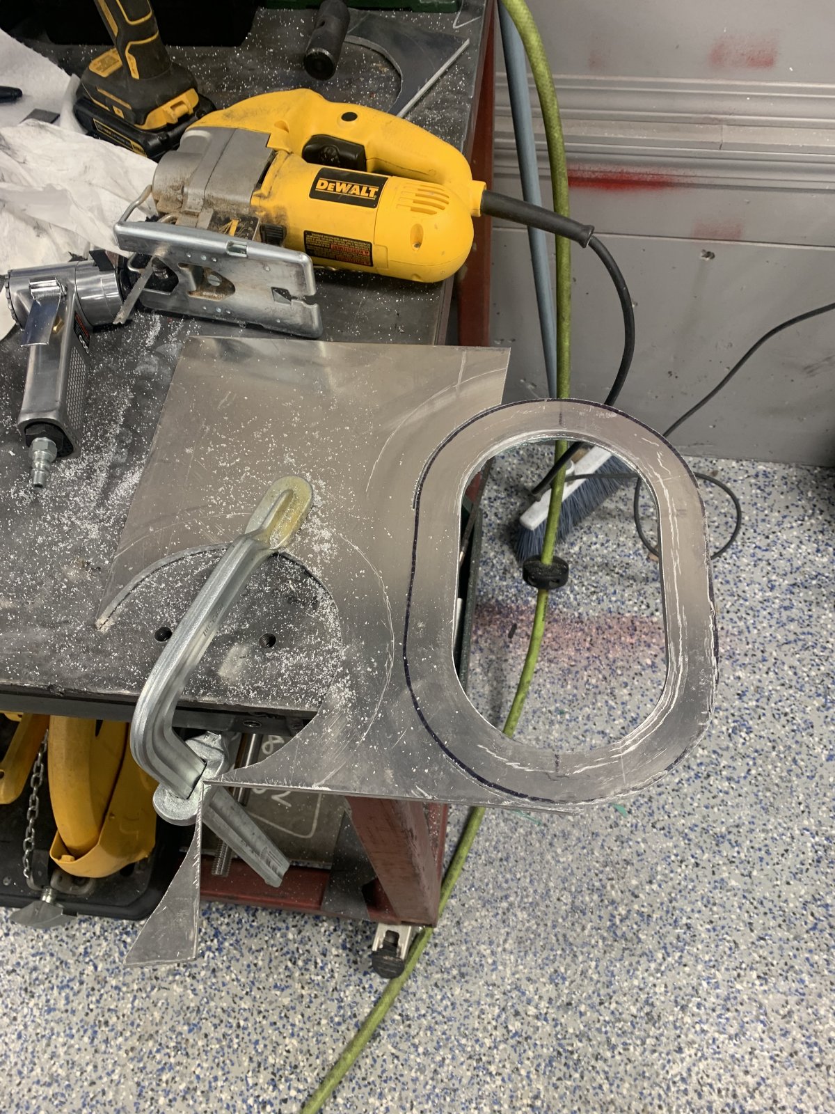

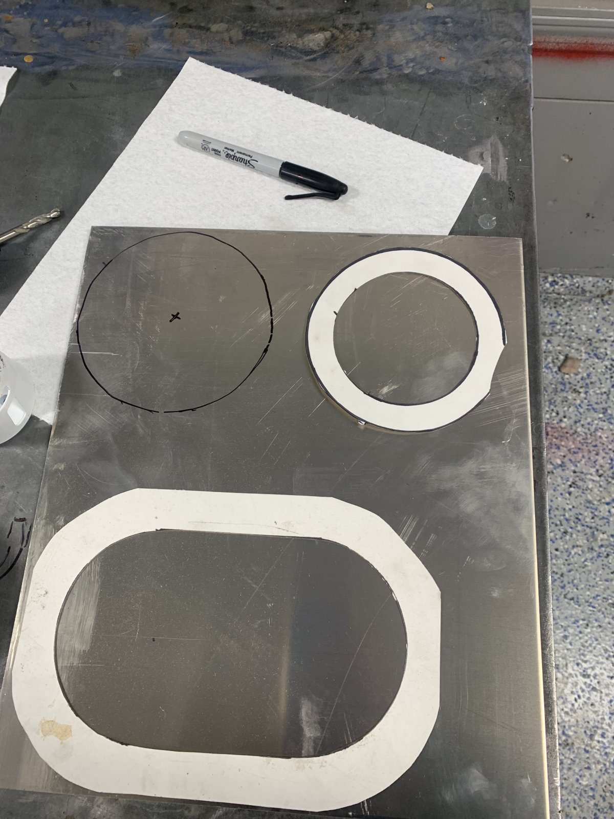

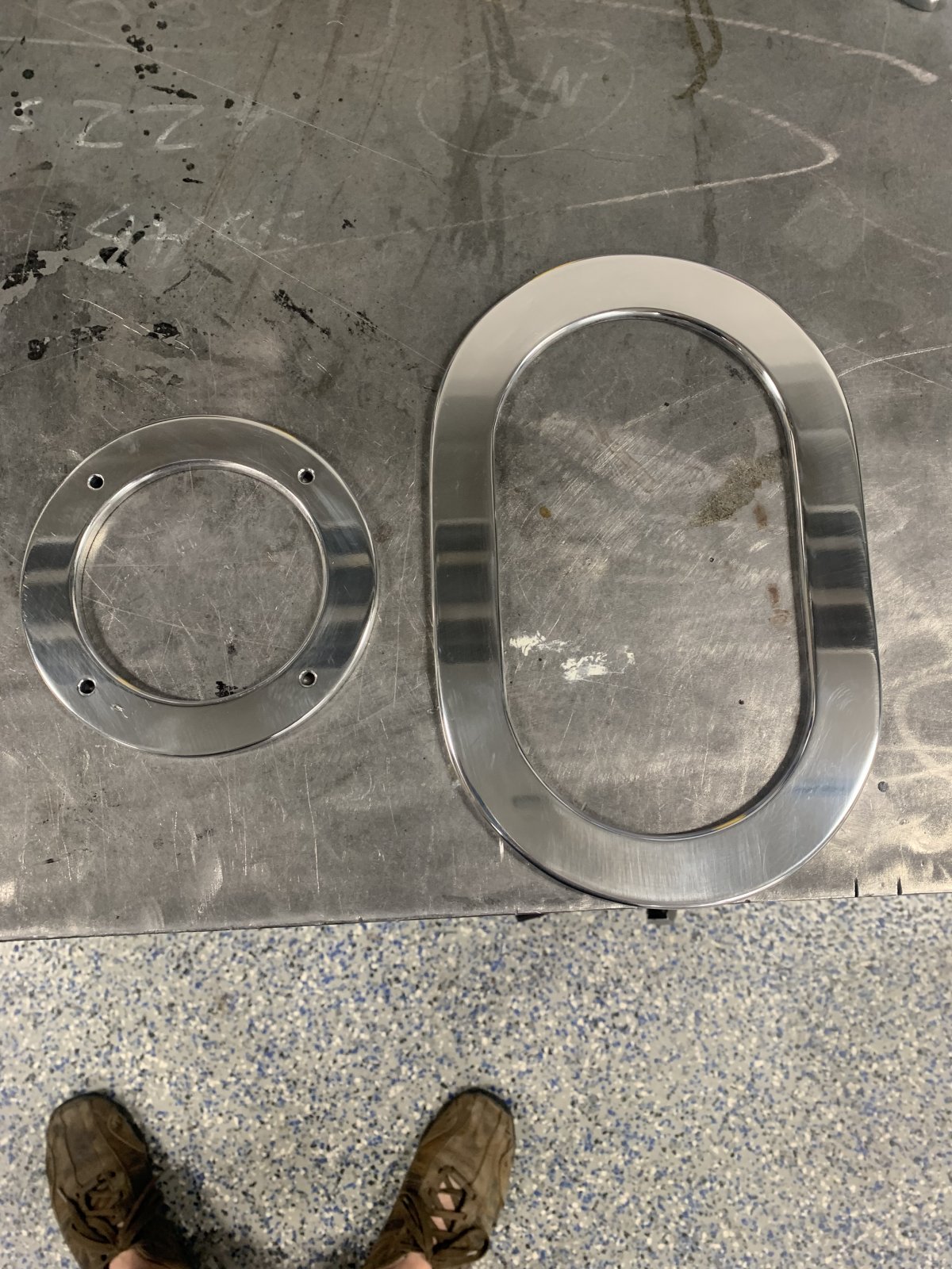

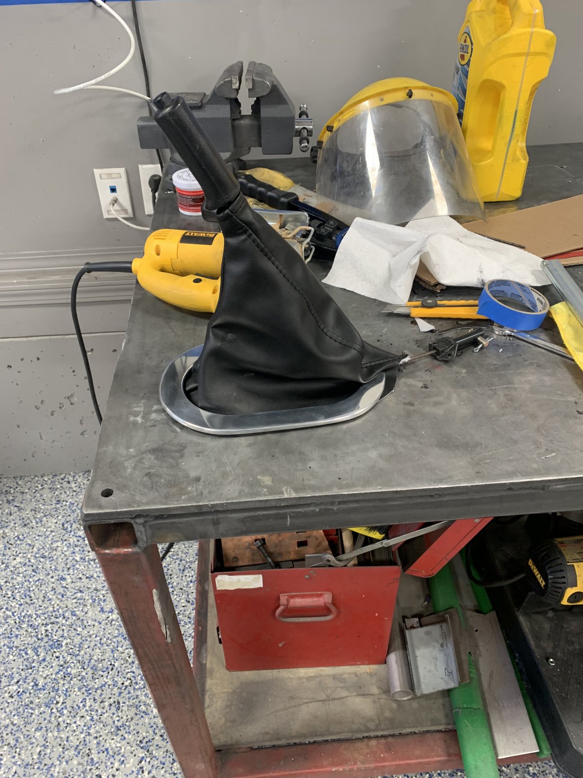

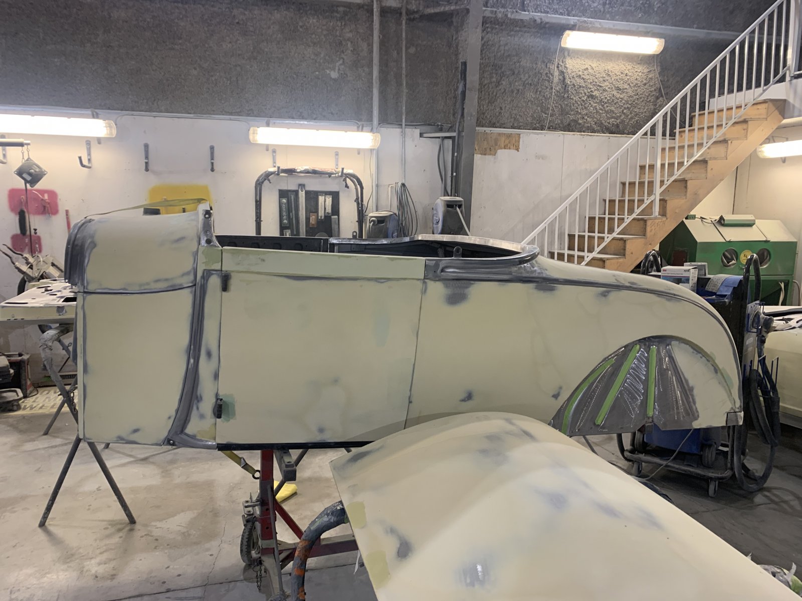

    I have working away on the trim rings for the shifter and park brake boots. Started out with some 1/4 aluminum plate and cut out some basic shapes. Did a little bit of work with the lathe and then a bunch of shaping with a sanding disk. I then polished them up nice and shiny. I had originally planned to powder coat them black but I figured it is always easier to powder coat a shiny part if it doses not fit the look of the car one it’s back together
    The body shop has made progress on the car with all the metal work completed and a skim coat of filler to get it straight. Into primer this week
