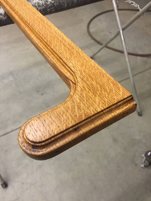

    Spring turned out pretty good. Was able to get rid of the spacer I had and it has a little softer ride now..
    Started to get the wood finished up
    Went with golden pecan stain
    Put a few coats of satin urethane on them
    And the bed strips and bolts showed up so drilled the rest of the holes and installed the wood

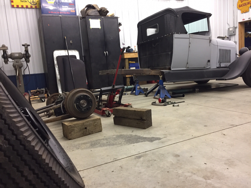

    Been driving the truck for a good while now and I think it's time for it to come back apart and paint it..
    First want to get a few issues fixed and tested.. always had a good bit of vibration/clutch chatter.. jacked it up and pulled the trans and pan..
    And this is the reason it needs to come apart.. it's becoming a mess underneath from apparently not getting it clean enough from bonneville..

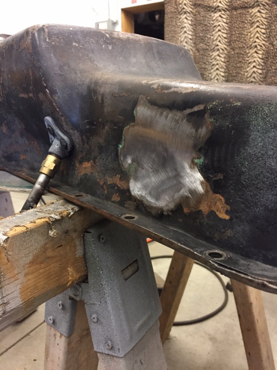

    I have a two piece pan for it that I finally located the back part of awhile back so it had some less then great repairs on it..
    Cut off whatever the port was toward the front of the pan and closed it back off..
    Ground out and rewelded around the starter plate
    Took the flywheel down to a buddies truck repair garage and had it resurfaced... had a few hot/hard spot in it... came back and tossed the original pan back on while I wait for gaskets and new front shocks to come in the mail...
    Good news is it is like a whole new truck now.. clutch is smooth with 0 chatter..
    Front friction shocks should be here Saturday/Monday so get them on and working.... and make/buy some new bushings for the rear spring..
    After few test miles I'll start to strip it down to clean it all up and paint it..

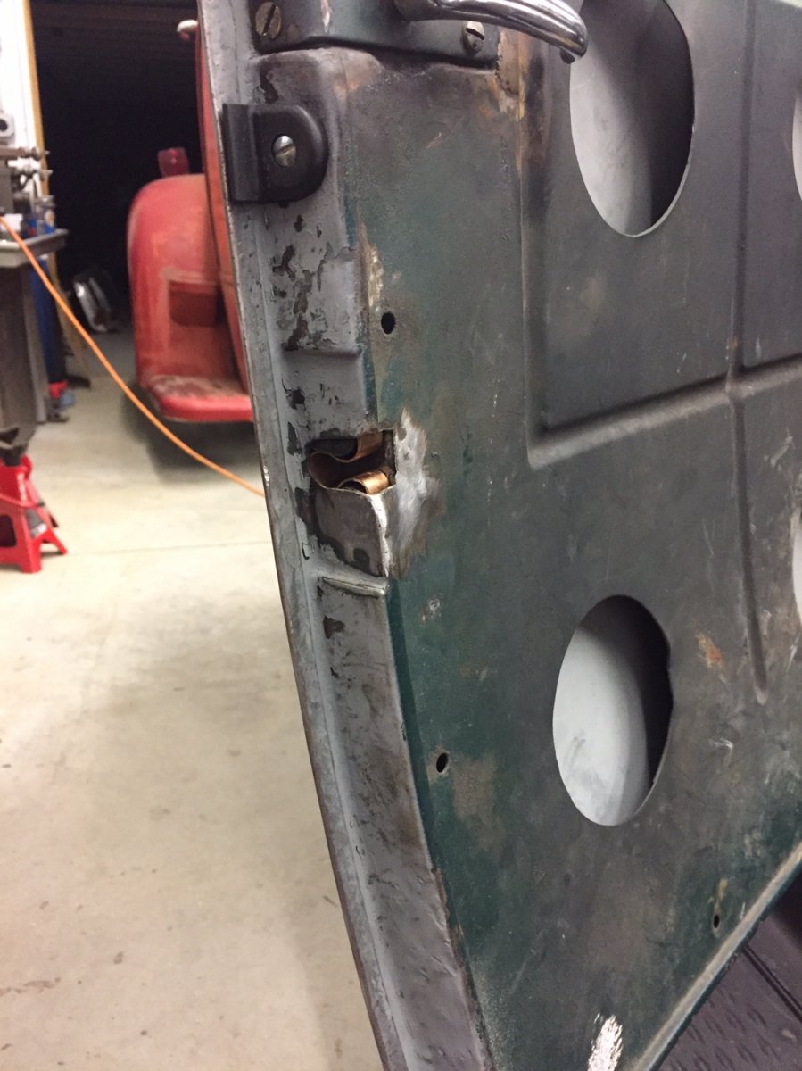

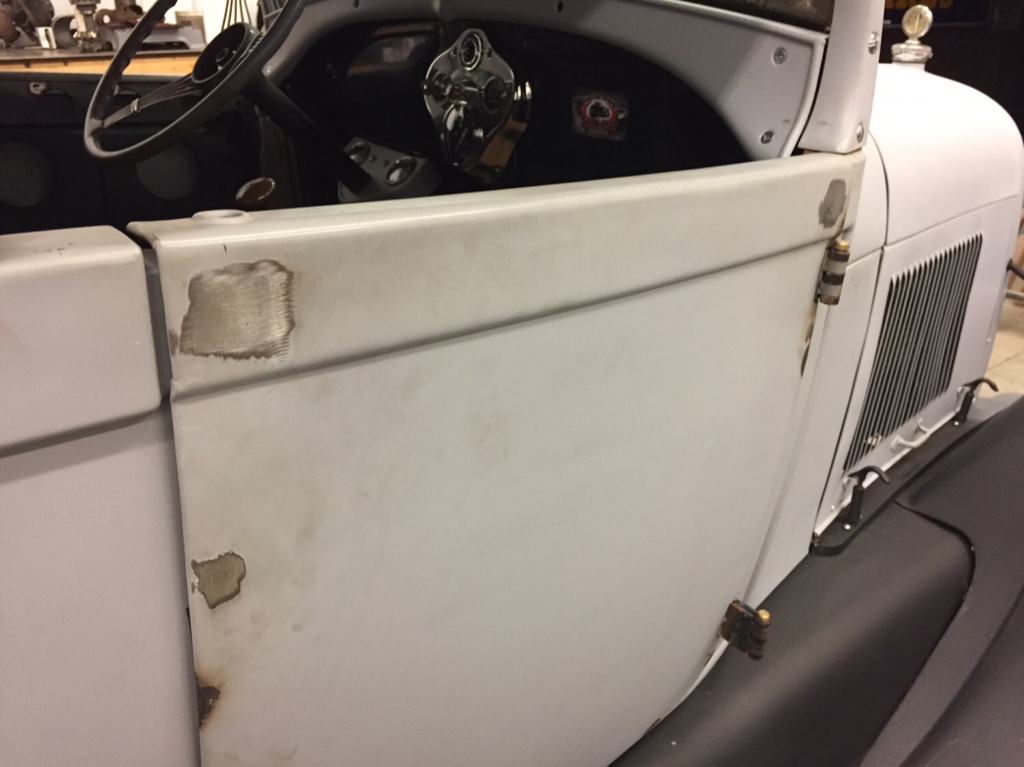

    First was the doors banging around since I didn't have the dove tails on the quarter or the rubber bumper on the door.
    The drivers door was torn up im guessing by how far off the body used to be and how flimsy everything ways.
    Had a heck of time getting the rubbers and the clip in the door.. was trying to put them in from the side.. figured out a little Gibbs on the rubber pieces and pushed the clips straight in not from the side..

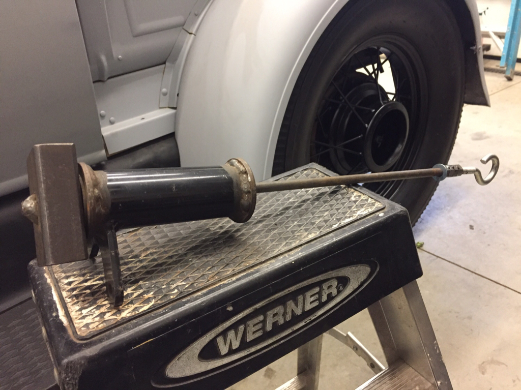

    Next thing was the hokey throttle return spring I tossed on. Just had it wrapped around an intake bolt.
    Bought a throttle cable bracket from stromberg and cut part of it off..
    Much better

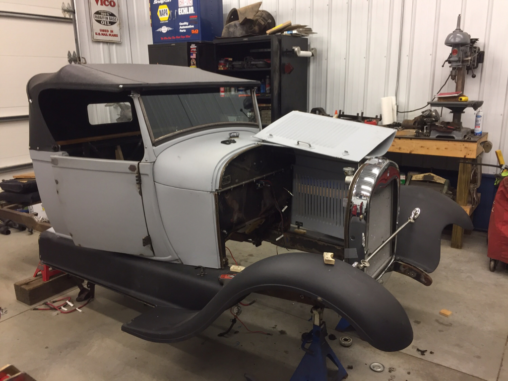

    Next was the hood.. the bottoms stuck out not really sure why. From what I remember the hood shelves didn't fit real well.. so made these little pieces to attach inside the hood to hold it in again the inside of the hood shelf.
    Before
    After
    Messed with the jetting since it seemed like it just kinda lost acceleration just above 60.. which was fine since I always had a shame about that speed..
    Ended up going back to what the standard jets listed on strombergs site.. 45 mains and 65 power valve. Going to try a 64 power valve to try and pickup the top end a little..

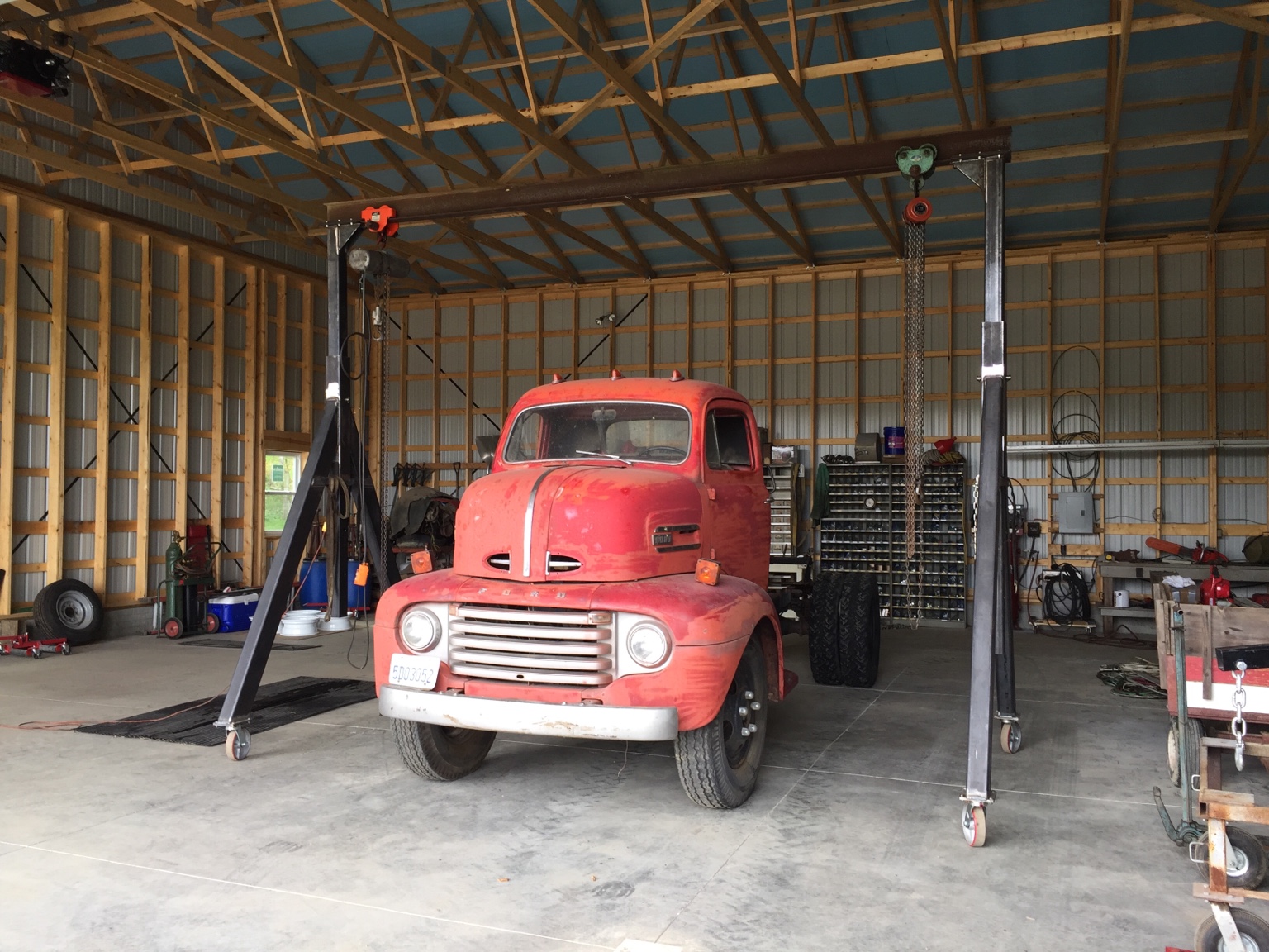

  17. twenty8tudor
    Joined: Oct 5, 2010
    Posts: 889
    twenty8tudor
    from Ohio
    Well I finally have some of the other things I have been working on done enough to move out.. think it's time to start back on the Rpu..
    Going to start by fitting the better rear fenders I have for it and fixing some small things along the way and get some paint on this thing finally..
    Been to sidetracked lately for some reason so hopefully get back up to speed working on this thing.. hopefully painting this thing during the winter won't cause to many issues..

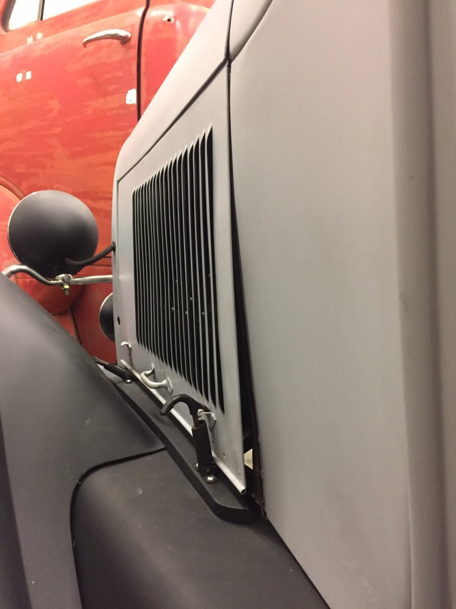

  22. Dean Lowe
    Joined: May 20, 2008
    Posts: 22,042
    Dean Lowe
    Loosen the latch screws, and slide the hood shelf 1/4" closer to the cowl and the hood will lay where it's supposed to.

    I need to work on them some more..
    I do remember struggling to get them to fit p***enger side fits up against the cowl and the hood still stuck out..
    I was at Snyders antique auto yesterday and knew I would forget something and sure enough I forgot to get they have little rubber pieces that attach to the hood the let the latch push the hood in..
    From what I remember if I moved the drivers side hood shelf over in the rear then the front was way off..
    That's probably the next thing to tackle after I get the rear fenders to fit better

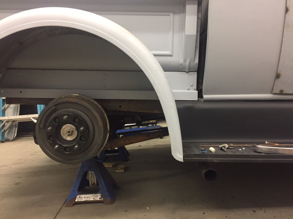

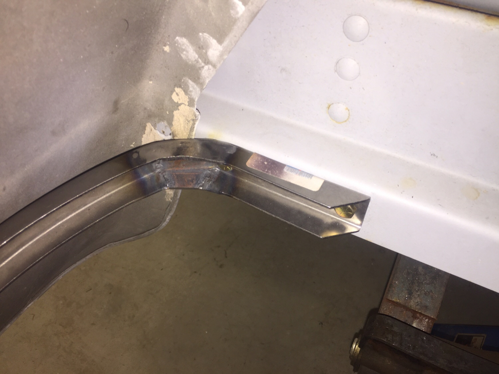

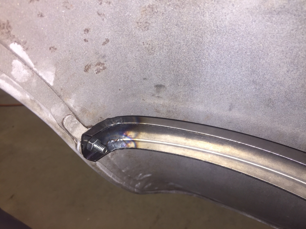

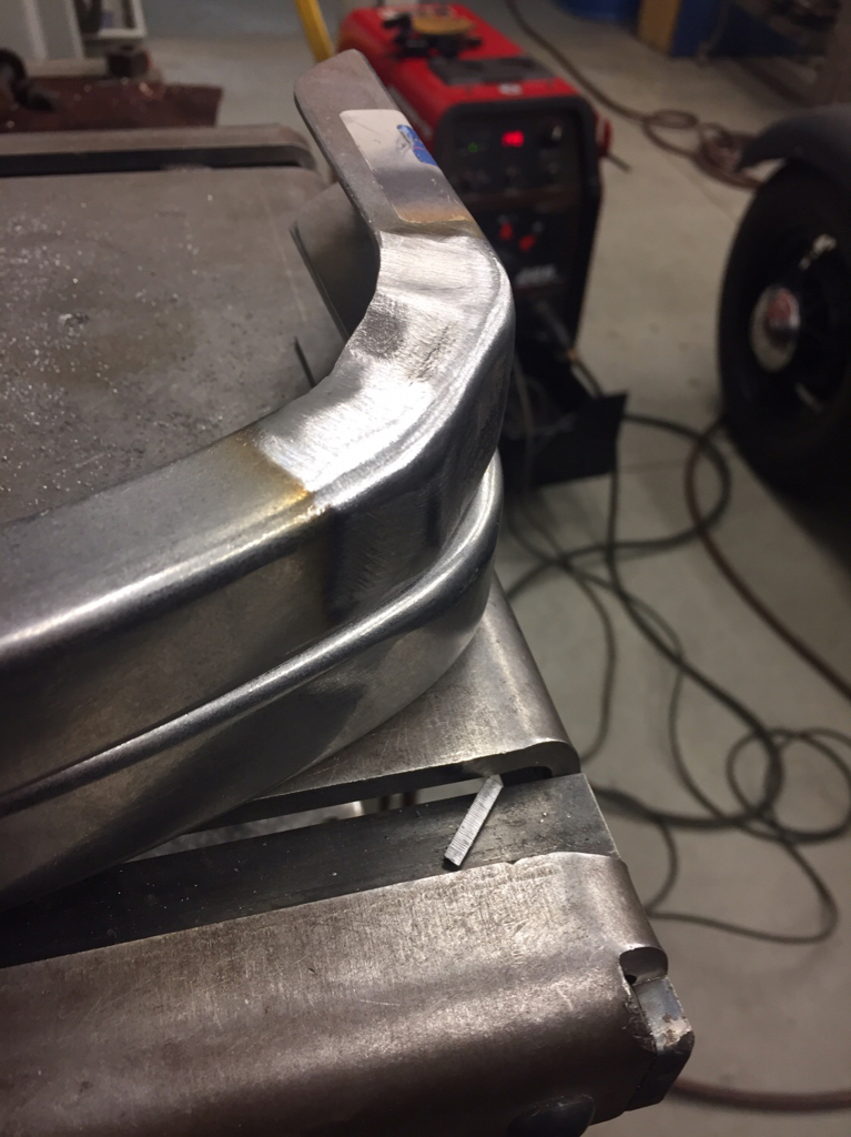

    I do believe I finally have the rear fenders where they need to be after some heating, bending, cutting, and welding..
    This is where they sat when first bolted to the bed..
    Ended up taking the board that's under the front of the bed that came with it out.. it measured 2"x3.5" put a new piece of 2x4(1.5"x3.5") also cut off about 1/2" of the bottom of the bracket where the front bolt goes down through so it didn't hit the frame..
    Next was the rear fender brace.. with the fenders bolted on the brace would set on top of the wire edge at the inside lip.. so much so the brace wouldn't sit flat against the bed.. so out comes the bandsaw again.
    Just took a little reshaping of the angle
    After that then the end of the bracket didn't have the right curve to it.. easier fix for that.. just a few slices and the shrinking heat of the weld.
    Next little thing was filling the holes where the side curtains would attach..
    P***enger side went really well but the drivers side the front shrank a little bit when I welded it.. so buddy told me about using a washer a long time ago and it worked way better then the stud gun.. had to whip up a hook attachment for a slide hammer I made a long time ago..
    Was in probably 1/8"... with pulling and hammering the door edge should just need a slim coat..

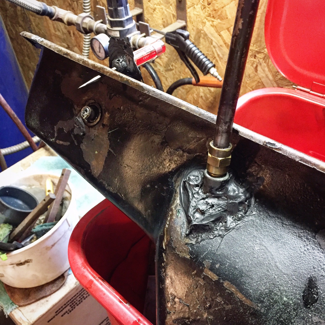

  26. twenty8tudor
    Joined: Oct 5, 2010
    Posts: 889
    twenty8tudor
    from Ohio

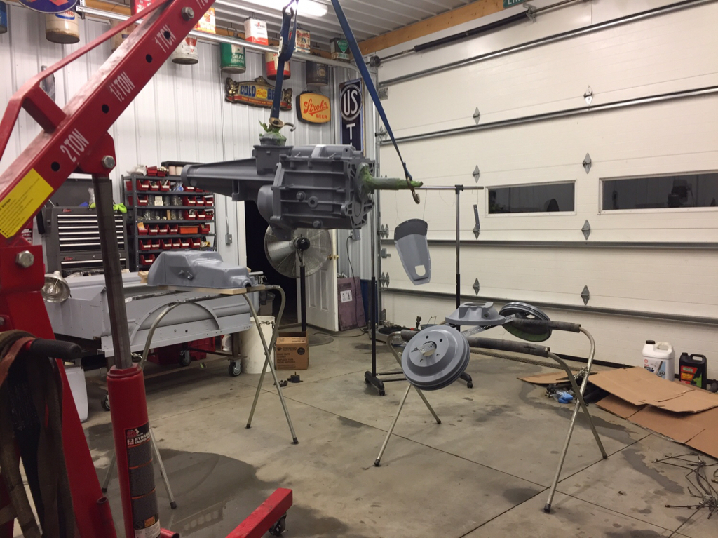

    Little more progress...

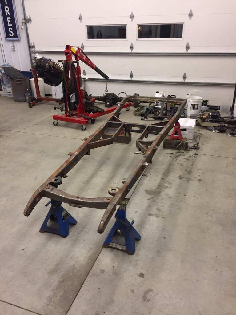

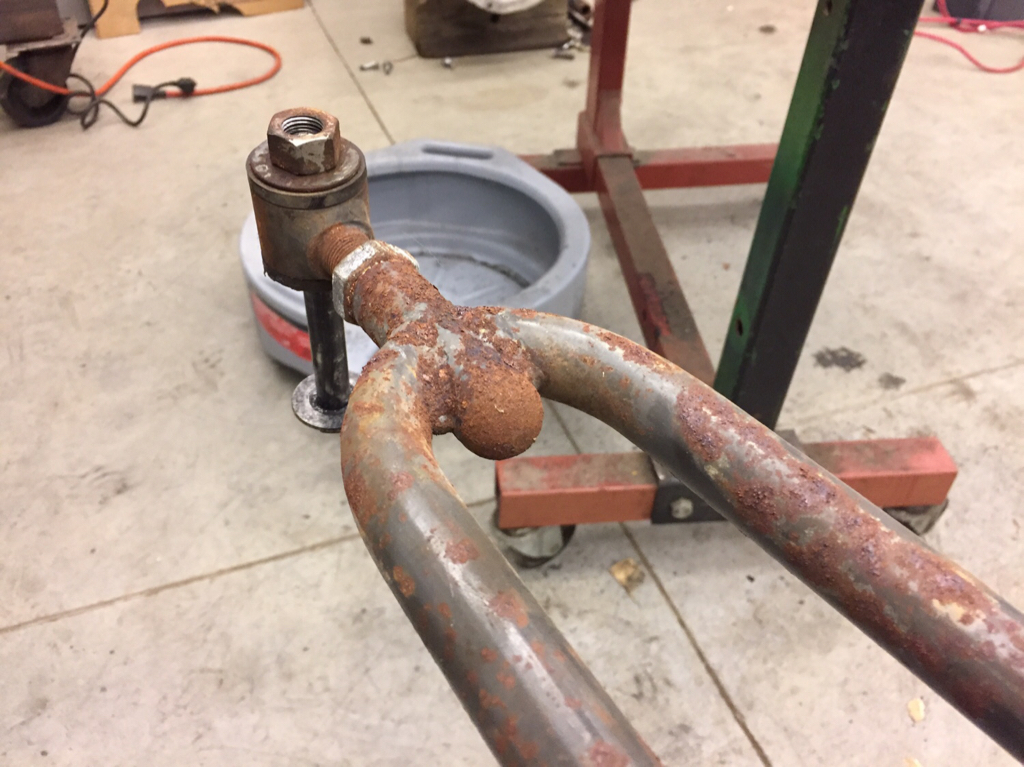

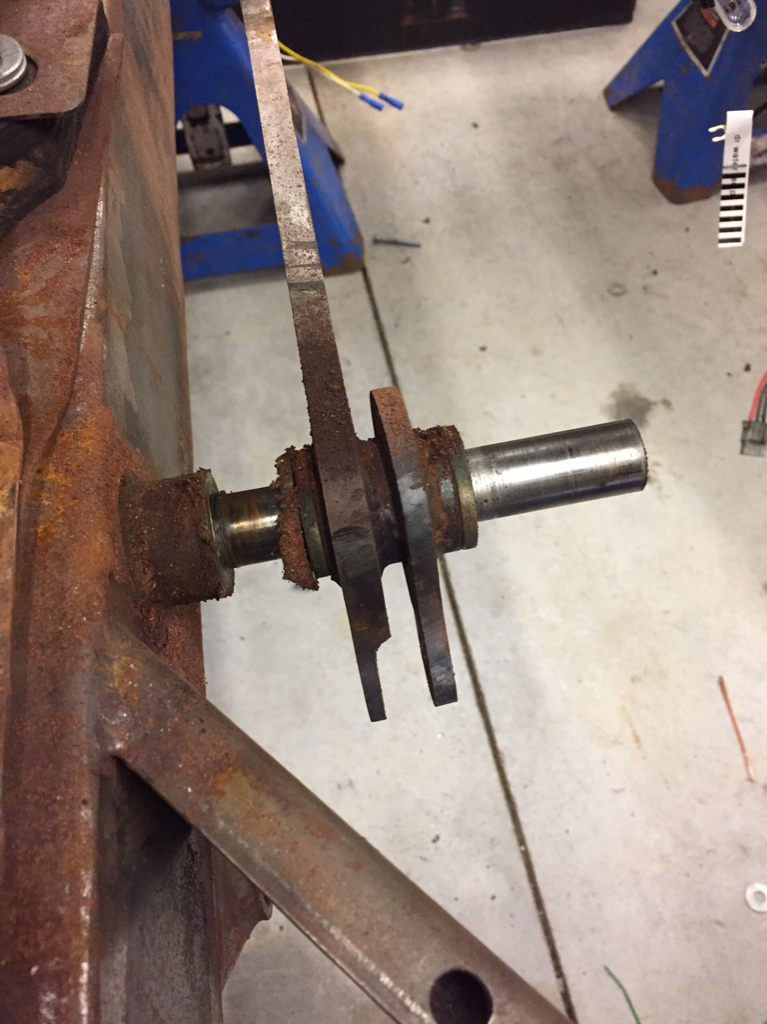

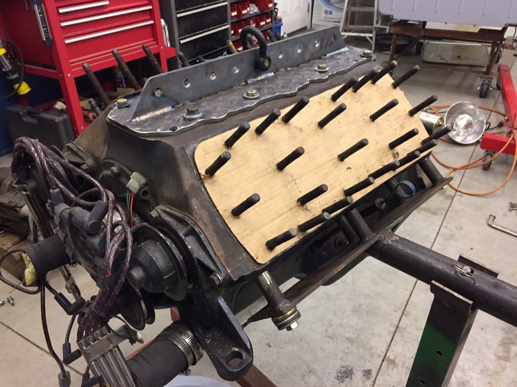

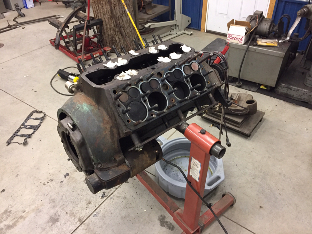

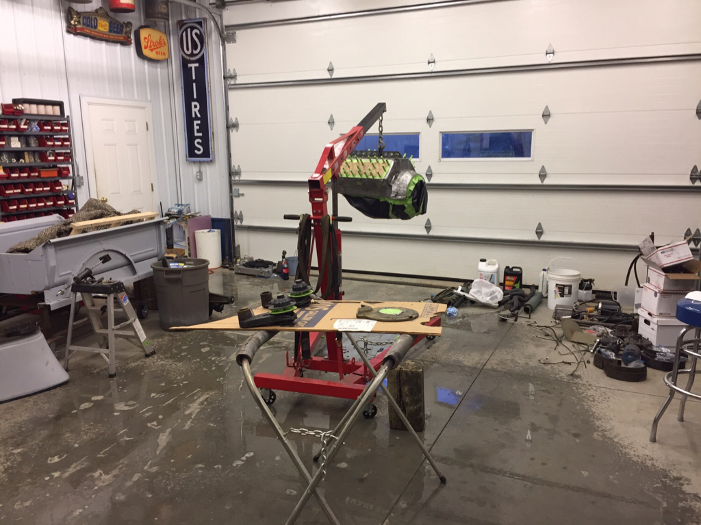

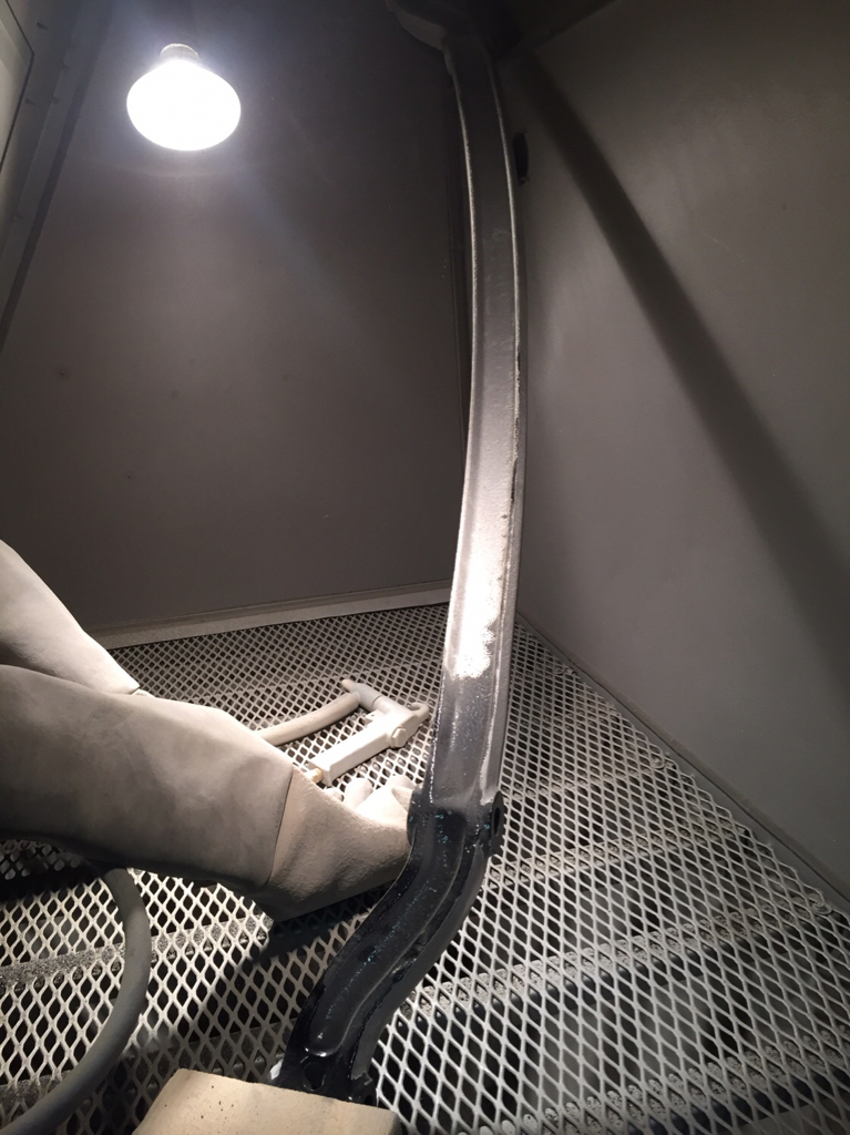

    Thought I had cleaned most all the salt off it.. still finding it as I take it apart
    Since paying the blaster by the hour I'm trying to save a little time by making a cover for the 9"... plus figure it won't hurt to have a cover laying around anyway.

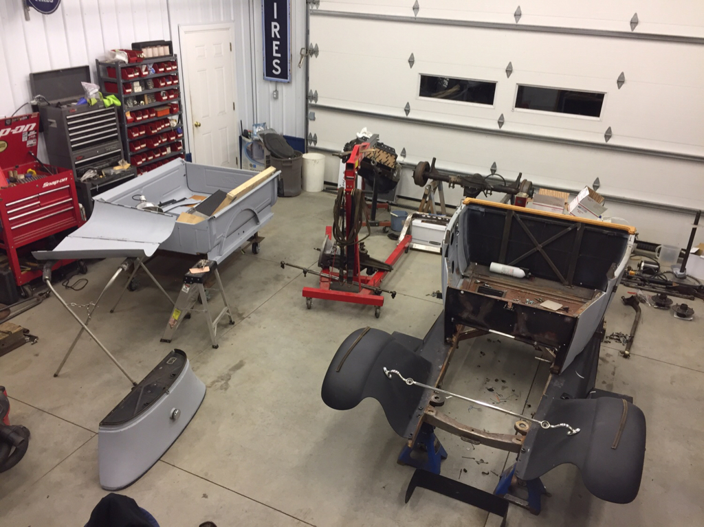

  27. twenty8tudor
    Joined: Oct 5, 2010
    Posts: 889
    twenty8tudor
    from Ohio

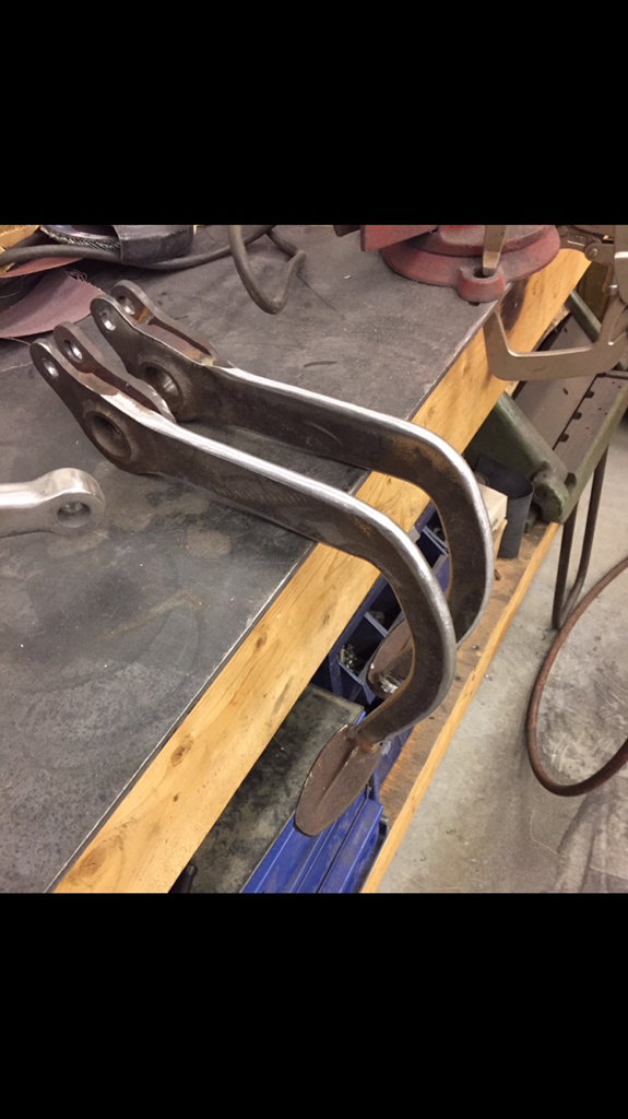

    Wanted to round the edges of the pedals so they didn't look like a cut out piece of plate steel..

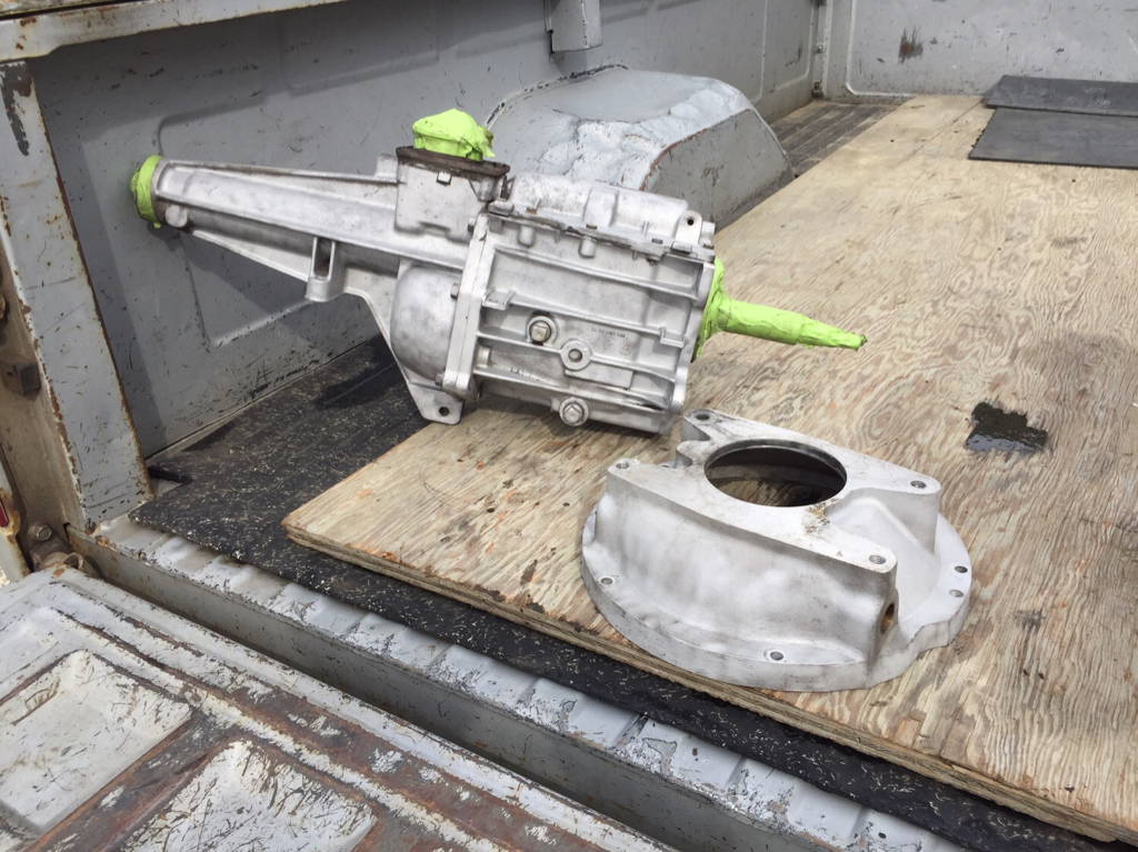

    Loaded up and dropped off to the blaster yesterday morning..
    Going to try my hand at doing some electro plating for some of the smaller parts.. see how that goes..

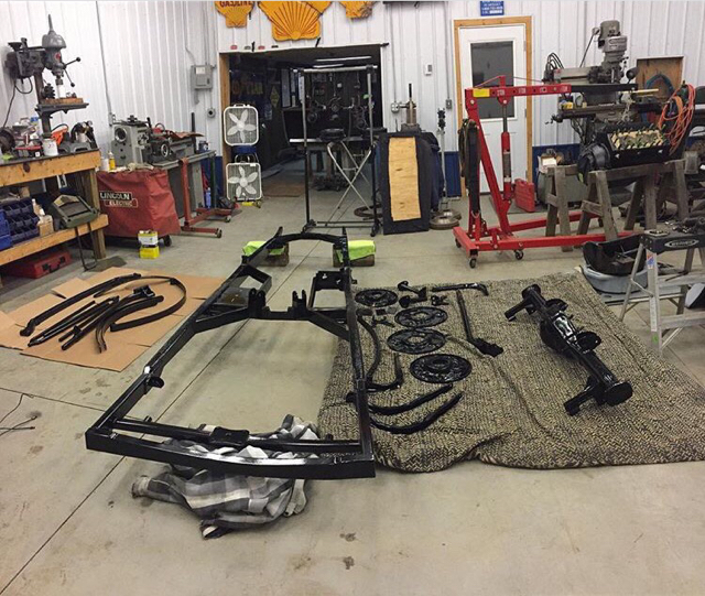

  29. twenty8tudor
    Joined: Oct 5, 2010
    Posts: 889
    twenty8tudor
    from Ohio

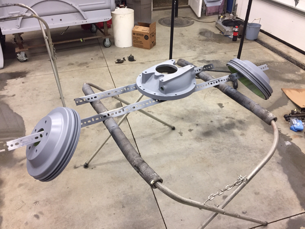

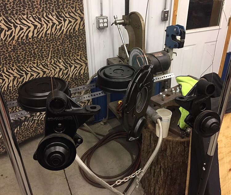

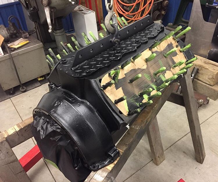

    Finally getting some color on things..

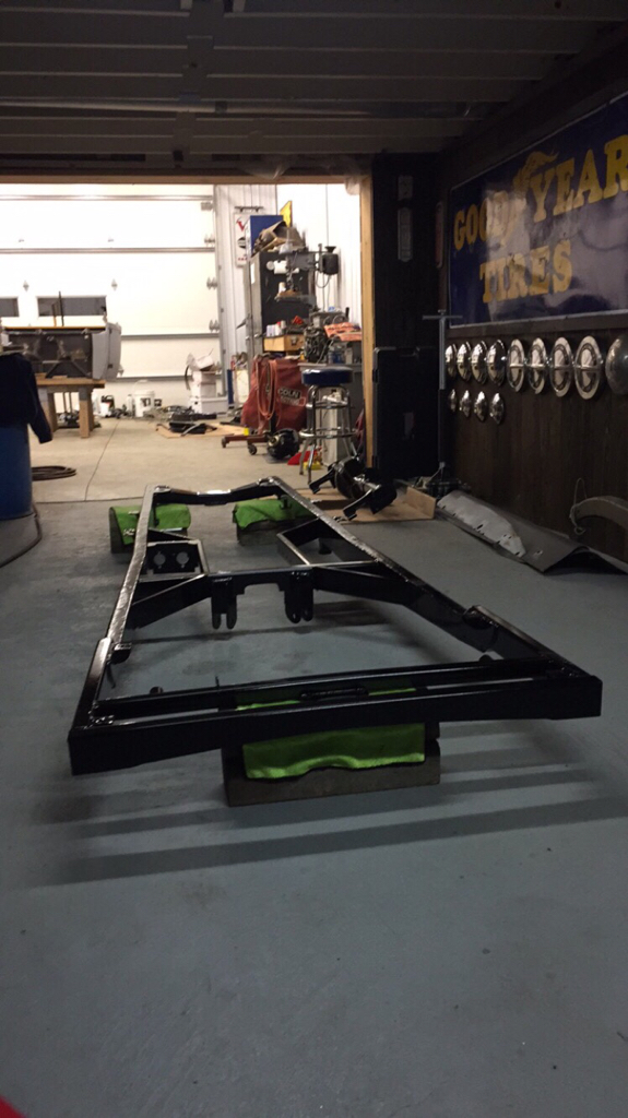

    Miss communication with the blaster and he painted the frame and parts gloss instead of satin..
    Painting the motor and few other parts satin black..
    Hope to get few other things painted so I can get the ch***is back rolling again

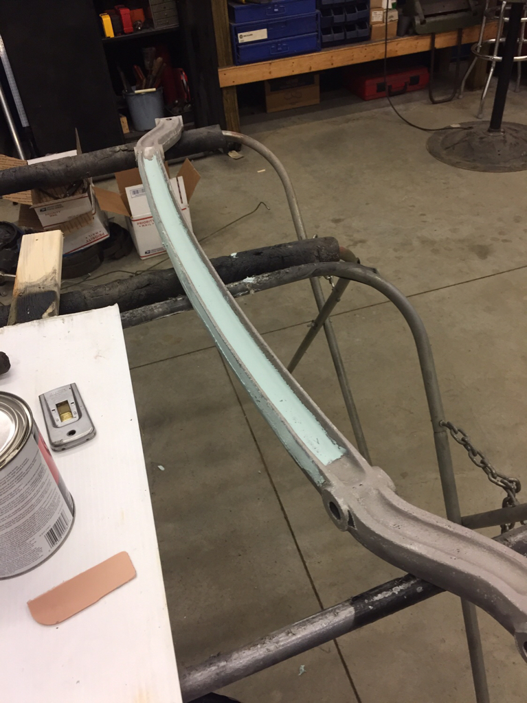

  30. twenty8tudor
    Joined: Oct 5, 2010
    Posts: 889
    twenty8tudor
    from Ohio

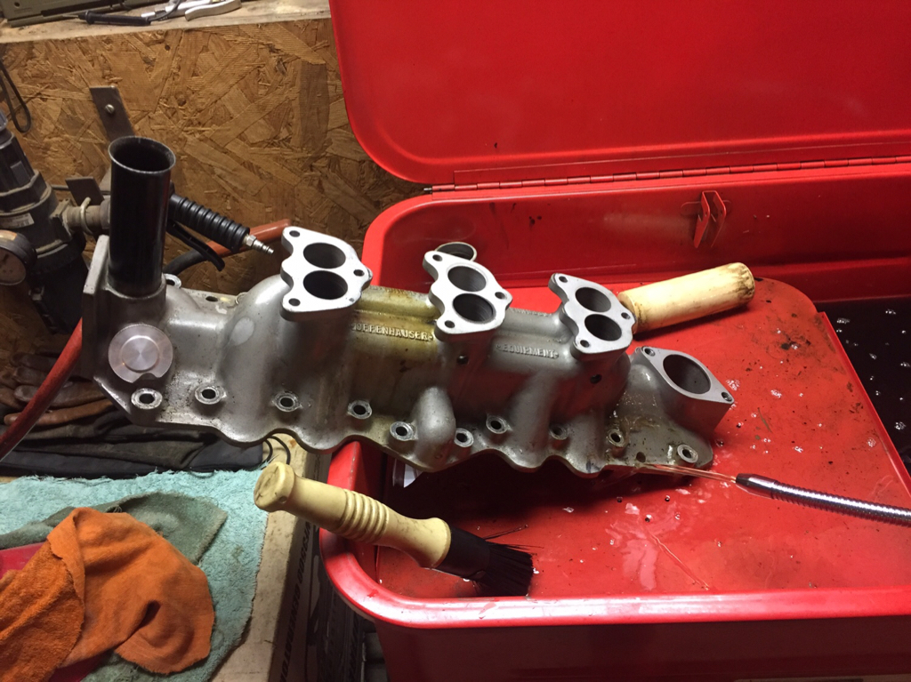

    Well making some progress on the truck..

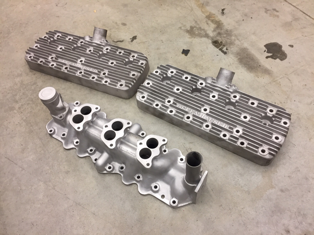

    Had a guy in Columbus polish the intake and heads.. try to make things a little bit cl***y

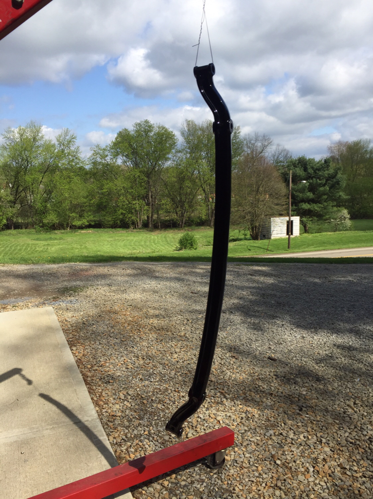

    Wasn't happy with how the front axle looked since there was so much pitting on it.. the gloss black made it look 10 times worse so I blasted it and painted it myself..
    Much better
