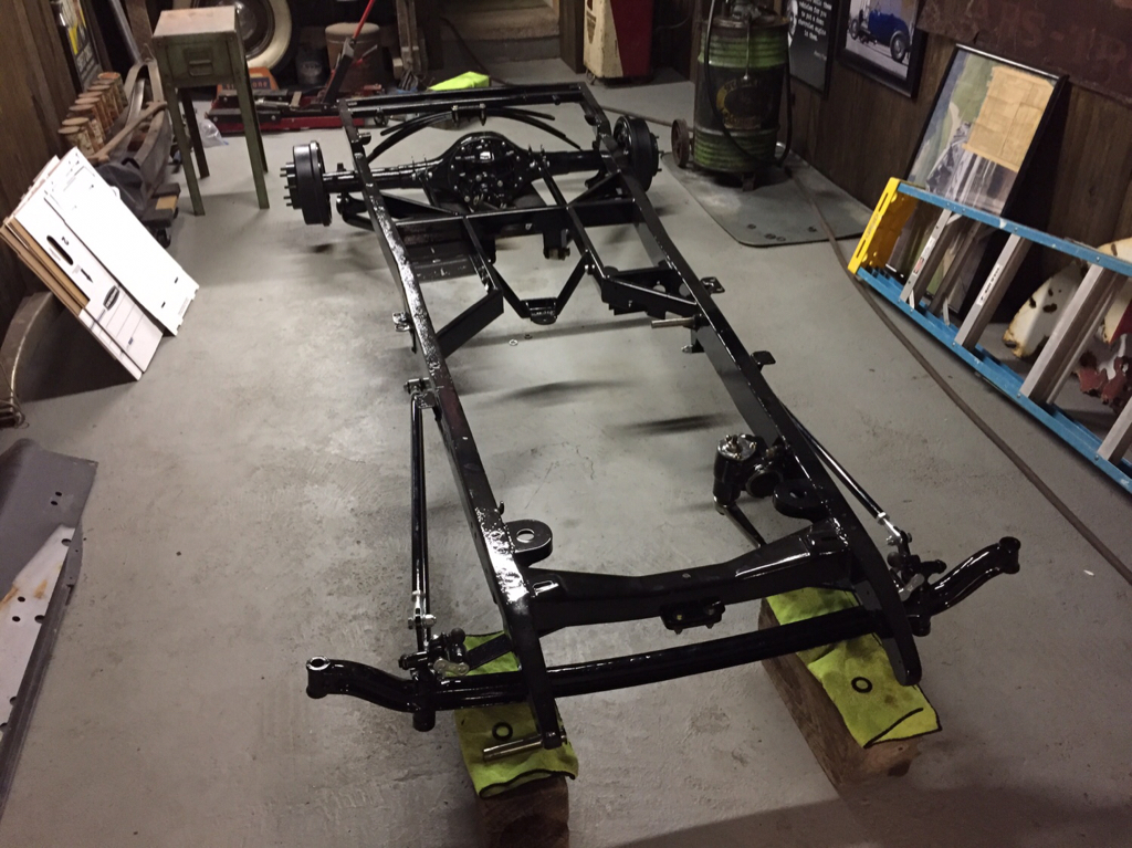

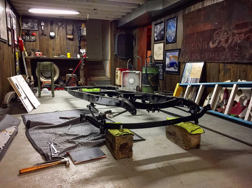

    Had to make some new bushings for the rear spring since the others were just a quick temp last time.. some hard plastic s**** I turned down and some bronze sleeves from the hardware store.
    Painted up the center section of the 9"
    Need more room it's like a mouse maze trying to work in here
    Bedroom floor joist came in handy..

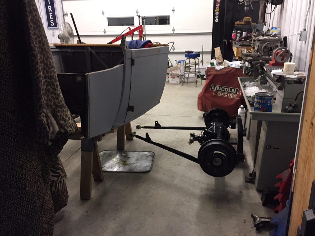

    Out all the brake and hubs on so it's rolling again.. probably try to put the motor in and work on redoing the brake lines this weekend since the salt ate up the fittings

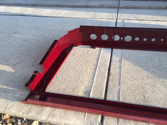

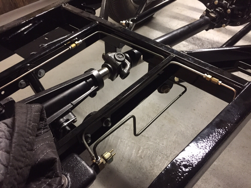

    Started redoing the brake lines since the salt ate up the fittings..
    For some reason the new roll of nickel Cooper line I bought seems to be a little smaller and it wouldn't flare.. just kept sliding out ten back.. so I had to stick a piece of 320 on the top and bottom of it to get it to hold.
    Took a few different options before fining a route I liked.. still need to add a few clamps to hold it up but it's routed way better then before.. feels like building it all over again
    Took a few tries to get the drivers side rear to fit the way I wanted also.. but should be good enough to bleed out and check for leaks..
    Went ahead and hooked the clutch up and bleed all the air out of it, so that's a step in the right direction..
    Going to try and get the heads torqued and steering out back together next.

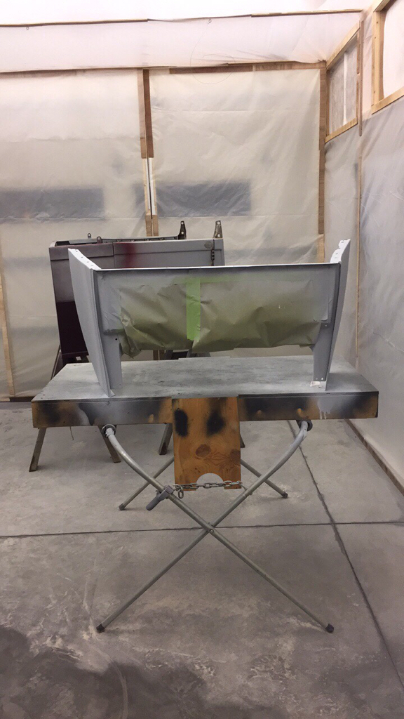

    Now just working on the splash aprons and cowl panels
    Also blasted and primed a few of the inner structure and fender braces

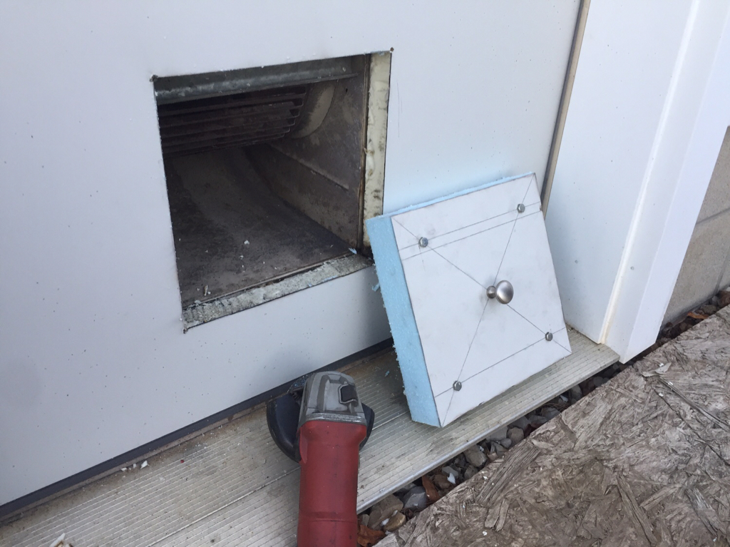

    Don't remember if I had posted it or not but here is the little booth I put up to try and keep dust/paint contained.
    Bought a cheap exterior door so I could cut it and mount the exhaust fan to it.
    Made a box that hinged up on the ousted to get the stuff away from the house

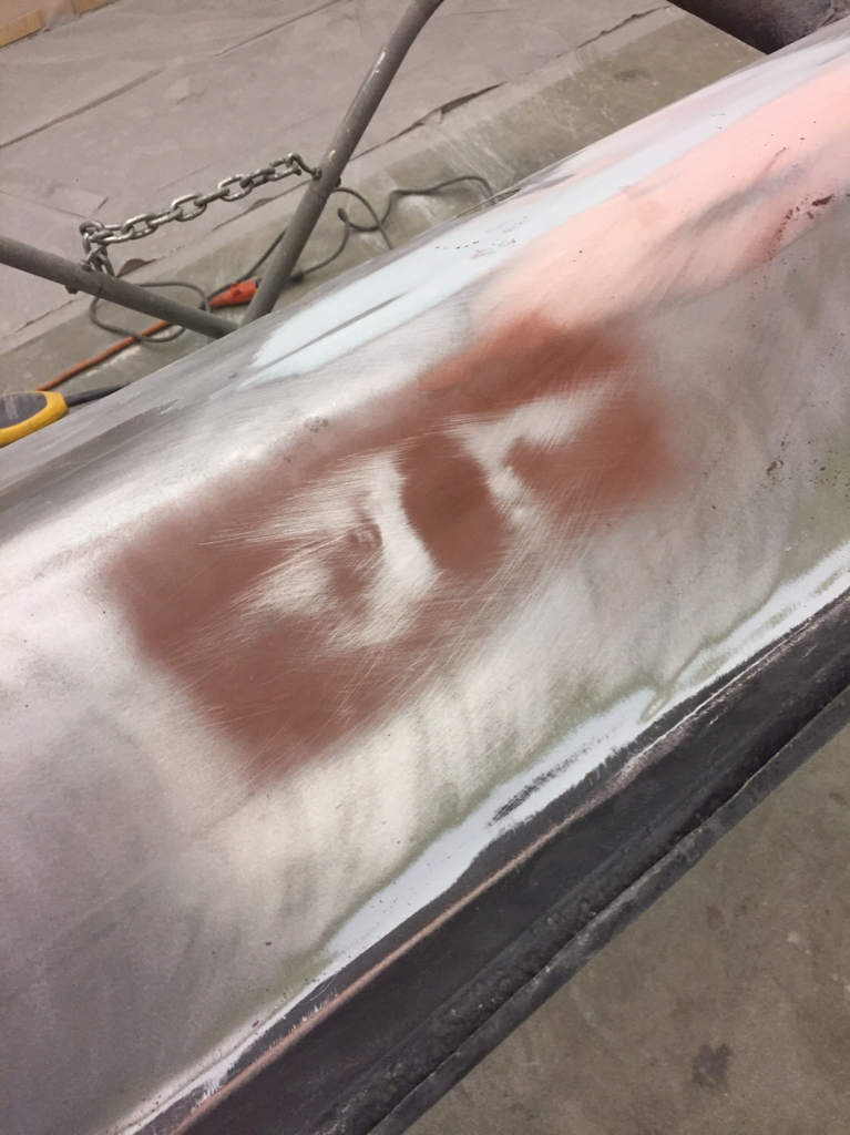

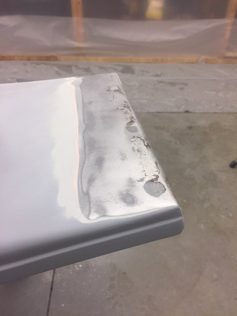

    Making a little more headway..
    I think I finally have the front fenders all smoothed out.. just one last sand with 400 before putting some color on..
    I goofed up way back when sanding the body lines in the fender.. had no clue what I was doing..(still don't) but on breaks and lunch at work I always watch videos on how people do things.. so taped off the lines and started sanding.. took a few p***es but cleaned them up..
    You can see the little line there but they were all over the place before..
    Put one more light coat of primer on and flipped them over to make the braces for the corner underneath..
    Second one always is easier and goes faster..
    Gong to clean it up and use panel bond on them since I can't spot weld them on now that they are covered in primer..
    Then hopefully I can get the underside covered.. still on the fence if I should just go with paint or go the thinned raptor bed liner route..

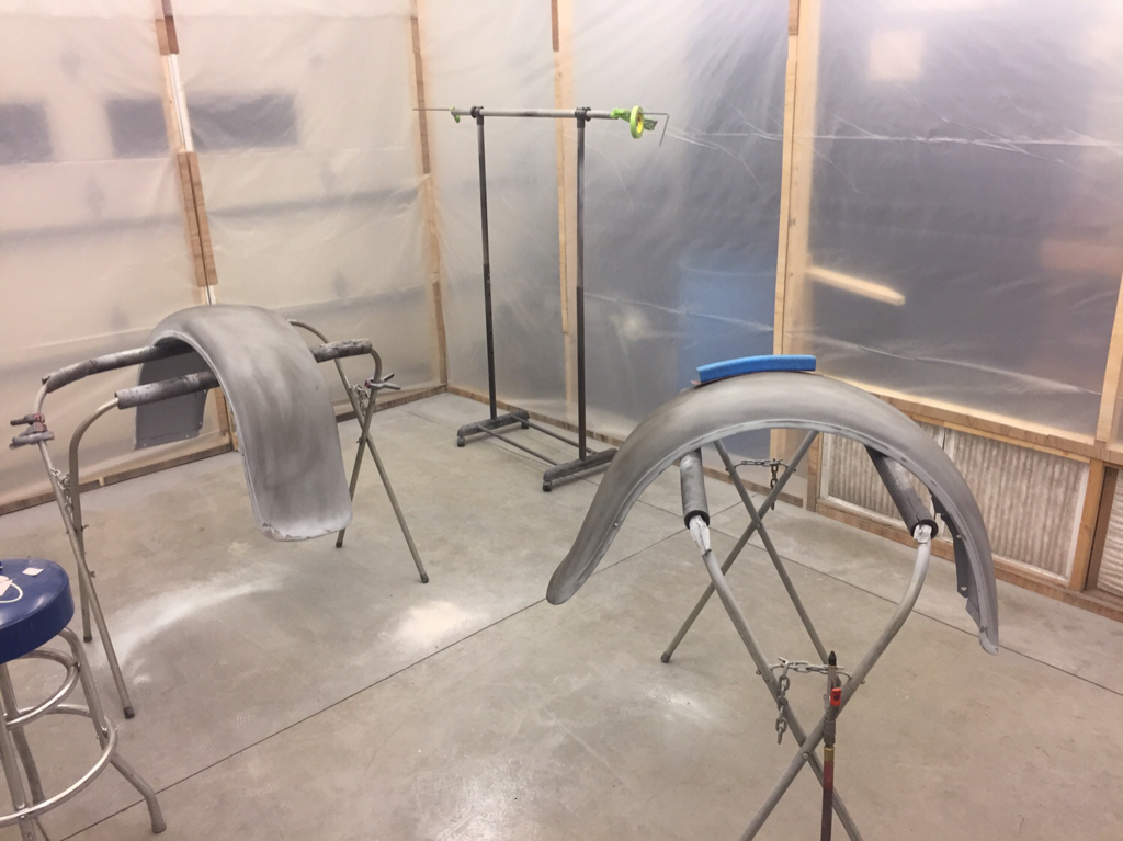

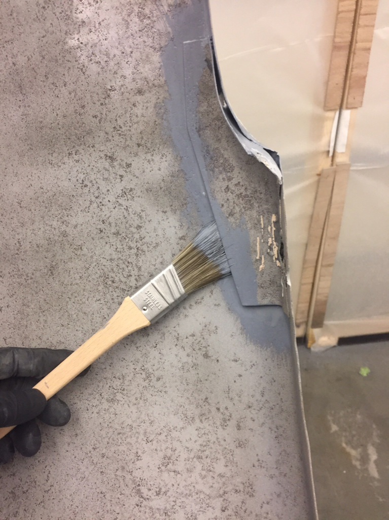

    Little more progress started working on the rear fenders
    Brushed some epoxy underneath pieces to try to protect it a little more
    Also brushed up under the wire edging all the way around.. then shot some epoxy then 2k primer on the underside
    I thought I had these pretty well straight but found a few lows and a few highs on the first round of blocking
    Few more coats then i let it dry for awhile
    Tapped off the areas for seam sealer
    Couple coats of black and then mixed up some clear with more flattening agent in it.. went with what the tech sheet called for to get a flat finish.. 51oz per sprayable gallon which works out to be 40%
    Still seems almost to be a satin finish still..
    Maybe I'll try 50% and see what I get there..

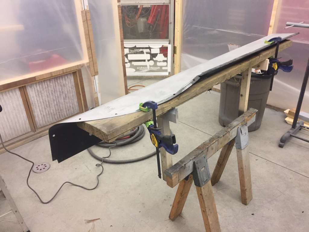

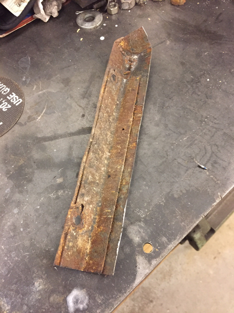

    Which leads to the next issue of the splash/fender apron debacle..
    Somewhere along the line the drivers side had gotten flattened out quite a bit..
    Not sure if it happened when it was getting sand blasted or me pushing to hard when sanding.. luckily a local guy had one in better shape..
    Which while trying it out it fit better but was to low.. other one was also but not quite as bad..
    Ended up having to put a spacer between the running board and the bracket to space the board up some..
    So this time I screwed down a board and laying the apron flat while I sand and do body work to it..
    So hopefully get this thing worked and in primer so we can spray the back side of these and the column.

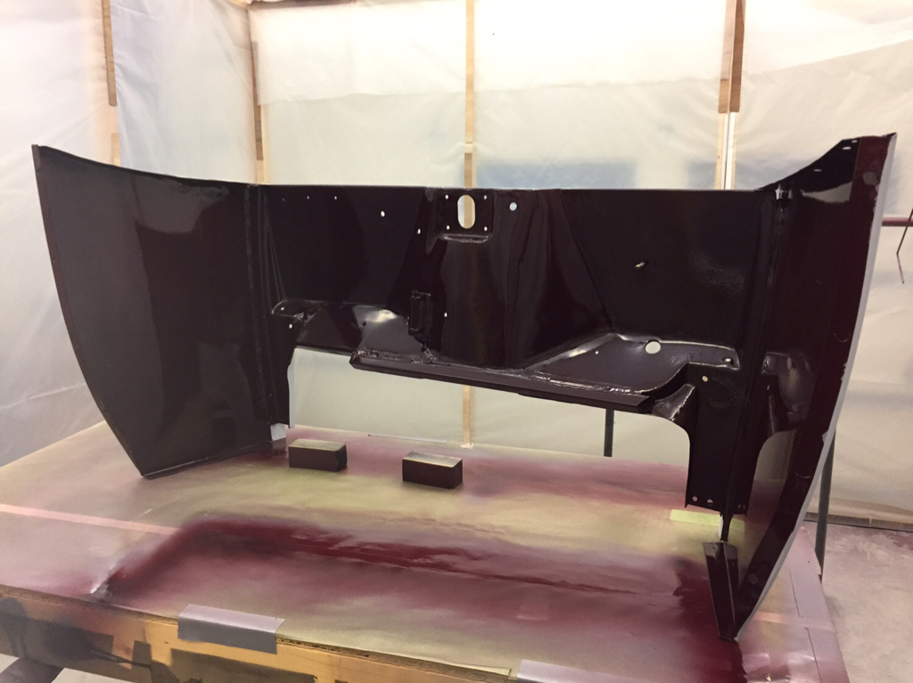

    Buddy came down and we come to the conclusion that I was spraying it way to heavy along with to many coats..
    Mixed it at 50% and only a couple light coats.. I was putting in one light coat at first then 3 or so pretty wet coats..
    Still has a little sheen to it which is fine.. I can tell this is going to be tricky to get sprayed out even..
    A few people told me that painting something satin/flat is harder then shinny.. now I know why they say that..
    I think I have the rear fenders and firewall ready for color.
    Hopefully soon get the cowl panels spot welded to the firewall so I can get started on the cab..

    Little more progress lately...
    Worked on the running boards some..
    Thought I had them where I wanted them till I sprayed one coat of black basecoat on them...
    There were quite a few spots that I missed and a lot of ruff texture from where there was bits of the original primer.. so I thought it would be quicker to just blast it and start over
    Which resulted it more days and days of sanding after work
    Wanted to let it really dry out so I decided to paint the gauge panel I made and the seat riser..
    Waiting for a good sunny day to really see what it looks like. Need to sand and buff part of the seat riser that is a little orange peely.. switched over to a fast reducer/hardner for the paint and clear to try and keep the dust/dirt out.. seems to have worked well just caused a few sport to orange peel a little
    going to wait a few days for that so I'll start sanding the running boards again and hope to get some black on them soon.
    brEad, slv63, Shadow Creek and 3 others like this.
  29. twenty8tudor
    Joined: Oct 5, 2010
    Posts: 889
    twenty8tudor
    from Ohio
    I was able to get paint sprayed in the running boards on Sunday.. turned out pretty well I think..
    little wavy in spots but I have to just have to keep telling myself that I am going to drive it like before or else I'll be in and endless cycle of stripping and repainting things..
    Took a few days but put some guide coat on and wet sanded out with 400... put a coat of sealer on then the black and clear
    Going to try to either polish out the dry/orange peel on the front of the seat riser or wet sand it and put a couple heavier coats on it.
    Hate to tape it all off again but I'm afraid I'm going to sand through it and end up in a bigger mess.
    brEad, slv63 and Shadow Creek like this.
  30. twenty8tudor
    Joined: Oct 5, 2010
    Posts: 889
    twenty8tudor
    from Ohio
    Few more parts sprayed late last night...
    Ran some seam sealer between the firewall and the cowl panel to try and stop any air from coming in through there.. always had some shine heat coming in but I think that was more due to the floor.. so hopefully carpet will help with that when the time comes..
    5 minutes after I started applying seam sealer
    Painted the inside of the cowl and firewall.. have to finial sand the outside and paint it when I do the cab..
    Subrail extensions and a wiring cover I made that bolts to the top and the extensions
    Probably should have took a little more time to smooth up the inside of the firewall but hoping the guy I have do the interior can make up a firewall pad to match the floor..
    but if someone is ever is digging around under the dash I'm sure some waviness and pitting is not what they are going to be worrying about..
    Hopefully start on the fenders and splash aprons next.. since going gloss need to really make sure they are straight..
