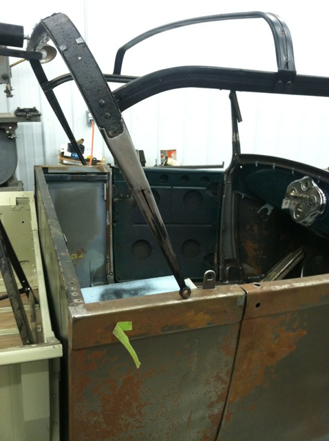

    Removed all what seemed like 1000 staples and removed to top material. Looks really strange without the cover. Thinking about taking a little bit of the rise out of the middle now to make it flatter.
    Now I can narrow it up and shorten the back post. Like to make it where I can break it down like a tent.

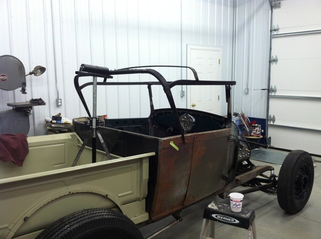

    Started shortening the back post took 2.750" out of them to match the front post.
    Ended up slicing the bottom piece 4 ways to get it to fit
    It had a separation in it on the outside of the post originally so I used that as a guide in where to cut it in the band saw
    After getting it tacked on I straight edged the front and back and needed up having to slice the top part also to get it lined back up..
    It's midnight so this is where I'm stopping for now... Welded the top and ground it down with a flap wheel then hand handed it smooth.
    Next update will probably be when I have all the top cut welded and attached to the quarters.

    Thanks!! Finding out roadsters can be a pain to get all lined up after being blown apart..(or hacked together before) haha
    Anyway top is back in order just need to finish fully welding it up.
    Knocked out the rivets in the back bow so I could narrow it by 1.5"
    Lightly shaved it down in the bandsaw then sanded it down so the sides would fit back on
    I narrowed the front a little more so it followed the body a little more and didnt overhang so much tacked in place and set it back on
    I slid the front down a little farther on the post and also moved it forward a little to clear the window and over hang the front a little more. So I had to rework the top mounts in the front. Junk flat steel hammer and an old chunk of steel with a recess in it to form the curve.
    Cut some extensions and welded them to the old mounts
    Slapped the old cover back on with a few clamps and staples. Top pic is the day I brought it home to compare the difference.
    And here is how it sits as of midnight tonight.. Hope to finish welding it and maybe start on the pedals this weekend
    chryslerfan55, bct and Kiwifruit like this.

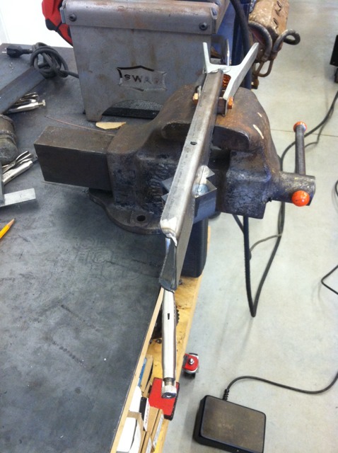

    Was able to get one more little thing done today.. Where the masters are under the floor the rods were going to hit the leg of the cross member..
    Cut the leg off to work on it easier.. Already had done the first one which took some time to figure out..
    Had to cut one side of the angle iron short to make the small c channel
    Tacked in to make sure it was in the right place and angle(first try the angle was way off)
    Cut both front and back on the portable bandsaw
    Ground the welds down and blocked it with 60grit quick
    Now to get a column and start on the pedals
