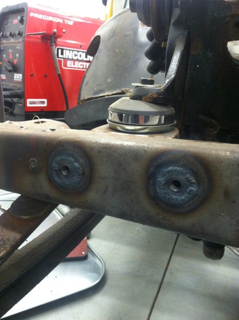

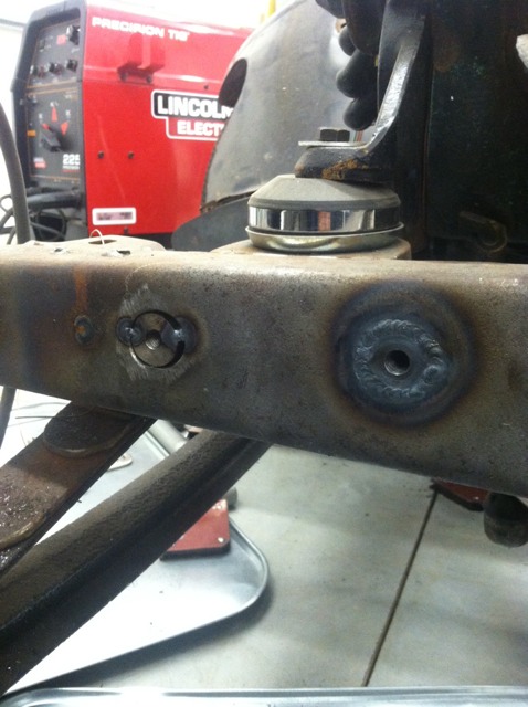

    Going to reuse the front shocks over.. Seem to be in good working order and it looks as if someone has been into them before or at least put new oil in them.
    Someone had went through a lot of the mechanical parts on this truck..
    And a genius that will remain nameless welded nuts to the inside of the frame for the shocks when boxing the frame and they were off a little bit and had to be moved away from each other to be able to use allen head bolts.
    Drilled the holes out to 15/16 and made some bungs to weld in on the lathe. Had to oval the holes a bit to get the bungs in the right spot
    Welded them both in and bolted the shock on..
    A little trick I figured out while doing this was I had a hard time getting the tap started so I put a deburring bit in my cordless drill and used it to chamfer the hole to get the tap started.. Made a nice taper and turned it slow in the drill so I didn't take a lot out..
    Figured maybe someone might find it useful.
    Onto the other side.
    chryslerfan55 and Tim like this.

    Nice tip on the deburring bit.
    I just use "offset bolts"-lol-when faced with holes/nuts that are a little off.
    Why two cut's in split bone?
    Earl

    I had to mill the holes in the shocks oval a little bit to even get the Allen heads to clear the shock body. Luckily only had to do one side. Passenger side fit after elongating the holes in the shock
    Just to spread the bend out a little but so it wasn't so much bend in one spot.

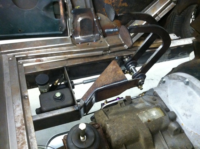

    Received a slave from speedway and worked up a mount for it to bolt to two factory tabs on the s10 t5.... Can't see it from the front but welded and tapped two tabs on the back of the plate and had to mill a slot for a tab to pass through the plate so it would sit flat..
    Then the pressure plate was hitting the bell so after 6 times if removing it I finally took enough out for it to clear..
    Put it back in and hope to run a temp line to try it out see what the pedal feel is going to be...

    here is a short video of the clutch pedal at least working.. milled a bit off of it to get the pedal over and the rod to line up straighter. also moved the brake pedal over also. next step will be to brace the mounting shaft back to the cross member...
    88 jeep Cherokee master cyl and a speeway slave cyl. the line i ran for them is temporary also.. will be a flexible line. tempted to try the 62 chevy slave that i bought to see how it changes the pedal push

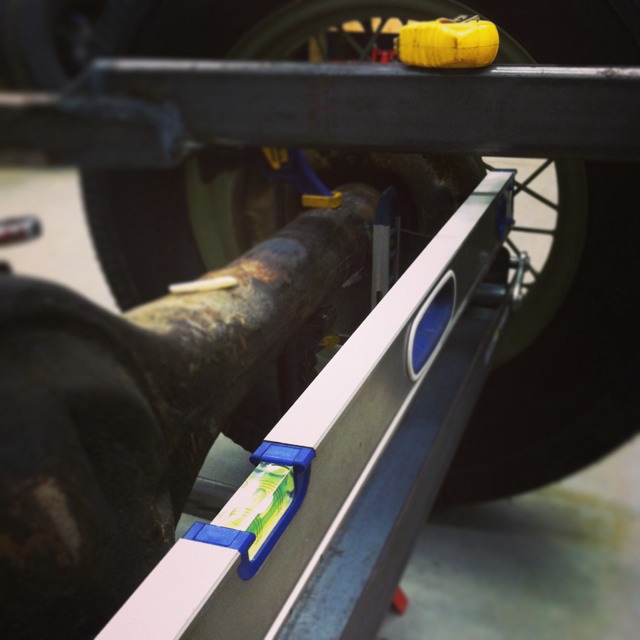

    Got the frame back in line and made up a rear/middle crossmember and welded them in solid so the frame wouldn't move as much I hope while building
    Going to tack the spring mounts on tonight and get moving on that.
    Used a piece of angle iron to put the mounts on at the distance I wanted them to be at.. Seems to make it a lot easier to keep them there then..
    Leveled up, plum, square, and clamped to the housing.. Should be close enough for this thing.
    Passenger side tire still seems to be running in a bit but hoping welding that side a little hotter to pull it back.. But the Coker tires sway back and forth more then a flag pole in a hurricane so I'm sure it will be fine.

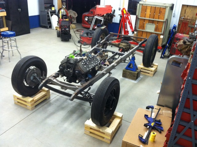

    Also after seeing some on Instagram I made up a set of small wooden boxes to set the truck on.. Should have made these a long time ago, sure make it nice and hold it where ya want it.. This is how it is sitting now.. Hope to get it setting back on its own weight by Christmas..

    figured out a name for this thing by now "problem child" seems fitting
    It's sitting on its own weight but need to have the spring fixed.. Going to take the spring to a local shop and have it narrowed or have it remade..
    It's 38" eye to eye with the mounts at 42.5 but seems a bit soft and sinks to much.... Probably going to shorten it to 36.5 to get the shakers up where they need to be then add leafs or spacer on top to get ride height..
    Shackles pointing down to far
    Like the look but needs more clearance I think to be driven a lot..

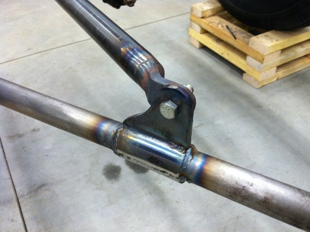

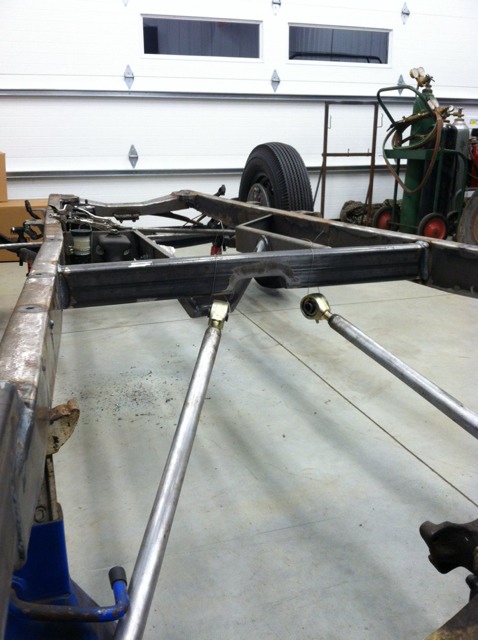

    Was able to get one more thing*****oned up today/tonight.. Made up two rear bars to help support the bottom bars..
    Used ends of of some old rods that I had and welded them to a new piece of pipe..
    Cut and smashed a piece of pipe to fit around the bars
    Drilled and welded a tab on that pipe and welded the pipe to the lower bar
    Not 100% sure/satisfied with the rear mount yet but will do for now. Also pie cut the back of the bar to for the piece of 1/4" plate in and pinched it in so it had some taper to it.
    Bent some plate up to cap the front bar mounts.
    And that's about it for tonight. Going to work on supporting the leaf spring brackets tomorrow.
