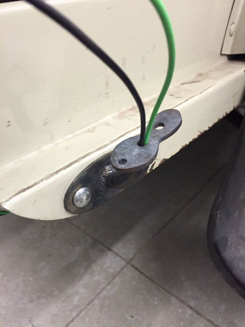

    Been working a some basic things.. Ran the brake lines and had some hoses made up for the front and the clutch..
    Made up a simple hold for the front T.. Just a simple j bend and tapped the side..

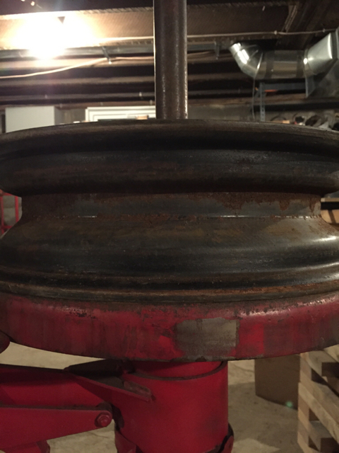

    Needed a brake line straightener since I was running one piece of line clear to the back.. Ran across the idea on YouTube
    Couple packed of patio door rollers, 2" square tube, 2 half inch bolts,and few minutes drilling on the mill and ya can have a roller for about $35

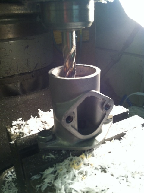

    Had to fix the issue of the old stand being to tall..
    The 3x2 has the ports in the front for the stand pipe and road draft.. So this was the thought I had...
    Heated and took the steel out of it and milled it down shorter.. Also had to mill a little off the top down inside where the push rod was at...
    Turned out a cap out of some s**** I had..
    Drilled and tapped a 1/2 hole in the back side to hold the cap on..

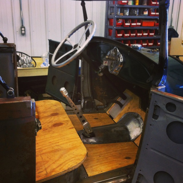

    Cut out a board for the seat pan and drilled some holes in the seat pan...

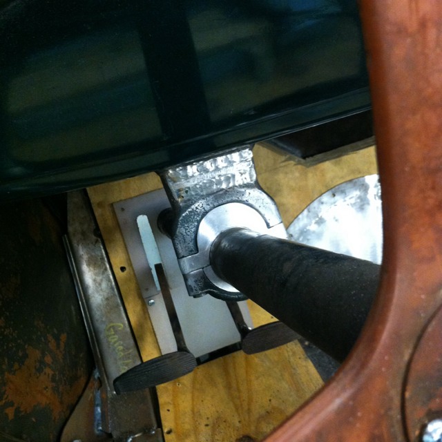

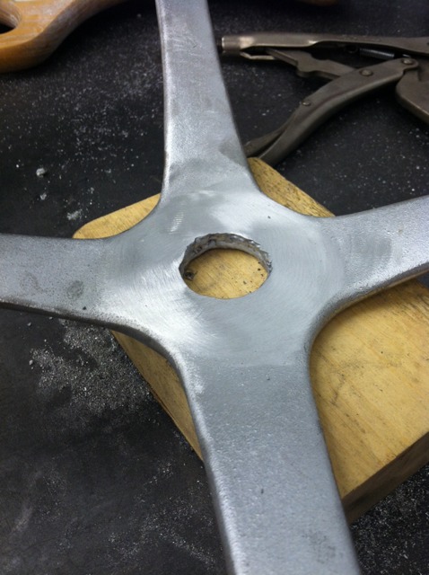

    Lastly I was a little concerned about the middle of the cast aluminum steering wheel being to thin so I welded up the recess front and back..
    Used a file and sanding block to do the back
    And due to the front being recessed had to use the mill
    Smoothed the front up to take the milling marks out

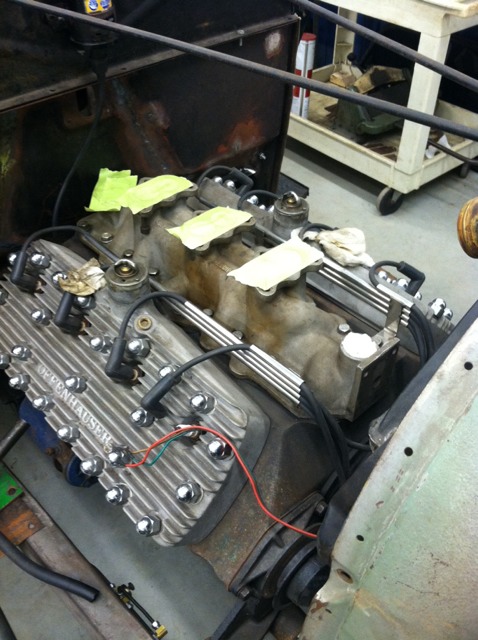

    Took a few days longer then it should but was able to get three large number 97s and dropped them of two weeks ago this Friday..
    Figured I would toss the intake in the blast cabinet and bead blast it.. It has some sort of corrosion or dust inside the runners that couldn't be washed out... The gl*** beads did a good job of cleaning them up though..
    Kind of makes the heads look really bad.. Will blast them when I go to paint and re-seal the block

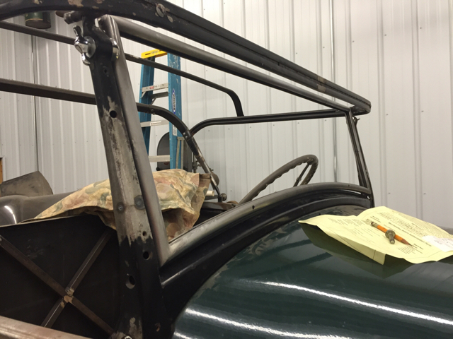

    Made up a 3/4" column drop out of some s**** aluminum tonight and with the little I dropped the mount on the tank it should be low enough to clear the windshield.
    Tossed the hood and grill shell on to see how they would fit up.. Couldn't help but to toss a fender on so it somewhat looks like a vehicle again..

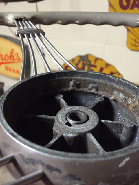

    Picked up an original banjo wheel of him for the truck..
    The cast one after looking at it awhile just looked to shinny/light in color.. Looked to street roddish..
    Needs some cracks fixed but nothing major..
    Now it looks like I'm gonna have to make a new steering shaft since this one is different.. Kinda also seems like I need to shorten the tube also..
    But in all I'm glad to have an original ford wheel on it..

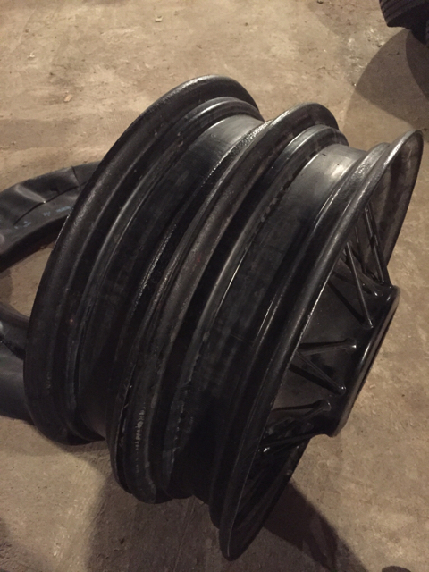

    Buddy gave me a steel wheel cause I told him I was looking for one more 4" wide wheel.. Said I could have this one and he wasn't sure the width but he didn't need it.... How can a sane person turn down free old ford parts..
    Anyway dismounted it and the 18" wires I bought to run on the RPU when I get it done and I couldn't be happier.. The steel wheel is a 4" wide and decent shape inside... And the 18s look like brand new inside!.. Had to cut off the old tires that were all dry rotted.

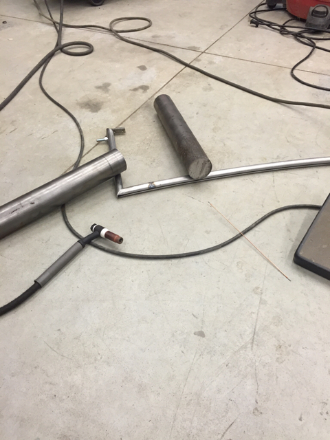

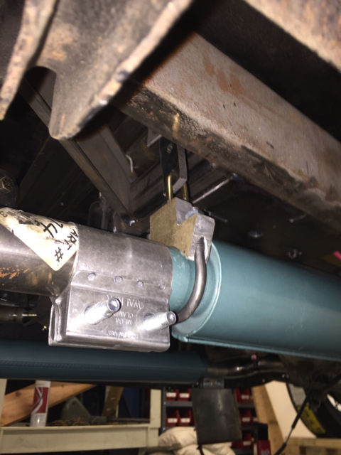

    Not to many pics of this but got the exhaust welded up.. Needed to get a 2" pipe in a 1 5/8" flange..
    Pie cut and beat in slowly with a hammer till it fit...
    Welded it up out of some 2" 90 degree bends with one long leg on them.. Waiting on band clamps from the parts store.. Just have them clamped and zip tied to the hanger
    That's where it's gonna come out.. Figure if I need to put tips on it I can always cut it back...

    Started working on some exhaust hangers..
    Will hang from the normal old rubber straps.. Always hated the look of the standard u bolts..

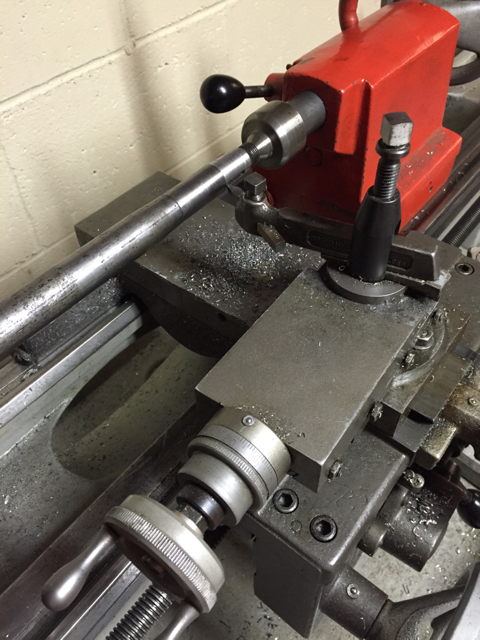

    Next on the list was to get the banjo wheel on the cut down model A shaft..
    The taper on the A shaft is a little larger in diameter
    This lathe has been a godsend worked out to be about 88.6 degrees of taper.
    Keyway is back in and seems to be good to go now..

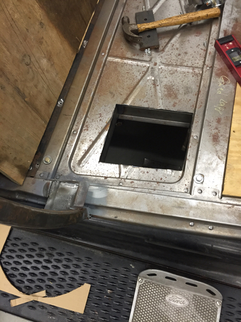

    I don't have access to a router so tried the mill as a subs***ute, cut a 3/4" wide recess around the pedal opening for the new plastic plate.
    Made the mistake the first time of cutting the plate in two then trying to cut the path for the pedals.. Had a hard time keeping the side from
    Moving while cutting.. So this time
    Left it all as one did all the milling then cut in two pieces... Much much better
    Then cut the 1/4" deep recess into the plastic
    Then counter sunk the holes in the plastic and screwed it to the floor.
    This should allow the mat to lay flat instead of the way I had it before.

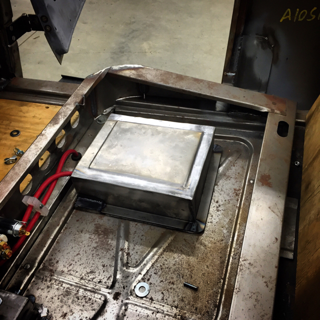

    Made up a pretty simple batter cover, since I don't have a box brake but do have a welder I made it out of separate pieces and made the raise in the top of it with just flat steel and a flattens chisel..

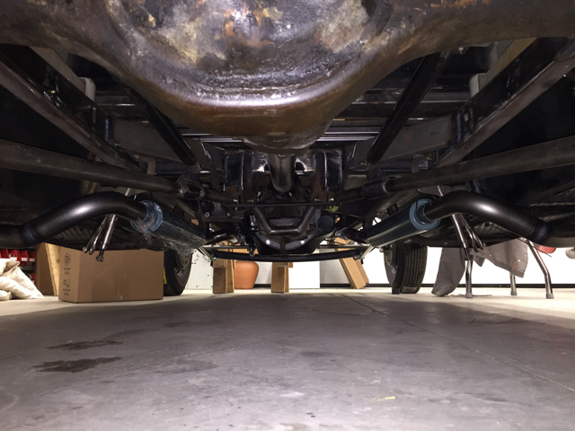

    Couldn't find any good universal pipe kits so figured I would see what a 90 would look like.. Had plastic in the ba*****t..
    Got two mandrel bends from summit had to shorten the long side and lengthen the short side a bit..
    Not sure I like it 100% but it will work for now... Also got the carbs back, bolted them on and put the linkage on..
    The other roadster came with a window frame so I took it for this project due to thinking maybe Duvall style on the other..
    Cut it down over the weekend..
    Used some thick stock to hold them down and still
    Fit up tacked together... Ended up having to take a bit out of the bottom.. Maybe 1/8" to get the gap on the side right.
    Cut down the top bar and welded it up.
    Ordered some stuff to mount the generator and some tail lights so that kicked me in the wallet so I'm going to do some stuff that doesn't cost anything..
    Make an access cover for the brake and clutch master and drill some holes for wiring..

    Made some more progress and also stepped back a little bit..
    Ran the floor board through the mill and made an access for the master cylinder..

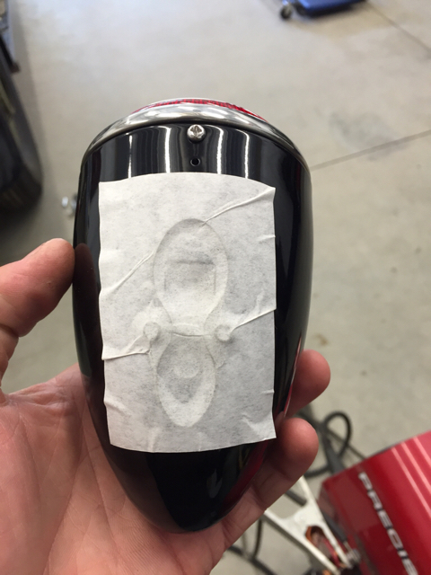

    The 37 ford led tail lights showed up from speedway with some other parts I need to send back since they won't fit or work the way I thought they would. Anyway made up a few stands for them..
    Found a new use for my vinyl cutter since I have quit doing it but still have the cutter... Makes for easy guides to cut by
    Picked up an anvil the other day.. (Other hobby is collecting junk) used it to make the square holes for the carriage bolts.. sharpened a piece of key stock on one end, heated the plate and knocked it down through
    Used cover tap (masking tape) from left over lettering stuff to make a guide for the top part of the bracket..
    Left some around the edge so the front screw would have some material left in front of it..
    Picked up a piece of thin wall 1/2" from tractor supply.. And more heat and beat.. Using an old pulley to shape around the inside to help the pipe from distorting
    Ground the pipe on top a few times on the truck to make sure I had the right angle.. Then tacked and checked again then welded it up..
    Need some smoothing up but should work out good..

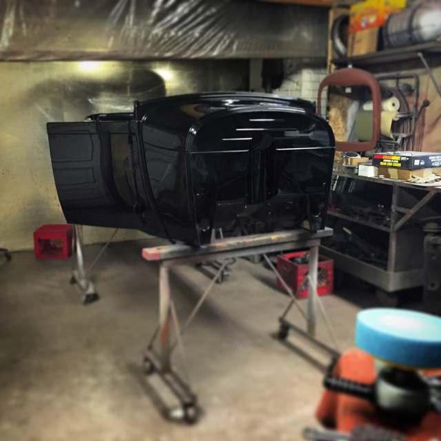

    Had a good buddy that has been doing this for a long long time come by and give me a hand sorting a few things out.. He ended up spotting something way more important..
    The hood was way outta line.. Didn't line up at the back and didn't come out in the middle of the shell.. We worked at it for a bit and got the back to line up but the front was still off..
    The center was probably 1" off to the left of the center of the shell looking at it from the front... I don't know how I didn't see that..
    He made a some suggestions and left... I pulled the bed back off and checked the cab.. Sure enough I had set it on crooked last time I had it off.. It was about 1.125" off to one side in the back! Squared it back up and also tightened the front down..
    And bam! The hood lines up at the back top and bottom the center of the hood is in the center of the shell.. Just need to make a few minor adjustments to the shell..
    Must have been rushing and completely missed that..
    I feel very fortunate to become friends with this guy over the past couple years... Him and a few of his friends have been a huge help and are on the same page when it comes to taste in cars.. Most all of them are more then double my age which between them there isn't a question they can't answer.
