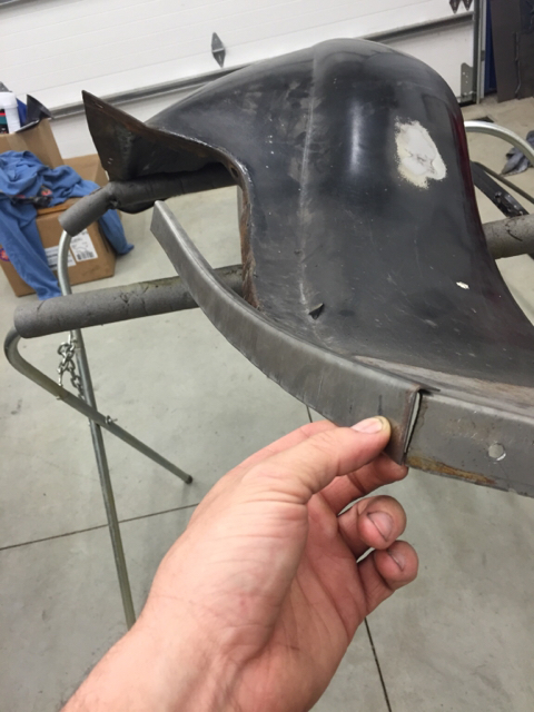

    The offset on the steel wheels made the tires rub the fender brace.. So I figured I would fix the fender edge while I had them off..
    Bought a new shrinker stretcher as I would like to learn more about metal shaping and equipment..
    So here is what I did..

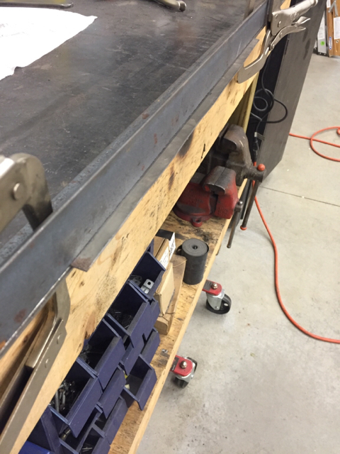

    Cut a 1 5/8" strip
    Bent a edge on the bench
    Here is the edges that need fixed
    So ran the piece through with the stretching die in
    And then switched to the shrinking die to get the other curve in it

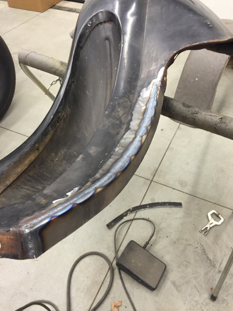

    Only have the drivers side cut and welded last night
    Cut
    Fit
    Weld
    Grind
    Install.. Still needs some work at the back and some mud work.. But I think there is a nightmare hiding in the rest of the fender around the spare well

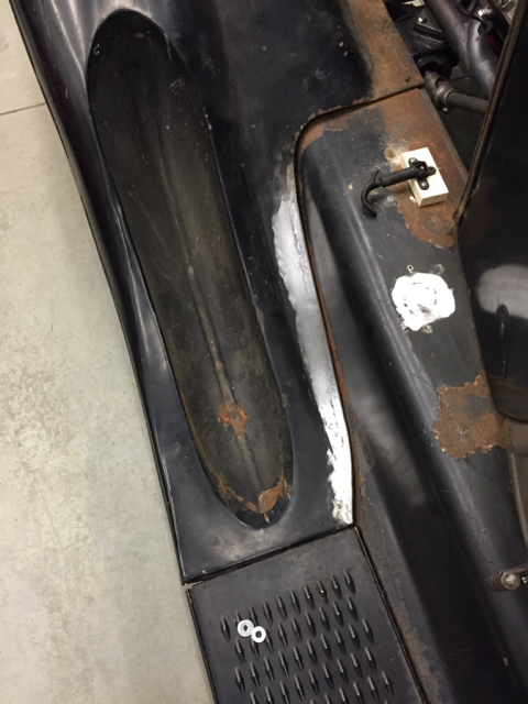

    Was my lucky day and was able to swap fenders with a restorer petejoe
    Wanted to start to try to get primer on some things.. Tried sanding the old paint on the fenders... That's a no go.. Plugs the paper up and if a da or flap wheel is used it smears around..
    Paint stripper would take the top layer off and with a another p*** or two I was able to strip them down..
    P***enger side has a fair amount of bondo in it.. Having a guy from town give me some help and pointers on getting it straightened out..
    Started to fill some of the pits on the wheels to get some primer on them also

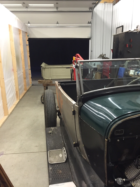

    I have terrible luck with painting outside with Ohio's weather.. So I had to make something up to paint in..
    Made out off all 8 foot 2x4s ends up to be 16x8
    I had to make a couple fixes to get it to draft
    Added filters to the ceiling and above the door add a furnace fan and long exhaust box to clear the air
    Seems to work pretty well. Using one of those turbine paint systems from TP tools and that's going to take some getting used to..

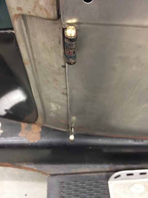

    Also turned out a set of new door pins...
    Lot less wobble in the doors now.

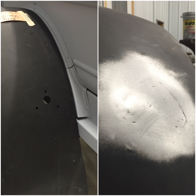

    Started to get some primer on a few things... Had the hood blasted and they took it easy on it as not to warp it.. Handed sanded all the old primer off..
    Wanted to learn how to bump metal and had a guy come over and give me a hand.. Showed me the basics and took off.. Spent about 3 hours banging around on the p***enger fender... Started with this
    Ended with this

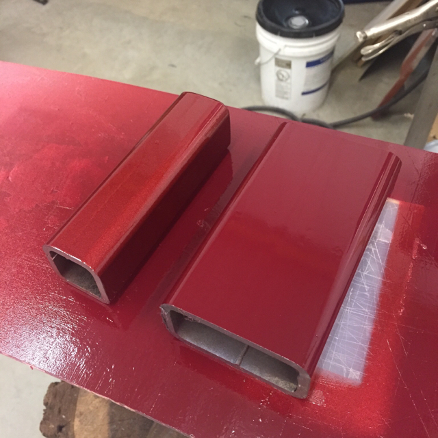

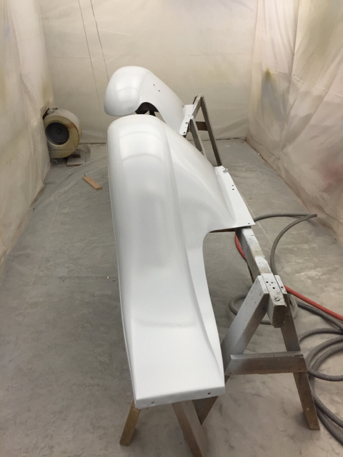

    Sprayed some Evercoat super build primer on the fenders... This stuff is THICK!! Basically spray bondo.. Should block out well... Couldn't get a good smooth finish on it when spraying it..
    Put the top pieces in primer sanded them and recoated the side pieces... Also welded up some brackets on a cart I made along time ago to mount the bed to to send to the blasters Monday..
    Also got all the boards removed and looking at making new ones since I'm doing away with the spring plate in the middle..
    That's the end for these couple days.. Hope to get the fenders blocked out and primed again tomorrow

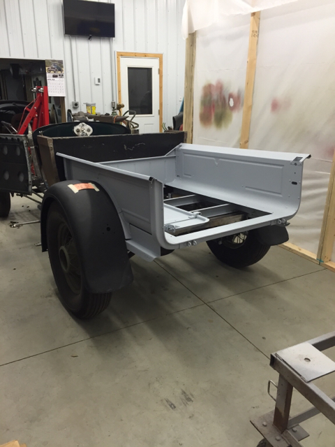

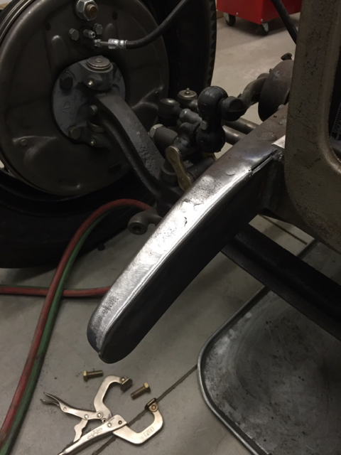

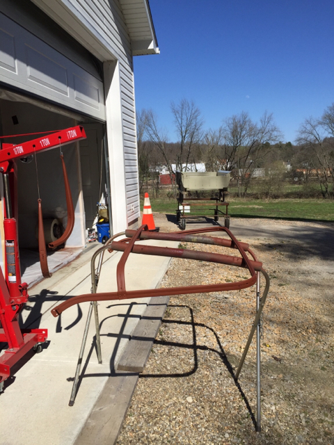

    Got the bed blasted and back

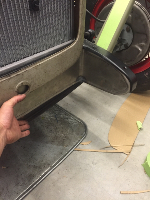

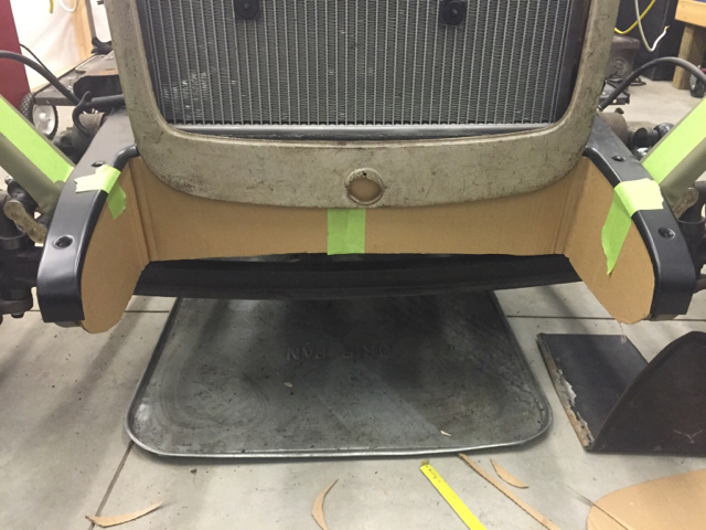

    Wanted to figure out something for the front that's a little different since the gravel pan that was on it didn't fit well after boxing the frame horns and it was kinda beat anyway..
    Cut some cardboard out in ruff shape
    Used a cut off broom stick to bend the corner around by hand
    Made it in two pieces..
    Had to heat the bead with a torch and hammer it back out after bending.. It pinched it but not bad..
    The one that was on it was pinched flat in the corner.. So I wanted to try not to do that.. Not like anyone will see it anyway..
    End result welded the two halves together.. Doesn't hang down so low, covers the spring plate, and let's the axle show..

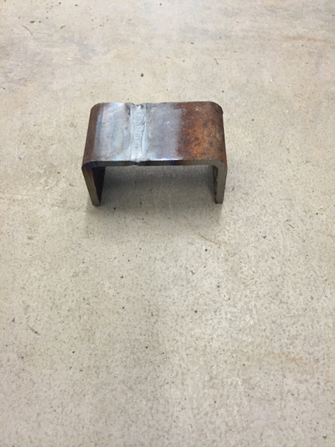

    Went to weld the frame horn boxing plates on and tried to s****e a little piece off the cup.. And wouldn't ya know at 10 on a Friday night after 4 years of use.. Crack..
    Not near as fast but it is traditional.. Had to break out the O&A torch to weld it up..
    Have to get back by the radiator and the bottom when I strip it down..
    Hope to get some primer on the bed and tailgate tomorrow..

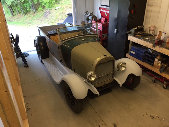

    Stuck the bed in the hokey paint booth and got some primer on it and the tailgate today..
    I don't know how guys pour out of a full gallon can and not make a mess.. Haha..
    Back to work.

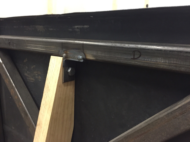

    Tired of stacking things behind me to sit in to test drive.. So out goes the blue board insulation.. Needed to make this up anyway..
    Glued two pieces of 3/4" ash boards together for strength and laid it out.
    Cut and drilled pieces of angle to the back structure to hold the top of the wood.. Then bolts through it and screwed the uprights to the bottom..
    Blasted and primed a few other things
    Can't quite get this turbine hvlp system to spray the heavy stuff smooth but it's just build primer that needs sanded anyway..
    Went to the swap meet and scored a couple good deals..
    Picked up a nice set of rear fenders and a clear ***le for my other roadster.. Few little spots to hammer and Dollie out but they fit really nice..
    And obviously set the bed back of to see how the fenders fit.
    Kinda nice to see a big part in primer and on the truck.

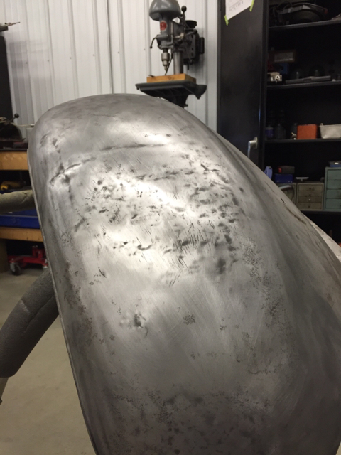

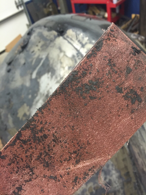

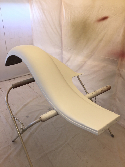

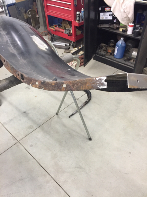

    Before that happened I was working in the rear fenders I had purchased and wanted to fill the hole from the step plate and the taillight.
    Took out a stud gun and welded a stud to some s**** sheet... Used a drill and a grinder to make a good round piece to use to fill the hole.

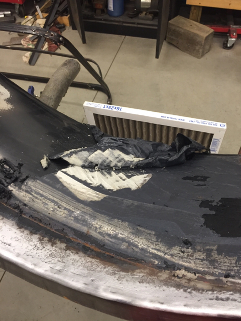

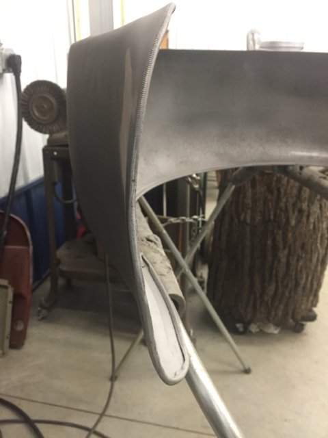

    When sanding around the hole I noticed some dents on the inside of the fender that wasn't showing on the outside.. Wanted to remove the cheap spray primer that was on the fenders anyway..
    And found a decent amount of bondo..
    There were some pretty fair sized low spots.
    Did my best as quick as I could to make the low spots smaller.. Someone with more metal finishing experience could have done better. Ended up with just smaller low spots that should take less bondo.
    Same deal for the taillight hole
    The rear of the one fender needed addressed also.
    Not perfect but better then it was.. Had a lot of pin holes and really thin on the wire edge so few p***es with the tig fixed that.
    Applied a couple thin coats and sanded till dark..

    This was Friday night..
    Had to get primer and some body work done in the splash aprons.. Quick work so they need to be sanded again and more body work done.. Primer will really bring out the dents that ya miss..
    Also needed to get a good cover coat of primer on the front fenders since I had block sanded the high build down and had a few small bare spots showing..
    Using the tp turbine system I have found that the thicker primers need to be thinned to give a nice smooth finish..

    I noticed on the way back from the church that day the front spring hit the frame so I had to make some provisions for that..
    Hard to cut it while it's all together but found it easier to drill holes all the way through to make the corners round and line up..
    Cut and narrowed a piece of rectangle tubing
    Set in and ready to weld
    Welded up both sides
    Took it on a test run of about 45 miles and didn't have any troubles.. Wanted to try it while it was hot out.... Right about 95 that day

    I noticed that the rear of the frame was hitting on the axle on big bumps.. Trying a 1/2" spacer for now till I can get a new spring made.. The old one doesn't have much spring left to it..
    Made a template out of cover tape used for doing vinyl lettering
    Going to try to get the top structure painted this weekend and start laying out the wood for the back top part of the cab..

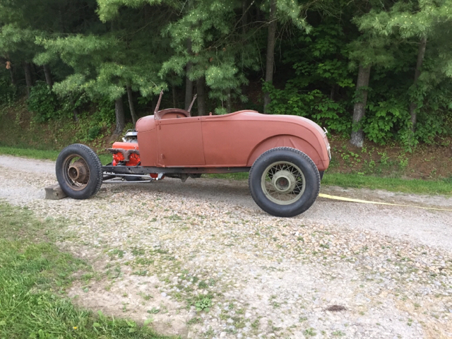

    Also sold the other roadster that I had to drum up funds... Had to take a few pictures while they were both here
    Got it all loaded up and delivered it to a good guy in Kentucky
