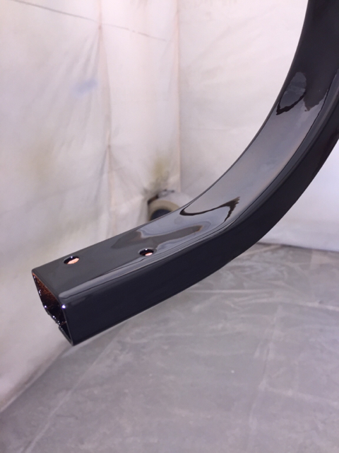

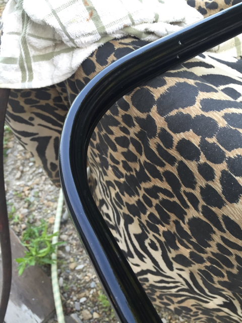

    Well was able to get a little color sprayed on a few pieces of the top.. Hope to do the rest of the structure tomorrow..
    Wanted to do a few small pieces since never painted a lot with this turbine hvlp setup from TP Tools.. Had some issues with it I hope I can get worked out before painting any of the body..
    Dean Lowe likes this.

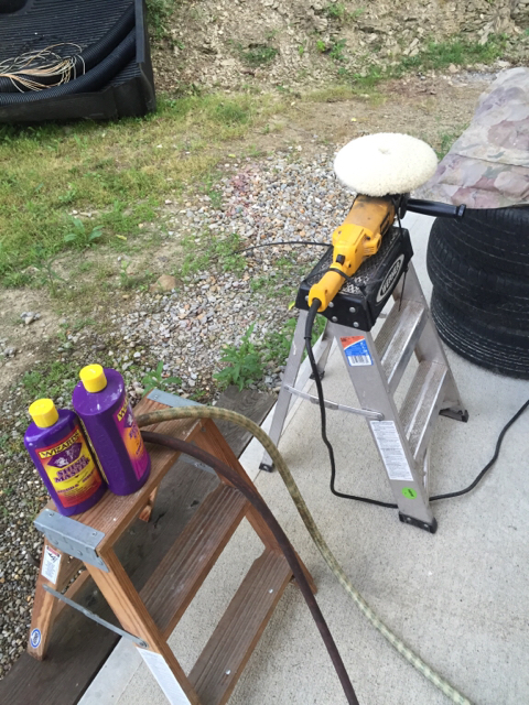

    Well took the pieces out in the sun and they had a little bit of orange peel to them
    Hit with some wet sanded with 2000 Grit then hit with two kinds of polish. Don't have 4 hands or a bench top buffer so zip ties and a short step ladder will do
    Pretty happy with how they turned out..
    Was also able to get the other top piece painted Sunday... Be nice to add some light to the inside of this plastic booth.
    Little orange peel might try to buff it by hand or might not worry since 90% will be covered up
    Put some hub caps on it and gonna kill the night by trying to make a tool to remove them easy and not scratch stuff up..

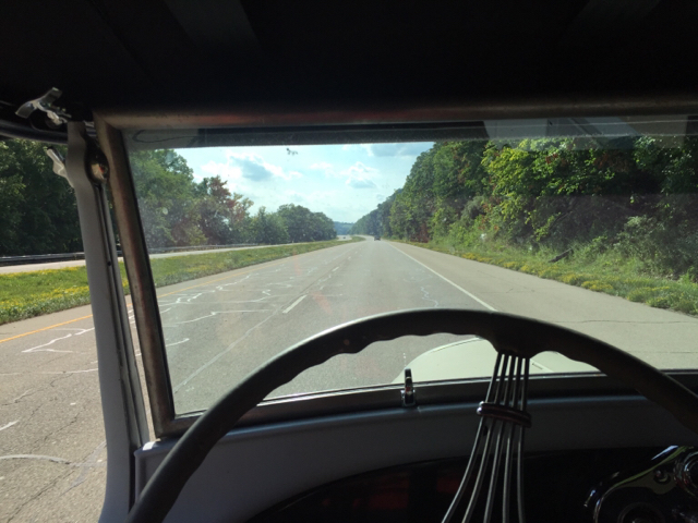

    So few ups and downs as always this week.. There was a local show that is about a 30 minute drive from home.. Decided to throw some stuff together and take the truck..
    Had to make a seat cushion for it.. Riding on 3/4 plywood wasn't cutting it for road driving..
    One of the guys in the local group owns a furniture store.. Said he had left over packing material.. Perfect..
    Couple layers of this stuff, soft foam, and some Walmart fabric
    Much better ride now.
    Took off about 7am
    Only issue on the trip was when I got in line for the show it stumbles and stalled.. And for some reason it just doesn't want to start when hot.. So I was able to coast down to where we had to turn in little bit at a time and luckily it decided it wanted to run again..
    Thinking the carb or fuel lines are getting hot and vapor locking.. But not 100% sure

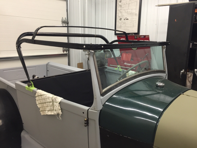

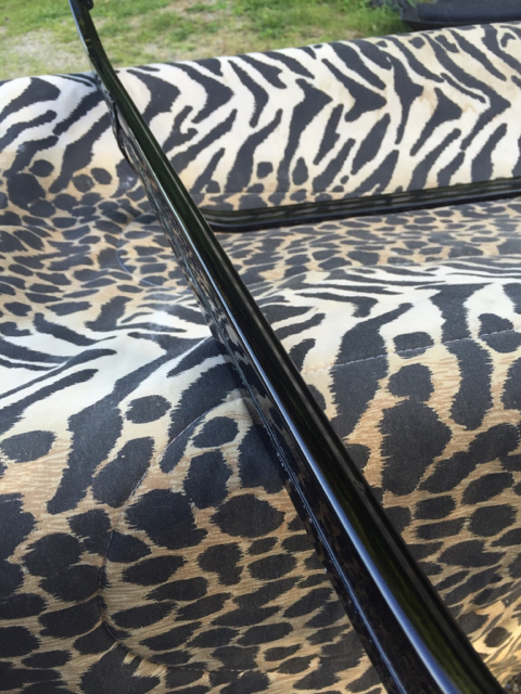

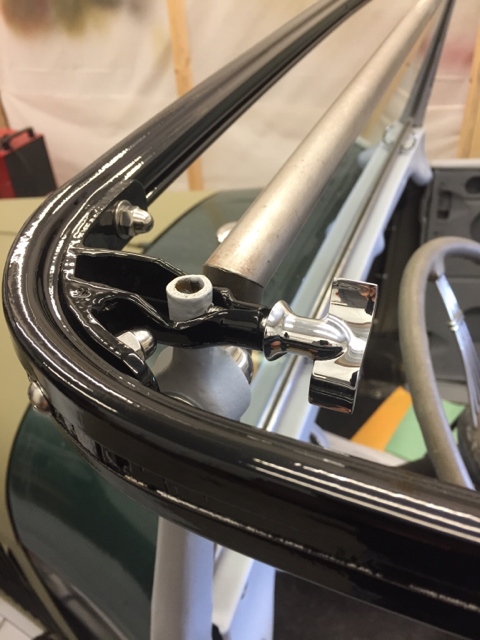

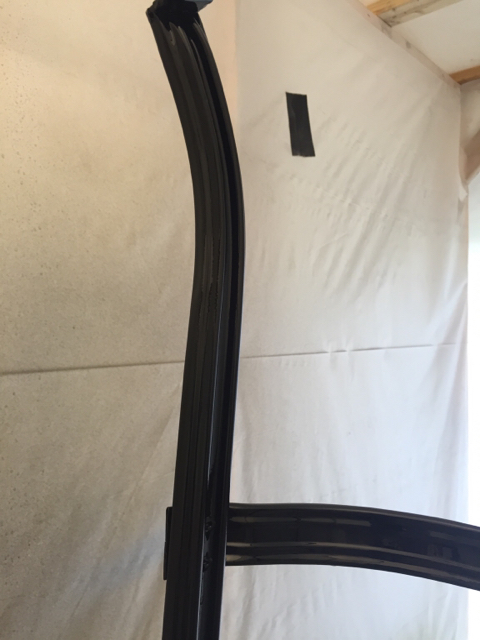

    So repainted the sides of the top late last night..
    Much better and made sure and put about 4 decent coats on it.
    Buffed it out where I stopped at.
    Threw the top on carefully and unpacked the clamp bolts and put some tape on

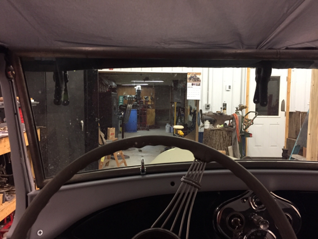

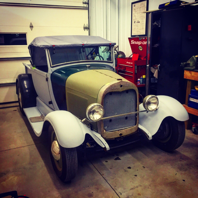

    Then I figured I would throw a sheet on I bought a long time ago for this purpose and never used.
    The view sure shrank inside :)
    I'm sure glad I narrowed the front and set it down a little more.
    Now just debating on how to do the sides and if I should bring them around the side farther..

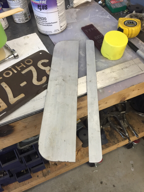

    Started on a few other things to get read for the top and needed to make a license plate mount..
    Cut out two pieces of aluminum.
    Set on a piece of rectangle tubing to keep square and welded them up
    Probably going to paint it but for now I blasted it with co**** media to give it a cast-ish look
    Needed to make a tack strip for the back so made up a template out of cardboard then cut it out of a 1" thick piece of white oak.
    Had to mill out some of the sides where the quarters stick up a bit
    Then went back to my brothers place who does more woodworking then I do so went out there and we ran a router around it to give it some profile..
    Attached it from the bottom with hex head metal screws... Didn't really want a bunch of screws showing from the top.

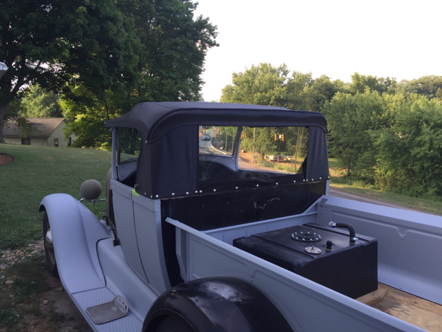

    Little update on the progress.. Went to drop off the truck at the upholstery shop so I figured I would shorten the top clam bolts..
    Off she goes to get a top put on

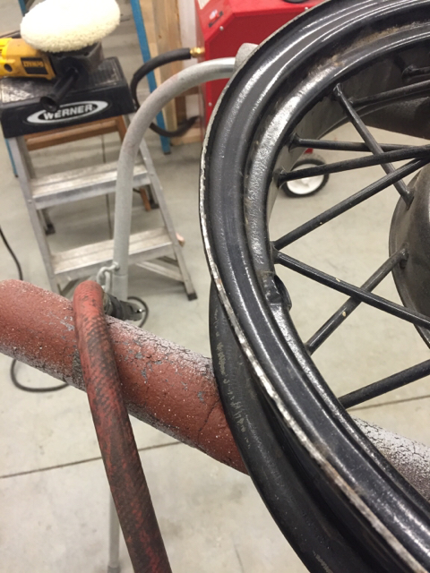

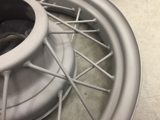

    So I needed to start on the rear wheels.. The bead edge was a little goofed up so did some sanding and grinding on them first
    Sent them to the blaster and really happy how they turned out..
    No one single pitt..
    So made up a thing to hold them so I could roll them around..
    Shot some primer on them and tried to learn the best way to paint spokes..
    Waited a couple days and scuffed them and shot some color on them..
    And then clear.
    Messing with the spray gun on the turbine has been quite confusing.. Not like a normal spray gun. I ended up with some runs on the back side luckily so I can sand them out and won't be as noticeable back there
    Set them outside this morning.. To try and get a little sun heat in them to help cure better
    So hopefully get some wet sanding done this weekend and get the back straightened out.

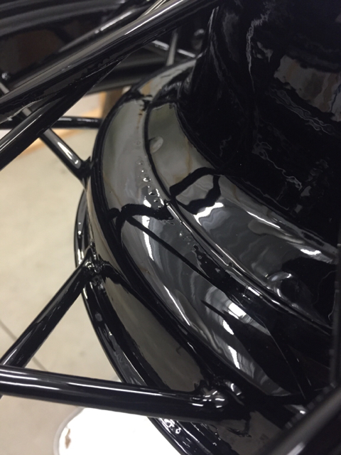

    :( oh and the hits keep coming haha

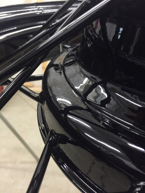

    I guess some of the basecoat wasn't fully cured out.. I left it sit for about 2.5-3hrs before spraying clear..
    After sitting out today I come home to find a present..

    So I ran up after work and drove it home.. I spotted one change that needs to be done as soon as I started to drive back the driveway.. But it will be an easy fix.
    So....
