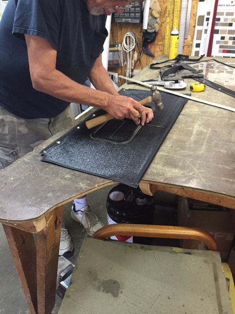

    Can you take a closer picture of the texture of the top material? Looks pretty cool to me!! One thing I see- I would paint the snaps black. Everything else is right on!!
  2. twenty8tudor
    Joined: Oct 5, 2010
    Posts: 889
    twenty8tudor
    from Ohio
    I did not think of painting the snaps.. That's a good idea! Since I painted the other clamp nut things black..
    The upholstery guy said its called cobra texture I guess... It's pretty close to what was on it when I got it and I believe it to be the original style texture

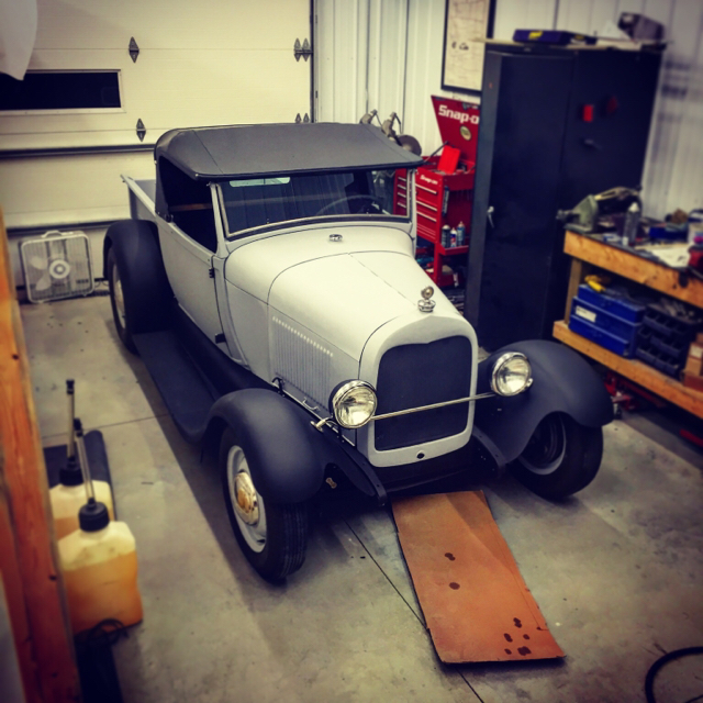

    Goofing around and working late to try to get this thing ready for the trip out to bonneville.. unfortunately going to trailer it out but so many miles on something not quite finished does not sound fun.. Anyway progress in the last couple days..
    Wanted to get the cowl section to be somewhat the same color.. Scuff and spray bomb primer.. Hated to but it's going to get blasted anyway..
    Wanted to out the old motometer back on the shell, with the aluminum radiator that's an issue.. Have some round plastic from work that I run through the lathe so it would thread down into it.
    Turned it down to where it just had to be knocked in from the bottom and would stick.
    Drilled holes and welded some
    1/4" bolts to the shell to hold some screening. Also filled where the ford logo was at.
    Got busy and forgot to take pics but primed the shell, wheels and hood.. So I could start putting it back together.. Mostly finished up late last night.. Still some things to do and adjust but it looks like a truck again.
    The grey and black is kinda growing on me.. Planning on putting gas in it and welding up the bottom of the battery compartment just have tacked in place.

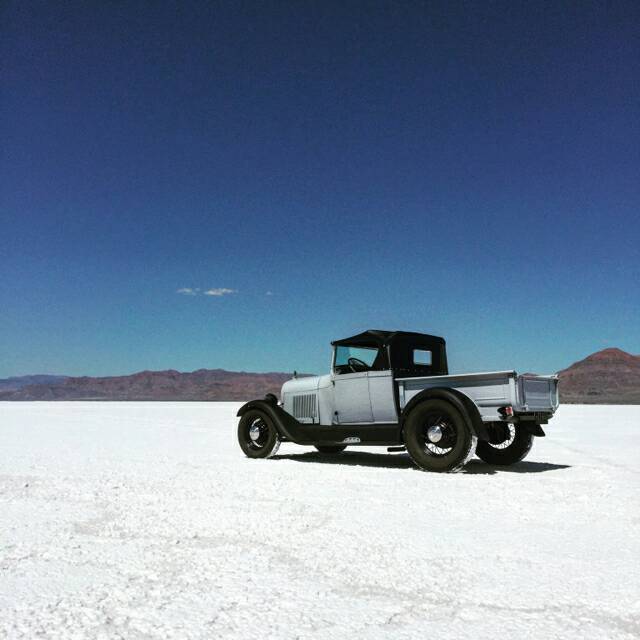

    Okay well made the trip out and back.. Trailered the truck out and back which worked out pretty well.
    Installed the key chain with my buddies ashes in it..
    Took off around 8am.. Kansas sky sure looks a lot nicer the ohio
    This become a very normal sight
    And after a 14 a 12 then a 4 hour day we made it..
    Had a blast and posted a ton of pictures in the other thread.. Came home and went to a localish show that always has a great bunch of traditional hotrods.. Called the spinout in brimfield ohio.
    Didn't get a chance to get the salt cleaned off by then but it made it fun for people to see and some tasted the salt that was stuck to the under side of the fender..ended up getting the award for best pickup.. Which I was surprised cause there was a really really nice channeled 34 pickup.
    Anyway I have started cleaning the underside of the truck..
    Hopefully using that rust treatment will help keep the rust down from the salt.. Going to pop the front fenders and bed off tomorrow and really get them cleaned and treated again..
