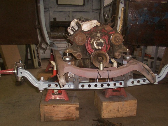

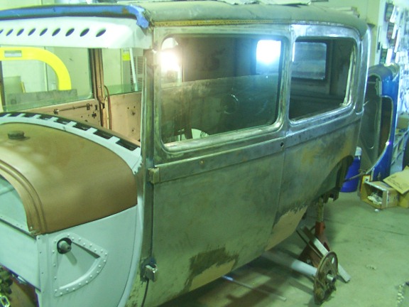

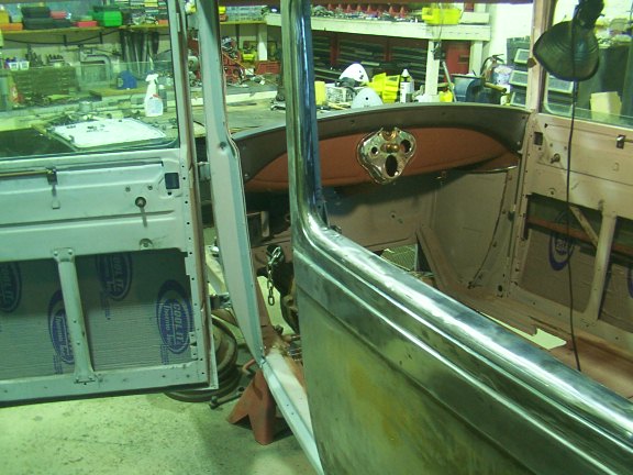

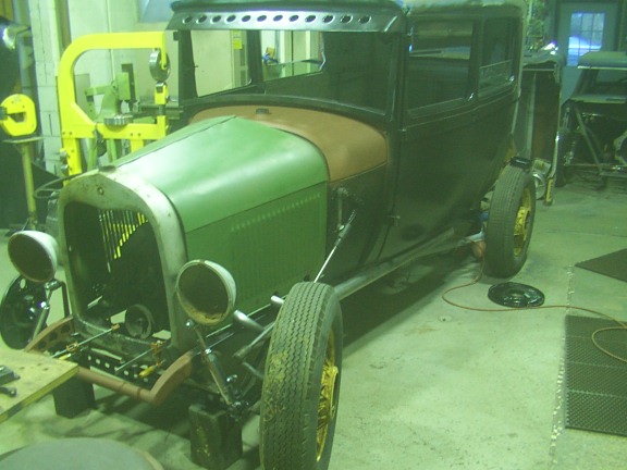

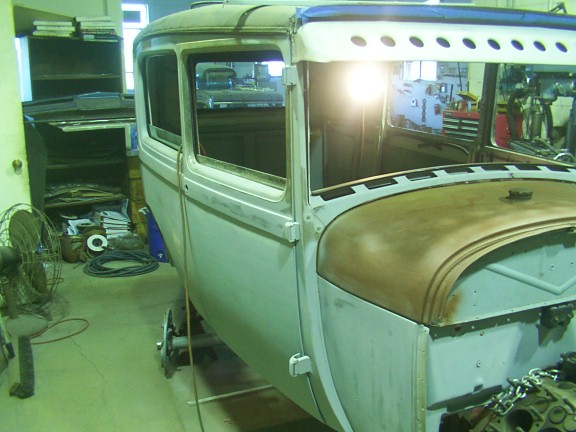

    Thought i'd post a pic or two of the tudor i'm working on, here's the body. I alreday had the frame done when we carried the body in and sat it on the frame. I white primered the inside so's i could see what was what.
  2. oj
    Joined: Jul 27, 2008
    Posts: 6,575
    oj

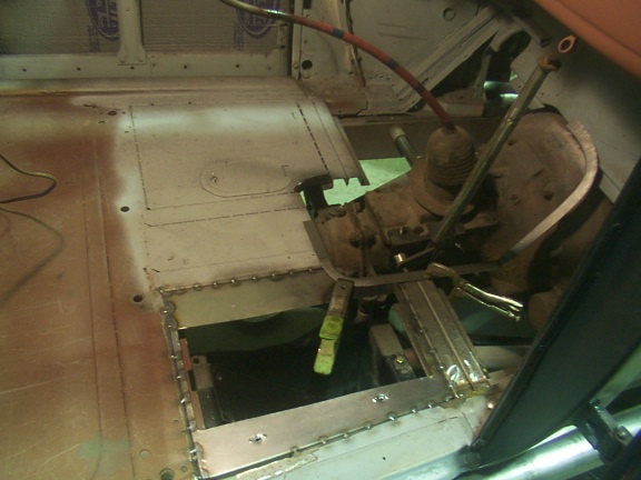

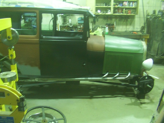

    I took most of the inside apart and rebuilt regulators, door latches etc, body work and patch replacement. I am doing my best to keep this looking like it is a mostly stock ford hot rod that wouldv'e been built by some highschool kids in the fifties.
    It will have a 59a with edelbrock script heads, offy dual 94 intake, 37 ford toploader and converted to open drive, model 'a' banjo, 4" drop drilled 'a' axle - just very traditional stuff

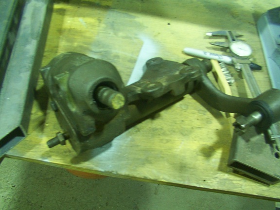

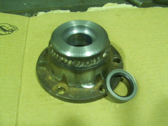

    It'll be benderless, non-chopped, wire wheels. There is a pic of the adaptor i made to convert the banjo to open drive.
  4. Nice work, OJ.
    What kind of tranny?
    I gotta get out to you shop soon...

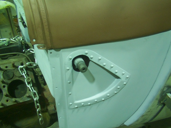

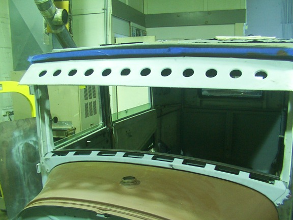

  7. I really like the indent for the steering.

    The owners haven't seen it since i started on the body - they wanted to leave the 'patina' and expect a bit of a ratrod. I haven't been forthcoming with pics so they know nothing of the progress - i told them i was working on the floor and needed the gas tank and that is what they are coming out for. They found an old stainless beerkeg dated back in the 40's.

    Outstanding! I'm with Hitchhiker on the steering indent, and anxious to see what's next for this Tudor.

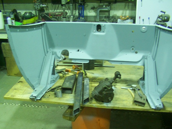

    I'm reposting these pics, they got posted under s different thread.

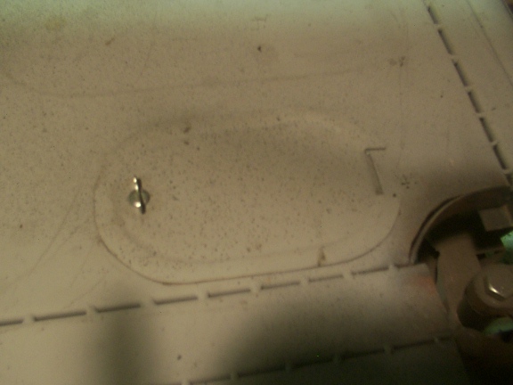

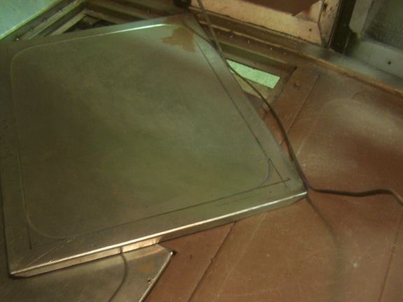

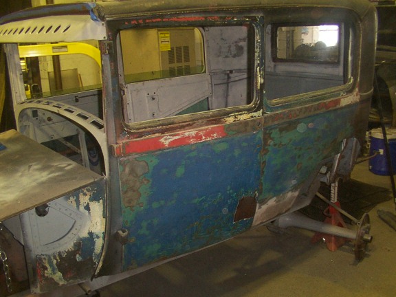

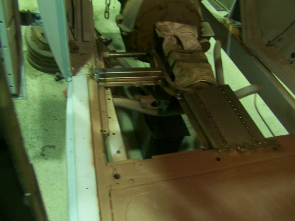

    Here's some pics of the sheetmetal, the rear panel are loose as the owners brought an old beer keg for a gas tank and i need to stand thru those panels sos' i can make the mounts and filler neck etc.
    I lifted one panel out so you can see how they are made and the hat channel they get welded to - when welding i check the door swing and latching.
    The access panel for the master cylinder and the panel for the battery are shown seperate

    Ditto on the steering indent, it's a great look.

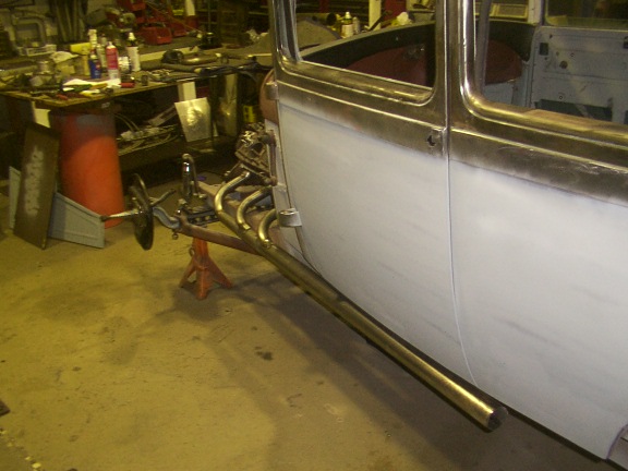

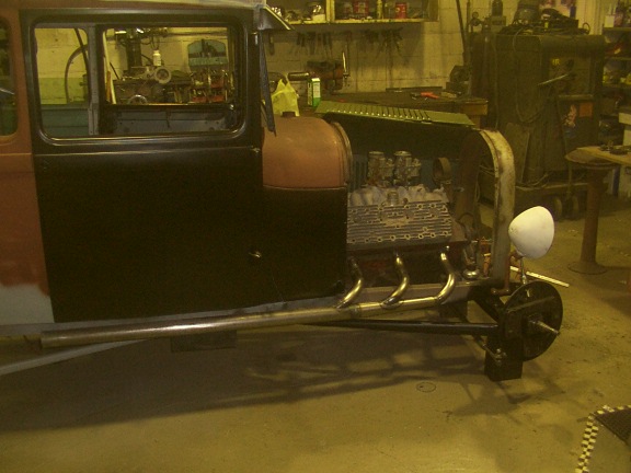

    way cool OJ !!! Did you do those headers as well ? somebody is getting a good looking piece.

    The headers etal - the owners are purplexed, they wanted a ratrod-like car and hadn't seen it since august. They came last week and had a 'holy-fuck' moment. They left talking about getting a loan to finish it. I hope they get funding i would really like to finish this and drive it to jalopy showdown. We'll see, thanks for the compliments guys, oj
