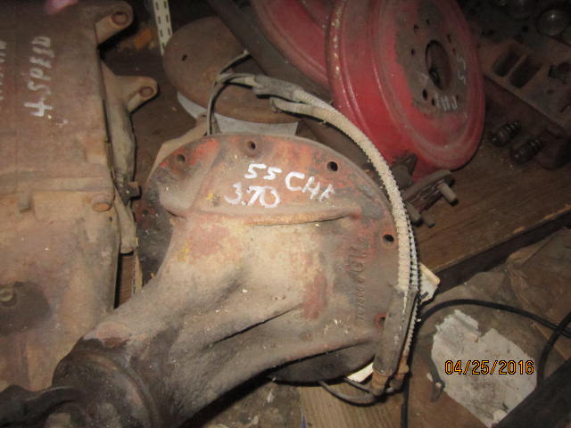

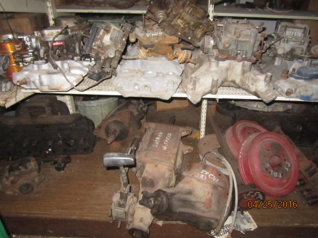

  3. The aluminum powerglide is tougher than a turbo 350. Ive seen them factory installed behind 396,s. My son one time was drag racing with me. And the torque built up against his 327 glide in his 70 chevelle. and he pushed so hard on the collum shifter that he went into reverse at 75 MPH. broke engine mount,s and Dist cap. did not hurt the glide. all the spark plugs we get today are resistor type plugs. And with todays sorry corn gas & resistor plugs a points type ignition is marginal at best. I actually use and drive old trucks and farm tractors every day. and the upgrade to electronic ignition is something that I really believe in. For about $300 he can install lower gears, 4 bbl,dual exhaust and electronic ignition. Buy used stuff and do the work himself. His two bbl carb will soon need to be upgraded to a ethanol compatable rubber parts kit. Buy a used 4 bbl carb and spend the kit money on it. He can split his cross under pipe and seal off the cut. and then he only needs 1/2 of the dual exhaust. And if he keeps his old parts all the mods I recommend can be reversed back to stock original in a heart beat. Before I changed to a 350 trans. I myself would convert the car to a stick. All Real Hot Rods have Three pedals. This kid is a novice everything I recommended is a direct bolt in swap no modifying necessary. The shifter and kickdown on the 350 will need modifying. the rear yoke has different splines. the trans dipstick tube likely will not fit. the rear crossmember might need moving?
  4. The 57 chevys that came powerglide equipped had 3.36 gears the 60 thru 66 trucks that came powerglide equipped had 3.90 or 4.10 gears. the 15 inch tires on the trucks made them a bit longer legged. Any rear chunk from a 1955 to 64 p***enger car will bolt into his car.
  5. Maybe In out to lunch. However I could do every modification I recommended in one day. and never have to buy any parts. chevy stuff 043.JPG chevy stuff 042.JPG chevy stuff 040.JPG
