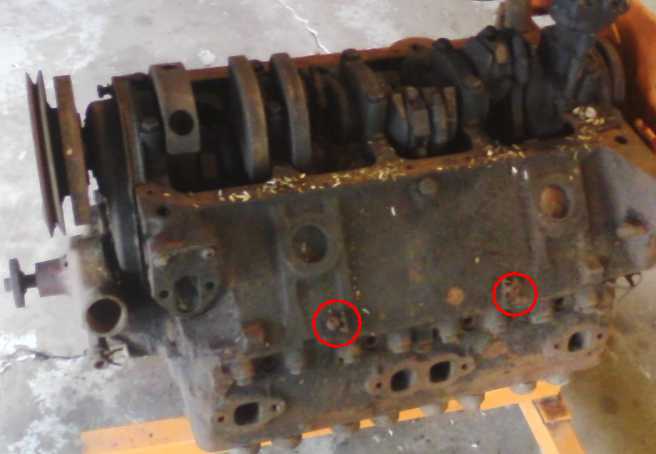

    I always wondered what these 1/4-20 screws were for. Highlighted with red circles. Two on each side of the block near the deck? 55-265.jpg

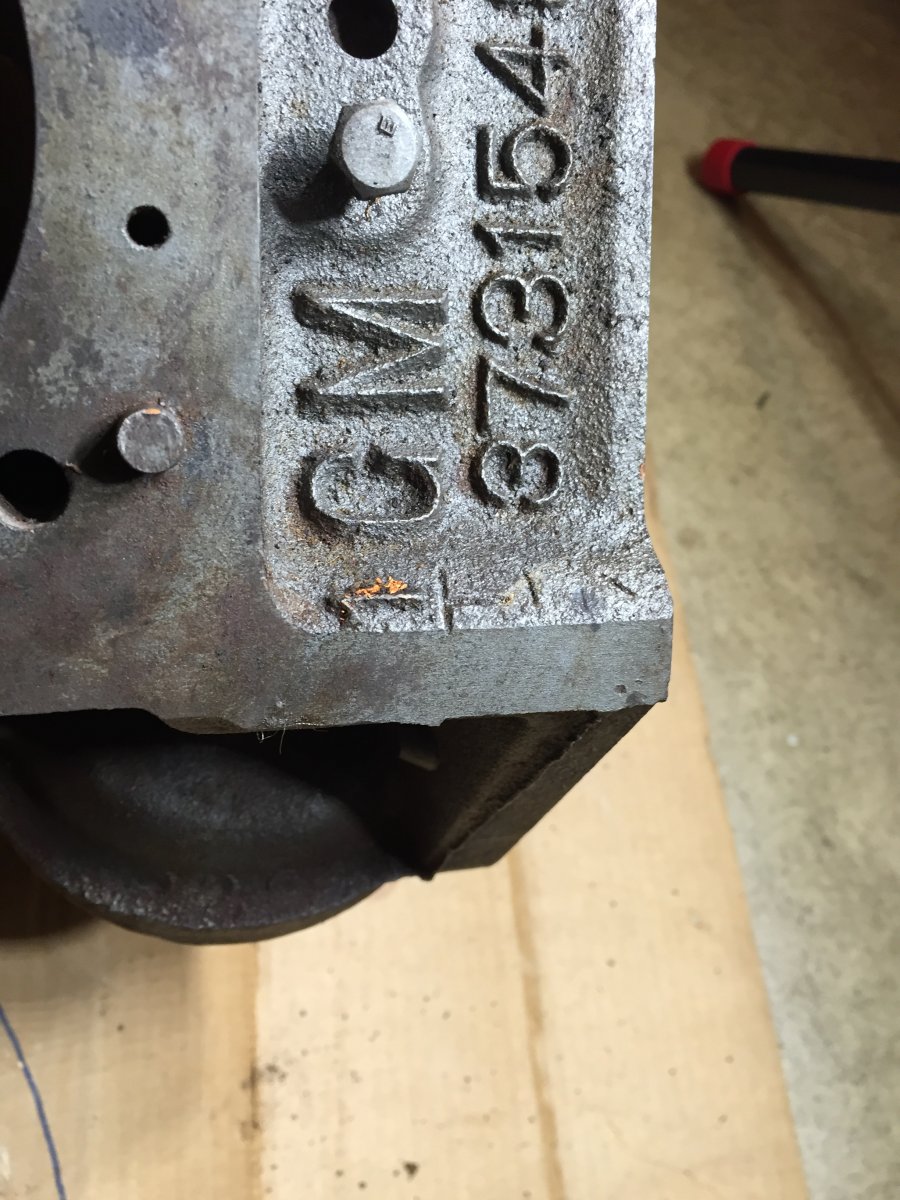

  19. SUSQ
    Joined: Nov 5, 2012
    Posts: 98

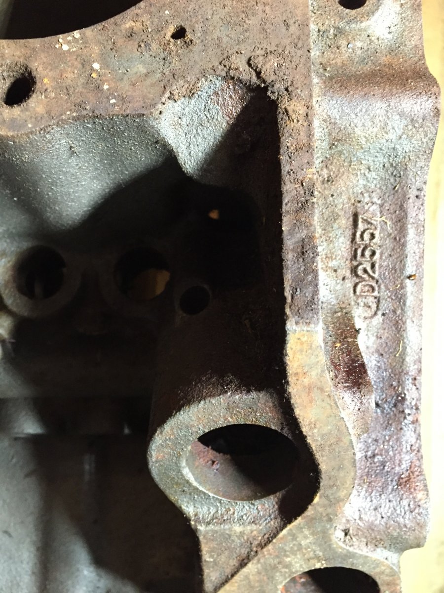

    SUSQ
    Thanks. Any insight regarding the other codes? Did they put VIN's on the blocks in '57?
  20. arkiehotrods
    Joined: Mar 9, 2006
    Posts: 6,802
    arkiehotrods
    On the front p***enger side of the block, on the part of the deck that still shows when the head is on, is stamped info that will tell you a lot more about where the engine was made and what it came in. If the block has been decked in the past, however, that info may be gone.
  21. SUSQ
    Joined: Nov 5, 2012
    Posts: 98
    SUSQ

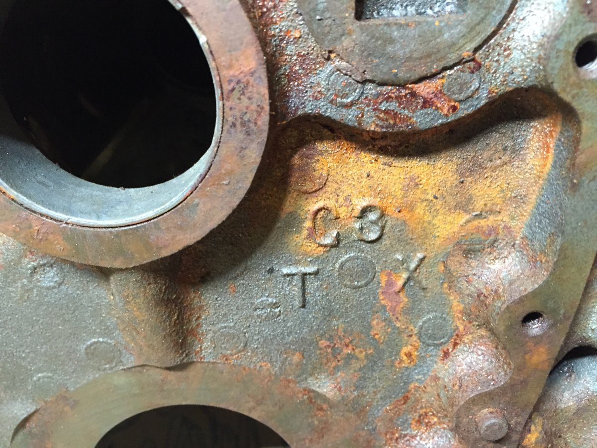

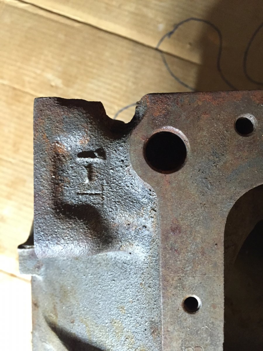

    We took a closer look at the pad and found what looks to be T503FC
  22. arkiehotrods
    Joined: Mar 9, 2006
    Posts: 6,802
    arkiehotrods
    T is Tonawanda plant
    FC is '57 283 4 bbl Powerglide 9.5 compression, 220 hp p***enger car
    falcongeorge likes this.
  23. SUSQ
    Joined: Nov 5, 2012
    Posts: 98
    SUSQ

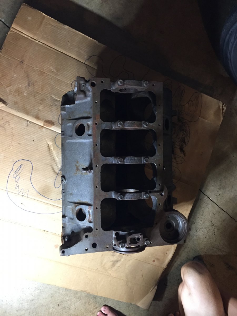

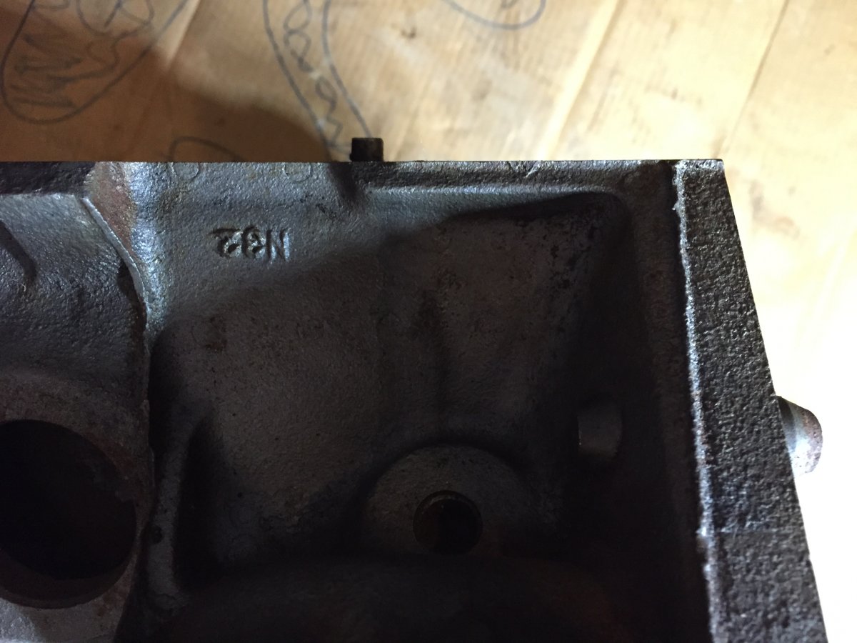

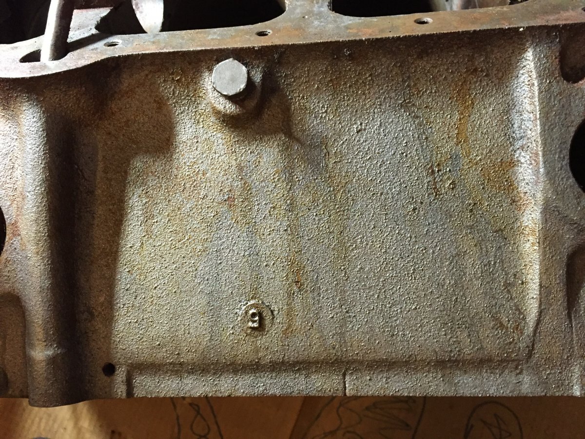

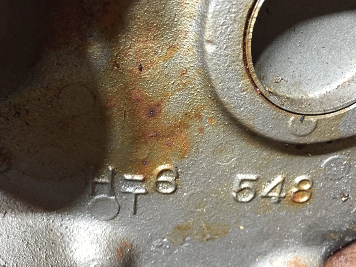

    Thanks so much. My son and I knew the H.A.M.B would come through! The May 3 ***embly date makes sense given the April 25 casting date. Any thoughts regarding the other block info in the pix?
