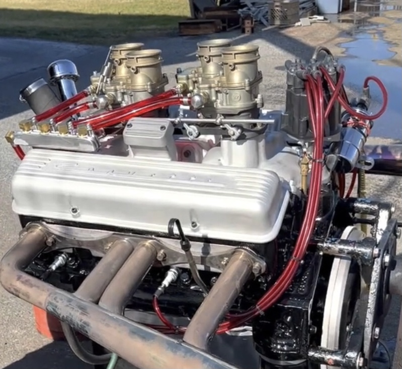

    upload_2025-7-24_2-54-36.png similar build in 1959
    Hello,
    Our first try at building a 283 SBC motor was given a lot of thought. What to use for carbs. Our initial thought was dual quads for top performance. For the drags, all 8 barrels on call at the touch of the full throttle. During the normal street driving, only half of each carb working with the pedal and foot. We had experienced it on a dual quad corvette and it was a nice set up. Plenty of surge with stomped on the throttle from on quad to 2 quads open and blasting down the street.
    But, as we got a lot of advice from the top engine builders in our neighborhood, Joe Mailliard, Reath Automotive, etc, we were in a quandary. We got all sorts of build scenarios. So, we visited a small speed shop near our house and in some oil fields neighborhood. They had set up shop in an old house and now had a cool converted shop in some homes, but it was ok, since it was zoned industrial/residential with the ****tered oil pumps doing their thing.
    The shop owners had a 283 long block in a build stage. A complete 283 motor with dual quads and ****tered on the shelves, 283 Chevy truck heads, Edlebrock 6 carb manifold and Stromberg 97s attached. They were in the half way point of putting all together with the long block. We were interested in the whole set up that was apart in many pieces. But, all of the pieces were there, it was a challenge, but my brother brought out the cash and made the owners an offer.
    The only other thing we had done was that we took the heads to Jocko’s Shop in Bixby Knolls and had them port and polish everything. So, now, we had the parts and the puzzle ***embly began. Yes, we were told the 6 Strombergs were better for the drags than the dual quad set up. And the linkage could be adjusted to run the center two carbs for daily driving.
    Jnaki
    It took many days of after school time to set out everything in order of my brother’s way of ***embly of the motor. So, each day, he set everything out he wanted to ***emble on a white towel. Then bit by bit, we ***embled each part carefully with a torque wrench.
    The pistons were 10 to one and the rest of the motor were aluminum Jahns version, aluminum rods and the stock crank. When we picked up the heads from Jocko, they were gleaming like gold and fit perfectly. I had taken them inside our study den of the house. I put them on a covered cardboard table and was wiping each head down as if it were a prized possession. After I got one head all cleaned and ready, I started on the other.
    It was freezing in our backyard garage that we normally ***emble hot rod stuff. So, the warmth of the house heater and a nice table was perfect. But, I got yelled at having a “dirty car part” sitting on a nice cardboard table inside of “her house.” But, by then, it was as clean as her dinnerware.
    The fully ***embled 283 motor was an instant hit as it got started in our 40 Willys Coupe. Backing up out of the narrow gr***y area, between the two homes and down the long driveway, the purr of the motor giving off a rump, rump of open exhausts was music to our ears. No, my brother did not rev up the motor. He knew our mom did not like loud exhaust noises… ha! But, it idled all the way to the street and then, we were ready to complete our adventure.
    Note:
    We ran the carb motor for a couple of months and were satisfied of its performance. But, then we took everything apart and the block got bored out to 292 c.i. Now, our next adventure of blower spec parts for the re***embly was starting, with 8 to one compression aluminum pistons and rods on a Reath balanced crank. So, then our process took awhile to complete. Real power was the result with the touch of the gas pedal…YRMV
